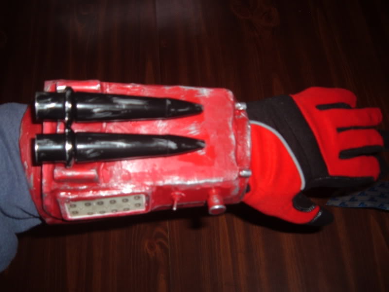

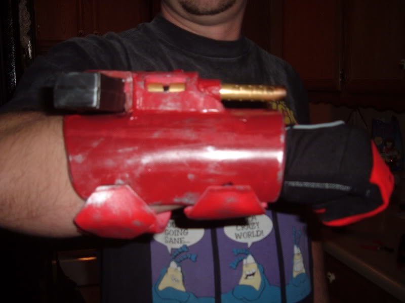

Here are the gauntlets for my custom Mando I'm working on. Enjoy!
Wrist Rockets
Machine Gun Gauntlet

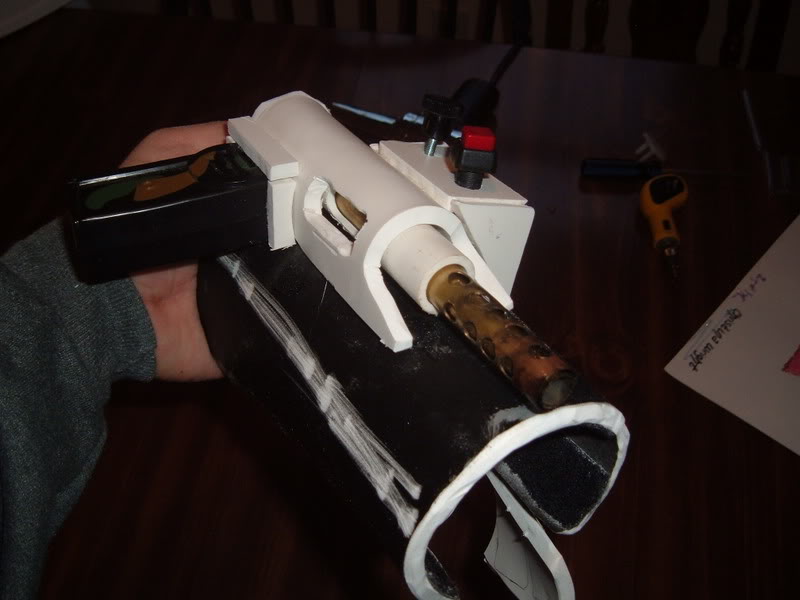

Some progress photos...
Yes. Lots of bondo. I glue the pieces of sintra together and then bondo them up with my trusty popsickle sticks. I then use a dremel sanding drum to sand down the crevases. I smooth them down a little more with hand sanding. The brass pipe is two different sizes inside of one another and my friend drilled out the outside one with a drill press for the heat shield. The "keyboard" on the missile gauntlet is the innards of an old cell phone (circa 1996). I used 1/4" sintra for these gauntlets. It bends best in the oven at 300 degrees fahrenheit for about 1.5 minutes. The ammo clip for the machine gun gauntlet is from a toy machine gun I picked up at the dollar store. Any other questions?
