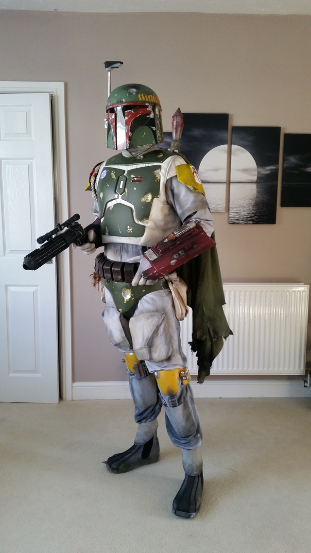

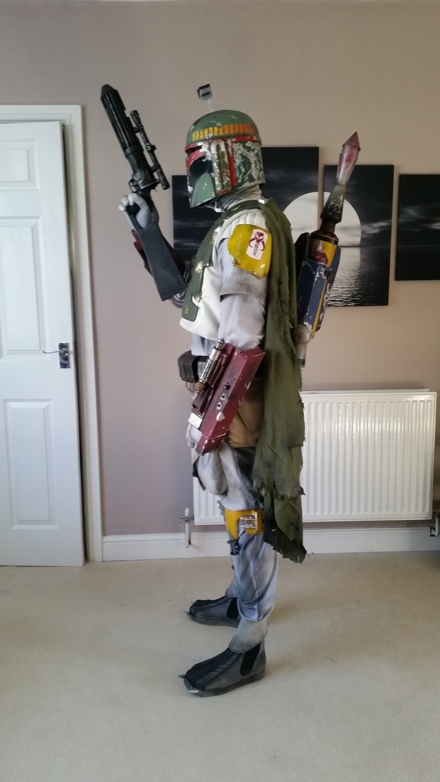

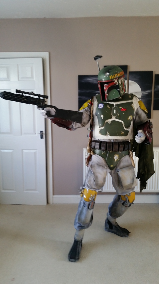

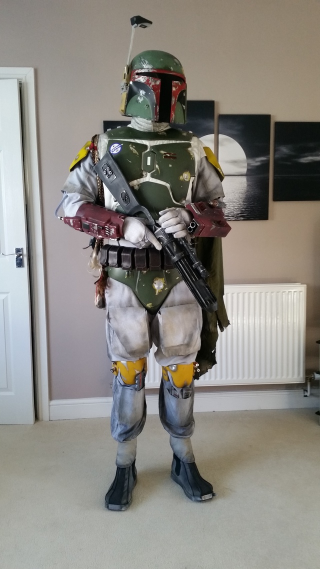

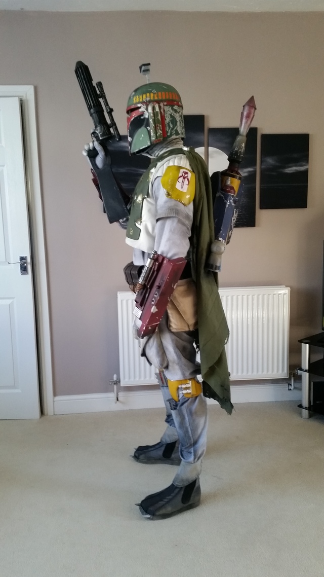

Ok this is it!! all painted and weathered I am minus the girth belt but that is being re made as we speak, and excuse the wires you may see that to has now been hidden I am 99% done!! with my SE ROTJ Fett

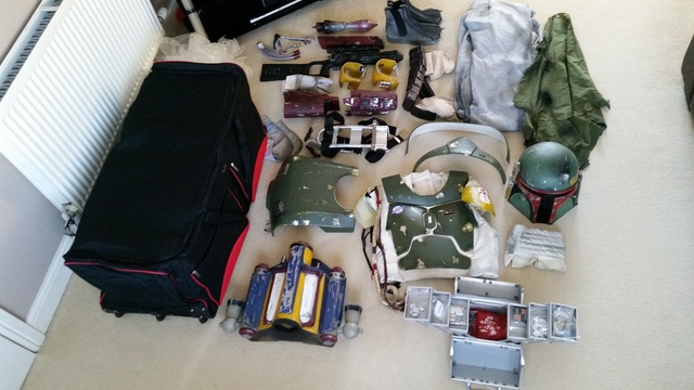

I got a huge bag to carry it around in, made a modular insert and padded it all out, this way I can get it around without damage, I feel this journal is not over just yet as I need to mount it so something else will follow after :D

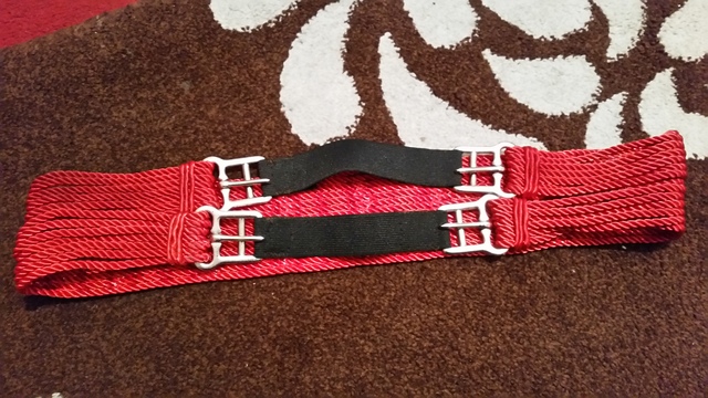

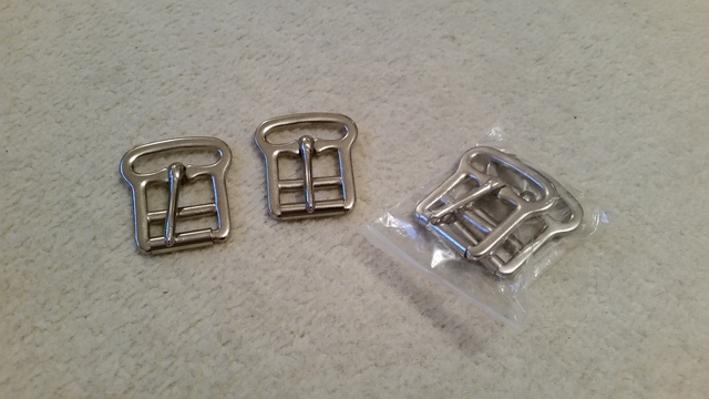

Well my girth belt parts arrived, the red rope is a bit to red but I can dull it down no problem. Now I have these little gems that are almost identical to the original, brand new from a very popular auction site and they were only a few pound each
for anyone looking for a girth belt or girth belt parts just look for things like ''Horse girth belt'' or ''Horse girth'' even just Horse buckles... as the girth belt it's self is part of a horse saddle
