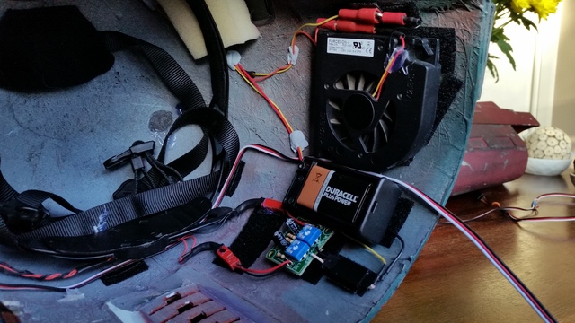

I have installed 2 fans, an amp with audio pic up so I can hear whats going on around me, range finder stalk servo and range finder lights.. I have the Aker voice mic also

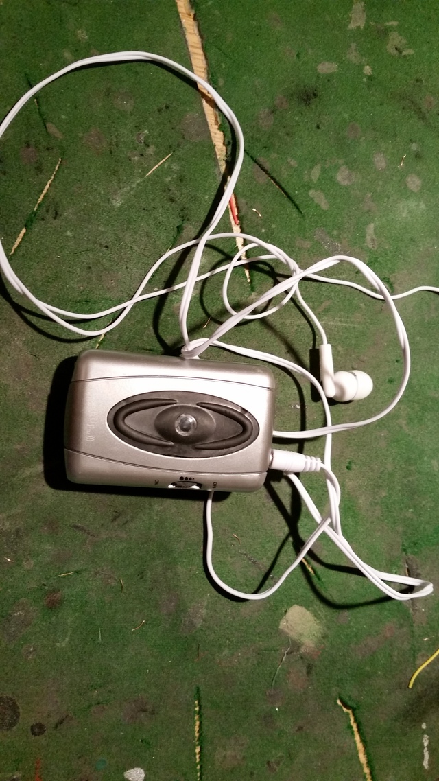

First off is the sound amp, I found this online simple easy to use audio pic up, for only a couple of pound it is more than enough to hear the surrounding environment, I sat up stairs and got my partner to whisper down stairs and I could her it clear as day its fantastic for very little money...

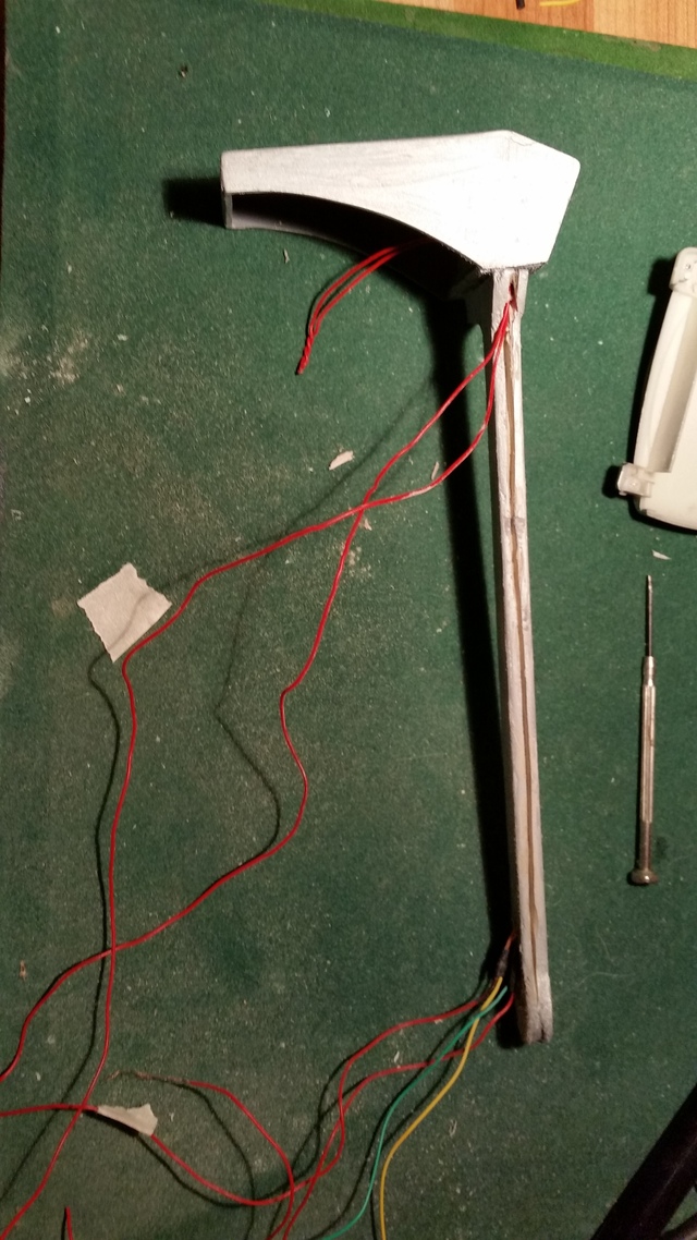

I stripped it down and put the mic in the range finder, now I have a directional microphone when the stalk is lowered :D:cool when its up top I get no feed back noises from my clothes rustling etc so its the perfect place

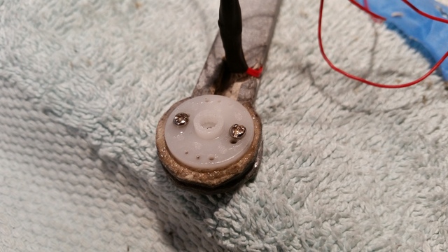

I solved the servo issue I had, it turns outt the little servo tester I am using don't work with digital servos so I got a 9g analogue one and worked right away, all I need do is fix it to the stalk good and tight and it's ready to go

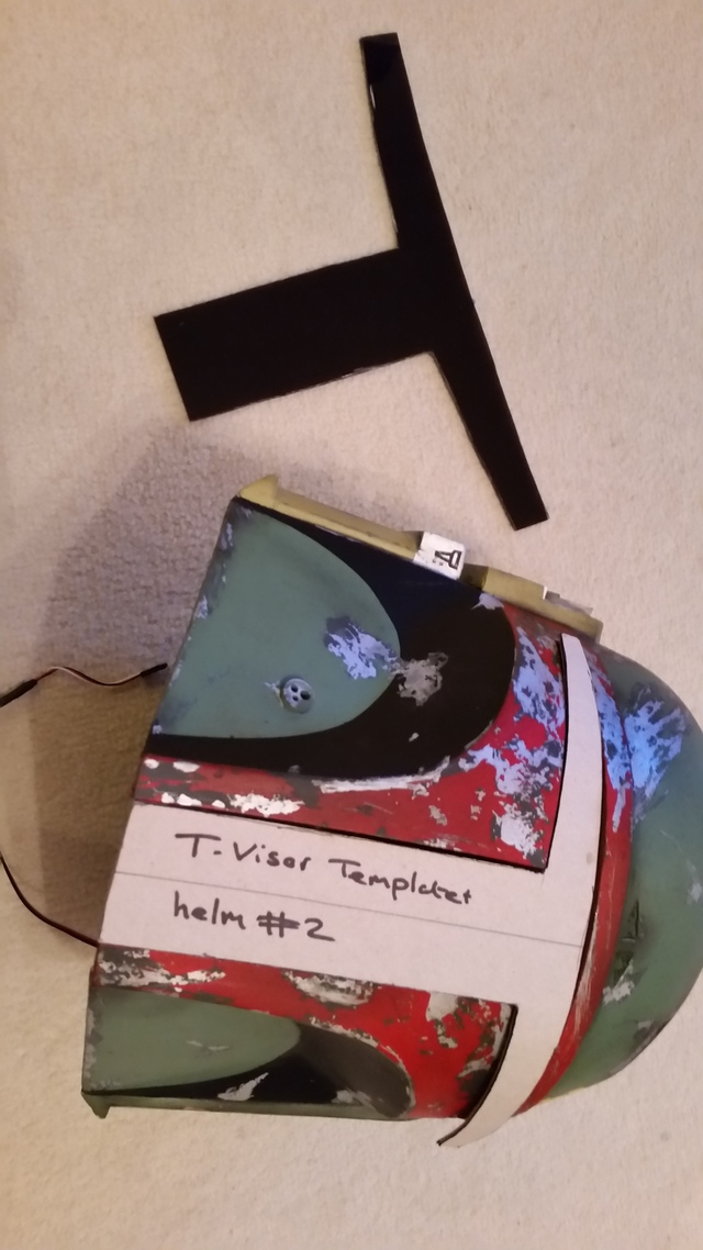

I had to get the visor in now that all the electronics are in, I got some 3mm dark perspex and cut to shape
now this stuff has very little flex and shatters if bent to much, I poured boiling water over it let it heat up a bit then bent it in to place and used hot glue to hold it down before it knew what happend to it....you will need 4 hands for this!!

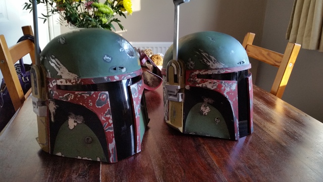

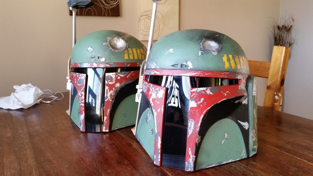

here it is as it stands now in direct sunlight,
and a side by side of my first helmet that is on the left....(the one with the massive dent :rolleyes)
here is the mother of all electrics that fits in here :eek:
everything has a connector on it for quick fast servicing if I have an issue with a fan or something and I can inter change it without needing to strip it all back,

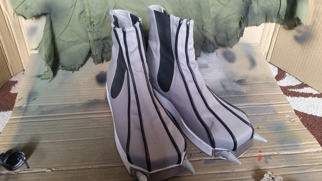

I have done a bit of weathering on the boots and cape, this broke my heart to spray them Man Of War boots but it had to be done...
the final image is in pure bright direct sunlight, its always hard to get an accurate picture of something without seeing it your self but they are a bit darker than this in person..
its just a simple Matt 33 black burned most likely from the jet pack with a bit of sand 237 along the bottom for the dusty dune sand look
once dry I will get a better shot I think for contrast

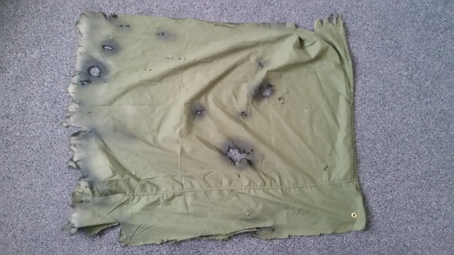

I also done the cape again in black 33 and sand 237
a few close shaves there by the look of them holes!

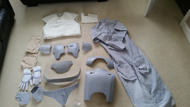

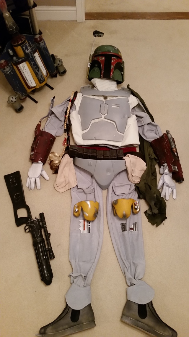

All V3 Boba Maker parts, this will finish off what I have started, I have so much work to do on this I can't begin to think about it.... to top it off I had a Facebook notification saying that on March 5th at Swindon's first con here in my how town Jeremy Bulloch will be attending!... since I met him last July in London that was when I decided to go the full distance and make up a Fett outfit I will meet him again but this time I will be Boba :eek:

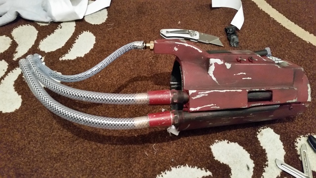

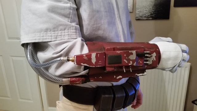

My main focus is to get the hose attached to the under sleeve on the right arm.... now I know full well the issue with the pipes bunching up and pushing the sleeve out making the whole arm look silly when you bent it....I think I have solved the issue.
these images are not the final product the are just proof of concept (Am covering the fact the stitching is horrid)
I see a lot of people using clips to hold the pipes on and it makes it easy when you want to take it off, one of the issues I find with this is a lot of pulling on one spot and almost tears your head off when you bend you arm due to pipes pulling down on such a small area of fabric.
for instance
so to combat this I used a V shape strap to spread the load across the shoulder, now when you pull down on this there is no distortion in the material
Now on the pipe end I have replaced one of the hoses with smaller diameter one ( I know that its wrong etc) but its more practical for walking around, posing for pics, and basically moving my arm like a normal person and I want to enjoy the day.
Nut and bolts
I bolted it in a curved position and attached elastic to it, the end on the sleeve is also on at a slight angle this way when I bend my arm the whole assembly will come out from under the sleeve and flex on the elastic and not on the pipes or fabric, I have tried it without the elastic and unbent pipe and the resistance is awful on your wrist when you bend your arm...

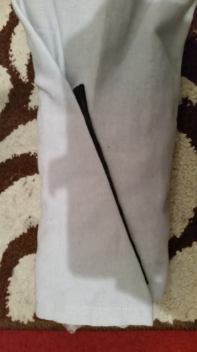

The Boba Maker gloves come with button, I find buttons fiddly at the best of times so for ease I swapped them out with velcro, this way I can get them on tighter and keep the cuff of the flight suit contained inside it

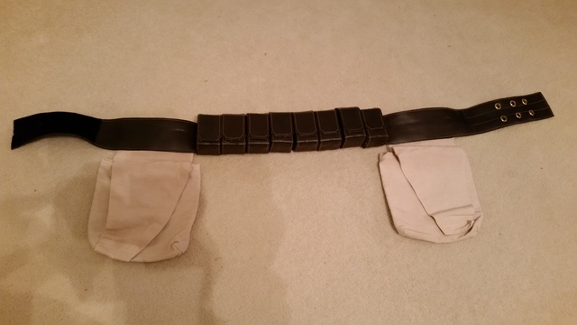

Again velco used to put the side pouches on to the belt
I have also added velcro to the forearms, getting the gauntlet to close without fabric getting all trapped and hanging out is just irritating, this way all you do is fold it over and it goes in with a lot more ease and a lot less faff!
