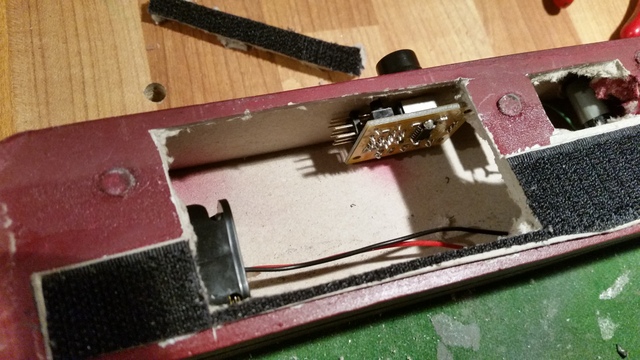

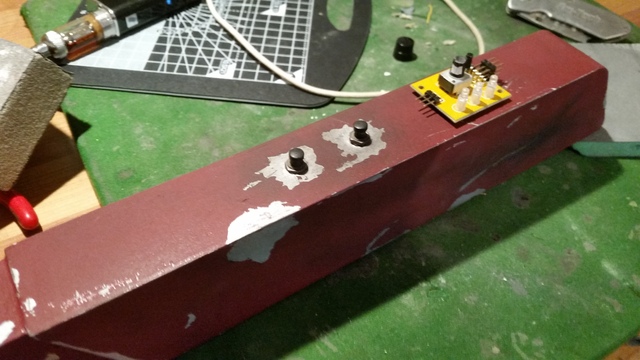

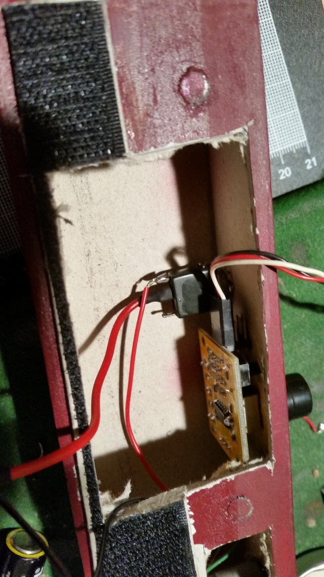

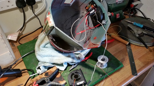

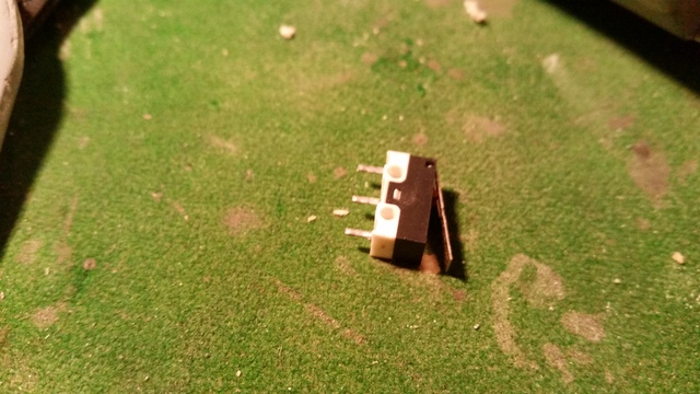

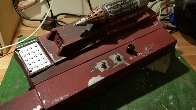

I have now got the micro switch installed, the circuit board is all working now all I have to do is connect it all together and I should be able to drop the range finder and have me some flashing lights.....I hope..

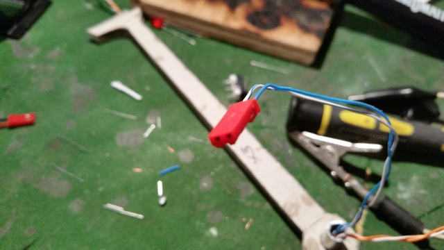

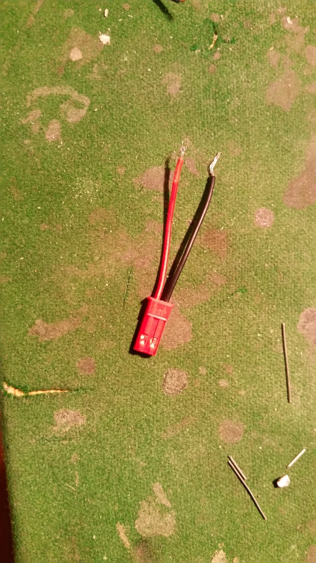

these type connectors are being used, I just took out the pins and soldered in the wires directly.

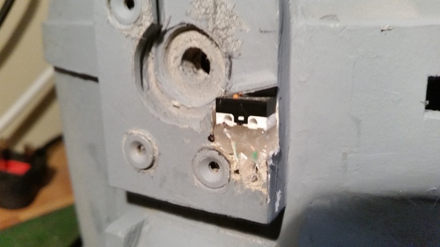

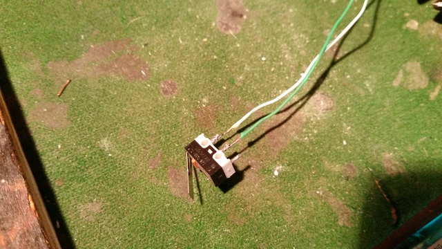

The micro switch
I cut the slot for it backwards :wacko so made a 'small' mess putting it in... no problem it will be filled and never see it anyway
I will hook it all up next week I am away for a few days now, more updates after Christmas and maybe some info from Boba Maker regarding my armor :eek:
I cracked it! I have flashy range finder lights :cool :thumbsup:

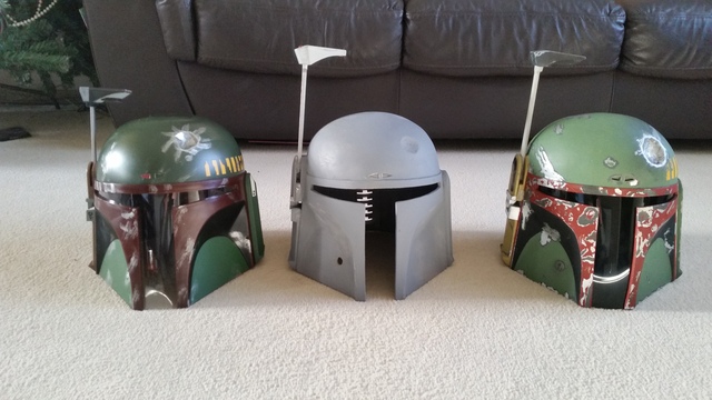

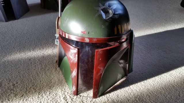

I have the Rubies Helmet, my work friends family was coming over from the states to visit for Christmas, so he got them to swing by a Target and pic one up, its been from state to state from country to country from town to town and finally they dropped it off :D
a few mods and a paint job ans it will become a display piece
I now have my first helmet that I have named the 'Beluga Helmet'' as it has a bit of a butt head to it pulled in from the thick visor, my WIP troop helmet (with all the electronics to go in) and the display helemt from Target,
not sure what to do with the Beluga one yet, maybe have it as a back up helmet..plus the dent in massive :lol: ah well it was a first try I guess.

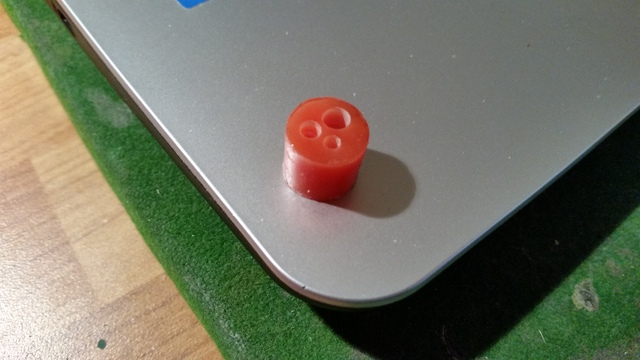

I did make a simple resin connector that came out a treat...

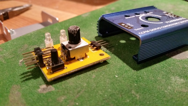

I have had a gizmo in the mail that will help with my range finder project, I want it to come down and blink... I have the blinking part working now I need to get the arm to come down and up again... and I have that 50% finished today..

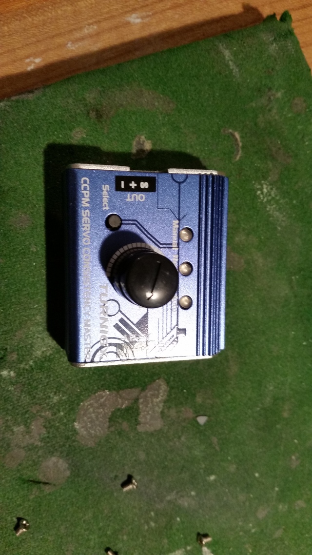

For about £5 you can buy a servo tester that you can test the full range of a servo with, and with one twsit of the dial you can rotated it 90 degrees, I did consider a simple switched version but I wanted to activated it with fine movements and from the gauntlet that you can see working...
its far to big to mount on the gauntlet so I took it apart to fin inside it some place..
still to big and could not find anywhere to put it inside the already tight fitting gauntlets,
I can't put it inside a pocket or in the belt without fumbling about to try and work it, I did however find space inside the left flame unit..... now I know it will not look accurate anymore with a dial sticking out of it but oce I have filled in all the lights and now unused button I can make a slim low profile version of the dial once its installed and should make very little impact on the over all look... I hope...
and as you can see from the video in the link below it works great, after a few tweaks and some cosmetic repairs it should be just what I need.

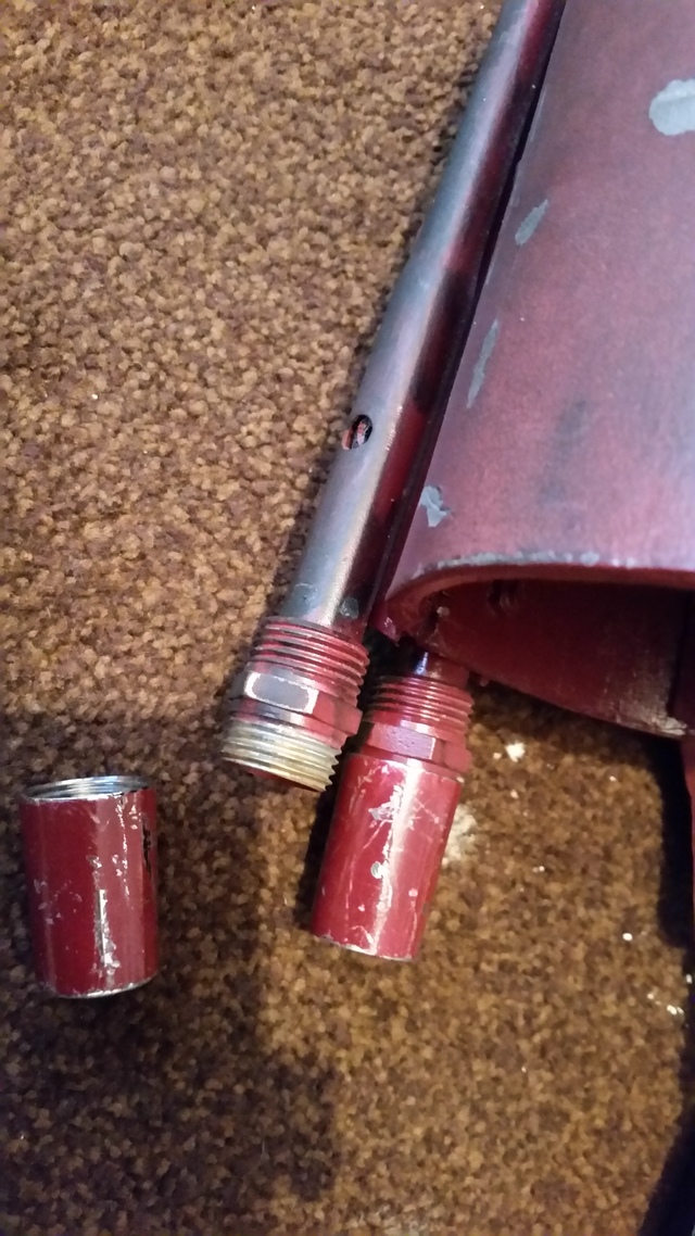

Where did you buy your gauntlet rocket and the keypad?
Most important though, what size copper tubing did you use on the right gauntlet and what are those connectors? I couldn't quite figure out the photos of how you connected the copper pipes to the gauntlet. If you have another photo or could explain it it'd be appreciated.

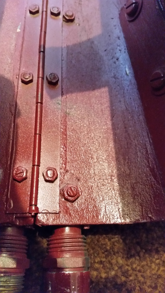

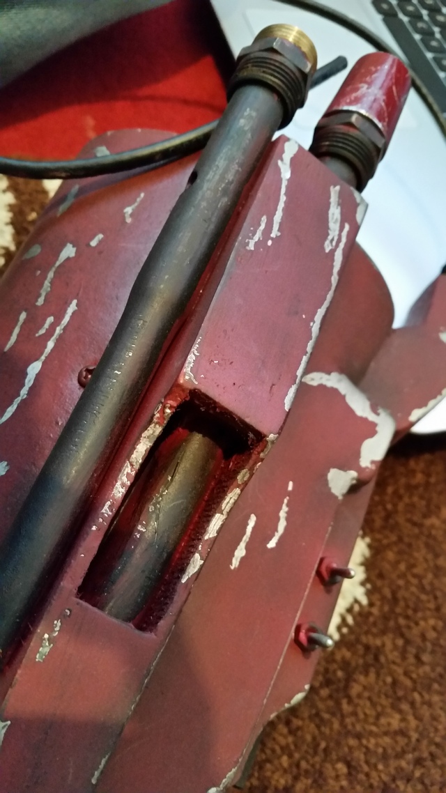

ok the pipe I used is a reduction pipe (copper) used on sinks mainly its 15MM and tapers down to about 12mm
first I bolt the upper pipe to the gauntlet as you can see with the two nut and bolts as viewed from the inside
I then place the line thrower shroud over the top of it and hold it in place with a bit of hot glue, leaving a little space or gap at the bottom to slide in some nuts so I can bolt the bottom pipe on through the bottom through the shroud and tighten up
so in sort top pipe bolted to gauntlet, shroud fixed to top pipe (with gap) bolt through bottom pipe and shroud with nut?
The reason for such a heavy fixing is the hose will flex like crazy and put a lot of strain on that area , this way it wont snap or brake the gauntlet
the connectors I used are in no way screen accurate but the are shower hose ends that have a an inner retaining ring. and half inch male male joiner
if you look up my posts you will see how I made it so the hoses will stay in place and be able to rotate and move, again causing less fracture and stress, This part of the outfit needs to be more practical than you think.
I really don't want to start falling to bits at an event :thumbsup:
I hope it makes sense, the parts are all basically bolted to one another. like Lego I guess..

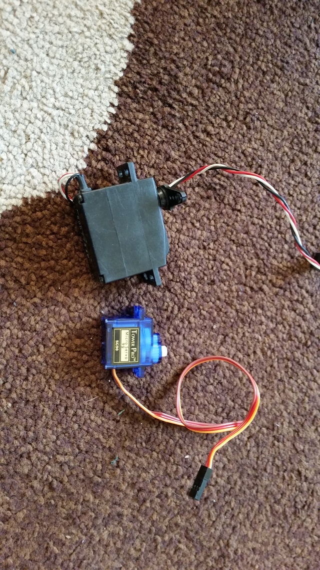

Ok folks I am having trouble with servo, in my video I show I have a servo working with my servo testor that I have hot wired to work as my range finder switch, I went and got a little micro servo to save space but the damn thing dont work with my little gizmo I bought? any thoughts, I have x2 of these little servos brand new they can be broke...they just dont seem to work at all with the servo tester? they are digital ones maybe that has something to do with it?
top one typical servo...bottom new micro servo

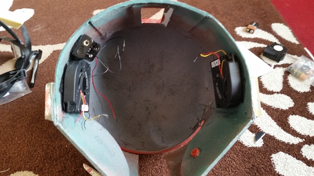

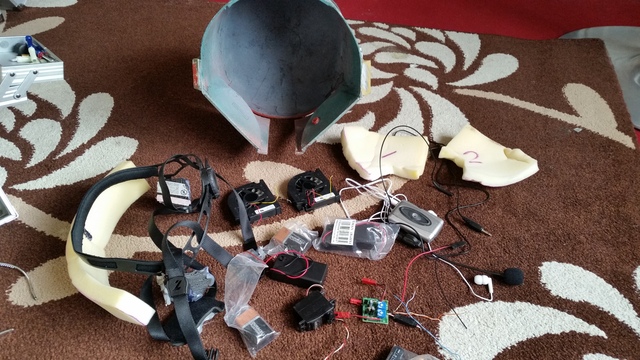

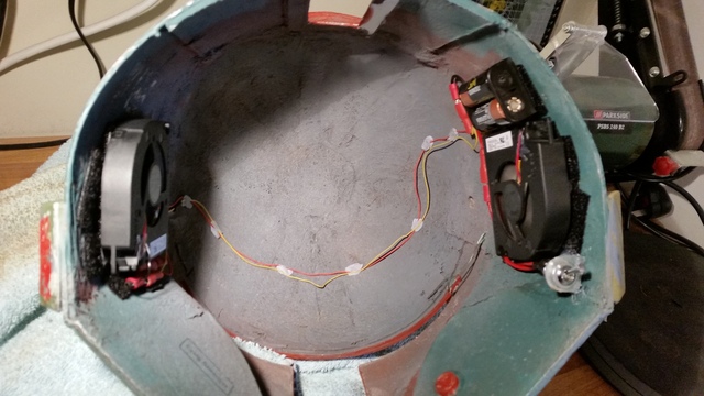

I have hit the point in the build where I need think about electronics, still waiting for my parts from Boba Maker so its giving me time to look through the mountain of wires needed to go in this thing, so I start with the helmet. x2 fans + power, x1 servo + loom, electronics for range finder + power, external audio pic up + power, and the aker mic system :behave
start with the fans and I like to make things as serviceable as possible for quick interchangeable parts so I used connectors on everything..
everything works :thumbsup:
I used a very low tech way to keep the wires in across the dome using blue tack, head band will be glued over it anyway. So thats two fans up and running with a toggle switch under the right ear
It sends out a nice draft everything is in with velcro so I can make tweaks if I need to
up next will be the servo.....still can't work out why the micro servo wont work with my servo tester??
