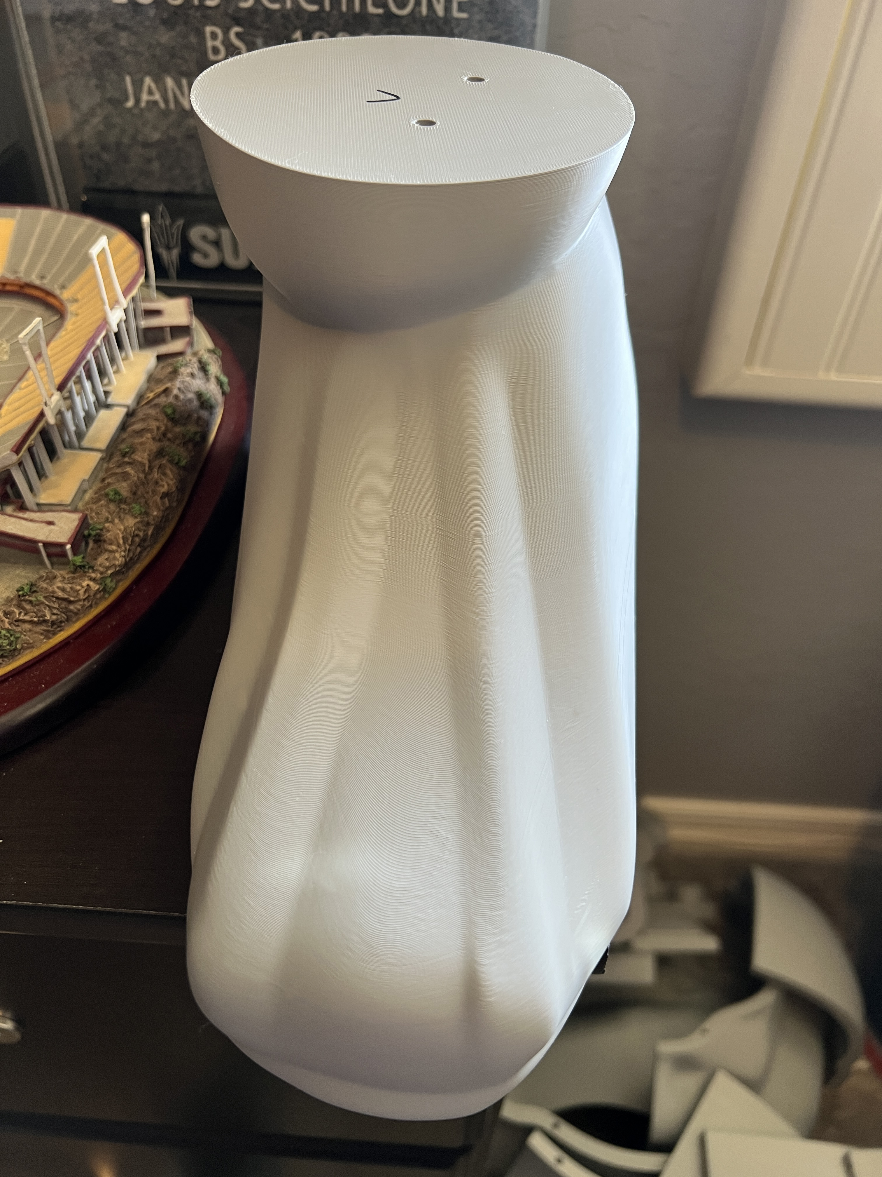

I think that about sums it up. I'm currently in the process of printing this figure now, the first foot looks great! Once I finish and make, if needed, any adjustments, I'll have this file set available.
