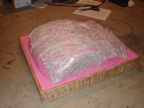

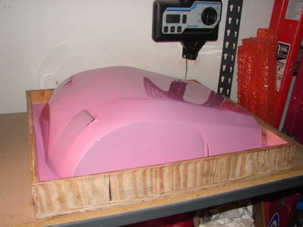

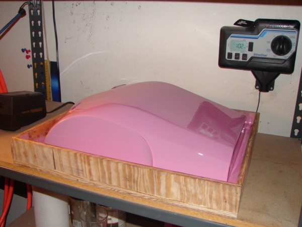

Well, by tonight I should have the 4th coat of silicone poured on the backplate. Then I'll butter it up with a nice thick coat of silicone and give it a FG jacket. If everything continues to go smoothly, I hope to make the first pull on Sunday.
I'll post a few progress pics tonight.(y)

I decided to make all of the backplates hot pink!:)

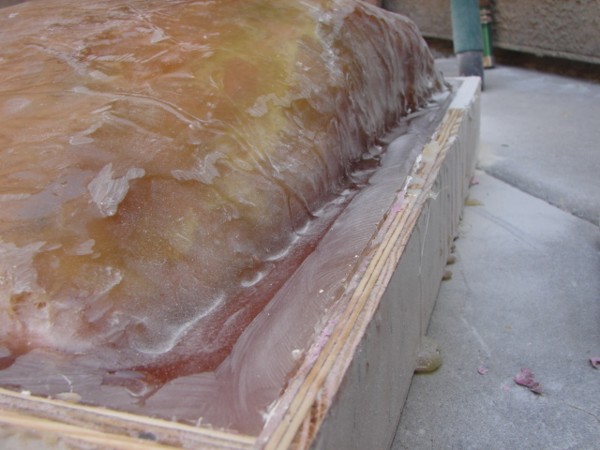

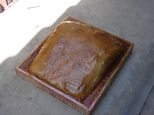

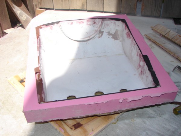

Laid the permanent FG jacket this morning. Then took the family to the local Iris Festival...in 100 degree weather:facepalm. Came back a few hours later and viola!(y)

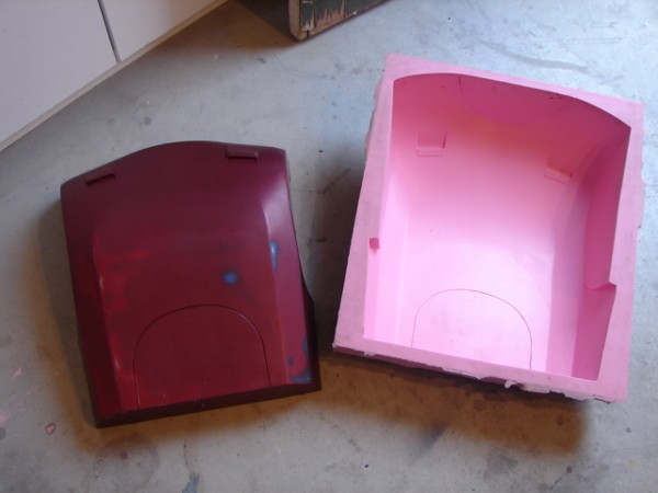

I figured there might be a few people out there interested in seeing how the mold came out...so just sharing. It came out solid and very good so it should last for quite a while.

nice job ! Hey, just a question on your mold, did you key your fiberglass jacket to your silicone or is it permanantly bound ?

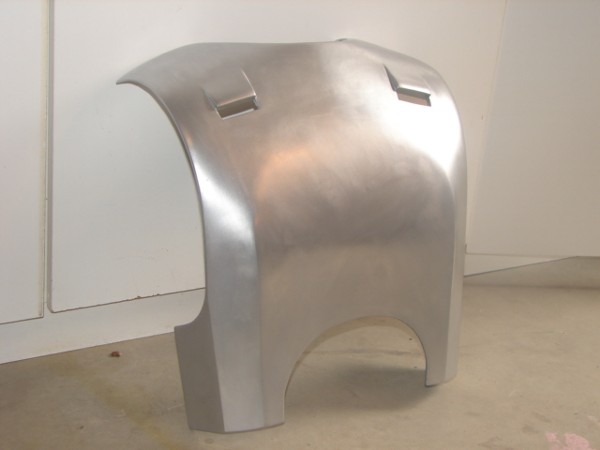

GotMaul, no keys, it's a permanent fg jacket. Every single area tapers so I prefered to make it that way. Plus, when I make a pull, I'll only resin and fg the actual areas of the backplate which should make it fairly easy to remove it.

man that's one nice thing about working with solid objects as opposed to making masks, with masks when you make a mold it ruins the sculpt. But with what you did you can make multiple molds with that one buck and have more than one going at a time. it just doesn't seem fair.... awesome work
