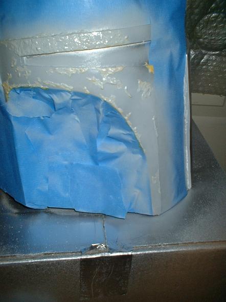

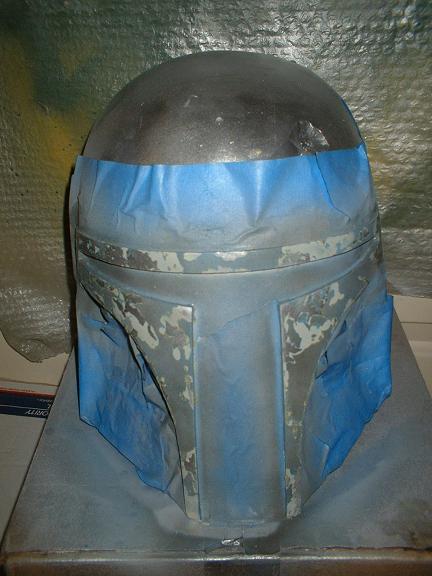

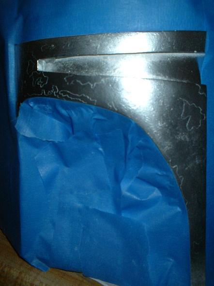

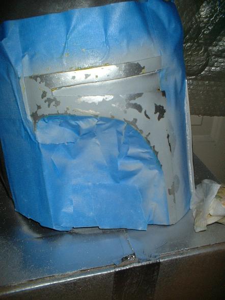

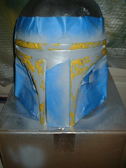

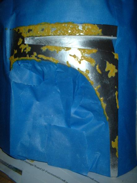

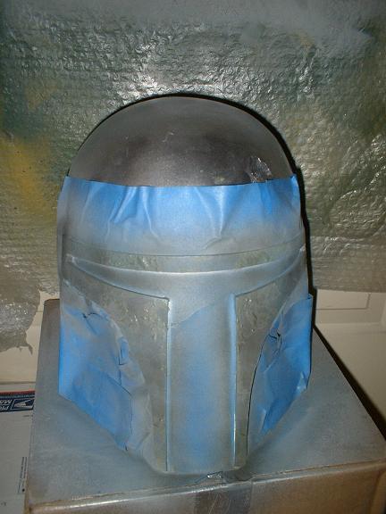

Ok, got my MS2 today(THANKS Marrowsun!) and began the long process of layer painting it to ROTJ specs. I decided 2 things before beginning. I am going to leave the helmet visor in until I finish painting to make this easier to handle and I am using mustard to mask the layers. In the pictures below you'll see the stages I started with for the metallic base and 1st layer grey. Also, you'll notice I am only doing 1 section at a time for the layers. This is so I can keep my damage as accurate as possible to the Magic/myth pics. I have found the best way to use mustard is to apply and then spray the next coat of paint ASAP. I then wait until this layer is still tacky to the touch and use a very wet paper towel to dab(not wipe) the mustard away. Then very lightly dab with dry paper towel to remove water, be very carefull of this stage. If you press to hard you could leave unwanted impressions in your finish. Then allow this to dry completely before the next layer of mustard & paint. You'll see in my picture there is still a bit of mustard, not to worry. These small spots can be gently scrapped away with your fingernail once the paint is completely dry..Also, I'm not saying this is the only way to do this...this is just how I have found it works best for me and thought it would be helpful to beginnners.

im a little confused... what color and in what order did you spray the layers... im trying to work it out lol
nope... think i got it... i think
Looks really nice!! Keep the pics comming..
i don't know about the rest of you but i let the paint completly dry for at least a few hours. Then i used an old soft toothbrush and gently scrubbed the mustard off under a tap of luke (spelling?? finger warm if you know what i mean..) warm water. Then i used papertowel (the good quality stuff, the one that doesn't leave lint) to wipe any remains of water and mustard off...
and concerning the mustard smell.. i found that most of it.. if not all disapers after you put on a layer or two of clear lacker.

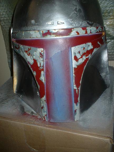

Fettish attack...I used chrome base, then light grey, then charcoal grey/blue mix, and will finally use claret wine with dull coat on top.
Boba Swede...I have used that method too, but found it takes too long for me. If I do the wet paper towel after paint is tacky I can get the same results but only takes me 1 or 2 minutes to wipe off the mustard. Was taking me 5 minutes or more with tooth brush method cuz I was worried about scrubbing to hard. More pictures with final coat on visor border later this morning......:)
(edit) As promised, here is a pic of visor trim after final spray...I'll be looking for area's I missed in the details and using a fine brush to fix the details I missed....
