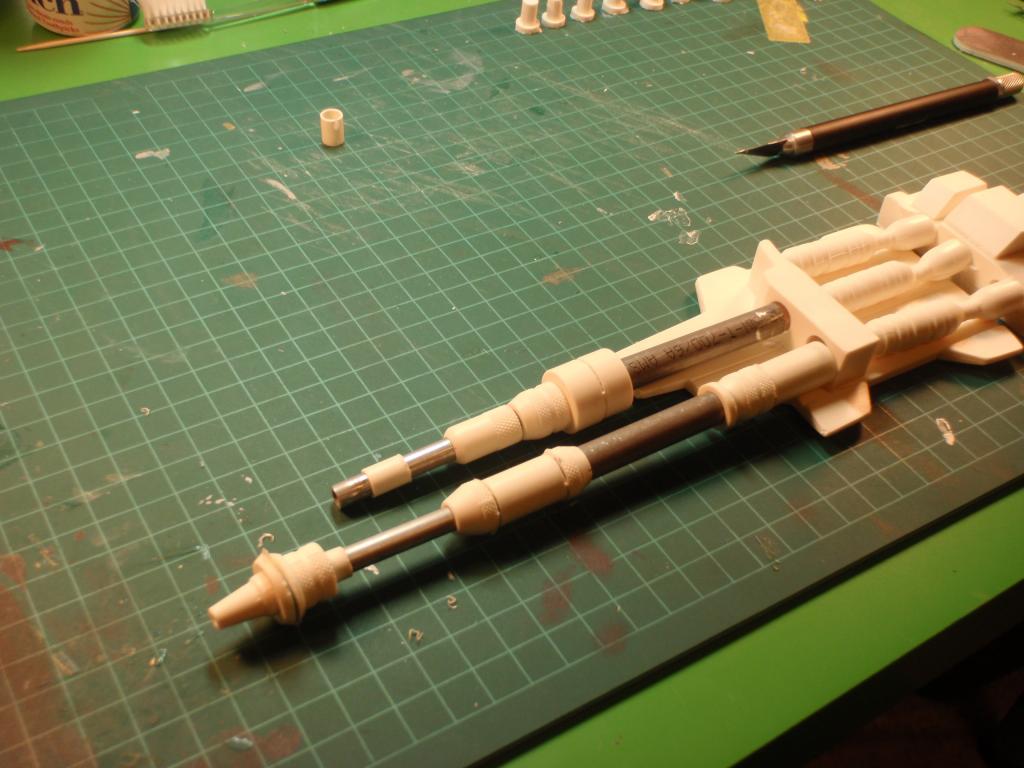

I did a quick layout of the parts for the base of the flamethrower unit. Check your references to see how this part gets assembled. You'll find a bunch of trapezoid-shaped blocks that make up the detail here.

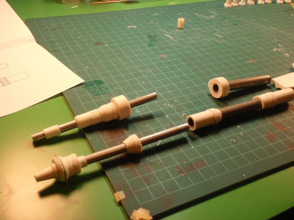

I also dry-fit the nozzles for the flamethrower. Christian provided a diagram for me to follow for this assembly. I recommend that you carefully study the drawings, and match up the parts to the drawing. Test-fit (trim any resin flash on the insides with an X-Acto knife). Correct your mistakes. Disassemble and lay out your parts again. Test fit your parts. Disassemble them. Repeat until you are comfortable with the assembly and parts identification.
Personally, I am probably going to replace the tube sleeves with brass or aluminum tubes of similar size from my hobby shop. As for the collars, I will scour my local hardware stores for similar items. Vets, is there any info you can contribute for this step of the build?
The cool part about these nozzles is that the skinny tip assemblies slide into the larger rear assemblies. This should ensure that your parts are straight.
A cool shot of the dry-fitted flamethrower assembly.

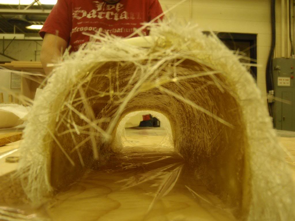

I used fiberglass mat (randomly oriented strands of fibre held together with a glue that dissolves in the resin you apply). This is better than the cloth because it will easily conform to irregular surfaces. Now I just rough-cut some sheets to size. Don't do this! Take the time to trim these pieces as best as possible to your part. I learned my lesson by the time I got to the last gauntlet half. :p
Brush some of your freshly mixed resin on the inside surface of your part. Don't be afraid to use lots! I found that more brushed on beforehand helped the initial contact and softened the mat enough for it to conform to the insides easily.
Lay on your mat. Press it into the resin you just layed down. Now, ditch your gloves (they're all covered in the loose fiberglass strands) and put on a fresh set.
Start dabbing on your resin. Don't use a brush-stroke. This will pull fiberglass strands from the mat and before you know it, your brush is all matted up.
As you saturate the mat with your resin, you might notice air pockets forming. My brush had some stiff bristles, and I was able to pop most of them by stabbing at the bubble. The proper way to do it is to gently roll them out to the edge with a small fiberglass roller. They look like paint rollers with super-skinny ridges. Darned if i could find one around here, though. :rolleyes
Here's the inside of my first gauntlet half. Kinda messy. Like I said, trim off the excess mat!
I used some cellophane food wrap over the wood form I made to keep the fresh resin from sticking to the form.
Fingers crossed! Here's hoping this works!
Ok, the post game report...
I probably spent about 15 minutes applying resin and just stabbing at the air pockets on my first gauntlet. A lot of that was caused by having flops of fiberglass mat sticking out the sides. The extra material would constantly pull away from the inside of the gauntlet. When I re-stuck it on, more air bubbles would appear.
I used almost a litre (2 pints) of resin to do these 4 gauntlets, and most of it was wasted. I found that by the time I was finished one gauntlet half, the resin was already gelling up. Tomorrow, I'm going to try smaller resin batches so there's less waste.
My last gauntlet half was the quickest, easiest, least 'bubbly', and the neatest of the 4. A rough cut of the mat really impedes your work. It's nasty stuff to touch, but take the time to do a precisely fitted cut of the mat.
By the time I finished my last gauntlet, my first gauntlet was pretty much all cured up and cooling down. And just the single layer has substantially improved the stiffness of these things!
The forms worked like a charm. The cellophane doesn't stick to the resin I had layed down, and it doesn't melt from the heat, either. My gauntlet halves still line up too!
