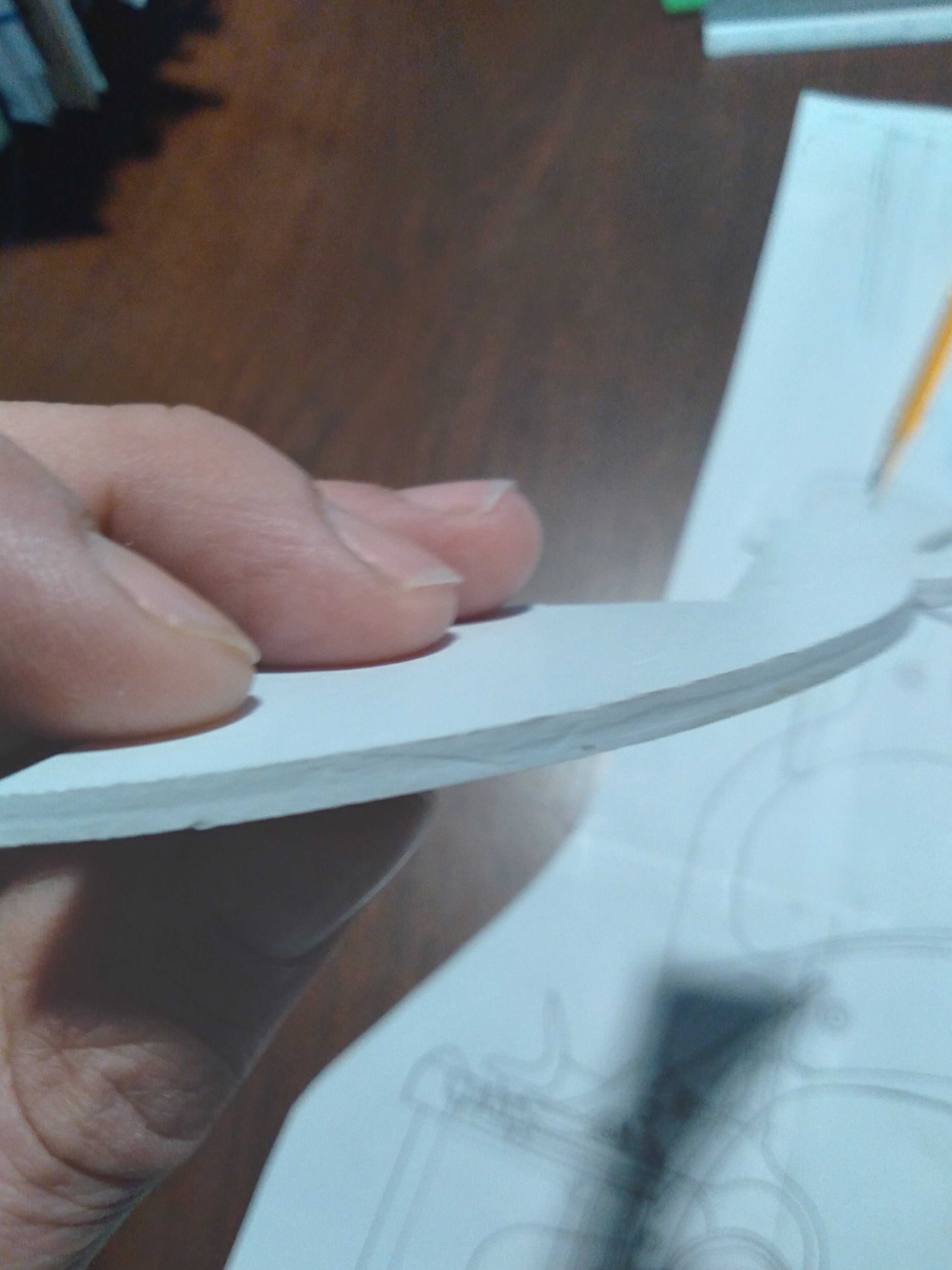

My reason for asking is if I want to curve edges and will the foam show and be gnarly as on sintra..?

Indeed Sintra has a foam core, but it's quite dense and I've found it looks perfectly solid once you sand and paint it. You could always use a glazing putty to smooth it out even further.
Yeah it is foam but its pretty solid, here's a picture when it's cut
my whole armor is sintra, the edges come out fine.

Coming from an Acrylics background I'd not thought about Glazing putty... That will work great for filling gaps on my Gauntletts..
That looks ideal!
I did beg some off cuts of PVC sheet from local sign makers but it was only 1mm where as your pic shows I can get super strong(hopefully) parts..
Yeah, I use 3mm sintra, it's pretty durable. I've dropped my jetpack before, I did get a completely fixable crack, but I expected worse when it happened.
