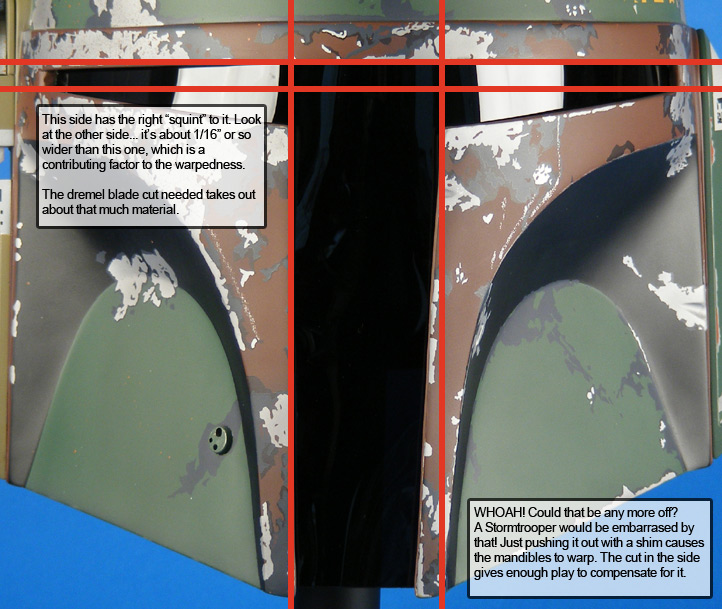

also note that the MR has a problem with the visor. you will need to do some work on it to make it look right... that work will involve anything from a heat gun to a dremel, so it's only for the brave and will destroy any collector value.
there are tons of great posts about it all around the board. this is a pic i did from my thread on the subject:

In hindsight I would have bought a helmet from one of the incredible artists on here but I found this site too late. I decided to "void the warranty" on my MR helmet and fix the pinch and add a new visor. Now when I see it everyday I'm very pleased with it sitting in the case. There are some more high end helmets and paint jobs out there that I'm in love with but I'm really happy with my MR now.

I agree TK7602 I was really worried about the silver coming off cause I ended up handling it more than I wanted too to correct the shape of the front. I kinda feel I was lucky none of the silver came off when I was exerting pressure for the jb weld. I treated it pretty gingerly though and kept it on a soft blanket while I worked on it and where ever possible I used a cut up t shirt to cover my fingertips while pushing on it.
Can you describe how you modded that mandible? Did you apply heat to help it move? Or just "brute force?" :)
I've seen someone else who used a heat gun or hair dryer to help bend it into the new shape after removing some of the small screws that hold the visor in.
