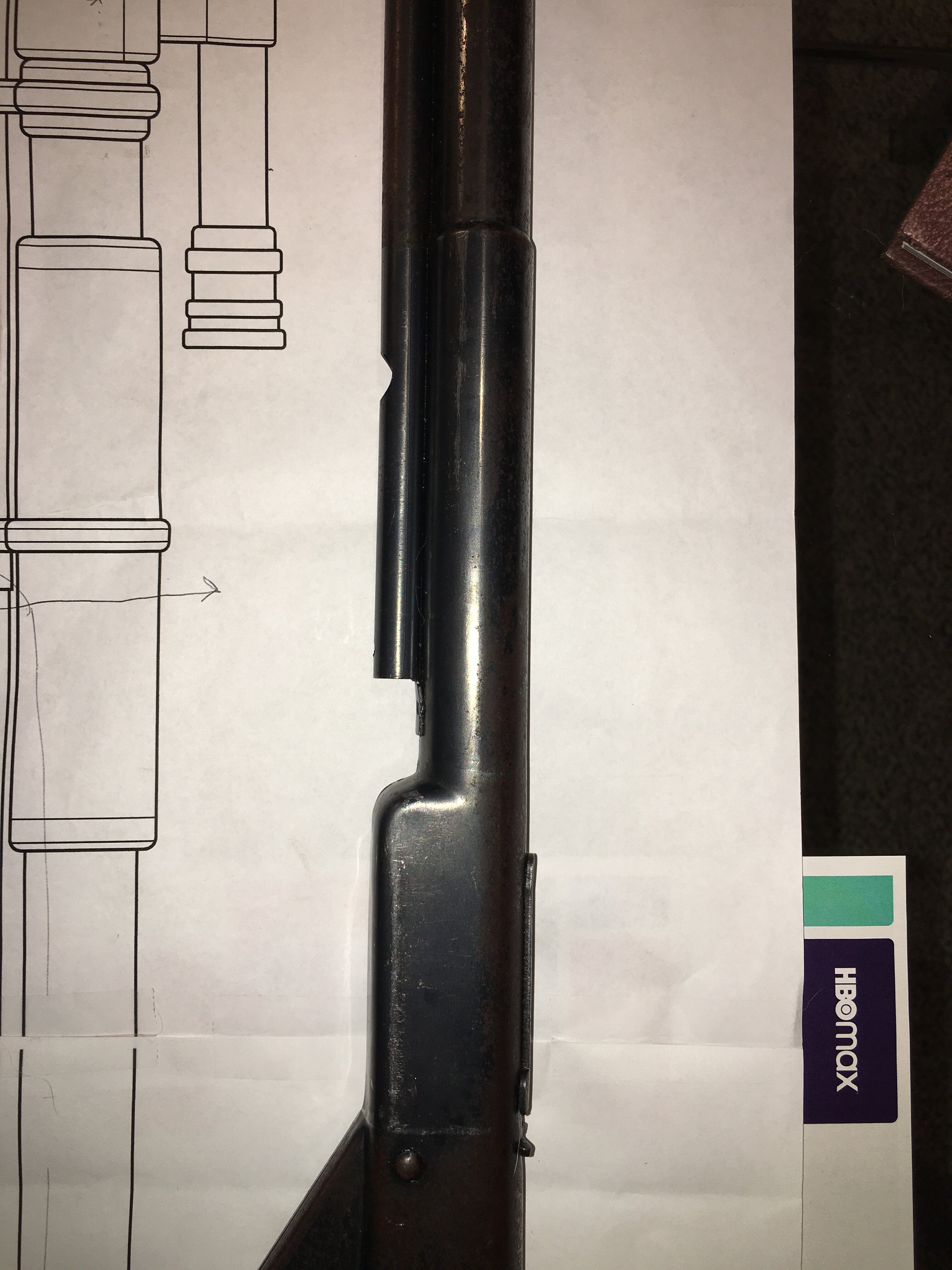

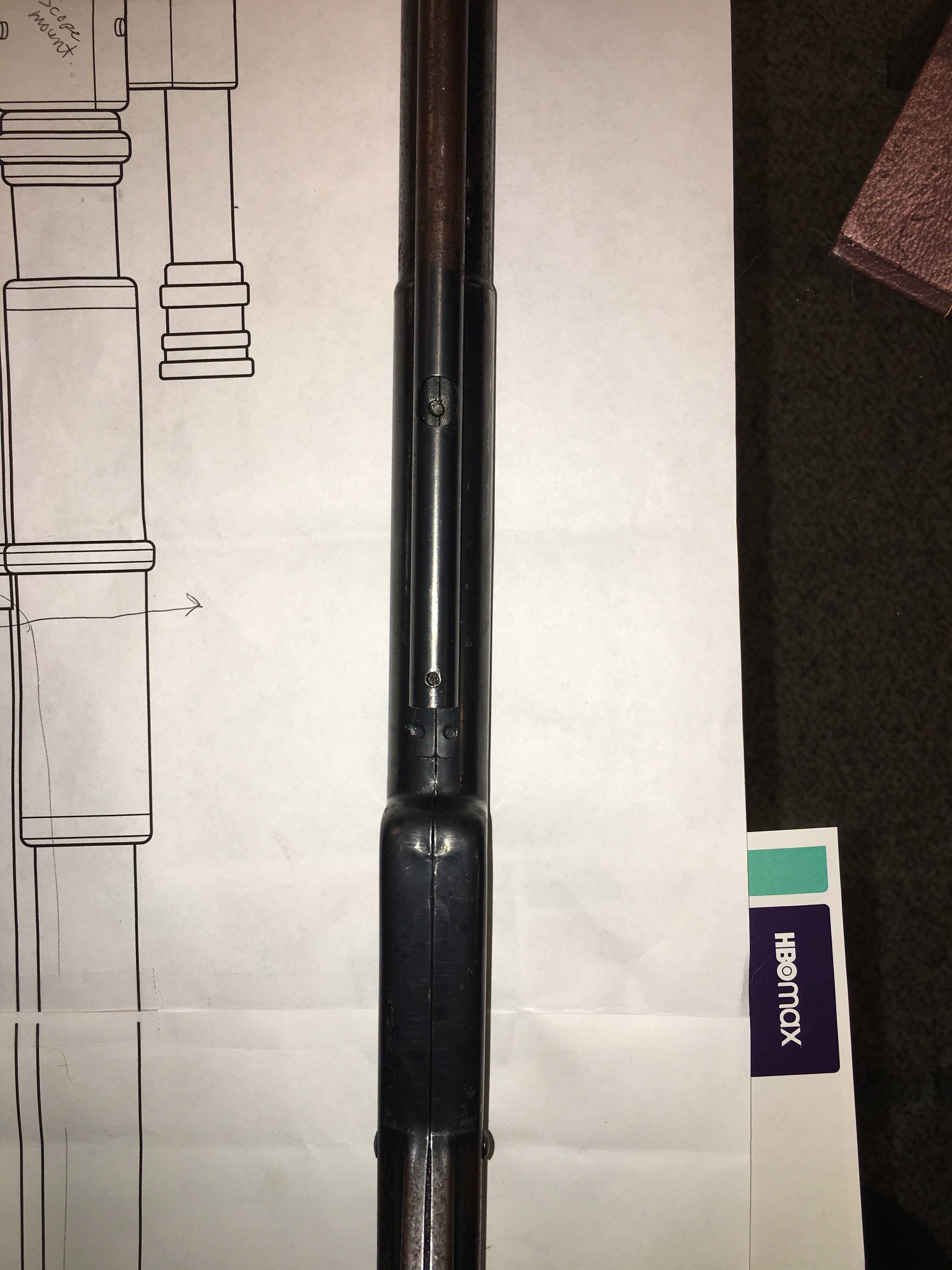

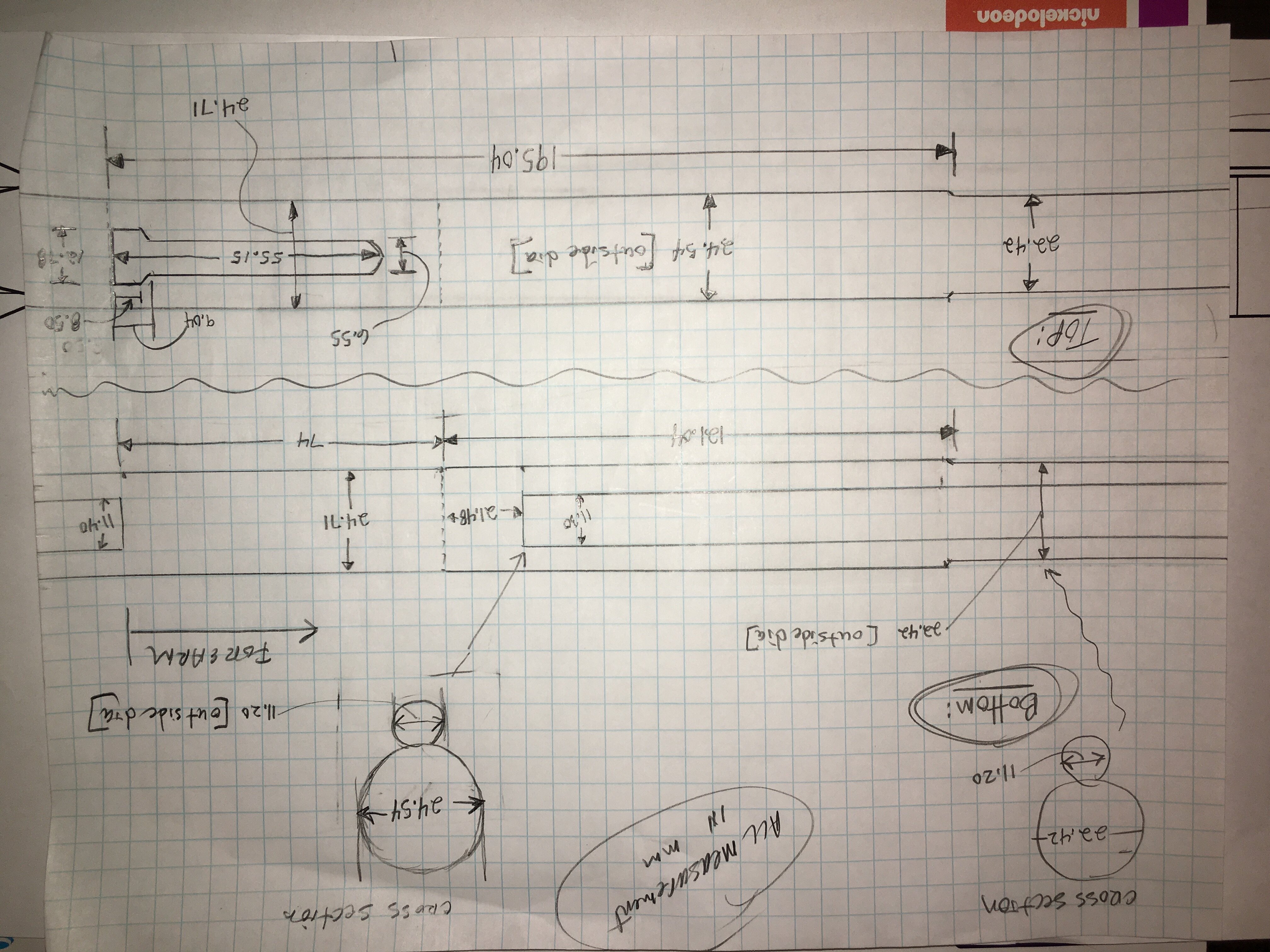

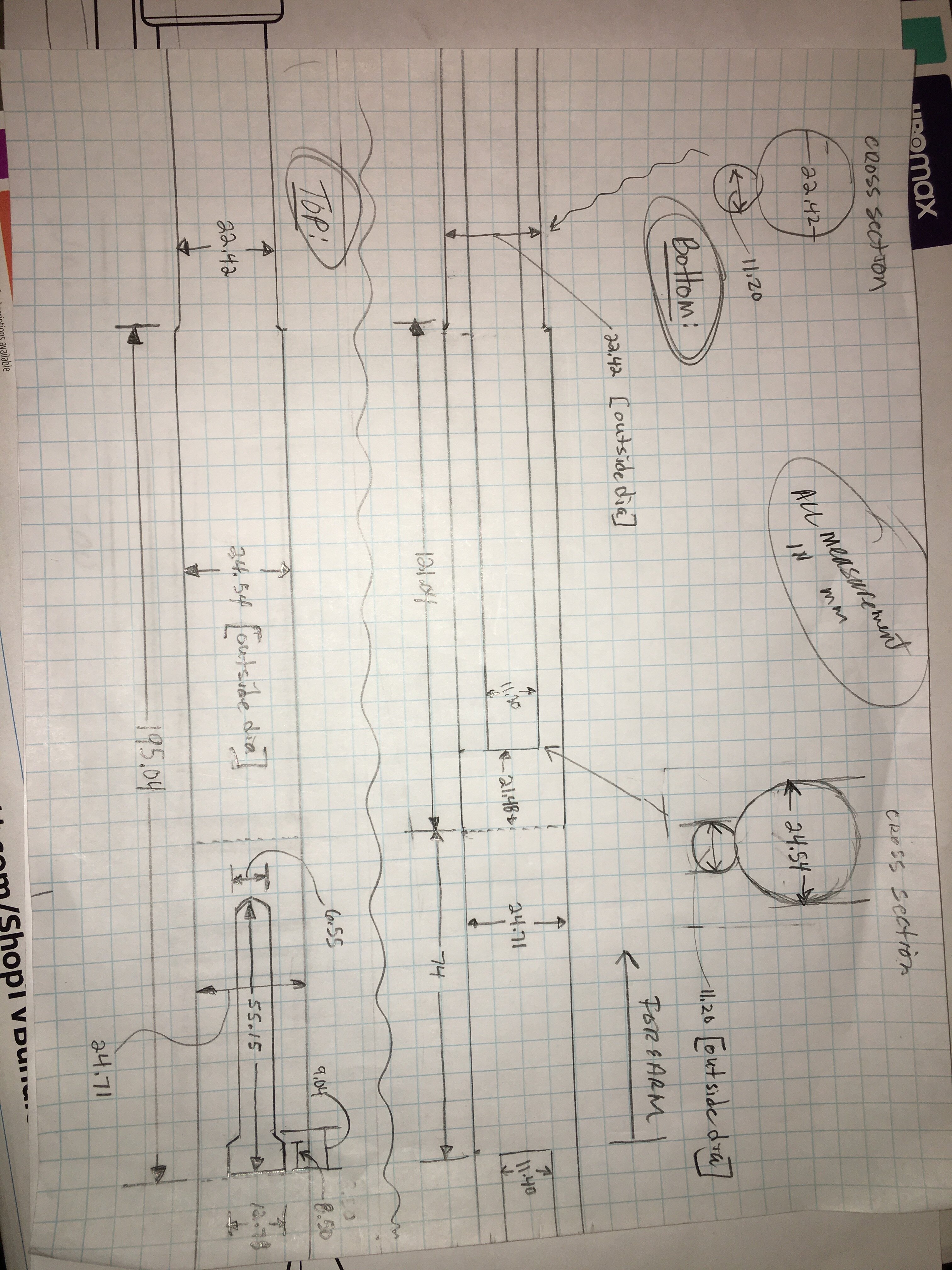

Please find the measurements/diagrams and photos - let me know if you need to FaceTime with me...
  • Daisy Measurements.pdf

In case the pdf does not work
Got your drawings, both PDF and JPG.

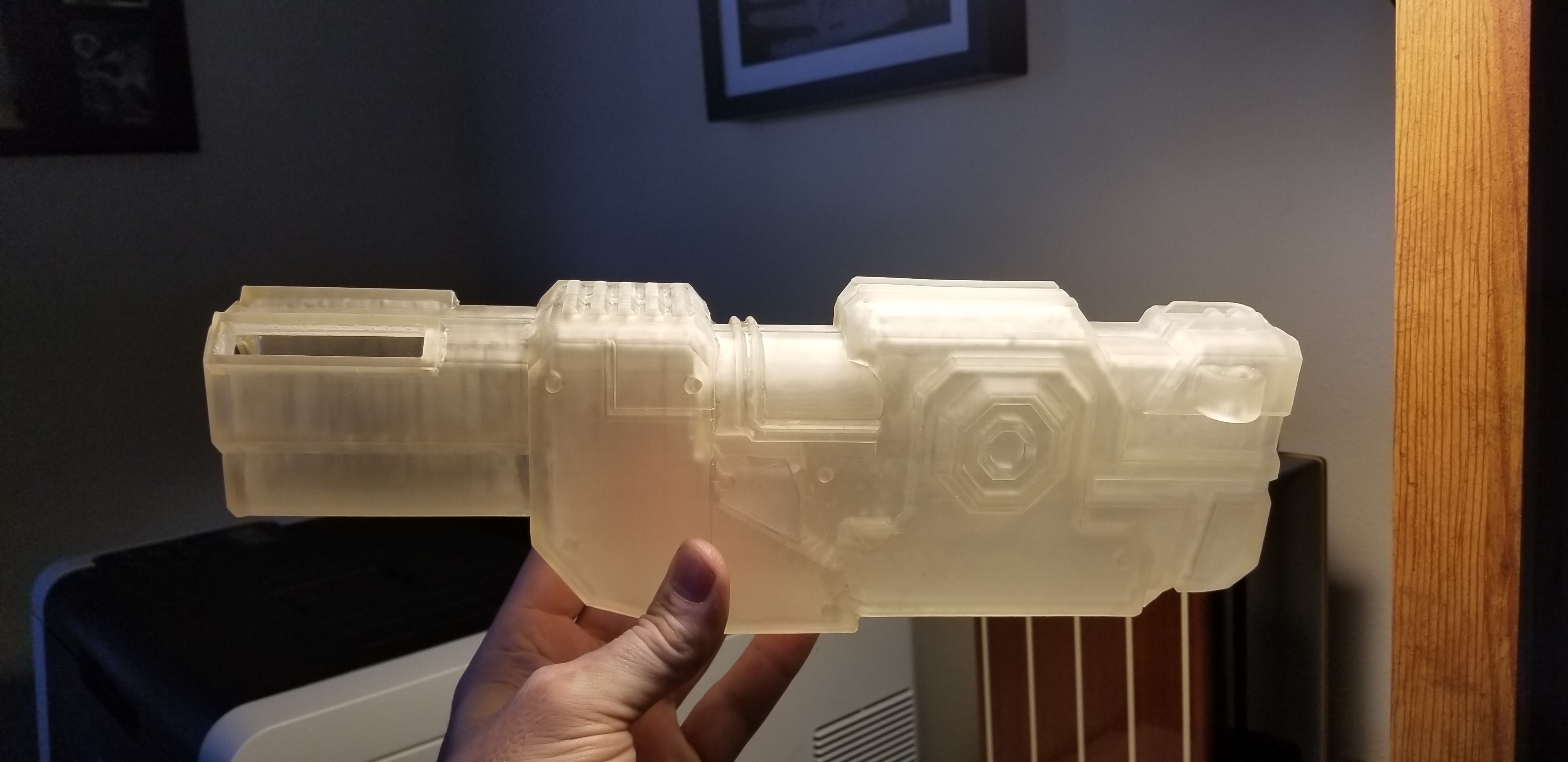

I modified this model to show what parts I believe you need. Note the model I have is slightly different than your drawing of the Mandalorian rifle. The main difference I see is the barrel. Yours is round and the one I found is a hexagon shape. I can print it with or without the end of the barrel if you want to use your round copper version and add or remove the scope too.
The plan would be for me to make a shell with 3mm wall thickness (in several pieces) of the Mandalorian rifle that is split it down the middle. You would then lay the pellet gun in the shell and use epoxy or some other resin to hold it in place. Then you would glue to two halves together around the pellet gun.
The fork tip would be 1 piece with a hole bored to allow the pallet to pass through.
If this is ok with you I will PM you a quote so we can get started.

After multiple phone calls, texts and zoom meetings Hirax and I worked out the details and I am beginning the 29 hour 3D print. I am doing a time laps of the print and will provide a link once it finishes.

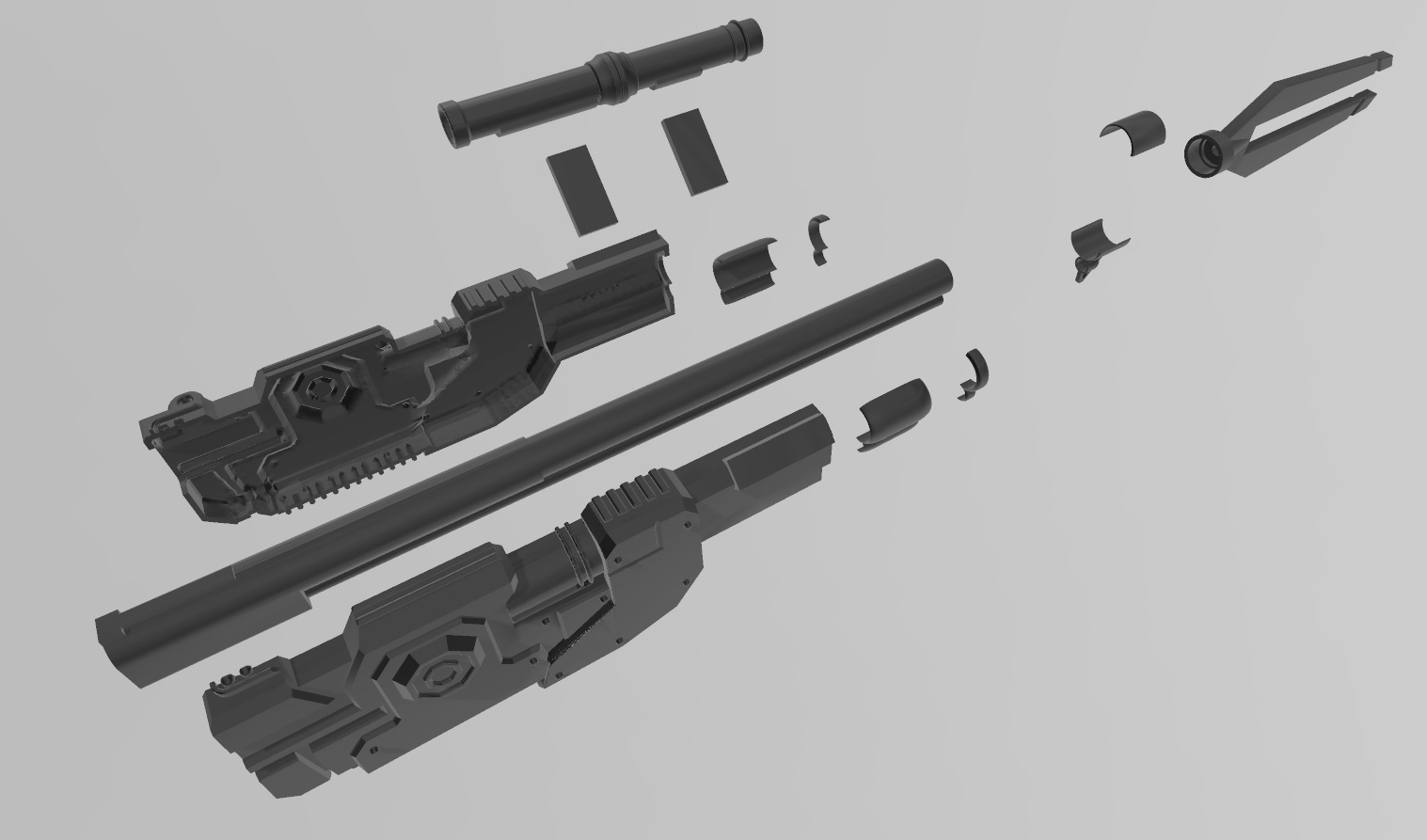

Here is an exploded view of what I am printing for him. The idea is that it is a shell that goes over a pellet gun and will resemble the Mandalorian rifle. The rifle in the model is just a place holder for sizing purposes.

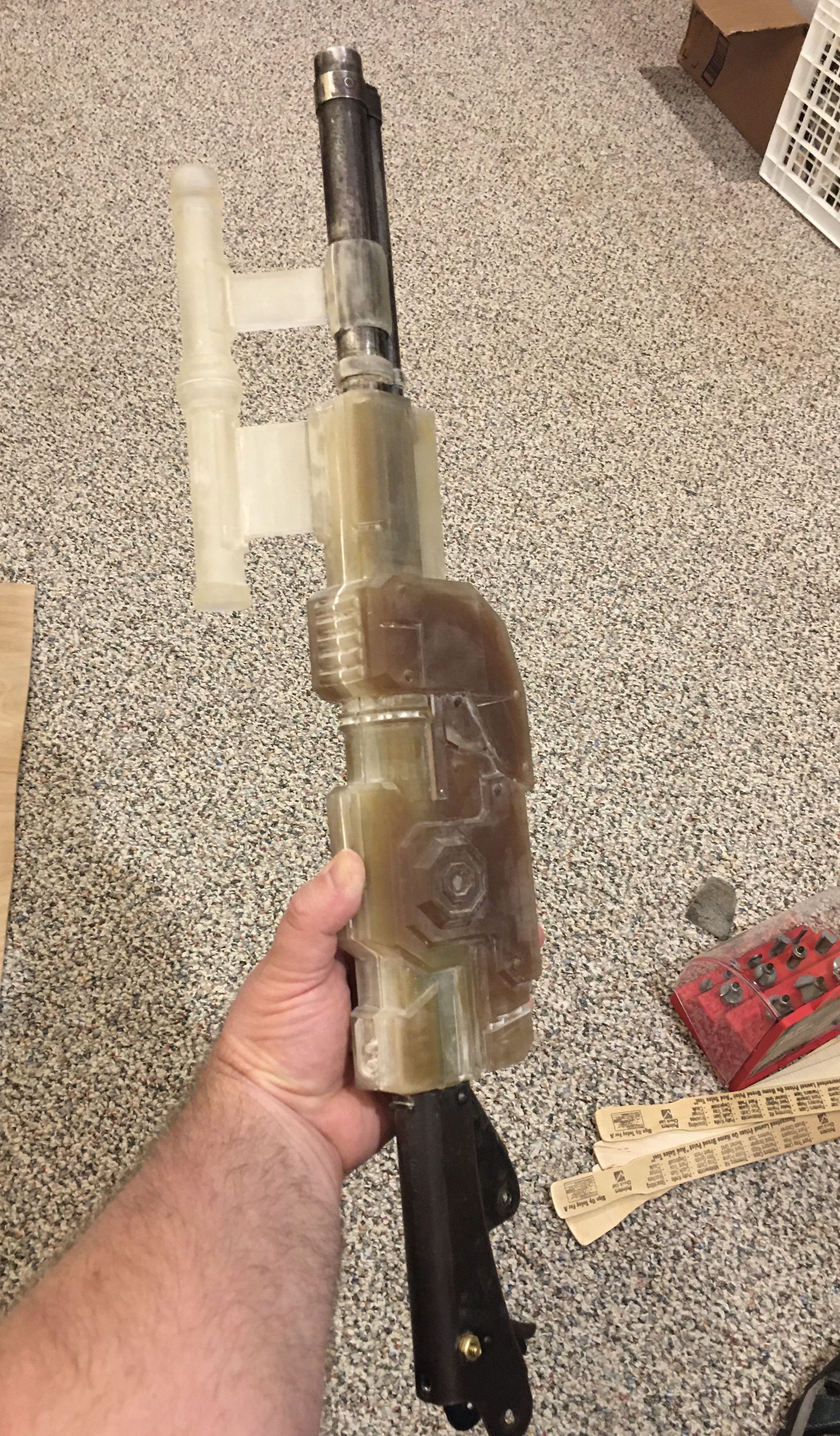

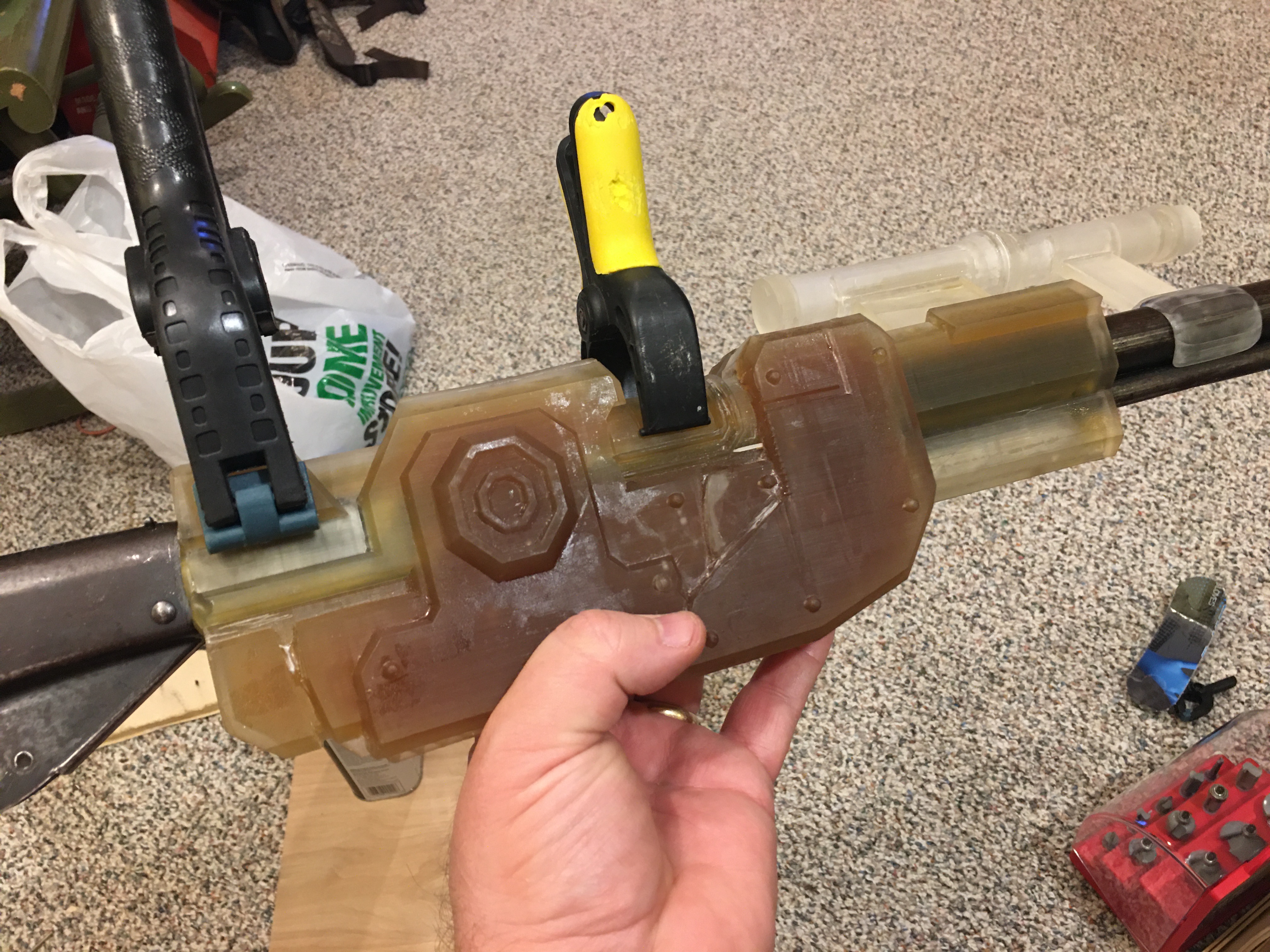

Rough fitting the awesome 3D parts modified to fit around the existing gun body and printed by Lazerjock to my Mandalorian Daisy Mod - lots of work to do yet but it’s coming together! Thanks a lot Lazerjock!
About 12 oz. of fiberglass resin, a few drops of super glue and a bit of elbow grease and I have a solid fusion of the forearm prints to the Daisy gun body.
