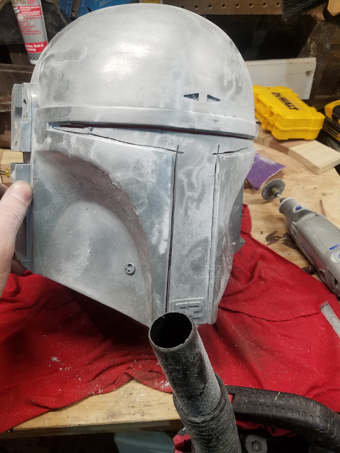

Not quite how it started but this is where I jumped the gun and started sanding and polishing before doing any work on it

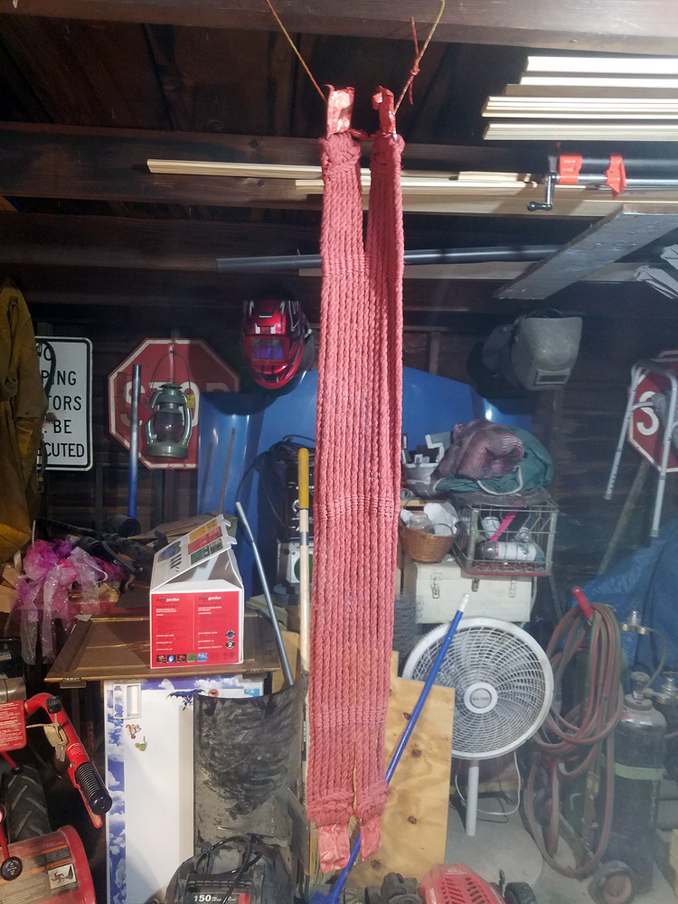

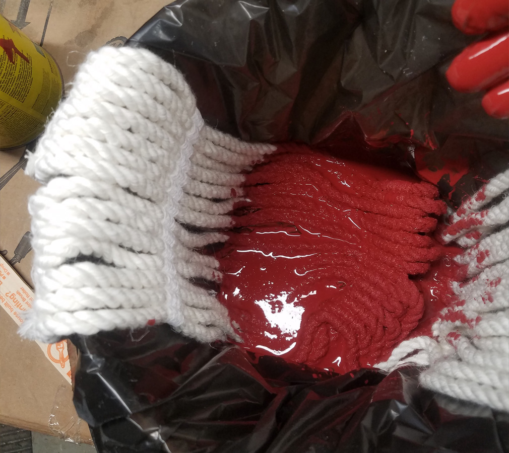

Ovation Centuar 40' mohair belt from amazon. I couldn't find the exact shade of red dye everyone was talking about and finally threw in the towel when I was at Menards back in April, settling for what they call "Tile Red". Looks close enough to me.

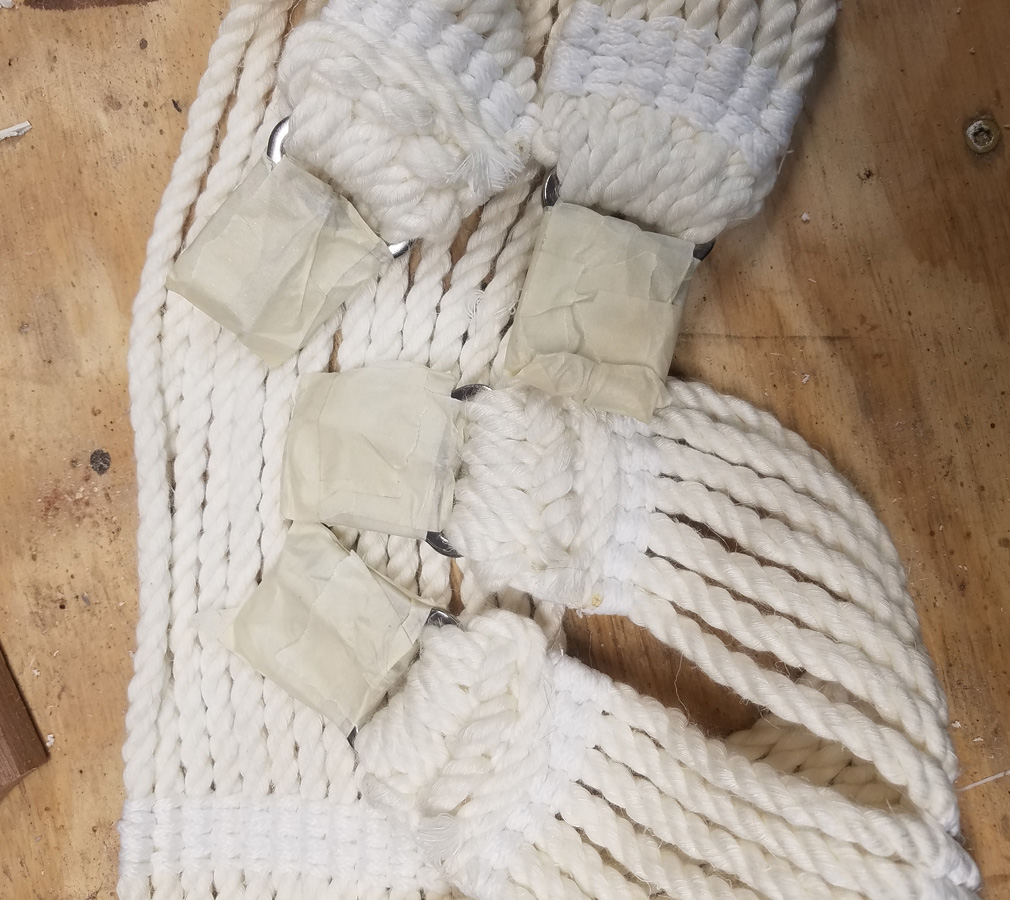

I wrapped the buckles in masking tape and drowned the entire belt in the dye with a garbage bag in a bucket. Kneaded it all together, wrung out the excess and hung it up to dry. I came back about two hours later and it was stiff like a baseball bat so I roughed it up in my hands until it was flexible and soft. Fits me just right around the waste, but maybe that isn't a good thing, I can't tell you how many gummy bears I ate when I was laid off during the lock down.

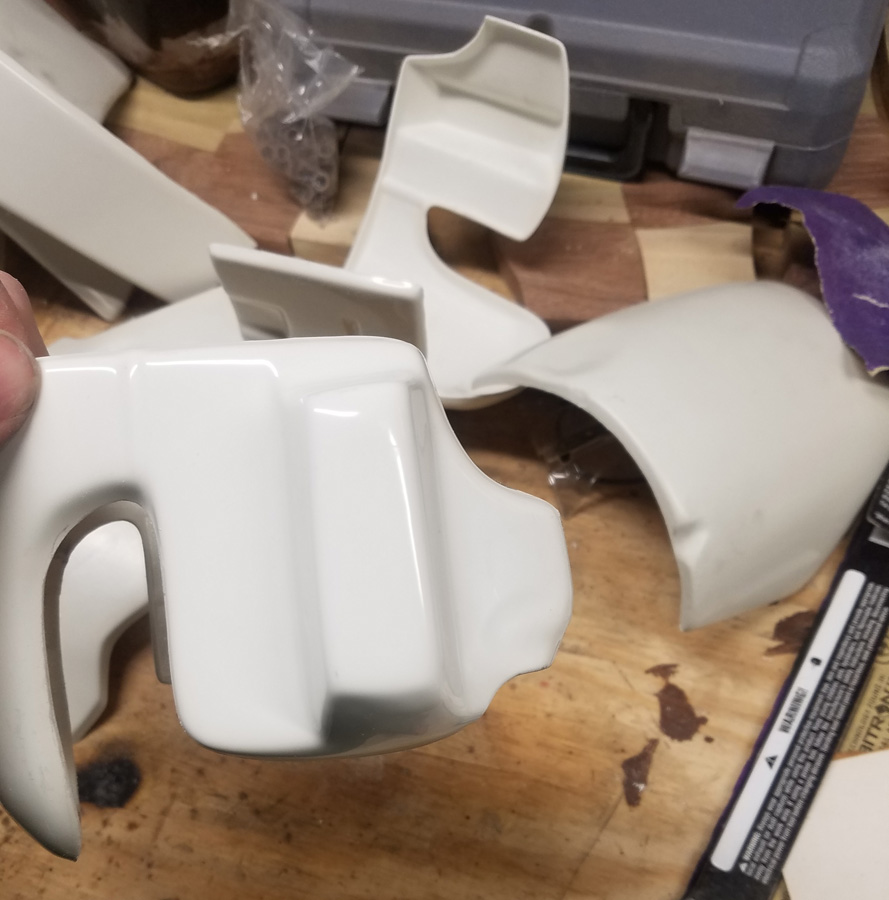

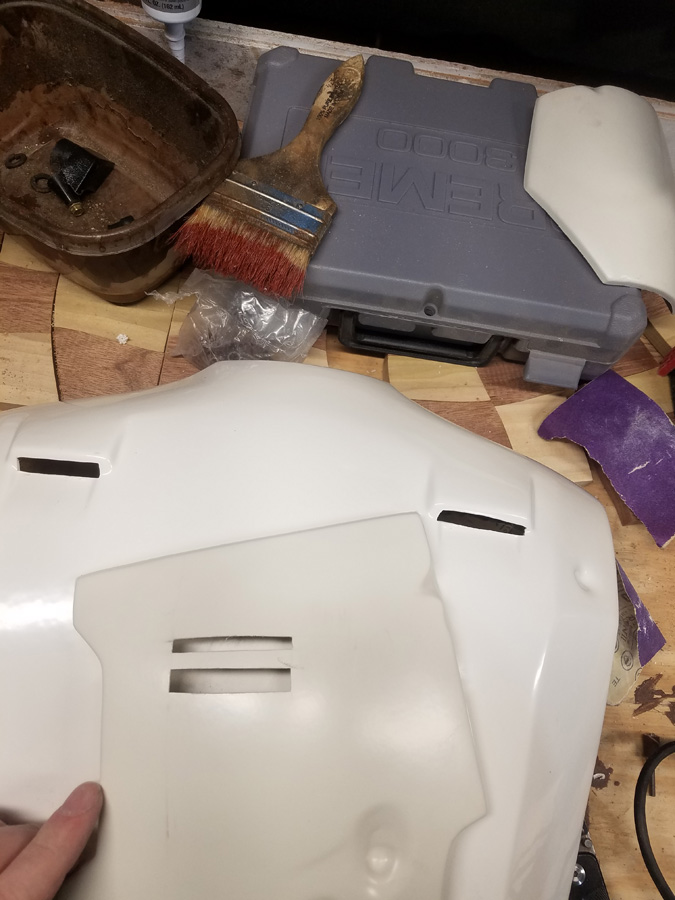

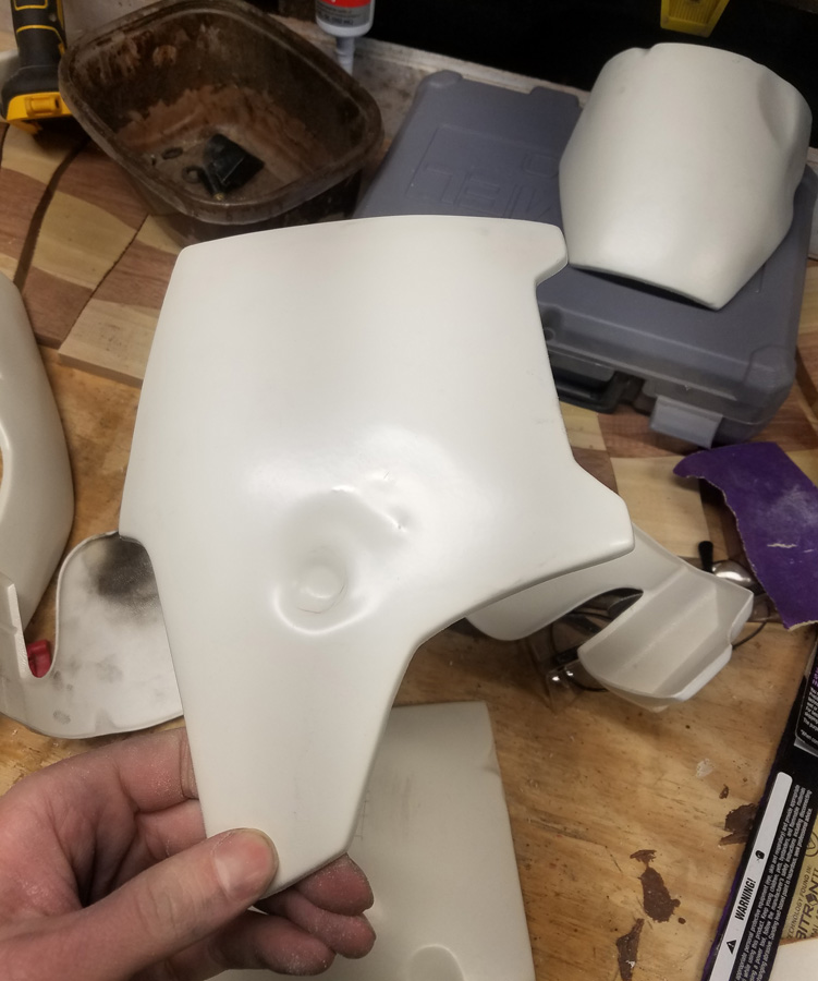

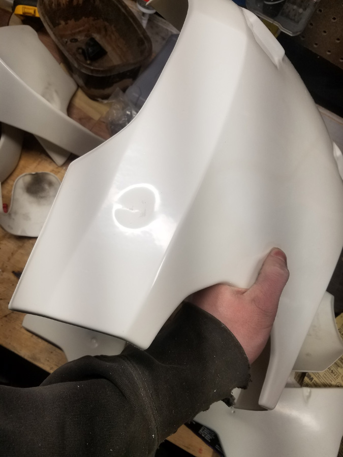

The armor pieces, I believe, are RS Propmaster. To add the RoTJ specific dents, I put a lighter to the armor and used a piece of clay to add an indent. I also added the notch to the left knee armor and cut out the slots for the chest display and jetpack harness straps.

It looks as though you have two right shoulders. An ESB and ROTJ. The left shoulder has no dents.
The armor came with three shoulders, I didn't pay attention to which one I threw into the picture.

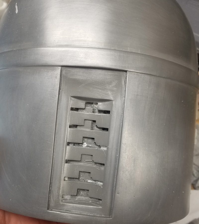

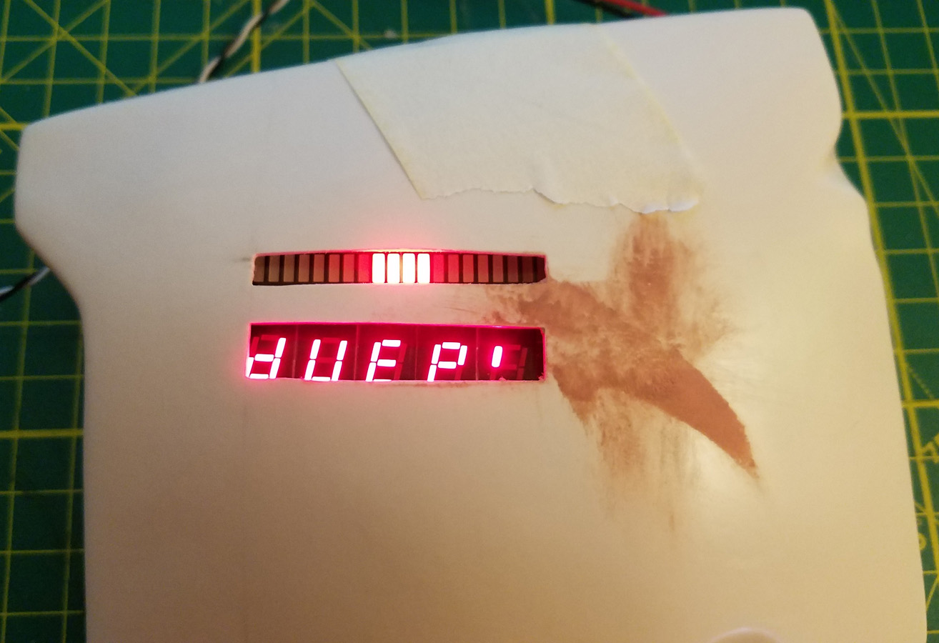

I played around with the chest display that I got from fettronics and noticed how big of a gap there is between the board and the armor. I'll have to look at more references. In an attempt to further sand the openings a bit wider, I got a case of the jimmy arms and put a gouge in the plastic.

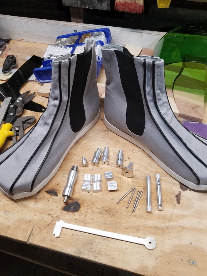

Imperial Boots aluminum fittings and size 48 boots. They're too small sadly, I need an extra 1/2 inch at least. I can probably manage a couple hours in them but...my toes might curl up like my grandmas. Also opened my Man Of War gauntlet box, lets get the party started.

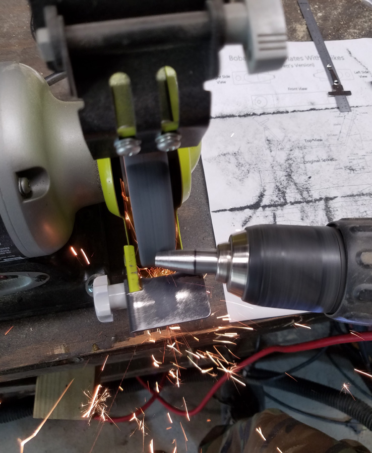

So I have a bunch of these huge pins in different sizes, not sure what they're for, some kind of keyway I'm assuming but they are the perfect shape for the spikes on the boots. After printing RafalFetts drawings, I measured the pins and then busted out the ole' grinder, put the pins in the drill and let her go.
After a little failure, sanding and polishing, this is what we come to.

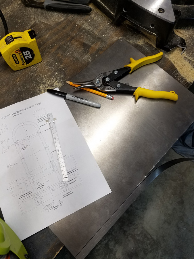

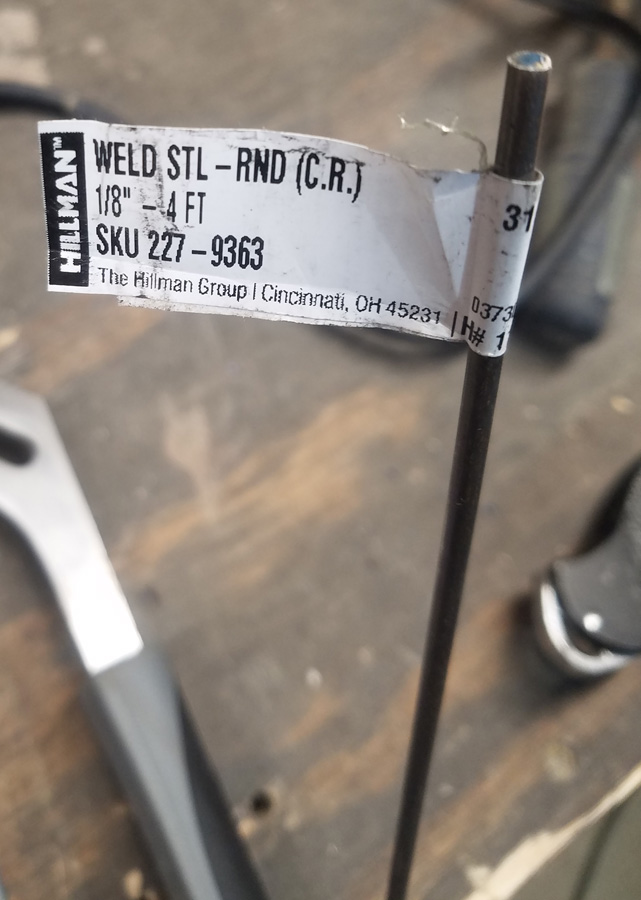

Here is my attempt at the jet pack harness rings and jet pack rail. I was running out of time but next time I'll start the frame and finish the middle strips of sheet metal. Ignore my garbage welding, I was trying not to burn through the rod.
The spikes aren't perfect, I know, but they will get the job done.

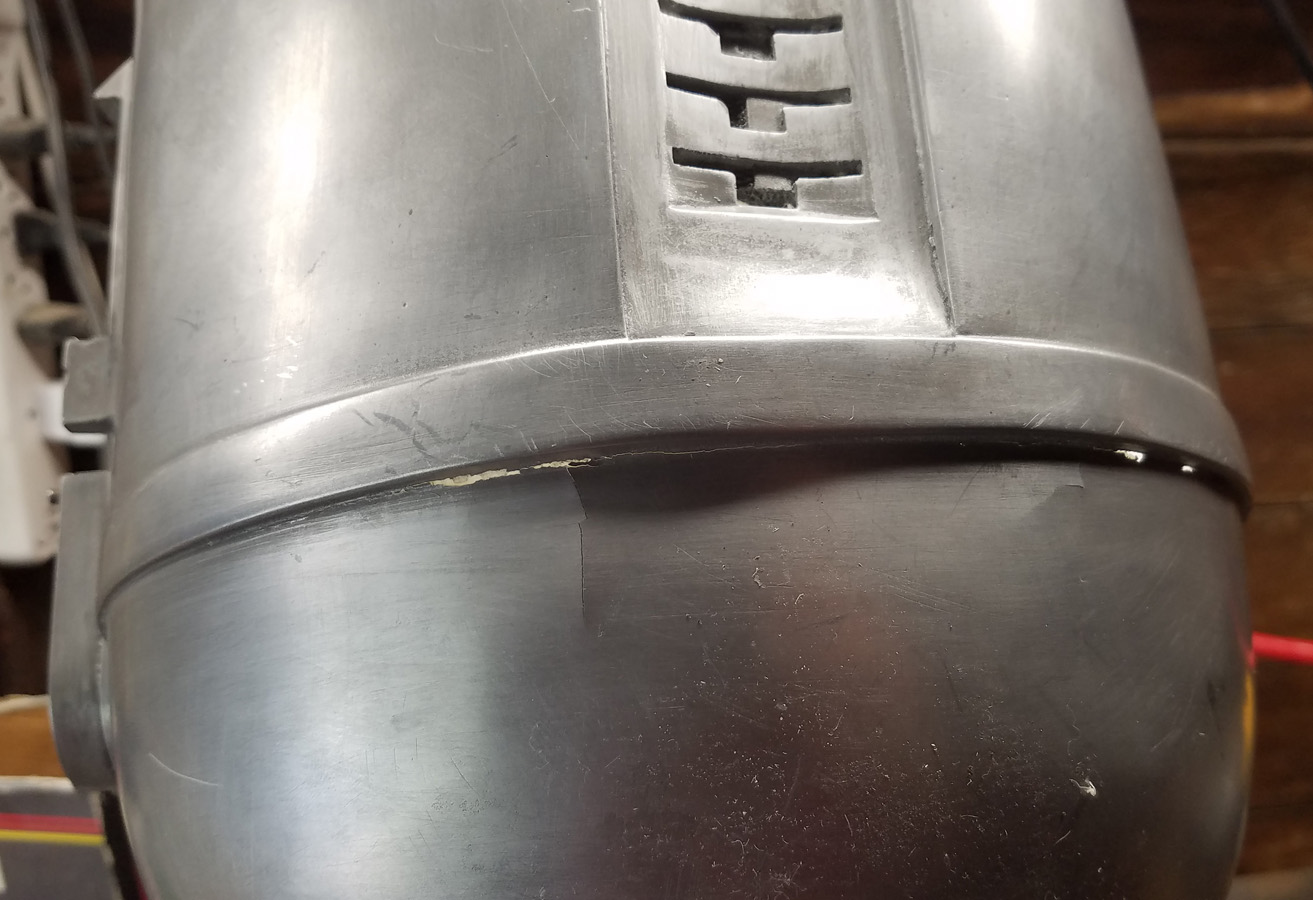

Here is the journey of this poor helmet....

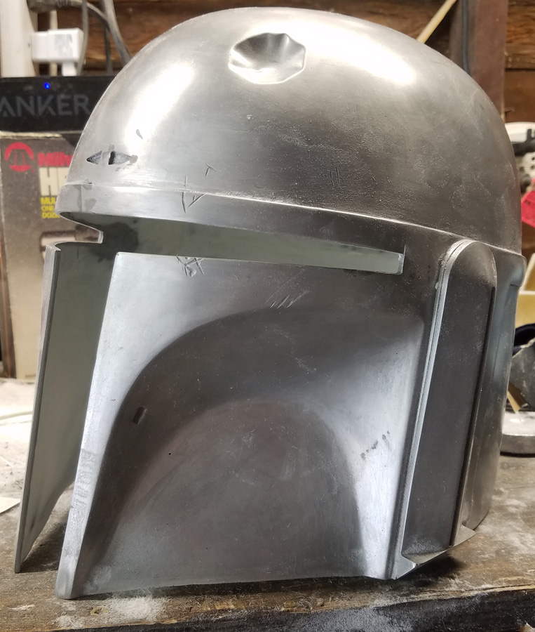

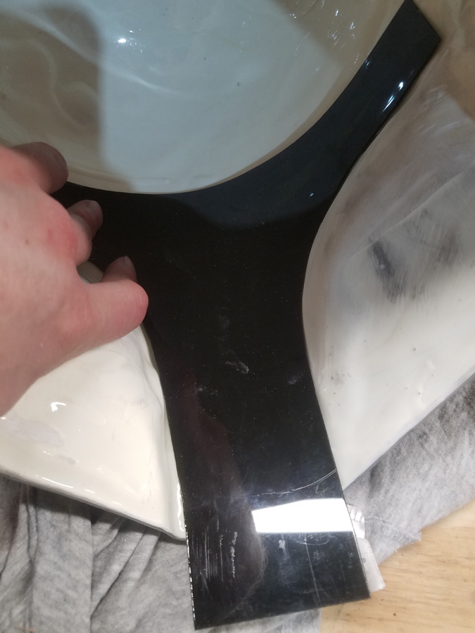

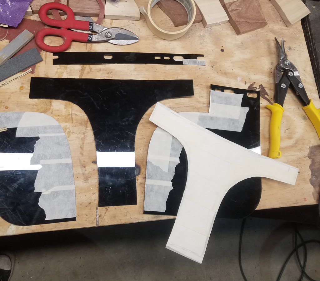

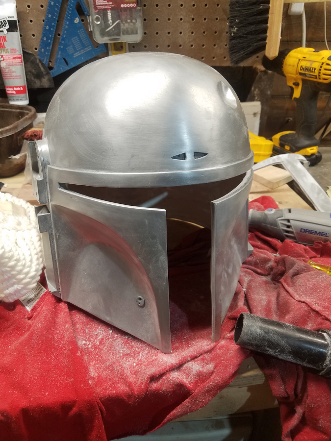

Started off with eagerness, sanding with larger grits of sandpaper until I got to fine steel wool and a semi polished look, I understand this should have been the last thing I did but the shininess gave me motivation, I'm a simple man . I cut out the T section and made a paper template for the visor, taped it to my face shield and cut it out.
Use a face mask, please. An N95 preferably, resin is no joke when it gets into your lungs. For added precaution I had my shop vac clamped near by and a fan blowing across me, directing the dust into the vac hose. Not perfect, but better than nothing.
Look at this handsome boy

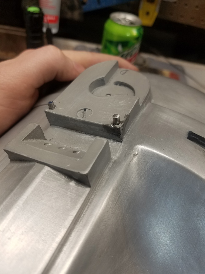

Added studs to keep the ear piece straight, the ones molded into the helmet were too shallow. I'll add a magnet when I set the stalk.

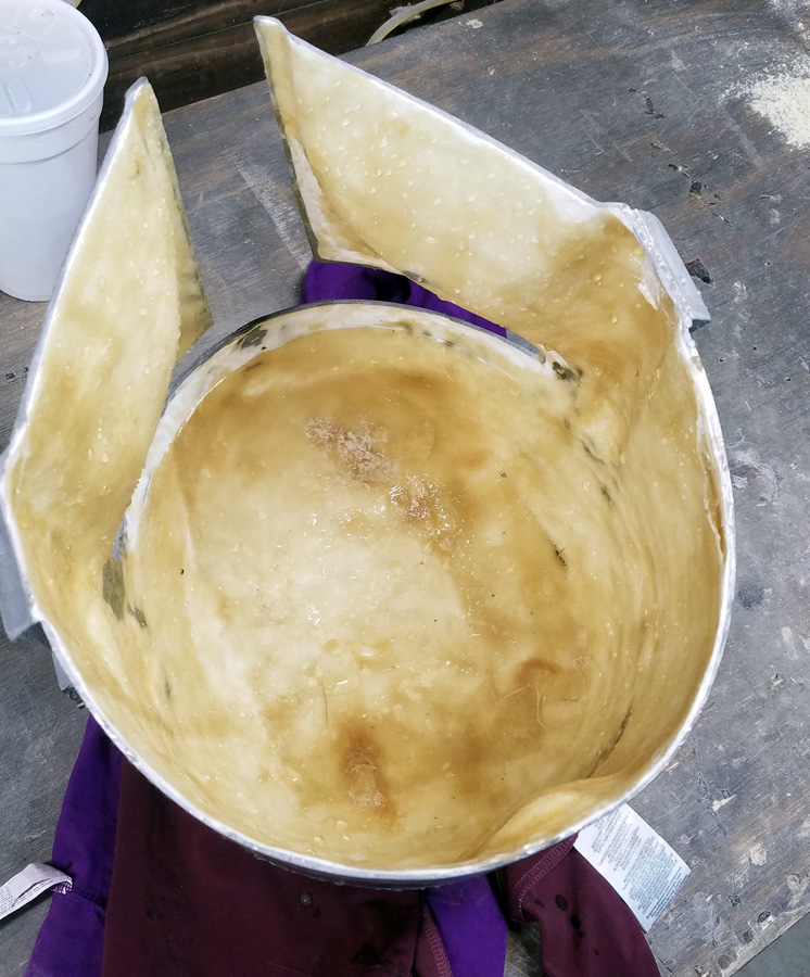

I dug myself deep, the only choice was to add fiberglass and resin. I'm not a professional and my patience became thinner than the helmet.

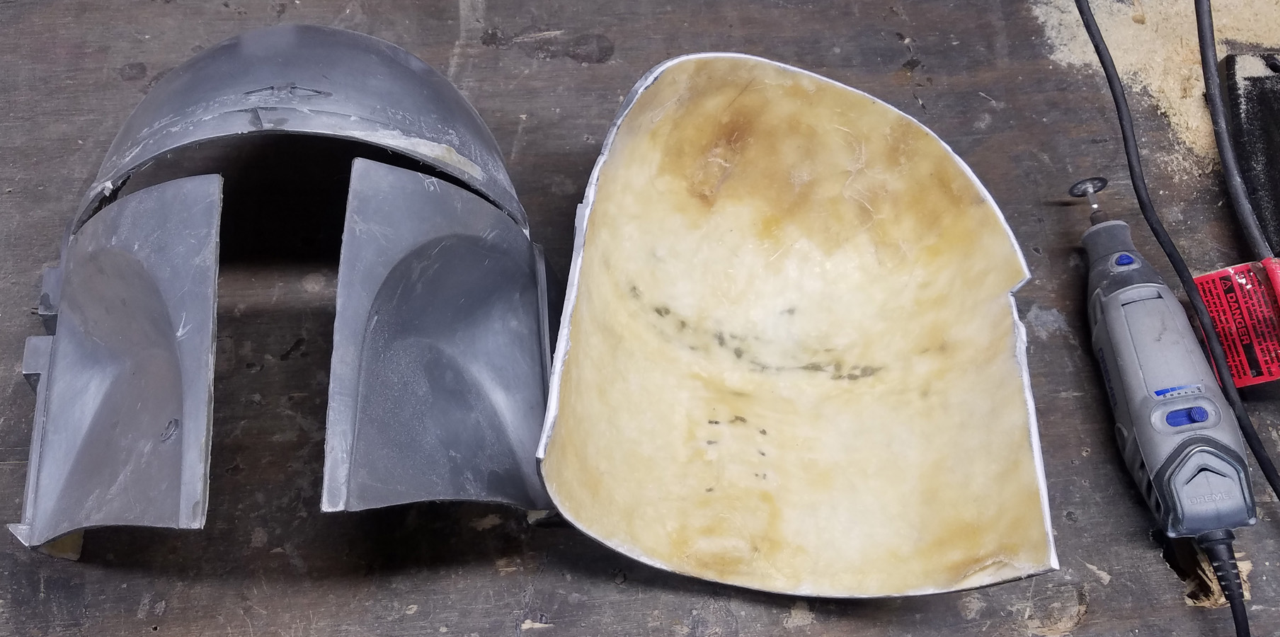

Some parts bubbled up and wouldn't stick, so I cut them off and hosed everything out. I put the helmet on and realized all that dremeling and sanding did almost nothing, I gained maybe 2mm extra tolerance after the fiberglass was laid. I'm too deep in it now, the only way is forward. I will wear this thing even if I have to be buried in it.

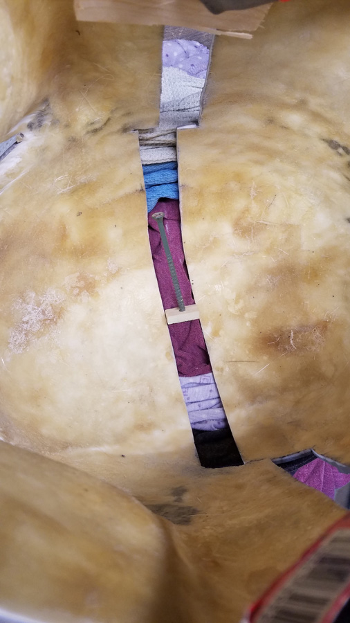

Like some back alley surgeon hired by a rogue agent to remove a lodged bullet, I drew some surgery lines and picked up my tools of destruction. My breath was heavy and my hand was shaky but it had to be done. My tools screamed and whirred as they dug into the resin, kicking smoke and dust into the air, catching the light from the dim bulb swinging above me. The rain from outside fell onto my garage roof like war drums, or perhaps, it was the heavy beating of my heart.
Thinking back to my stormtrooper helmet and all the fans, batteries and microphone electronics I needed, I figured I would need an extra inch of space. I cut small rectangles of wood an inch long and used them as spacers between the two halves. I taped them in place and used clamps to make sure the helmet didn't shift. Added a thin layer of resin and fiberglass to the inside.
Well guess what, the helmet shifted. I cut the new fiberglass only down the right side and put a small shim until the strip behind the ear lined up.
