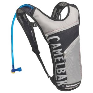

I have asked this question before and all I ever Got was stupid comments about MOW, or pay a hefty price for the scuba harness. I'll tell you what I did. I tried several options but ended up settling on a basic Camel-Pack. These things are padded all around and are extremely conformable. I don't have a picture of my harness, but basically I removed the water pack, and cut the outer canvas off so it was just shoulder straps and back. Then I sewed straps to the shoulders and attached an aluminum rod, I bought from lowes and bent myself, across the bottom with two screws, nuts and washers. Sewed my scuba belt to the bottom of the harness on each side. I have a MOW jet pack and if you didn't know, those things are over 15lbs. I can wear it all day no problem. This picture is the closest I can find of what I used.

Wow, I'm impressed! Genius idea for those who don't want an expensive accurate one.

I'm really interested in seeing pictures of your method! I haven't settled on the harness yet and that sounds like an option that I'd definitely like to take a look at.
In the big picture of Fett building , the scuba harness doesn’t have a “ hefty “ price. Especially if you are shooting for any level of accuracy. If you aren’t shooting for any level of accuracy cutting up a backpack will work as well or possibly bungee cords.
I work out of town but I'm going back this coming weekend, so if I can remember I will take pictures of it.
