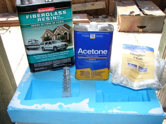

Okay over the next few weeks my friend is going to be helping me with some small projects in fiberglassing. Hopefully in the end i will be able to fiberglass some armor but im going to start off small by reinforceing my jason mask with Fiberglass.
Most people have told me i can get most of my stuff from Home Depot or lowes but i have no idea what to look four. If anybody can give me pics of what im looking for it would be apprecieated. (the actual fiber stuff, hardner and don't know the other thing..):)
Here's what you should be looking for. I got all this stuff at my local Home Depot, but Lowes should carry it as well. You can buy the resin in a smaller size like that of the acetone, but it may not be enough resin for larger projects. A tube of hardener will come with the small size of resin, and two tubes will come with the gallon size. There are two basic types of cloth you can get, weaved and matted. The weave kind is in the bag and behind it I put some of the matted. I like to use the weaved type if I want a thinner application with less resin used, or for making curves. It's just lays down cleaner in my opinion. You don't need the acetone for fiberglass work, but things will get sticky quickly so it's a good idea to have some for clean up, especially for your hands if you choose not to wear latex gloves. I don't wear any type of gloves so I go through plenty of Acetone. I usally buy it in the gallon size too, but they're all out in my area.
Also, be sure to work in a very well ventelated area because the fumes are very strong.
Let me know if I missed anything guys!
Cruzer

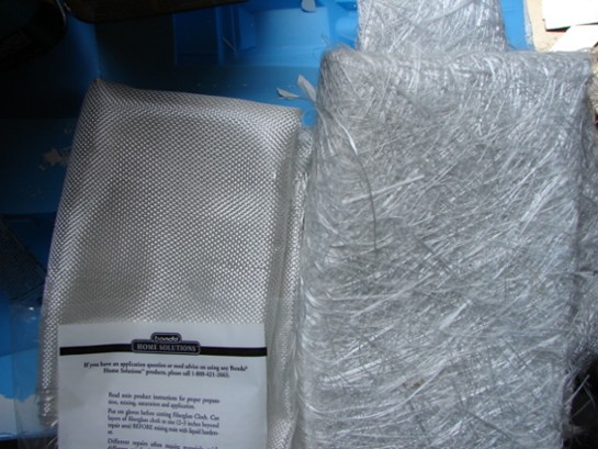

The differences in the cloths didn't show up in the pic so here's a better shot showing the differences and also a pic showing an example of the weaved used in an application.
Cruzer
Cloth is usually in bags for $4-5
Resin is usually $9-17 depending on size
and acetone depending on brand is anywhere from $4-16
-=QuinN!

The FG cloth and strand each have their own purposes. And of course, it's what you're most comfortable working with too.
But when one considers the shape and detail of the negative of their mold, FG cloth may not be the best for an application such as you gaunt shells.
Cloth cannot lay properly in detailed crevices within your mold, which forces you to "mud" up these areas with xtra resin to keep the air entrapment to a minimum. This leaves you with much thicker areas of resin build up, not as uniform. This can lead to excess exotherm (heat in the mold) in the areas that are overly "mudded". This can warp your gelcoat layer if is too thin, even if cured. Leaving you with a surface imperfection and possible warpage.
For a case like the gauntlet shells, it would be better, at least IMO, to consider the stranded FG. This can be tamped into these negative crevices much easier, with less resin build up in your "mud" layer. If you're using gelcoat, this will be your "mud" layer anyway. You're probably already aware by now, that more resin, does not mean a stronger piece. The ares that have too much build up, will be more susceptible to "cracking" when flexed, as well as "shattering" if dropped. As has already been said, using just enough resin to "wet out" you FG strand, or cloth will give the casting optimum strength.
I use cloth for many applications, but generally, for larger areas, with minimal detail. Stranded for more detailed applications, and a third ,"chopped", for hard to reach detailed areas respectively.

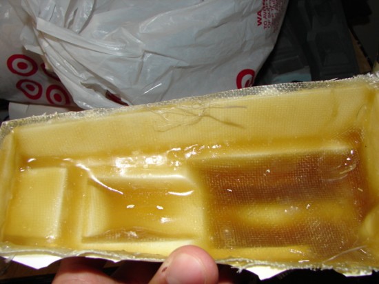

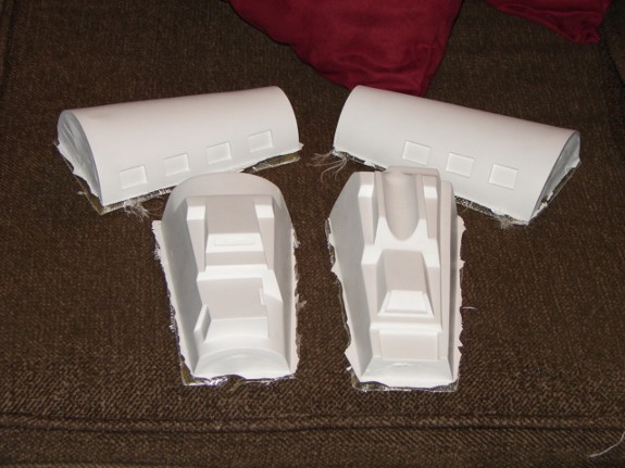

Sorry guys, just checked this thread again for the first time tonight.
Batninja and Evan, the mold is made out of silicone that's specially formulated for a movie prop shop in the L.A. area. They've recently worked on movies such as the Matrix's, Pirates of the Carribean's, and the Spiderman's. I don't think it can be bought, but I believe the closest stuff to it that can is the MoldRite25 silicone from Life-Casting.com. From their info on it, it seems to have similar high elasticity properties. Save your pennies though, one look at the prices and you'll know what I mean.
Fettpride, one of the head honchos there made that mold for the shells of my kid gauntlets and I've seen their mold room and it's loaded with all kinds of box molds like the one I have. So for smaller objects they seem to prefer box molds to shelled molds. They also make a lot of 2 piece molds so they have many box molds in permanent boxes. They buy this silicone by the truck load so they can allow themselves the extra silicone to make box molds. I consider myself very lucky that they made this mold and will be helping me to make the other molds for the smaller pieces to complete my kid sized gauntlet project. And hey when it's on the house...I'm not going to argue with how they want to make the molds.:lol:
Thanks for the tips. I did try casting these gauntlets with the matted cloth too and I prefered the way the weaved cloth laid down flatter with less resin used. To me, less resin means less weight and I don't want them to be heavy if kids are going to be wearing them. There is some flex in the sides with no cracking occuring and I like that because they're durable. I cut weaved cloth pieces for the three main surfaces with overlap and did mud up the nooks and crannies before hand to decrease bubbles and because I did notice it was difficult to get cloth in the crannies.
I think they turned out ok.

Heya bud, wasn't trying to step on your toes there. Was just trying to help you out. I had no way of knowing how advanced you are. I certainly didn't know you had pros making your molds either. For bigger biz, of course it's easier/faster to do molds this way, what's saved in time more than makes up for the excess rubber. For the little guy though, every red cent counts. Again, wasn't trying to step on your toes.
Cruzer said:
Thanks for the tips. I did try casting these gauntlets with the matted cloth too and I preferred the way the weaved cloth laid down flatter with less resin used. To me, less resin means less weight and I don't want them to be heavy if kids are going to be wearing them. There is some flex in the sides with no cracking occurring and I like that because they're durable. I cut weaved cloth pieces for the three main surfaces with overlap and did mud up the nooks and crannies before hand to decrease bubbles and because I did notice it was difficult to get cloth in the crannies.
Well, I did say that it's also about what your most comfortable with too.
But you may have missed my point. I was actually preaching "less resin" is better as well ;) Nevertheless, looks like you got it covered either way.
