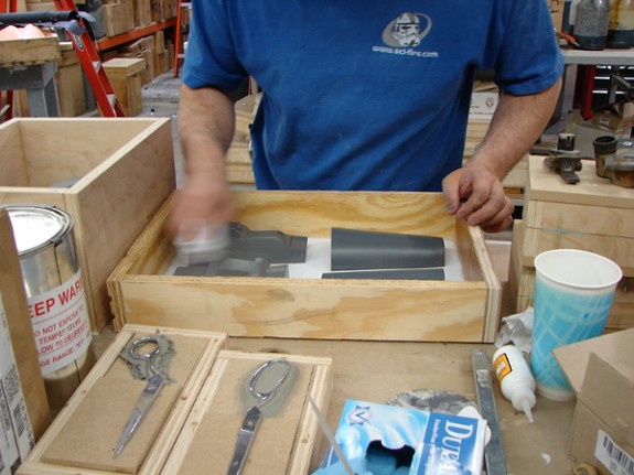

Oh, no way man, no toes stepped on here. I'm still new to all of this molding business. So I am a new guy when it comes to fg casting from molds. I just consider myself very lucky that some prop people took me under their wings and showed me how they did it. For the most part I just sat back and watched them work. But I would love to try molding a few pieces on my own one day, but your words ring very true...the silicone is just too dang expensive for those of us not in the industry buying it by the barrelfulls.:lol: And yeah, I'm sure they make up for the ample use of silicone big time doing those big blockbuster movies and gett'n paid.;) In the pic you can see just a hint of the molds stacked up in the back.
