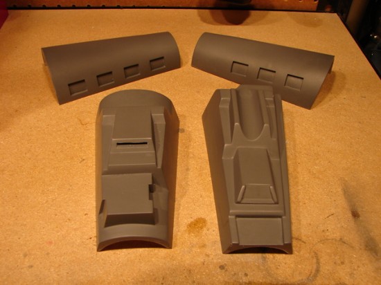

Ok, here are some updated pics of the project. The Boba style flamethrower, ripcord housing, and right gauntlet hose attachment(have no idea what it's called) will hopefully be molded up this weekend and ready for making resin casts asap. I was satisfied with how well those three pieces turned out and forgot to take pics of two of them, but trust me they look really good and to scale with the rest of the gauntlets.
1st pic is of the finished masters

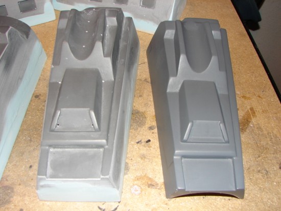

2nd pic is of the...well you know
3rd pic is of the "bucks" casted from the mold of the main pieces and used
for some vacform test runs we did this past weekend.
4th pic is of vacform prototypes using 1/16" styrene for the pair on the
left; and 1/8" styrene for the pair on the right. Noticed the difference
in detail between the two pair.
I don't like the way the vacform turned out using 1/16" because they are too flimsy, and the 1/8" stuff is nice and thick but too much detail is lost.
