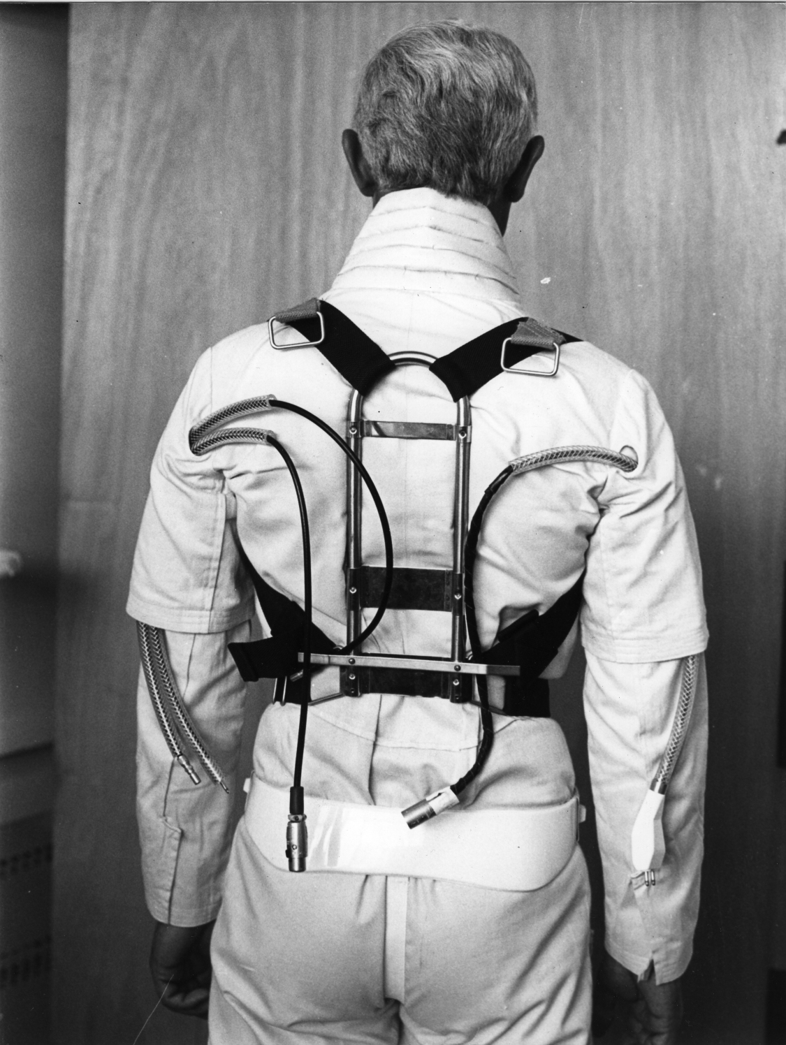

So after watching the infamous test video of the super trooper, i have been intrigued by the smoke system in the jetpack with a trigger in the gauntlet. Does anyone know how this was accomplished for the video? This is the only pic i have to work with currently (taken from RF''s 40 stages thread) : Super Trooper Dressing (Back).jpeg
Does anyone know how this system would have worked??
