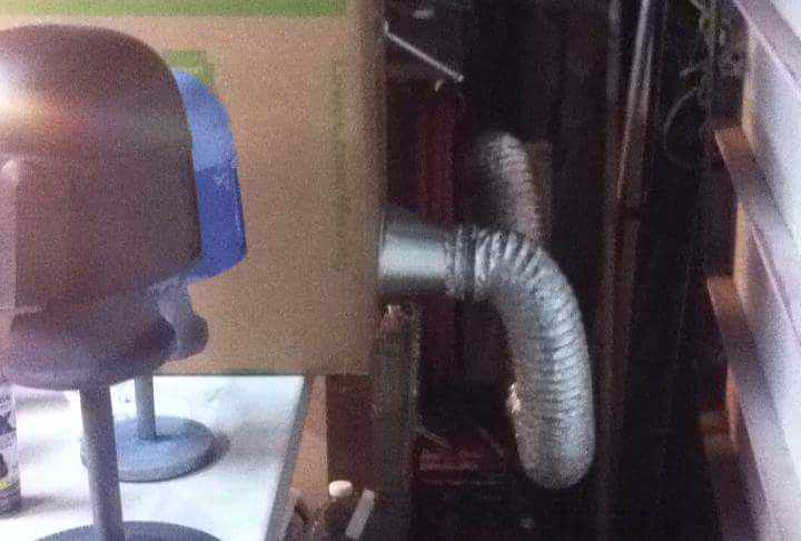

Nothing great to look at but this is basically it

1. Tape up the bottom half of your large box

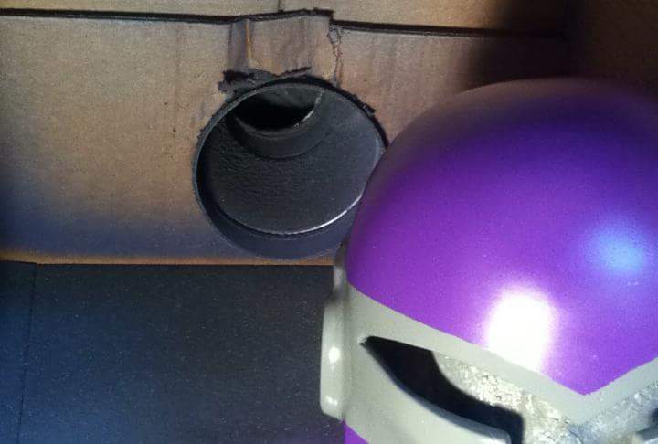

2. Then flip it upright and cut out a large whole in the back of your box for your heater hose to fit through. Try to keep this hole I bit tight to help hold the hose in place and to keep it as air tight as possible.
3. Next push your heater hose through the hole about an inch or so and then apply duct tape from the inside of the hose out and onto the box. This should create an nice air tight connection.
4. Next place your spray booth / box next to or close to one of your garage air vents.
5. I placed my spray booth on a table close to the air vent with the least amount of junk around it.
6. At this point you will need to rig your heater hose to the fan you’re going use. I was able to attach my hose to the fan with screws but duct tape could work just fine.
7. Now place your fan with hose attached at the vent, I stacked stuff up to hold my fan in place. You could use anything you have available.
8. Ok now place your floor heater in front of and just below your box and turn it on high.
9. I placed a cheap plastic lazy Susan in my booth to turn my parts around as needed.
10. Now turn on your fan and heater.
11. Place the item being painted and paints to be used in the spray booth. Let it all heat up for about five minutes or so then you’re ready to start painting
With the heat rising up then getting pulled past what your painting, your temperature problem is solved and as you paint, all of the fumes and overspray gets pulled to the back of the paint booth and out of your garage. Depending on your situation, you could add a filter to catch your overspray but that’s up to you.Hope this keeps you working during these cold months, don’t let the cold stop you.
