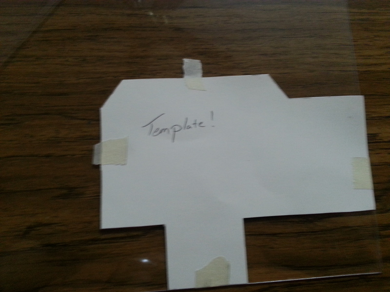

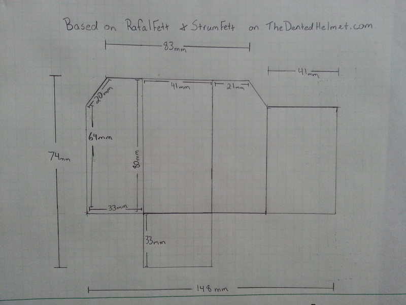

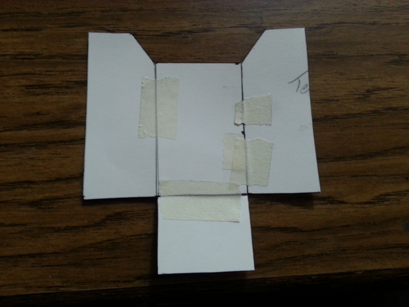

Step 1: Make the Template: Thanks to Rafal and Batninja and Strum these are always available out there.
Step 2: Transfer Template to poster board it is much easier to use and not destroy

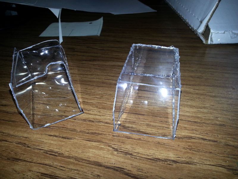

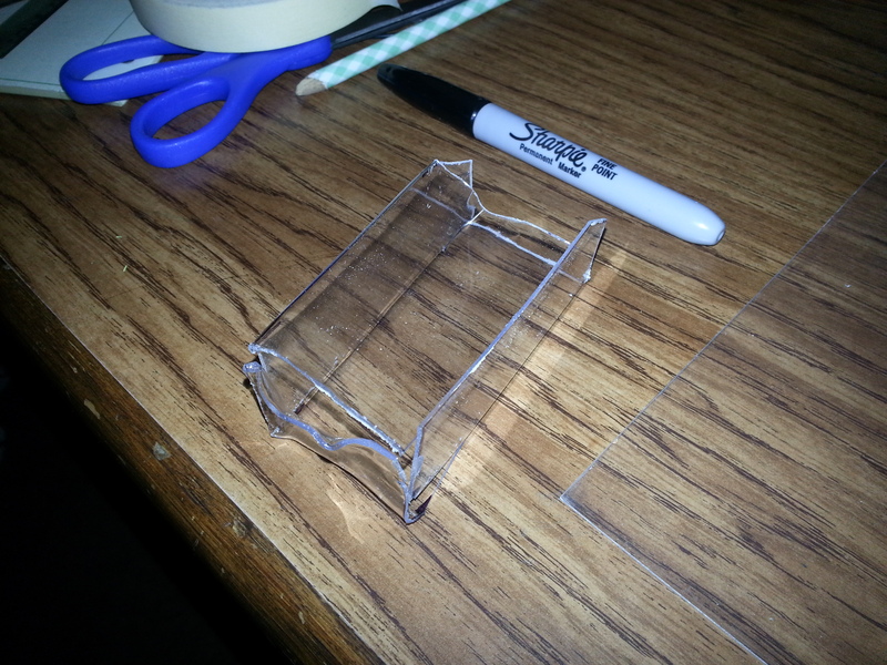

Step 4: (Should be skipped to Step 5) Heat and Bend into shape (this did not work)
- I originally tried to do one piece and heat it and bend it. Perhaps with more patience I could have but the results were less than stellar

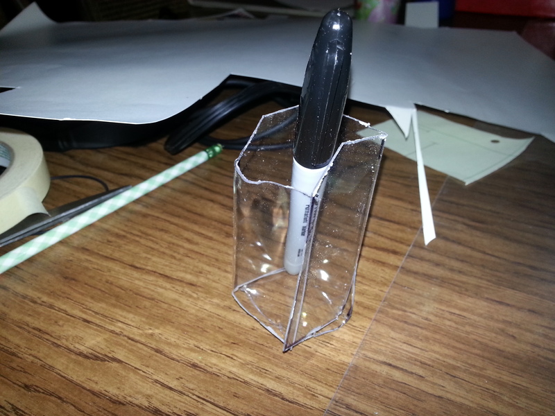

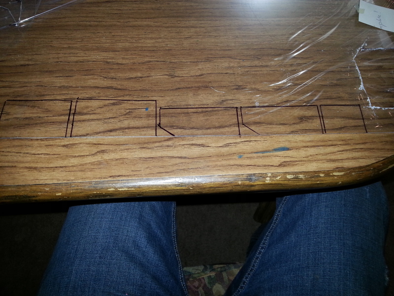

Step 5: Change template from 1 piece into 5 separate pieces
Step 6: Transfer those onto plastic sheet

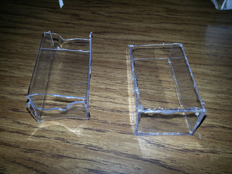

Step 7: Cut out. I am still going to attempt this with polypropylene sheets but with this plastic sheet from Hobby Lobby it cannot be cut with scissors or it will splinter and crack!

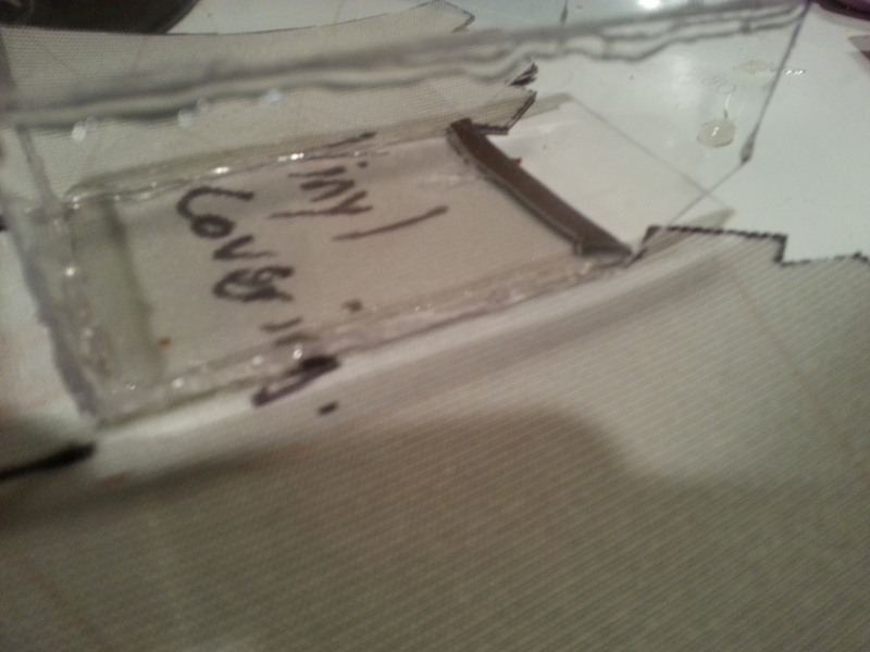

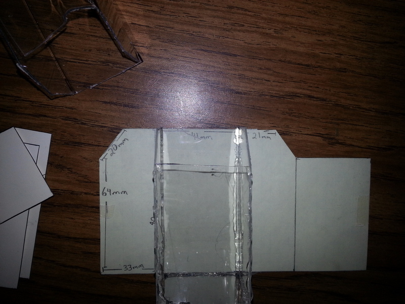

Step 8: Hot glue pieces together, and compare to failed prototype, and to template. I would say very close!

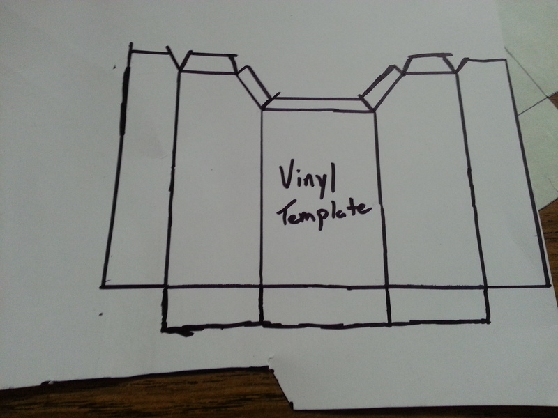

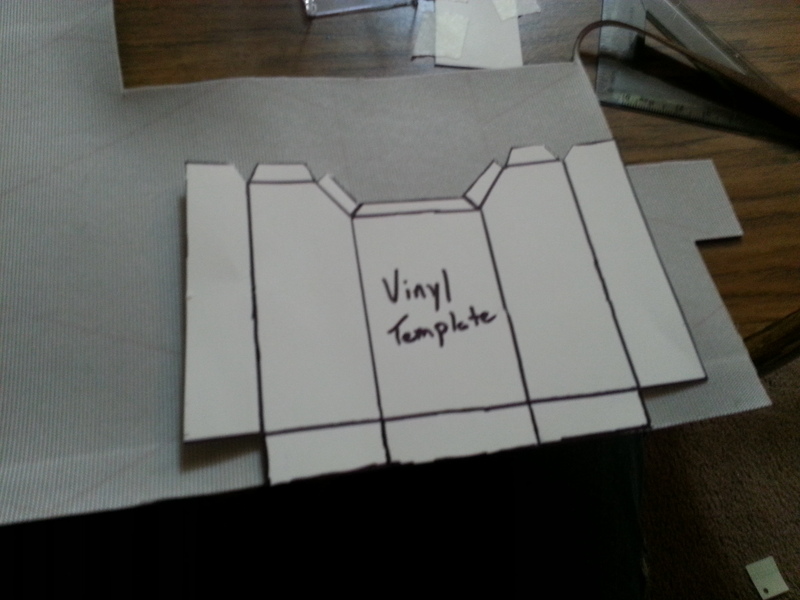

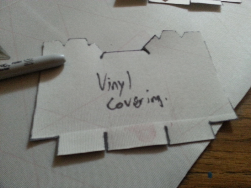

Step 8: Turn old template into a new template for the vinvyl.
- I ended up not using the bottom tab piece
- I added about 20mm to the bottom edge and back edges
- I added about 10mm to the pieces getting folded into the pouch

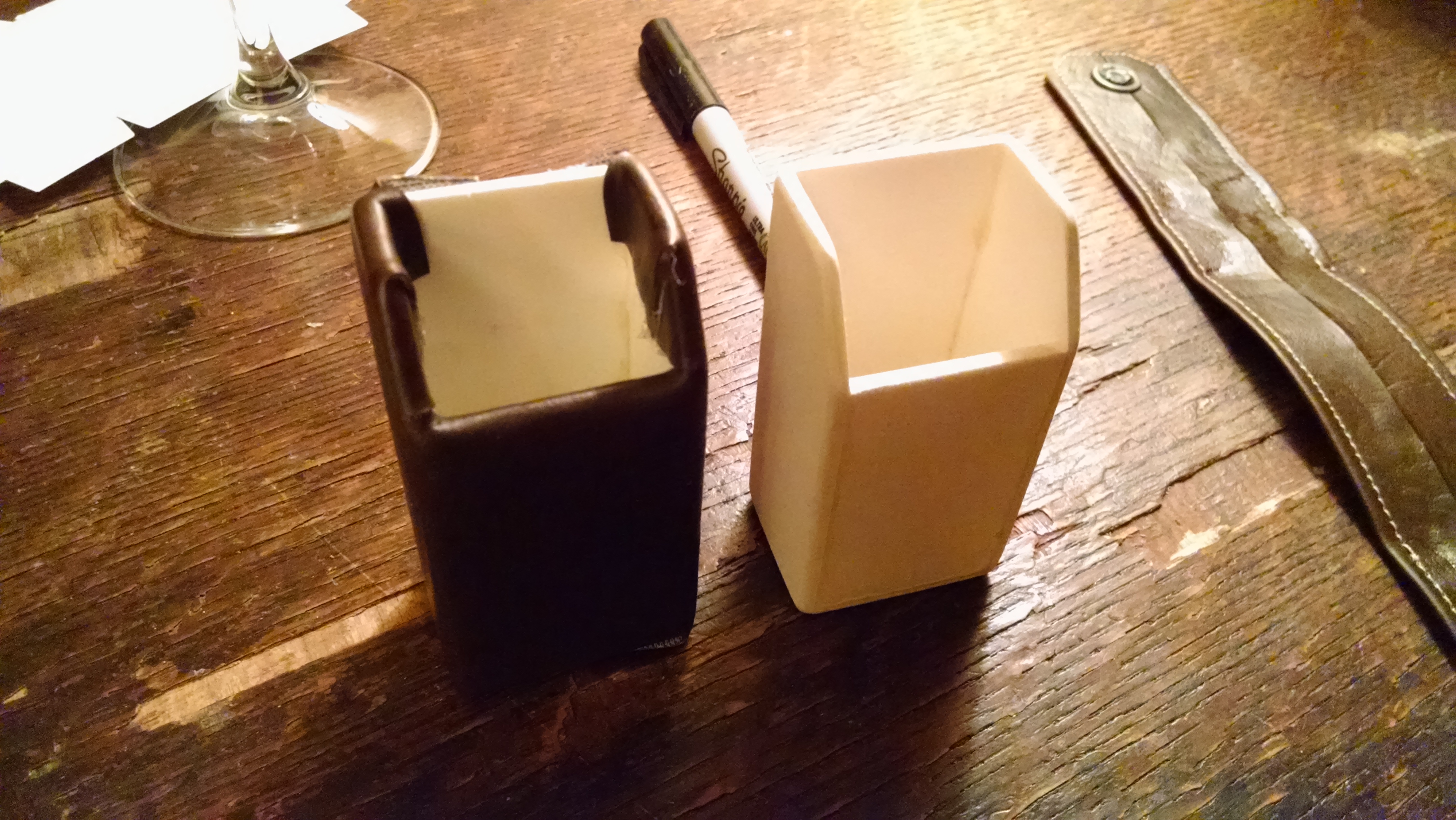

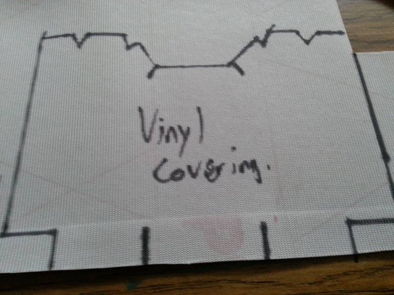

Step 9: Cut out the template, trace onto vinyl, cut out vinyl

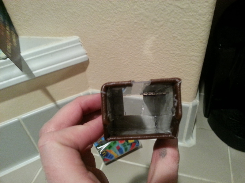

Step 10: Glue to "pouch"
- I started at the center section and folded how I thought appropriate I will leave it up to you to figure it out

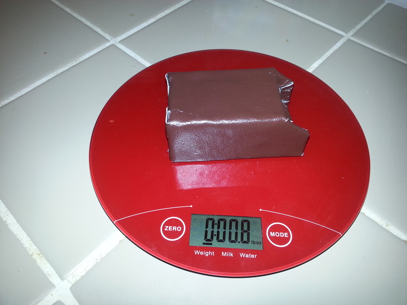

- The best news is that this thing is LIGHT and fairly sturdy. I do not think it would make it through getting stepped on
