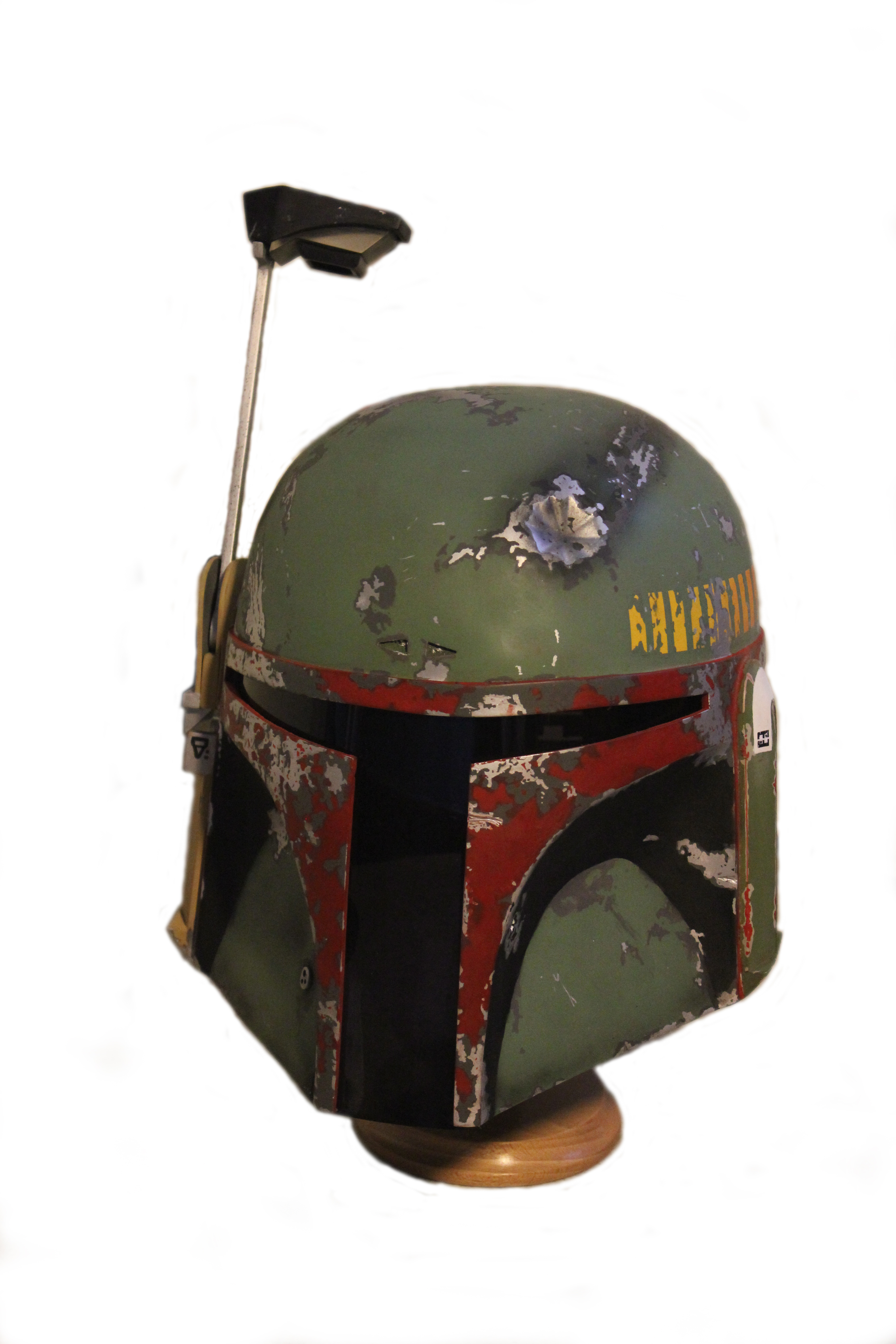

Just about to start on painting my helmet in ESB style, just wondering how many hours I should expect putting into the helmet, I'm going to try layering the paint on the helmet.

Ooh, thats a toughie. It of course is dependent on several factors, including - how accurate you want to be, colour testing and how much time you have available. If time permits you to do some work on it every day, then you can likey get it done in a few weeks. I don't quite have that luxury with a fairly busy work schedule and family, so because im essentially a pedantic old man, I take as long as I need to get my details just how I want them. So its no rarity that a helmet paint up can take 4-5 months for me. I'm pretty sure Garrett mentiones being around the 4 month mark at one point in his 'One last wafer thin..' thread, so it sounds about right. One thing that will help with ESB, is there are already many great tutorials, paint lists and stencills avail, so that will definately help cut down a bit of prep time for you. Good luck my friend! :)

Two weeks. For this helmet;
I was using the Welshwarior's youtube tutorials on the ESB paintjob, and had a vaccuum box for the airbrush, so I could paint at home. I used Humbrol paints which needed some 10-12 hours between layers to dry, and had a deadline for my Fett to be complete.
Two weeks, from start to finish. After work, I buffed the previous work with steel wool, and masked the next layer, then, some jogging outside to let the masking fluid dry, and paint. Then, few hours of sleep and repeat. Then to work, and another coat after work.
I did two - three layers per day, and was able to complete the bucket in time. No social life during those two weeks. Nada...
If I were to paint another bucket, I would take a month to do it, so I could have SOME free time....
