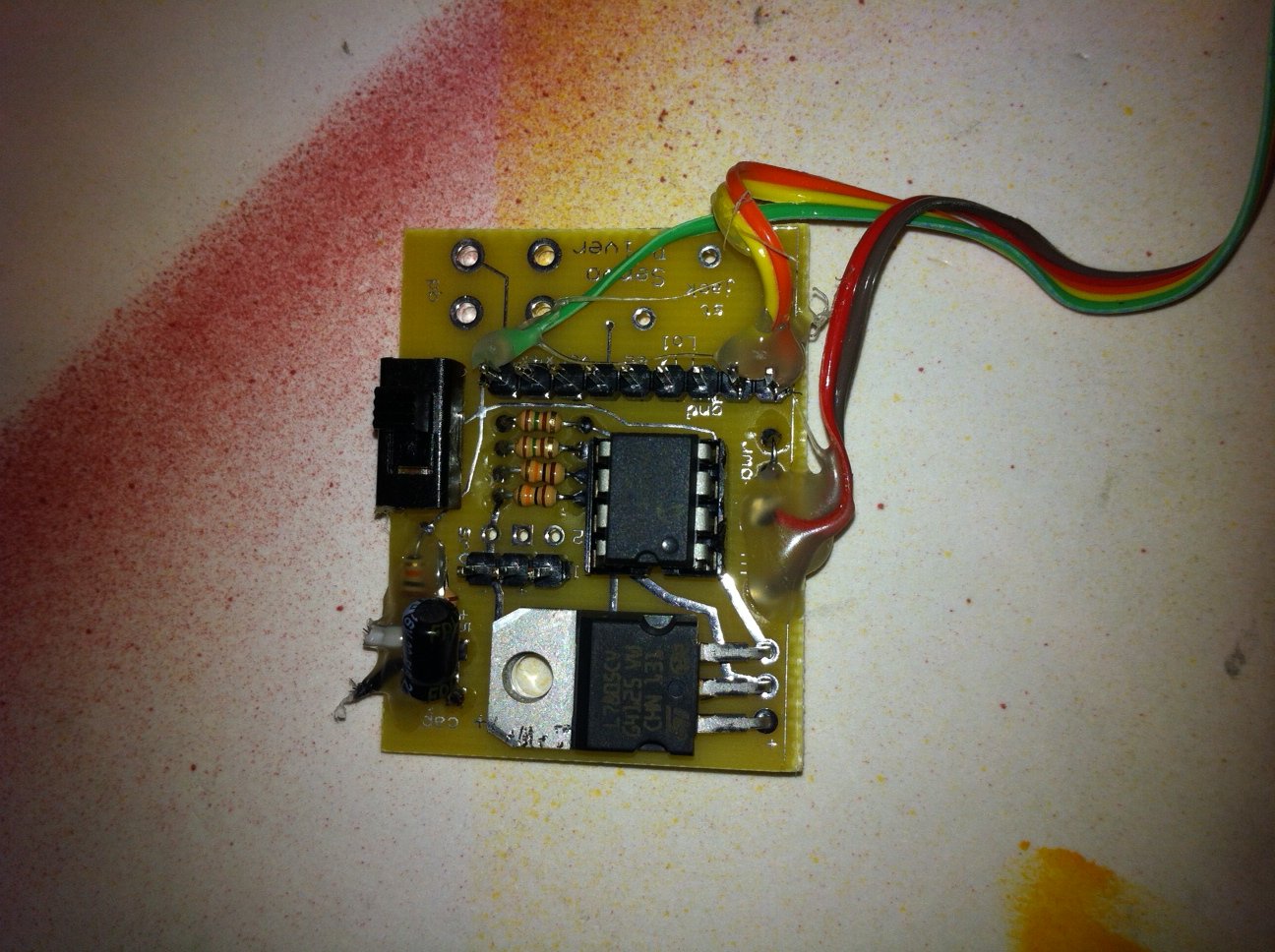

Does ANYONE know how to wire this thing? This unit came with no instructions. doesnt look like thew wireless remote board is getting power. if i switch it on and off the servo moves a tad bit but the remote does not work and i cant get anything else to work. Its driving me nuts. Ive had this thing for almost a year and cant for the life of me figure out how to make it work.

I'm not sure what could be causing the issue. Maybe how the servo is plugged in to the board (the instructions say to be sure to have the servo's black ground wire nearest tot he resistor by the edge of the board)? Or maybe a wire came loose in the receiver board?

Thanks man...well i know one issue is my servo doesn t have a "plug" its just 3 wires...so im going to get a new servo and try again. thanks for the help man..hoping i can get it working once i have a new servo!

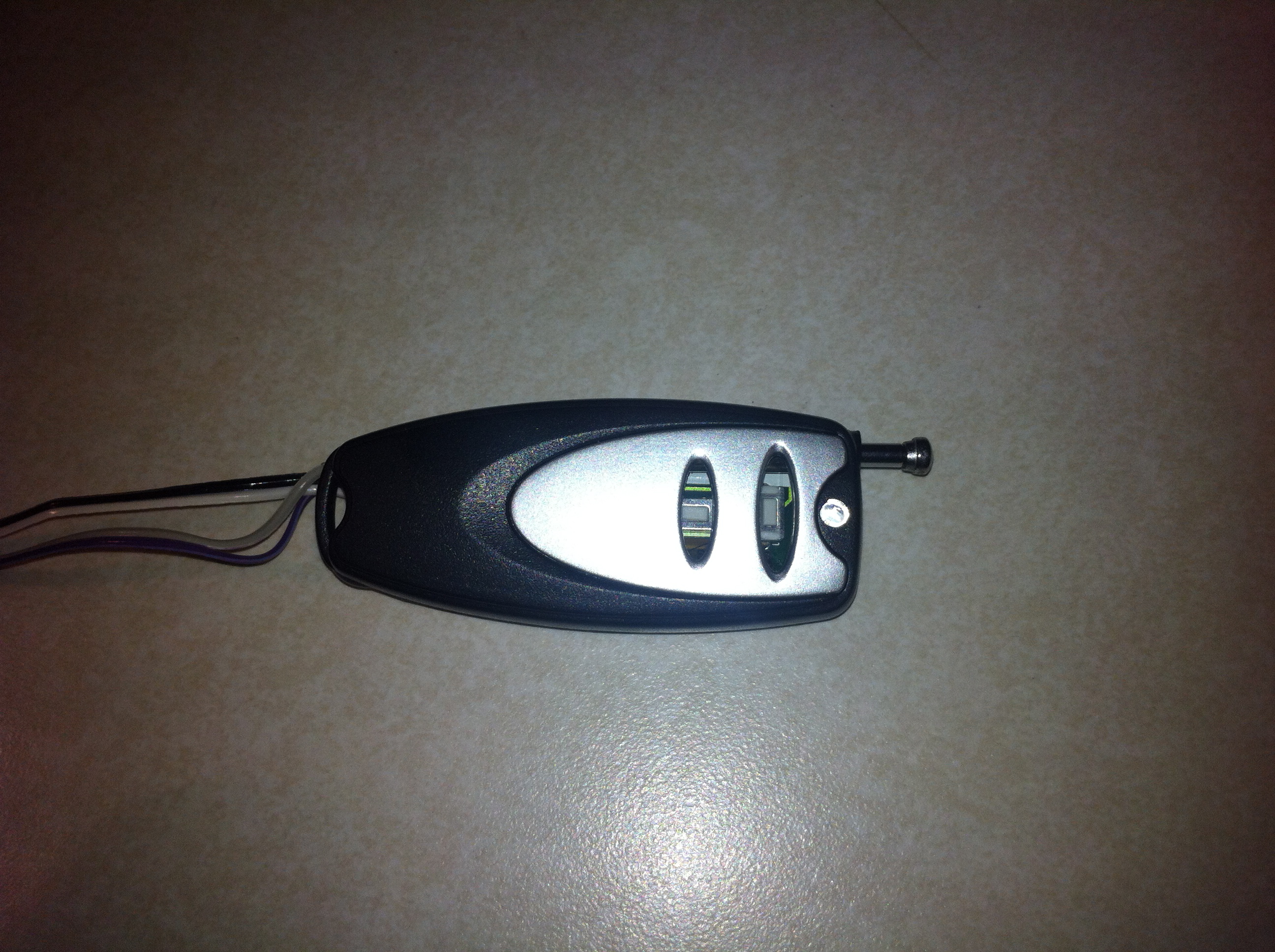

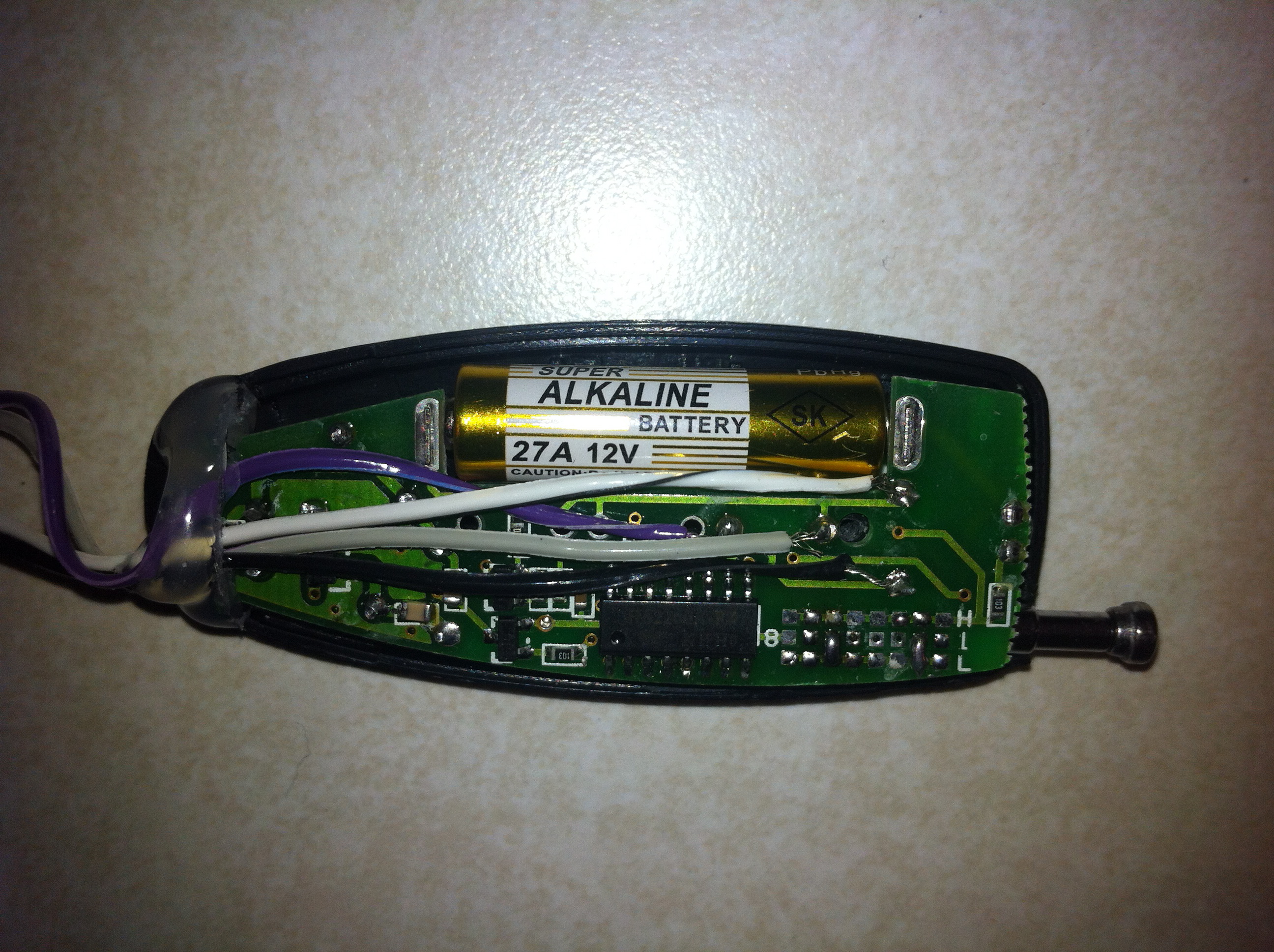

Here's how I hacked my key fob and installed it into the gaunt.

My keyfob looks different, but im guessing the same method would apply. Mine looks like an old 90's square one lol.
Also do you need to use both buttons on your gaunt? Or can a button be pressed to drop the RF and then pressed again to raise it? I have ESB fett so im going to use my right gauntlet. I have one switch hooked up to the light though.

Here's pics from my other link about the key fob hotwire.

If your remote has 2 buttons, one button sends the signal to lower the stalk and the other raises the stalk. If you have a switch on the smaller board (like in my photo) it allows the buttons to manually control the stalks motion, otherwise it is pre-programmed with a static 90 degree rotation.
On my gauntlet, the button closest to my wrist lowers the stalk and the other one raises it.

Thanks for the props! I love tinkering around with stuff. Be careful when you solder the board, you don't want to cross a circuit. I didn't add any solder to the connections. Rather, I just let the iron heat up the original solder just enough to get a connection to the new wires. Once the original solder grabbed onto the new wire, I used hot glued to take the torque off of the connection. I also took great care in not striping the wire too far back so it wouldn't cause an arc and short out the transmitter.

It works!!! it works!! thank both of you guys so much!! I havent tried the keyfob mod yet though..that one scares me a little lol. Once i get this mounted in the helmet and have everything workin, ill grow a set and try the fob mod.
