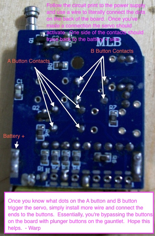

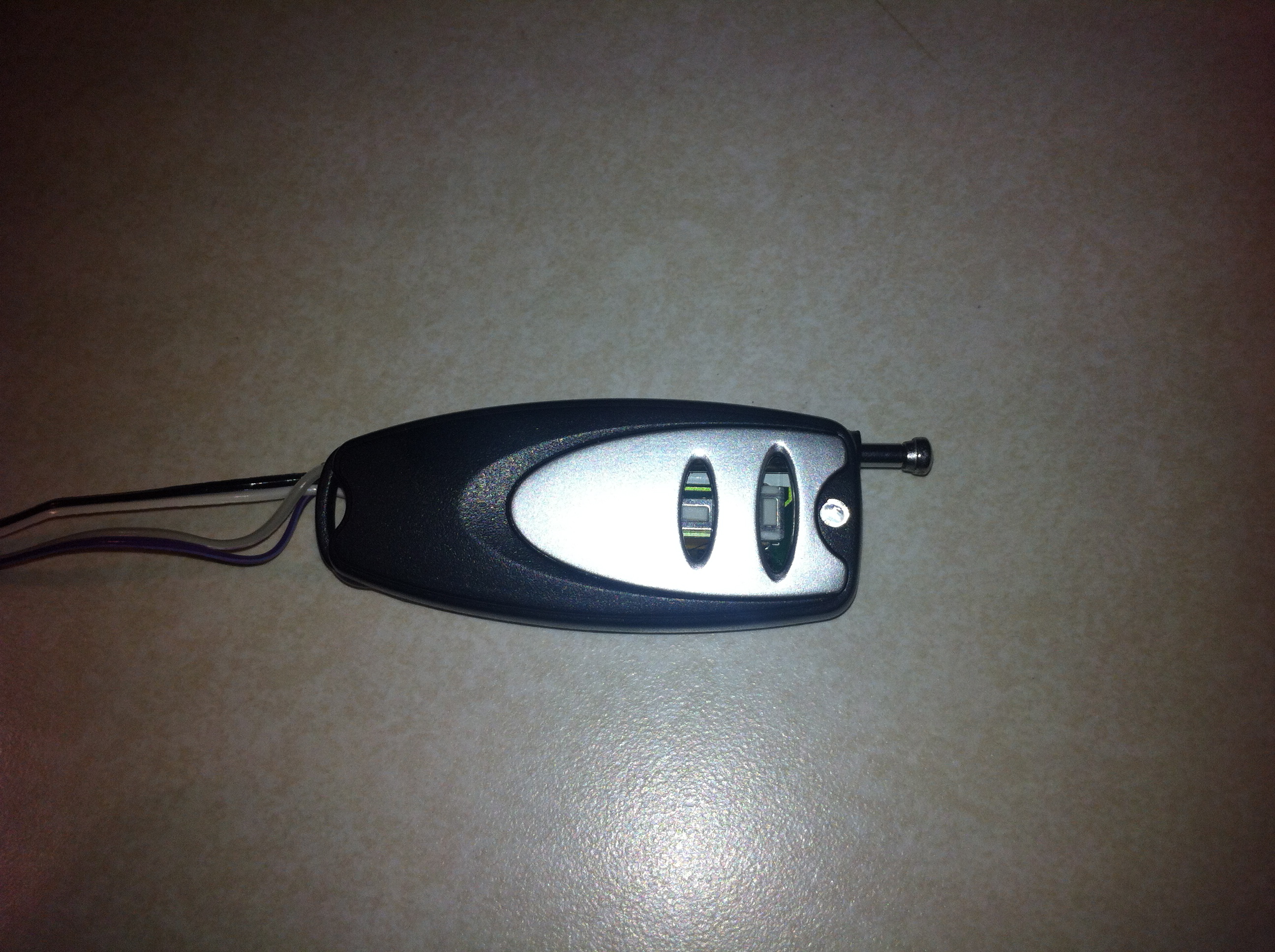

Ha! Got the pics working again! If you can get a better focused shot of the circuit board patterns, I can get a better idea for another suggestion. It's all about completing the connection away from the actual plunger switches. If you notice, in my pic of my remote in the gauntlet, I removed the buttons in order to not accidentally send a signal. Here are pics from my install plus a notated pic of your board.
Let me know if this helps!
Awesome thanks Warp!
