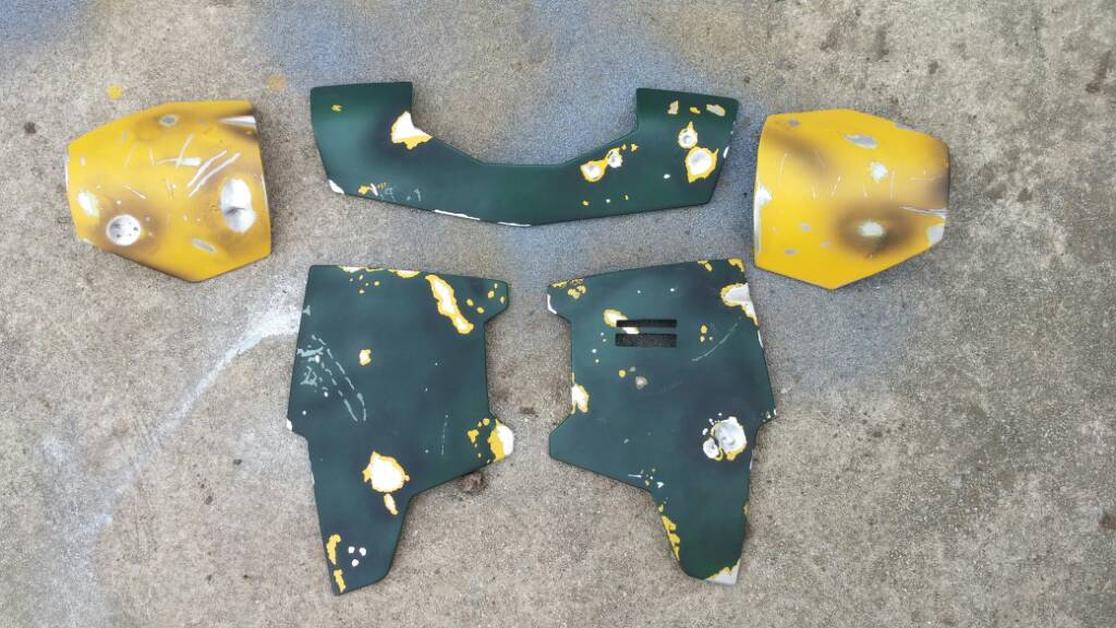

An airbrush worked perfect for me I put off buying one for a long time because I've never used one...but the day I got it weathering has never been so easy...I held the brush back about a foot and did a light spray over the whole thing and then a heavy spray over the dented areas I couldn't be happier with the way it came out

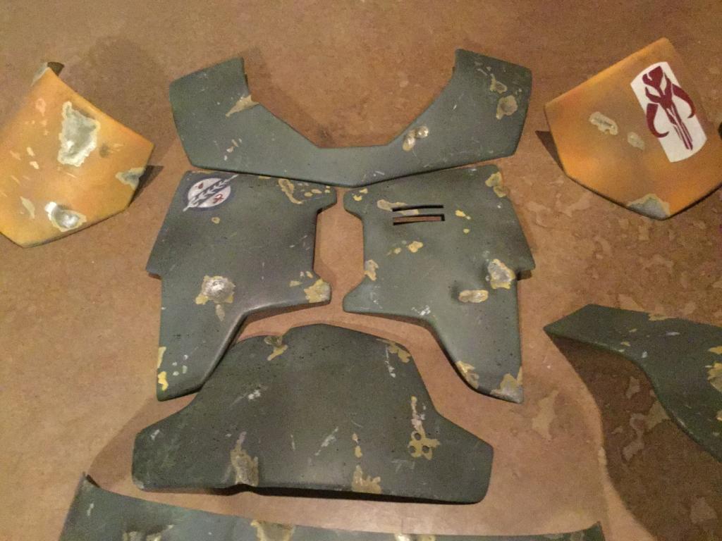

Weathering is a process and should be done with multiple layers. Blacks, dark greys, browns, white and silver scratches, matching the reference pictures as much as possible.
I used an airbrush which gave me much more control over the fade.
For the black splatters I took a toothbrush dipped in in watered down acrylic and just pushed my thumb through the bristles. Have a paper towel ready while doing any weathering to clean up if you go too far.
That looks pretty awesome, DeathProof !
