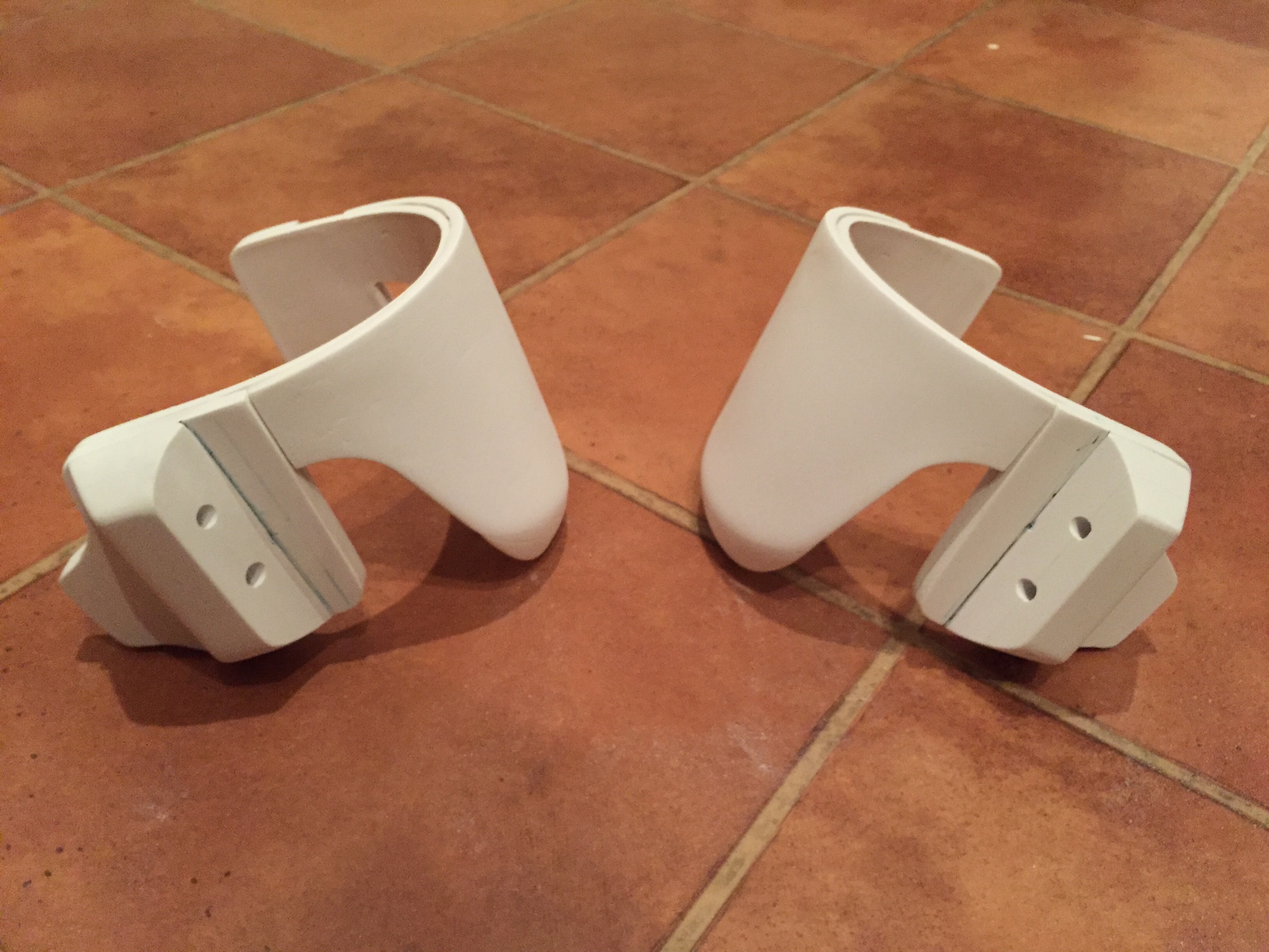

I also made my knee armour with sintra and WOF templates.
I added the side dart attachments as one piece to the sides. I glued 10mm Sinatra together to make a block and shaped. Then smoothed the facing edge (where the darts go) and the rear with epoxy putty. I haven't got many pictures from that stage. Hope this helps...
This is before I added epoxy putty, you can see the shaped blocks attached to the sides.
