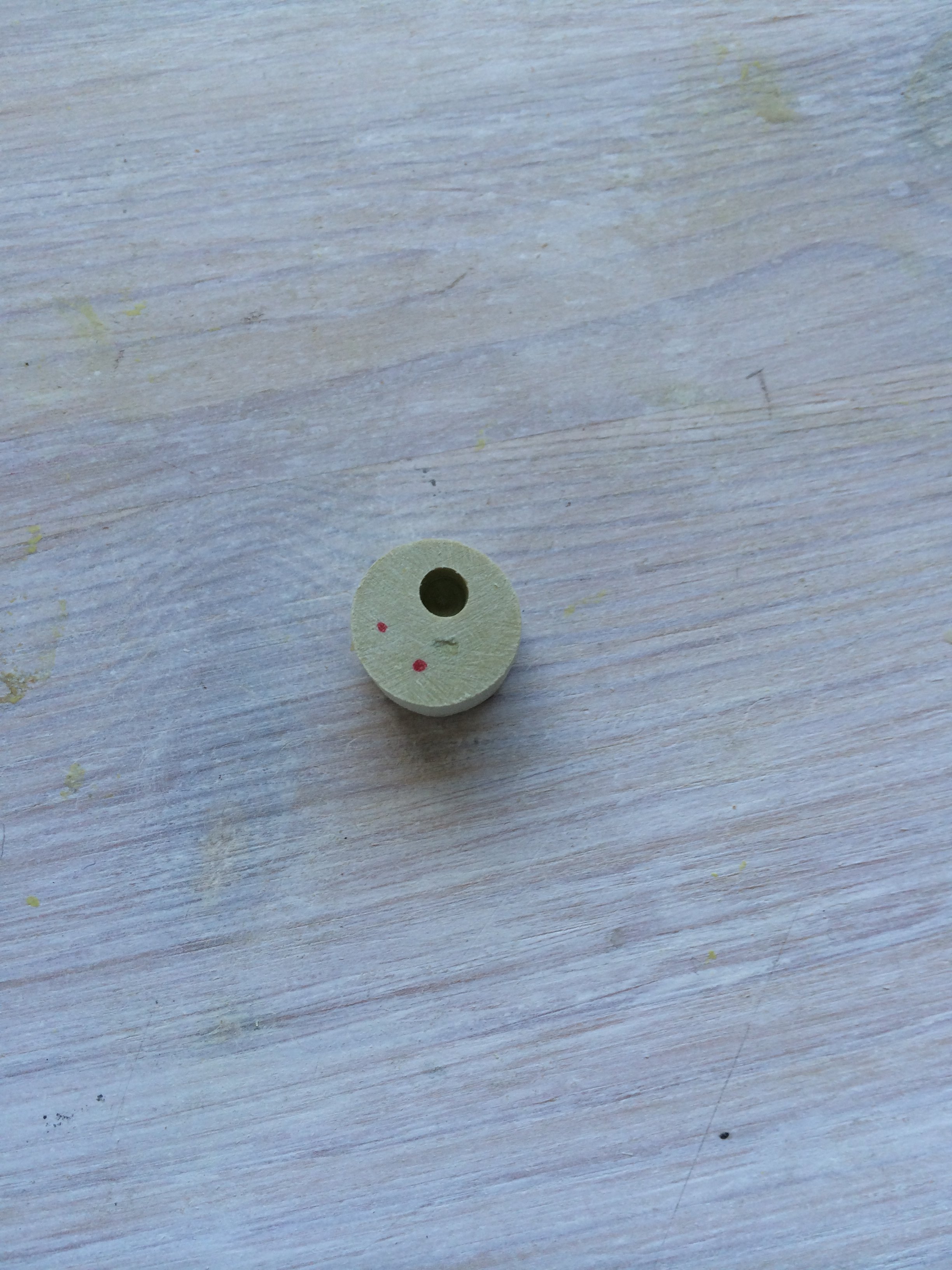

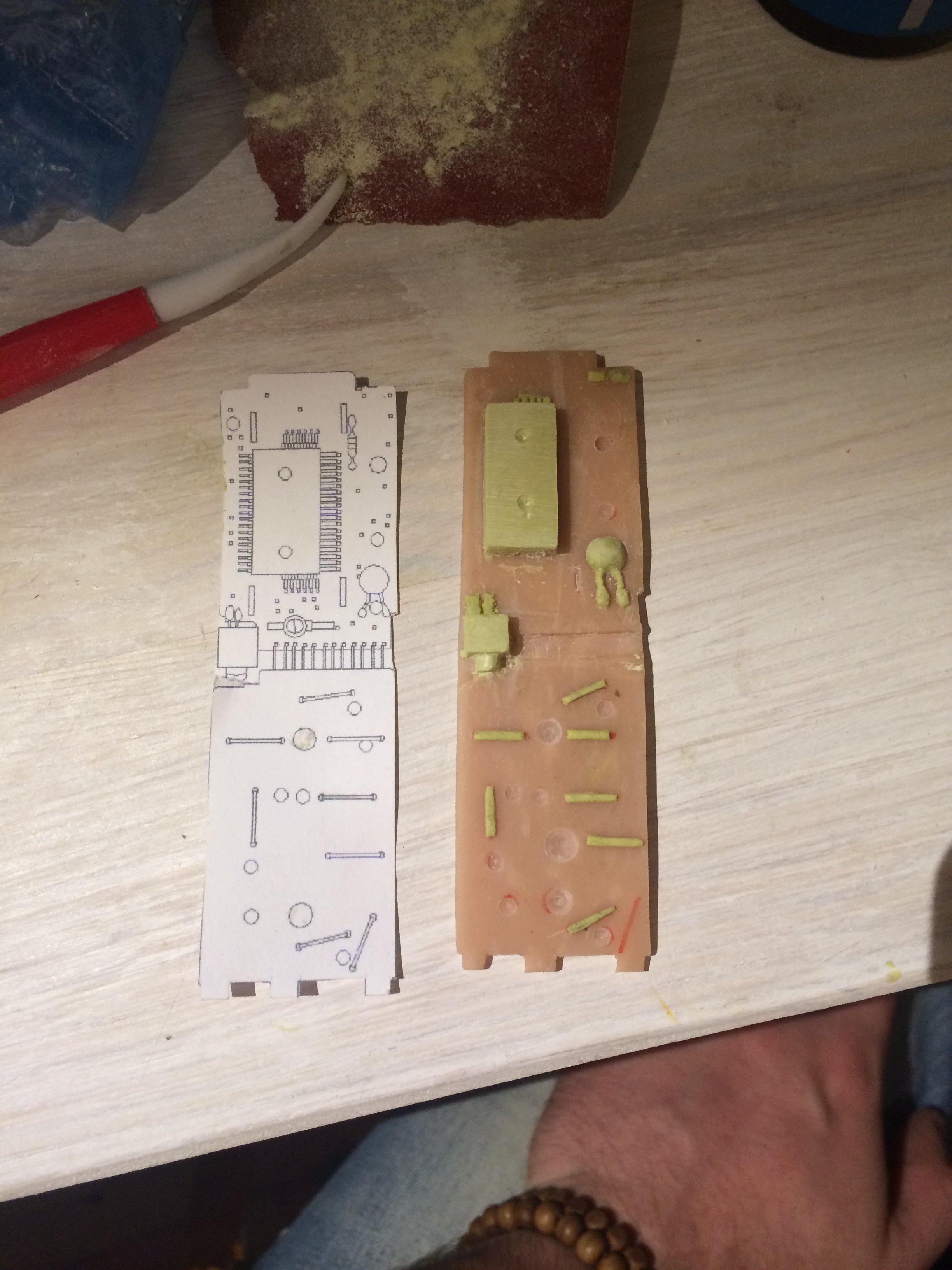

bild 5 (1).JPG borden :)

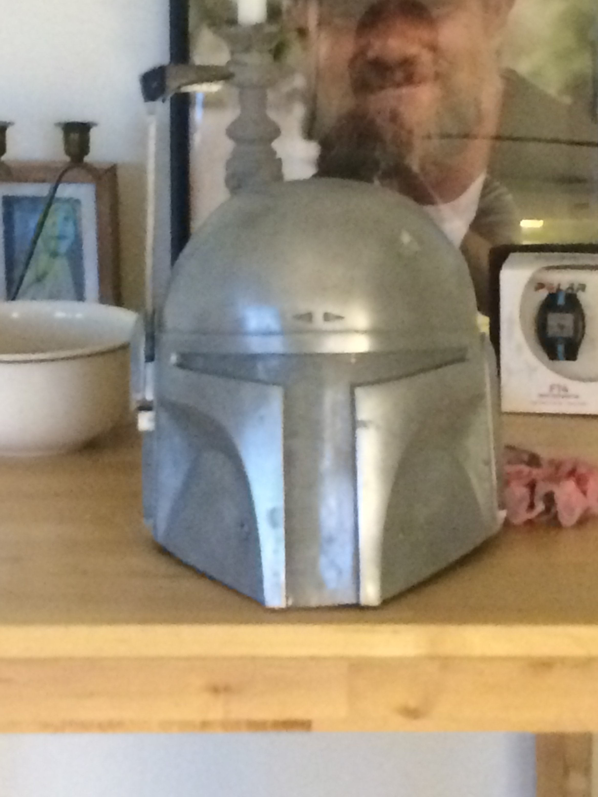

bild 1 (1).JPG installed and ready!

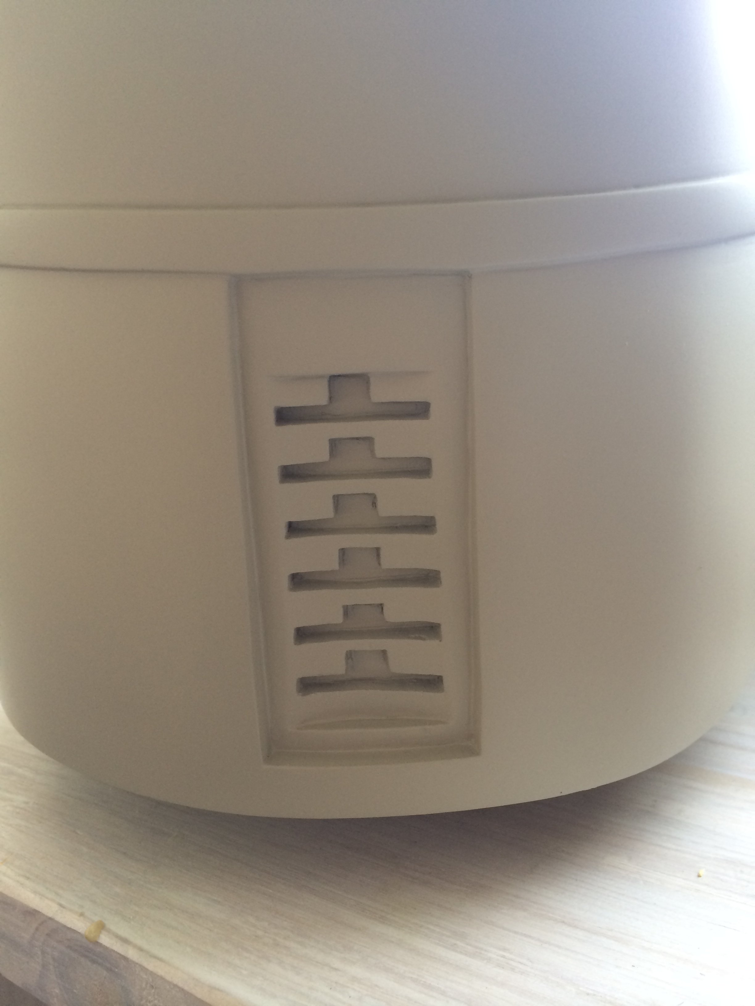

bild 3 (2).JPGmaking theese mo*her*uckers a little bit more acurate.. still need the slight slope on the upper bit of it.

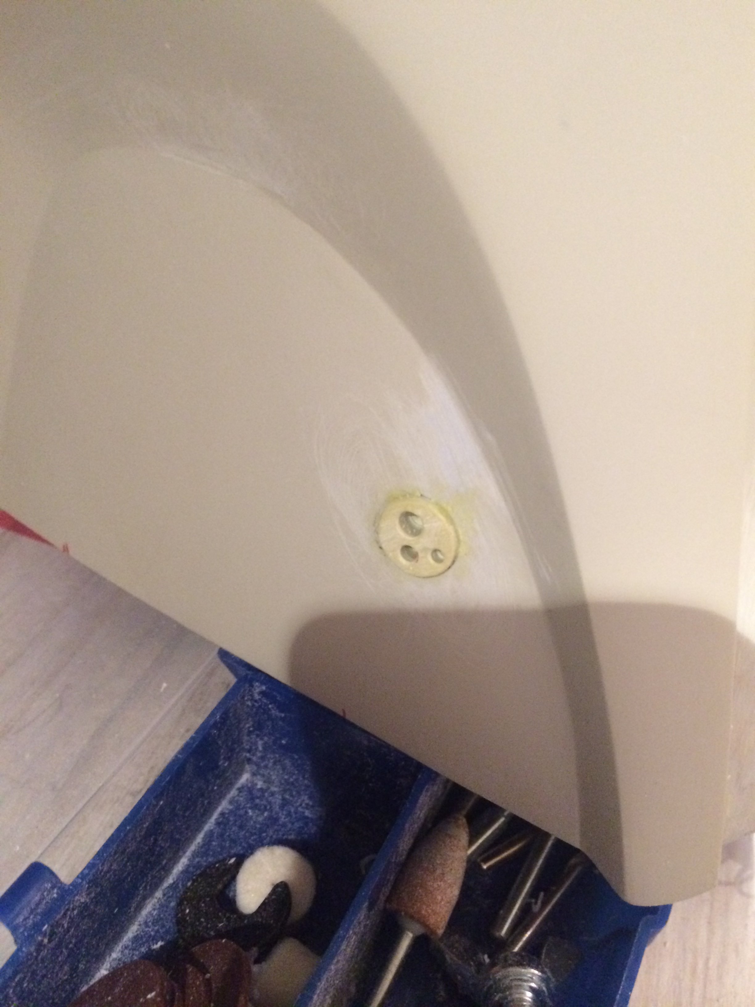

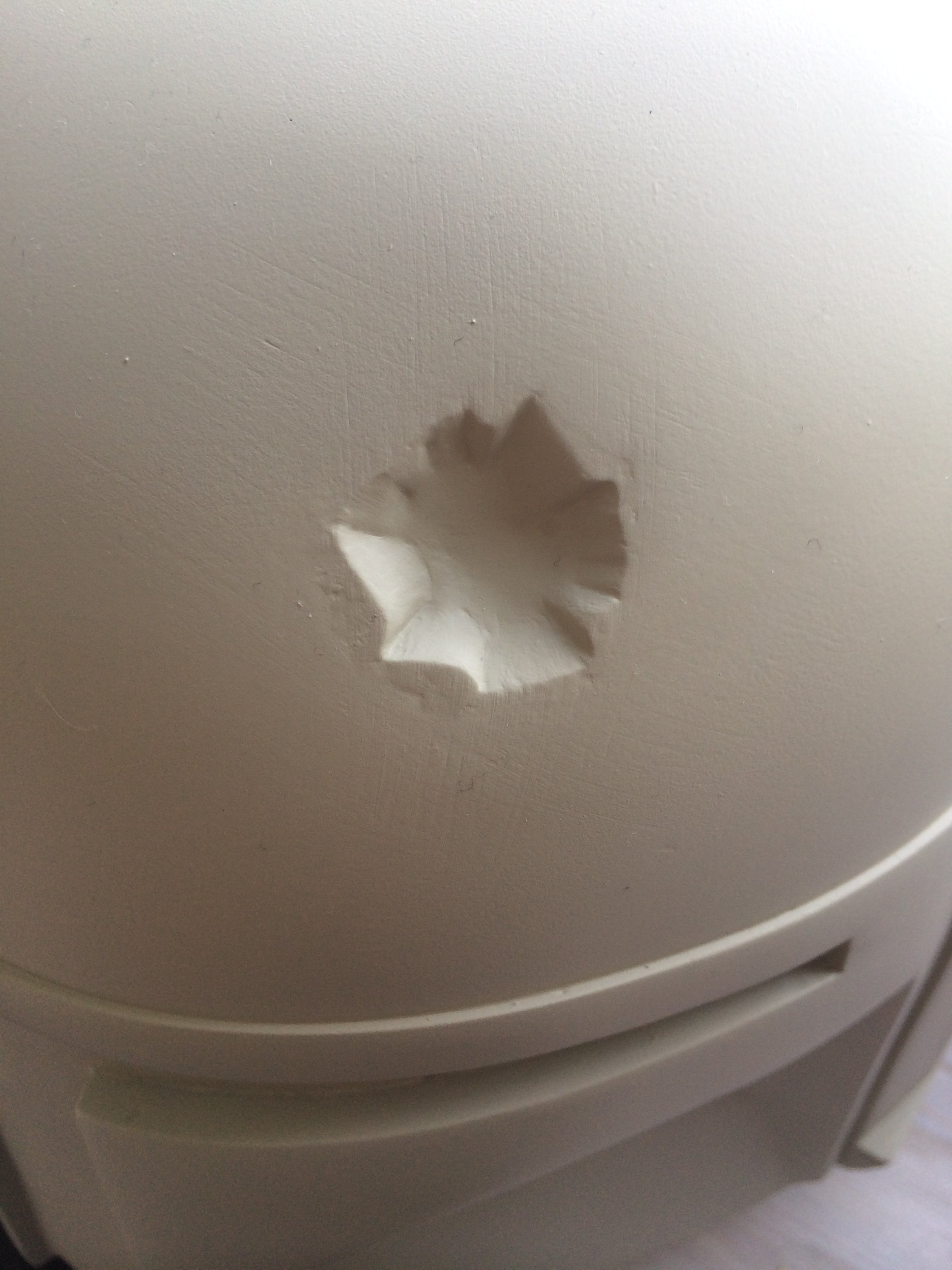

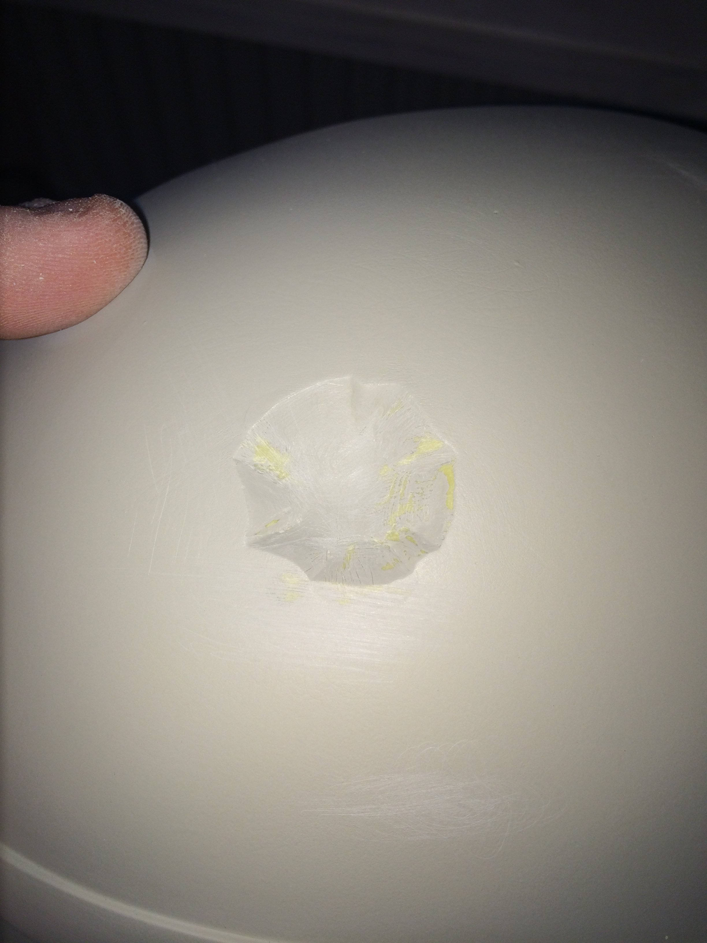

bild 4 (1).JPGmaking the dent more "screen acurate" still rounding it off and smoothing it out a bit.
bild 2 (1).JPGand im making one of theese :)
after i finished with theese parts and added the damage to the helmet ill prime, wetsand, paint in blackgloss paint, and wax it then it will be ready for silicone!

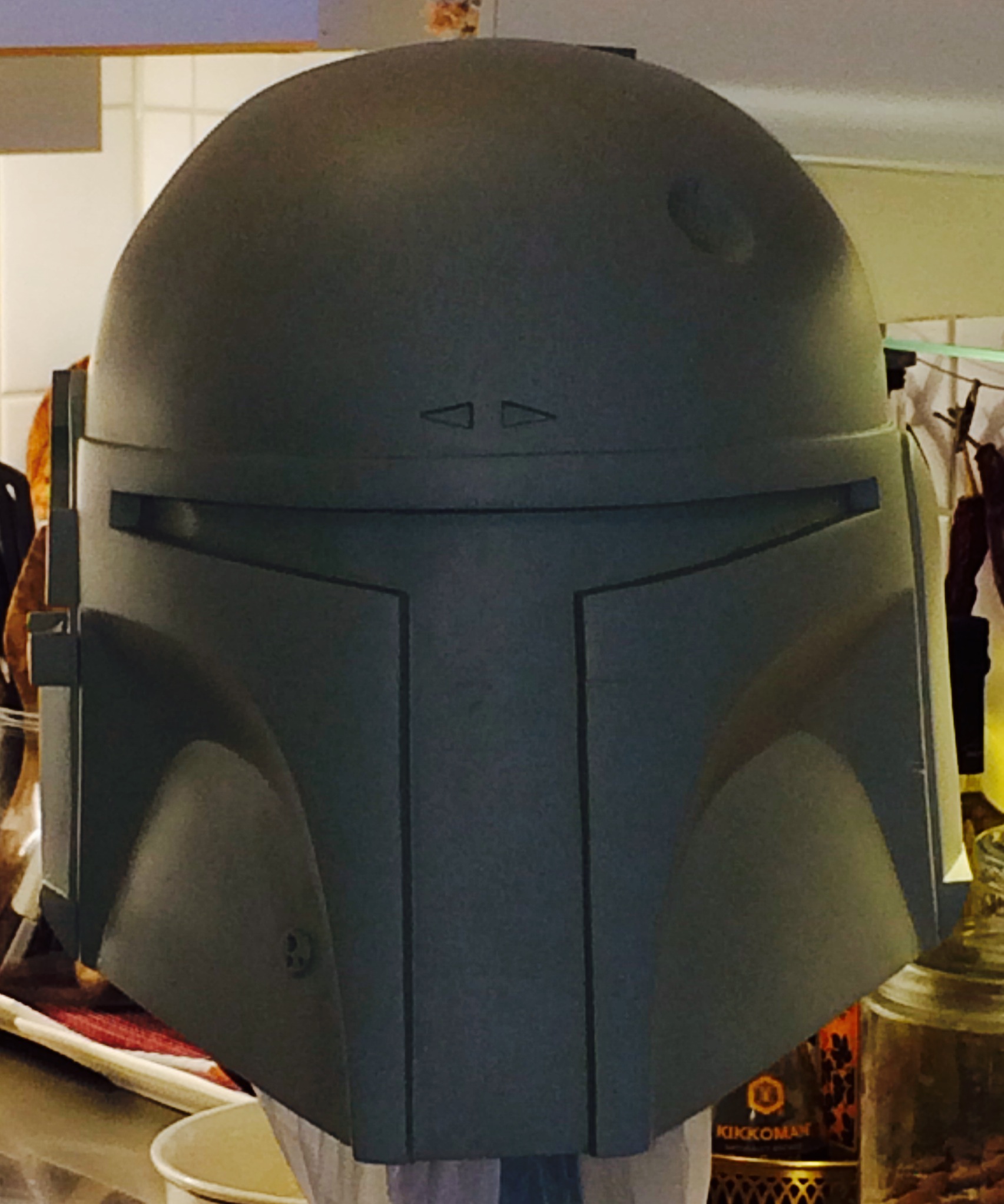

bild 2 (1).JPGdid the dent as close to the moviebucket as i could.

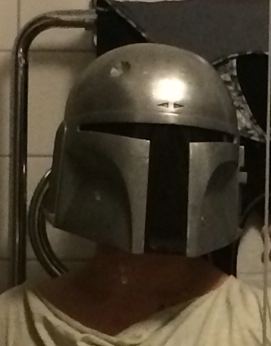

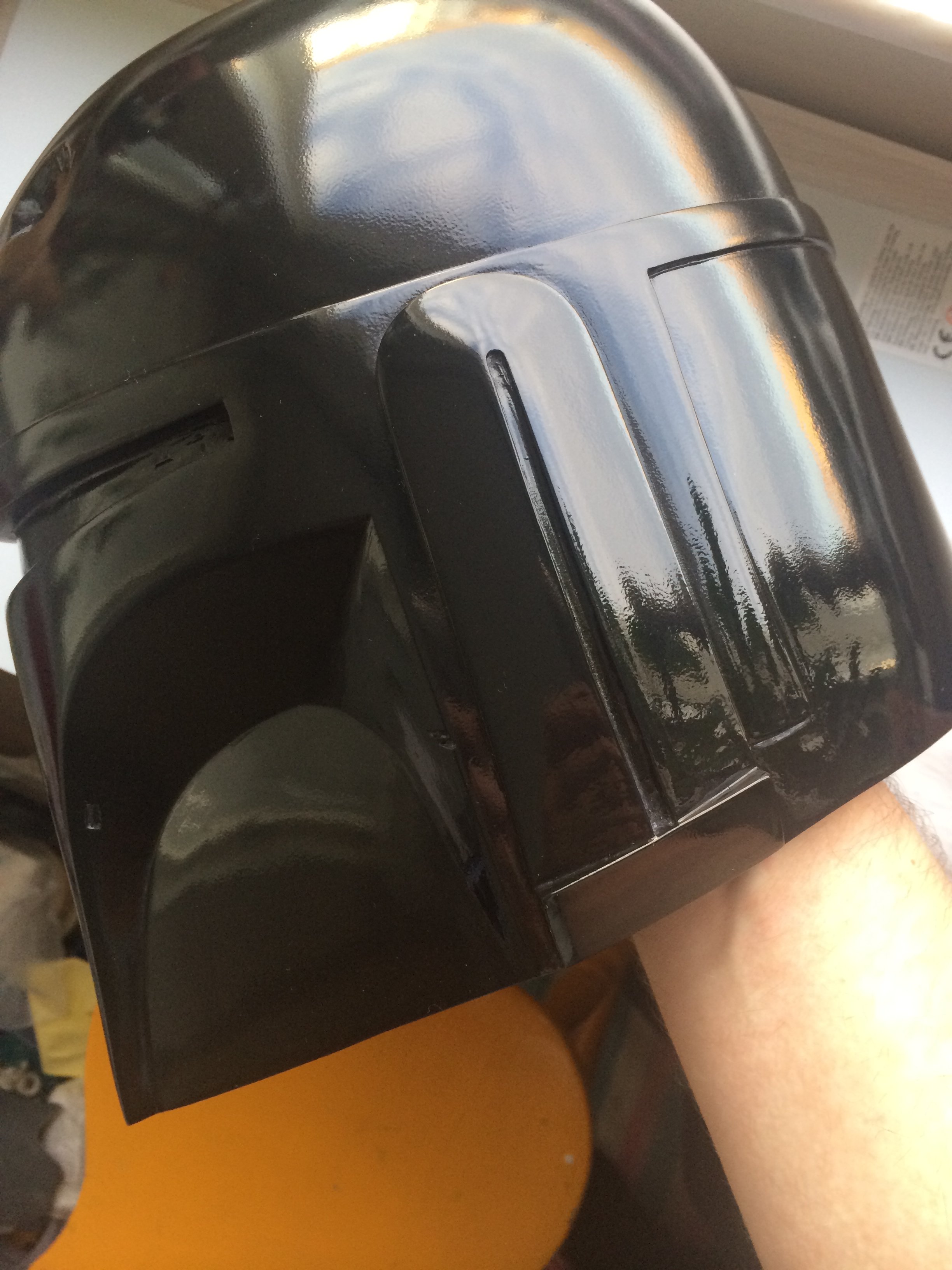

bild 3 (2).JPGgave it some shiny blackgloss paint and clearcoated it.

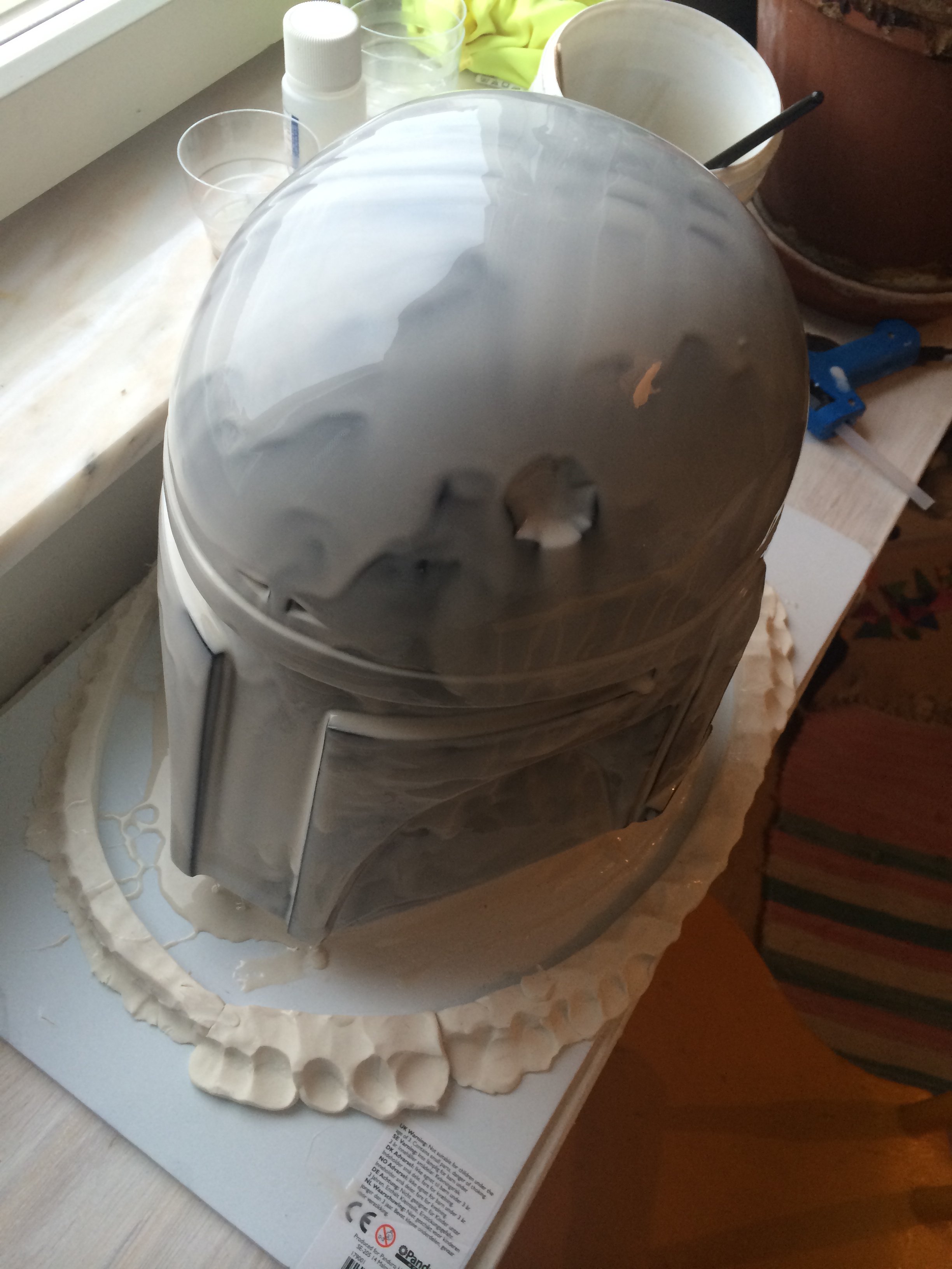

bild 1 (3).JPGbrushed on 2 siliconelayers

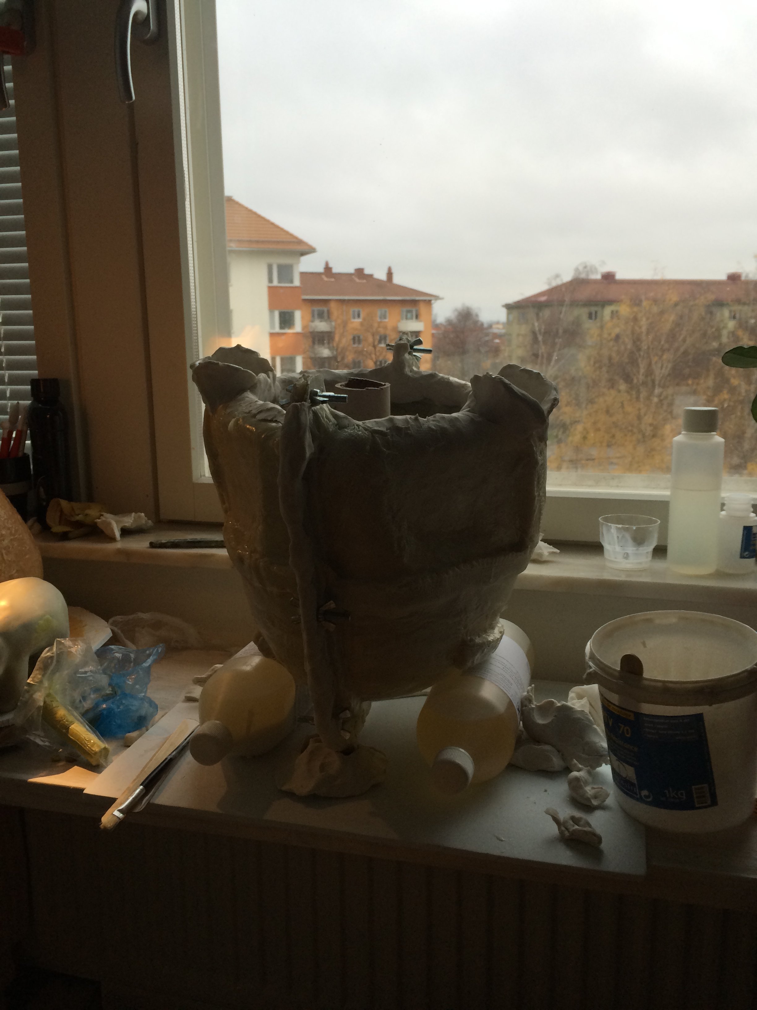

bild 4 (3).JPGmade a matrixmold. (i have previously made a glassfiber shell of a clayed up helmet. put some pucks of silicone on the layers of silicone as a divider to make the helmet float inside the glassfiber and then poured the rubber.)
