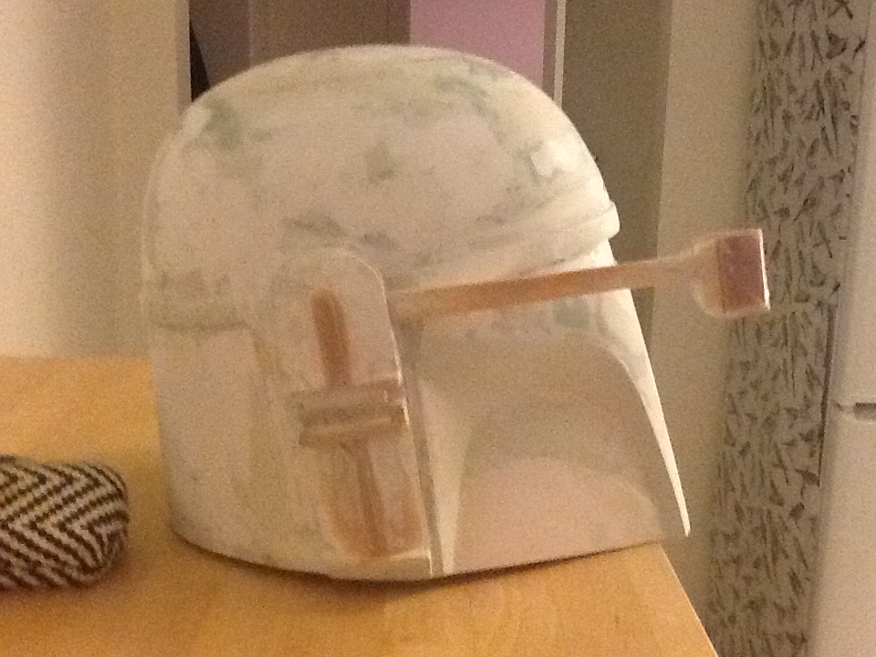

So here is some more progress! I started on a new rangefinder, my old one wars awful!
image.jpgThere you see the old one and the beginning of the new one! What you think? If something is off please say some thing :)

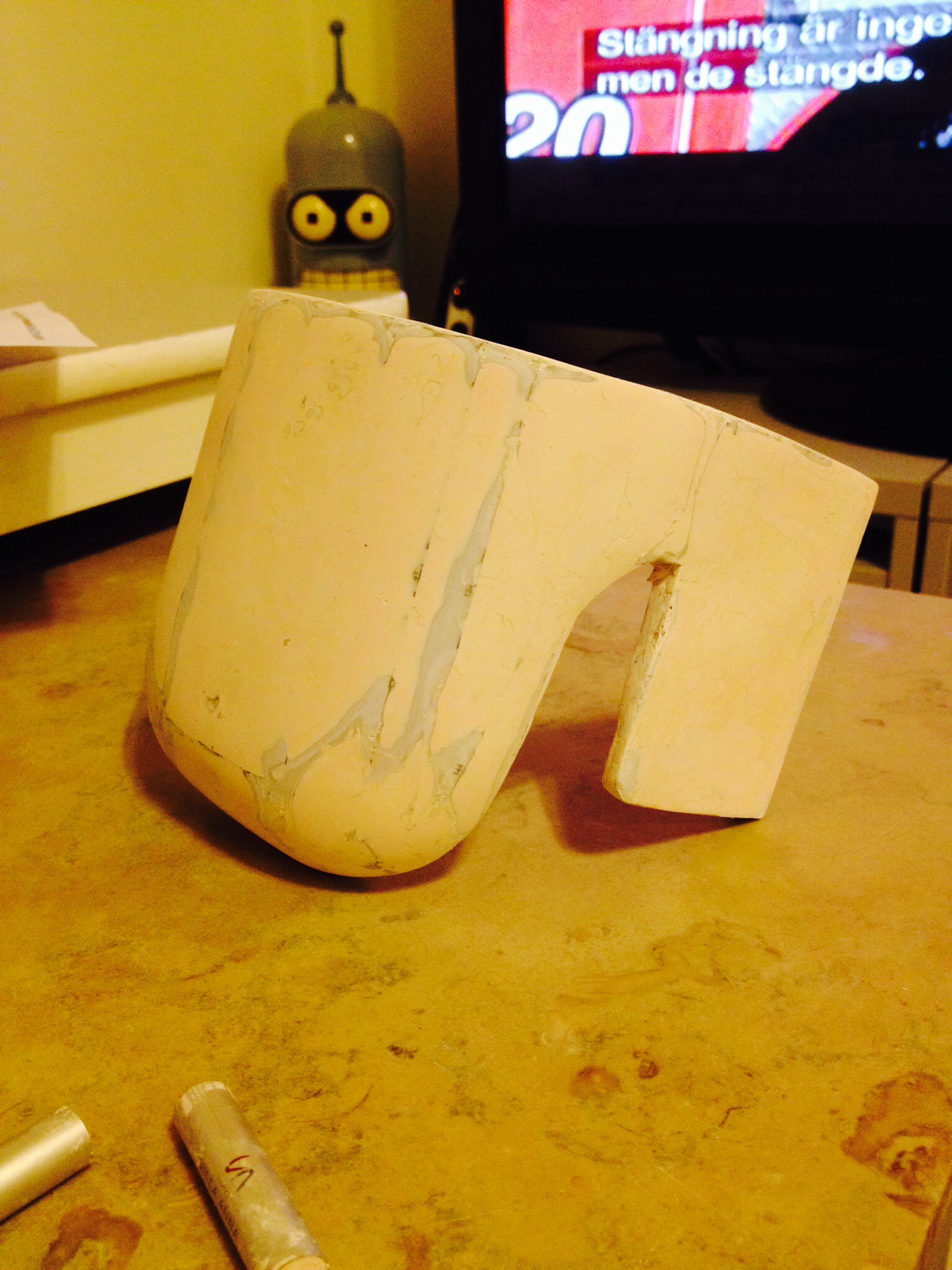

and one one knee is almost ready some more plastic padding on the inside and the ("slots") on the flat side of it :)
image.jpgIn the bottom you see the very early stage of the kneedarts :)

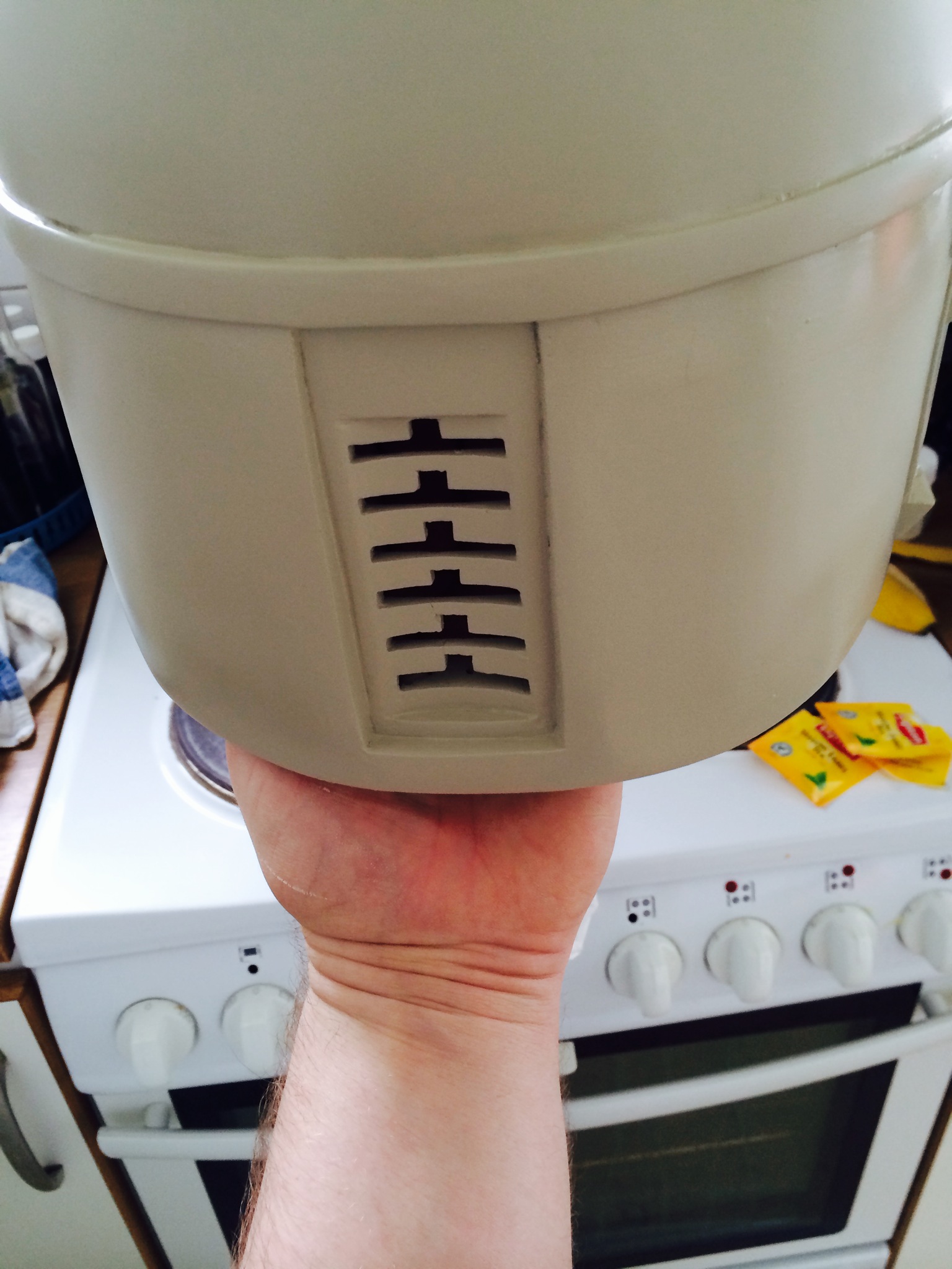

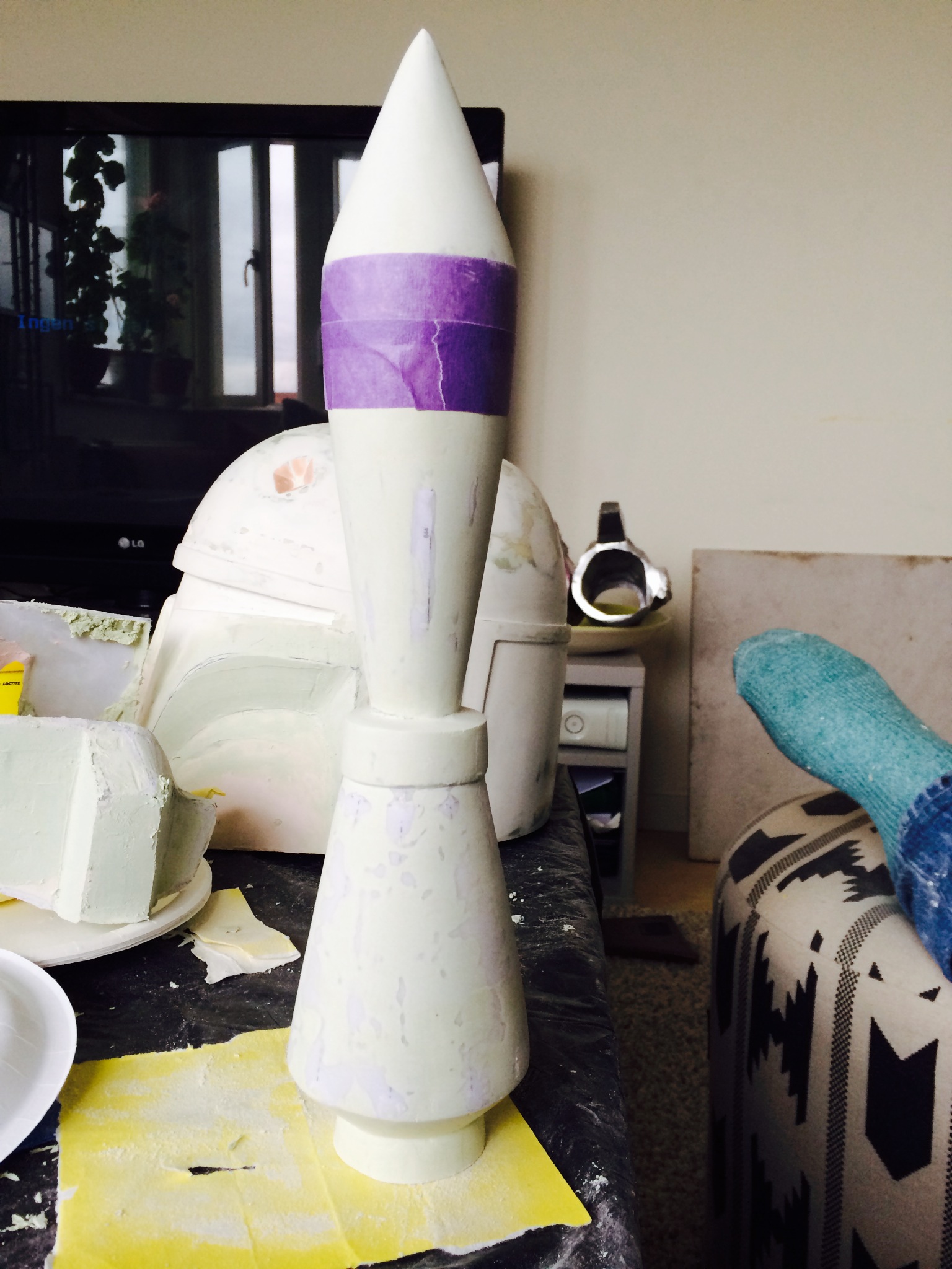

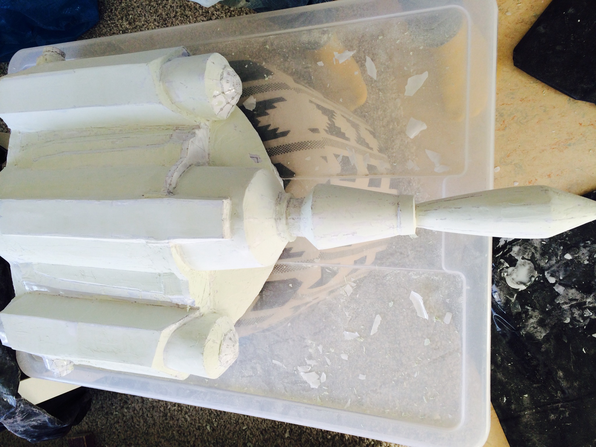

a little update:bild (1).JPGbild.JPG started with the jetpack! i wonder why i begin new things when i havn´t even finished the helmet :/ wich i am remaking the mandibles and the keyslots on :)
update! :bild 1.JPG

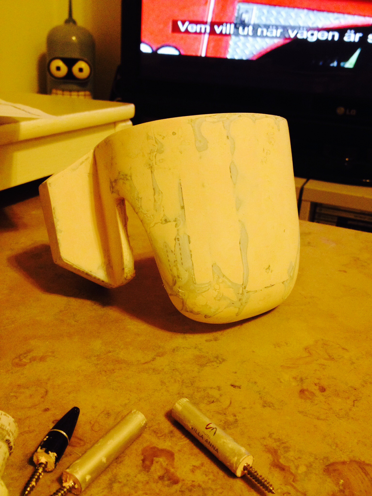

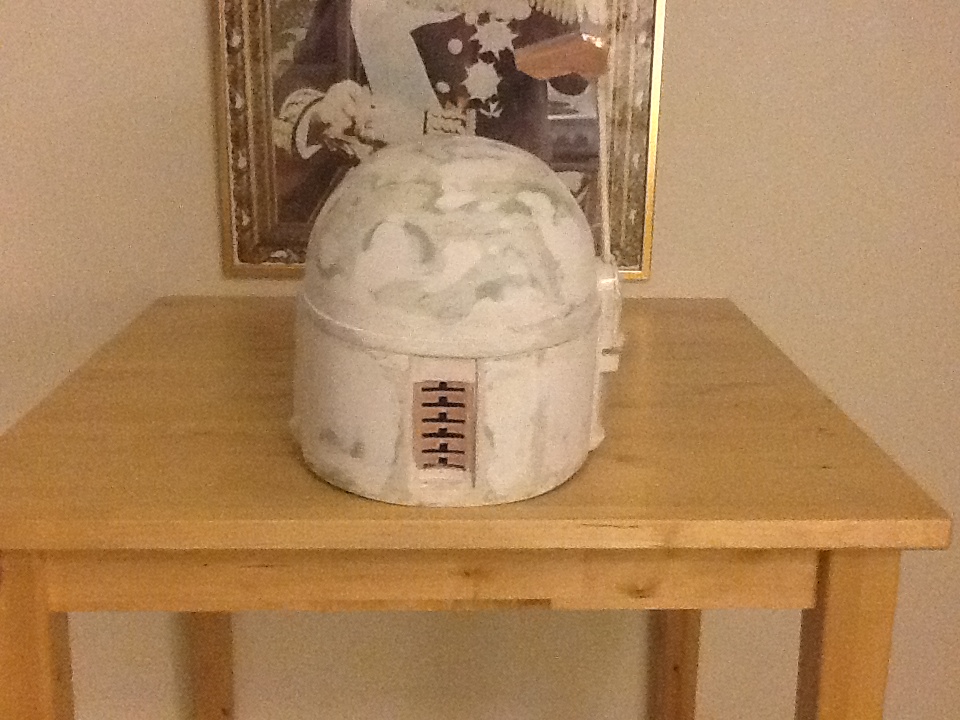

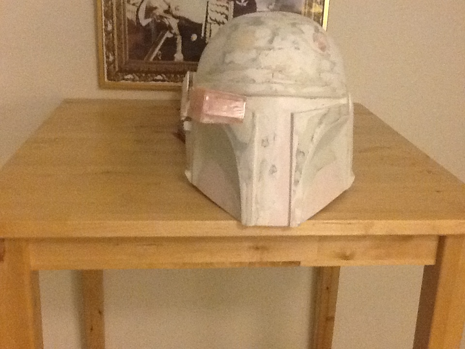

bild 5.JPG i think im starting to get happy with the helmet now! it will be fun to see it when primed! been sanding like an animal! if anybody sees this and have kritisism im glad to hear so that i can fix it i want this helmet to be good when im done :)

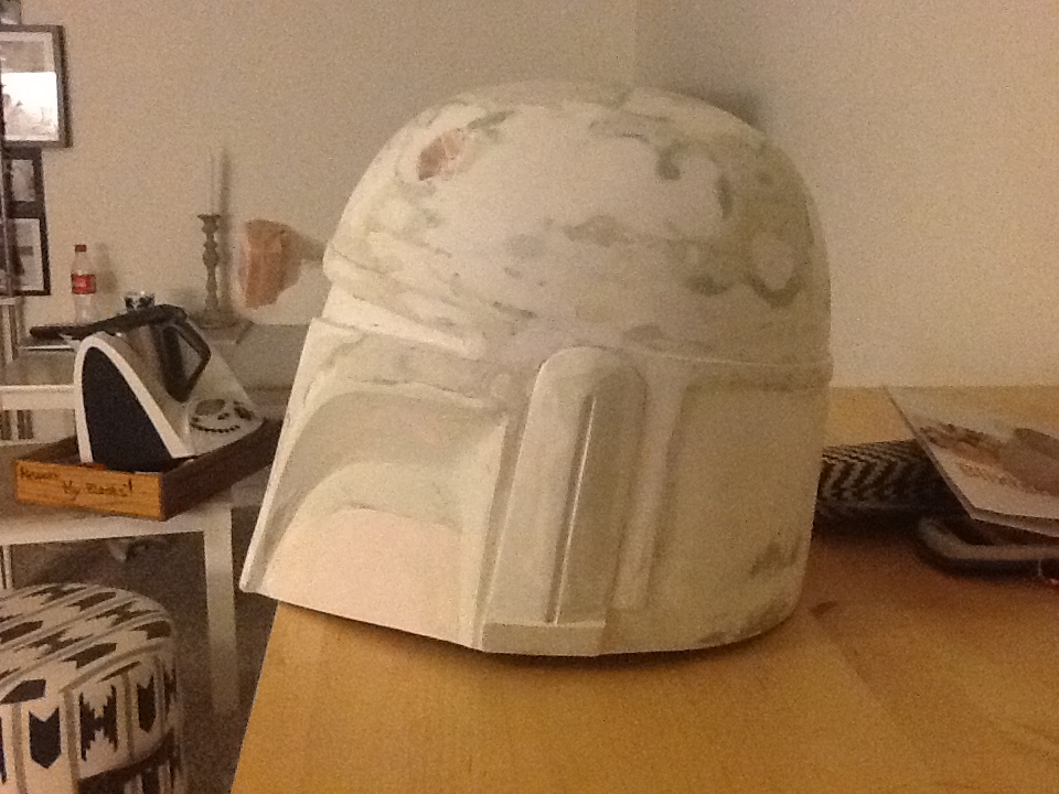

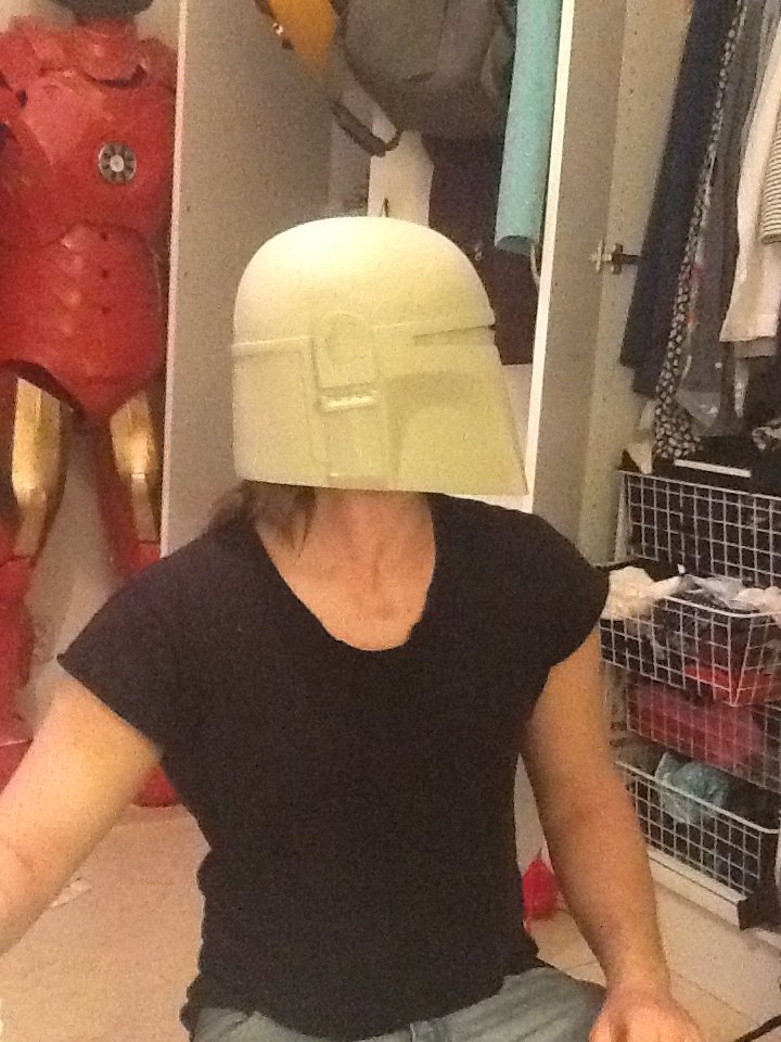

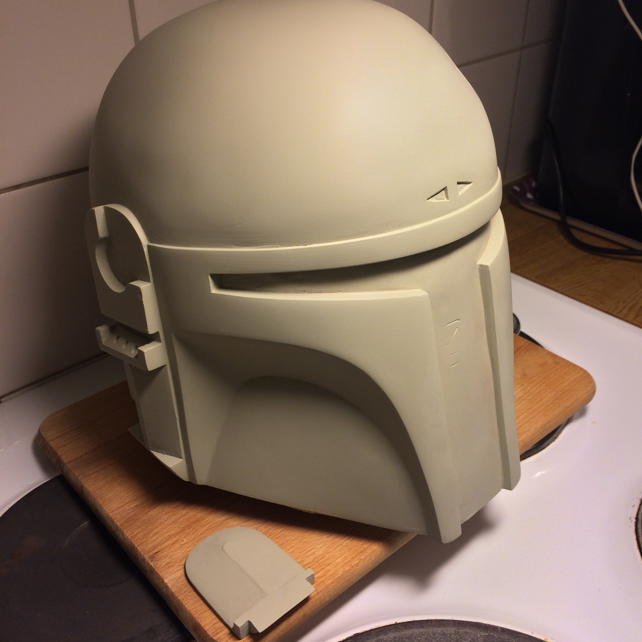

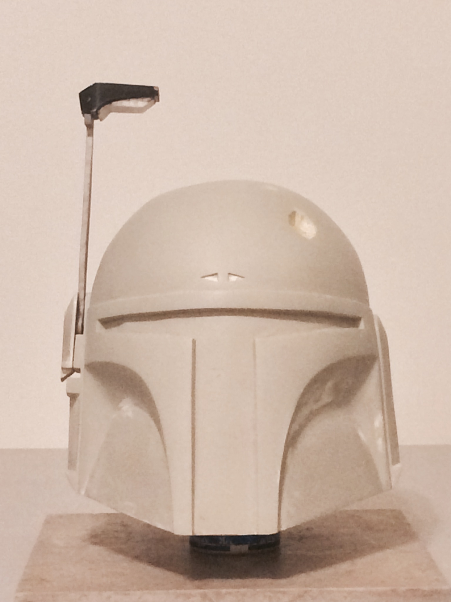

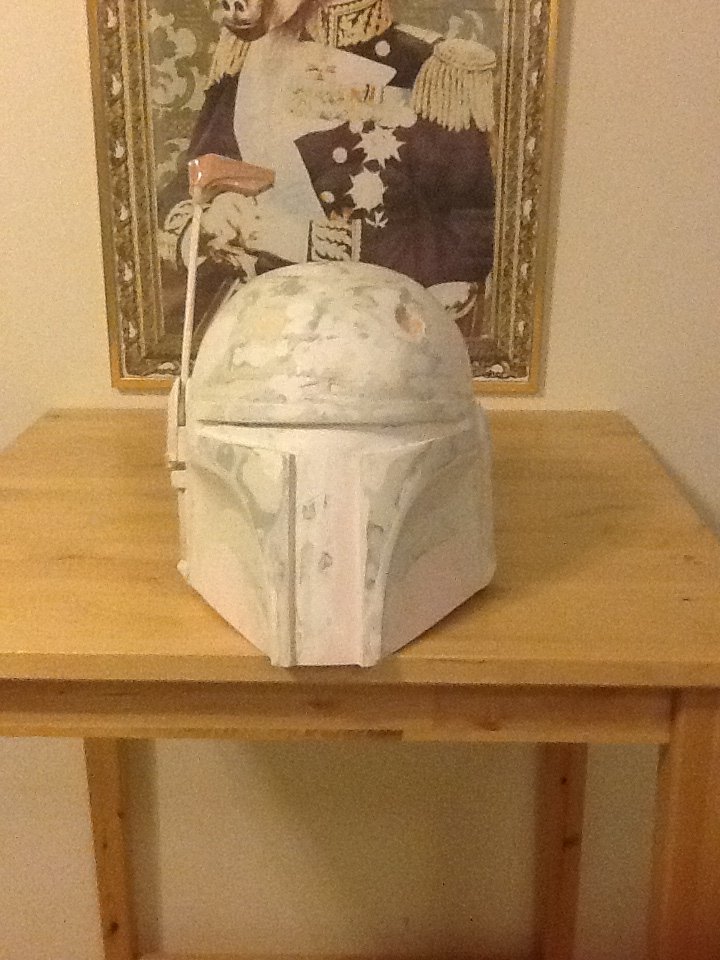

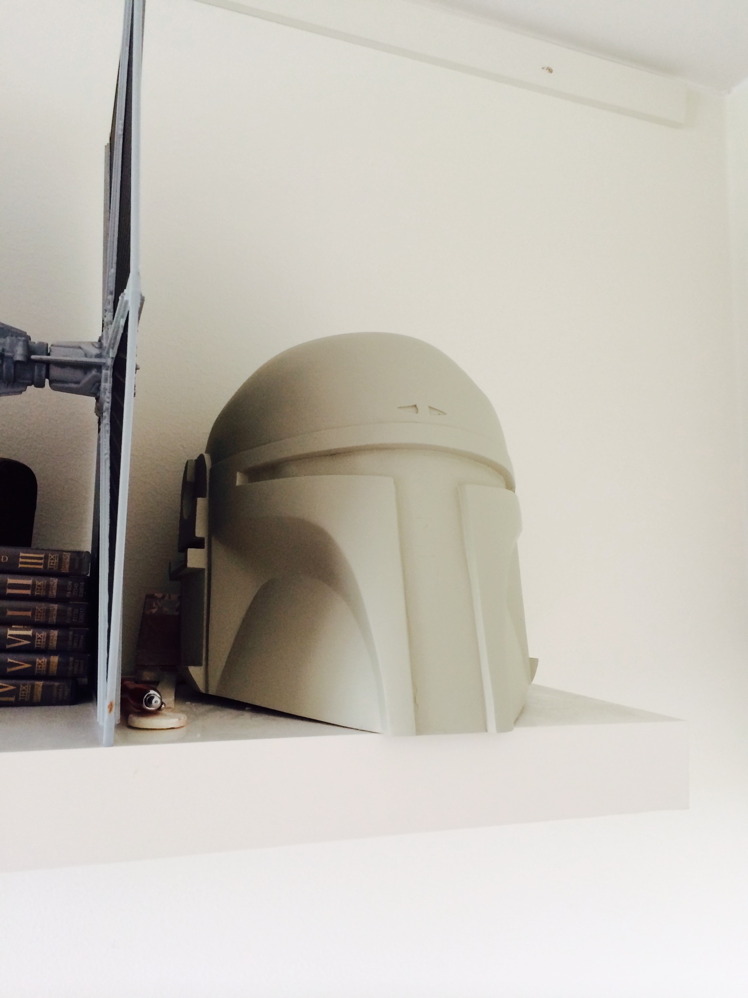

hi guys! a little update. I have made a decision to finish the helmet before i do anything else otherwise im going to go crazy! so i did about 12 hours of work on it since last time and im starting to get there! i primed it and discovered som bits and bobs left to fill and sand but its not much. have a look and see what you think of it. im really sorry for the crappy pics. when its ready i will get a better camera and take some nice fotos. i promise
bild 3 (2).JPGmy little star wars shrine :)
bild 4 (1).JPGi dont know how to flip it around haha. not so good with computers. i like sanding more :)

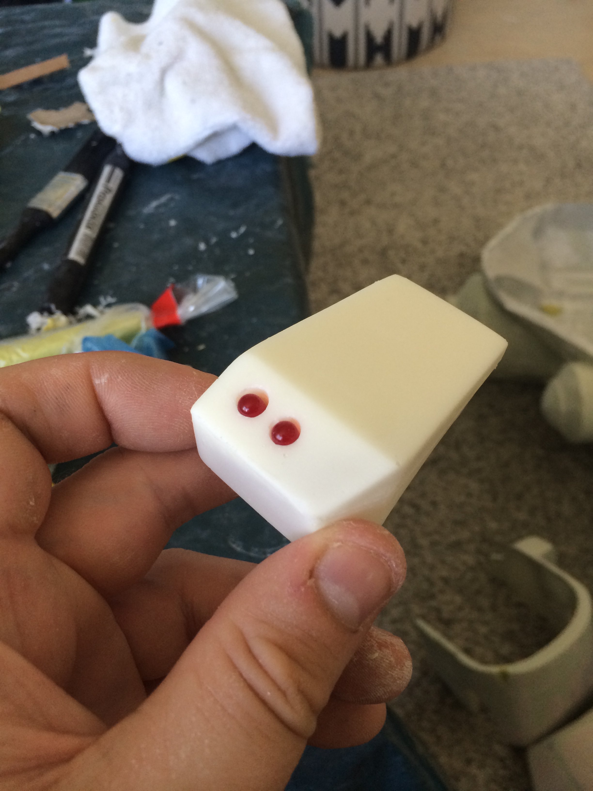

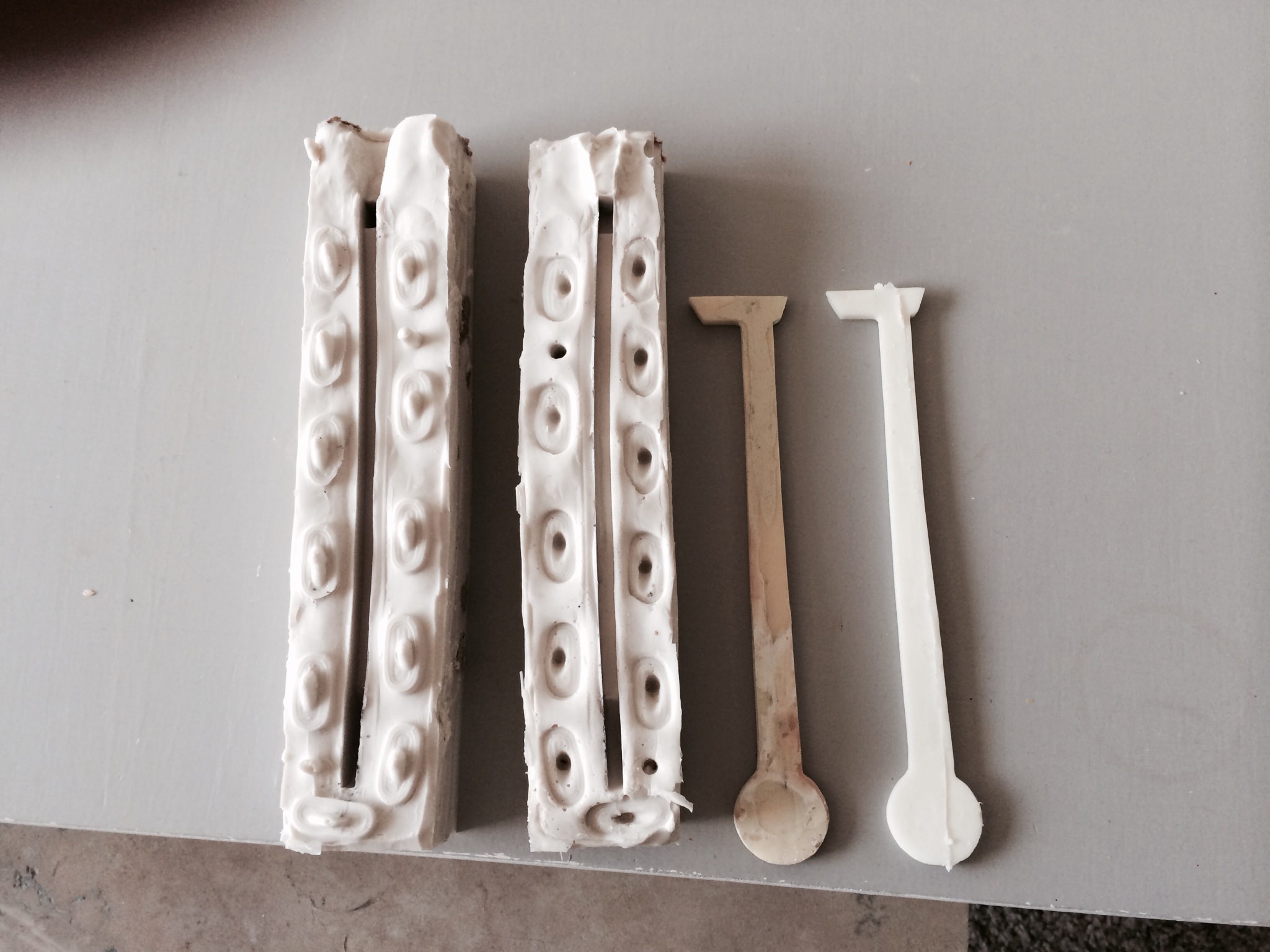

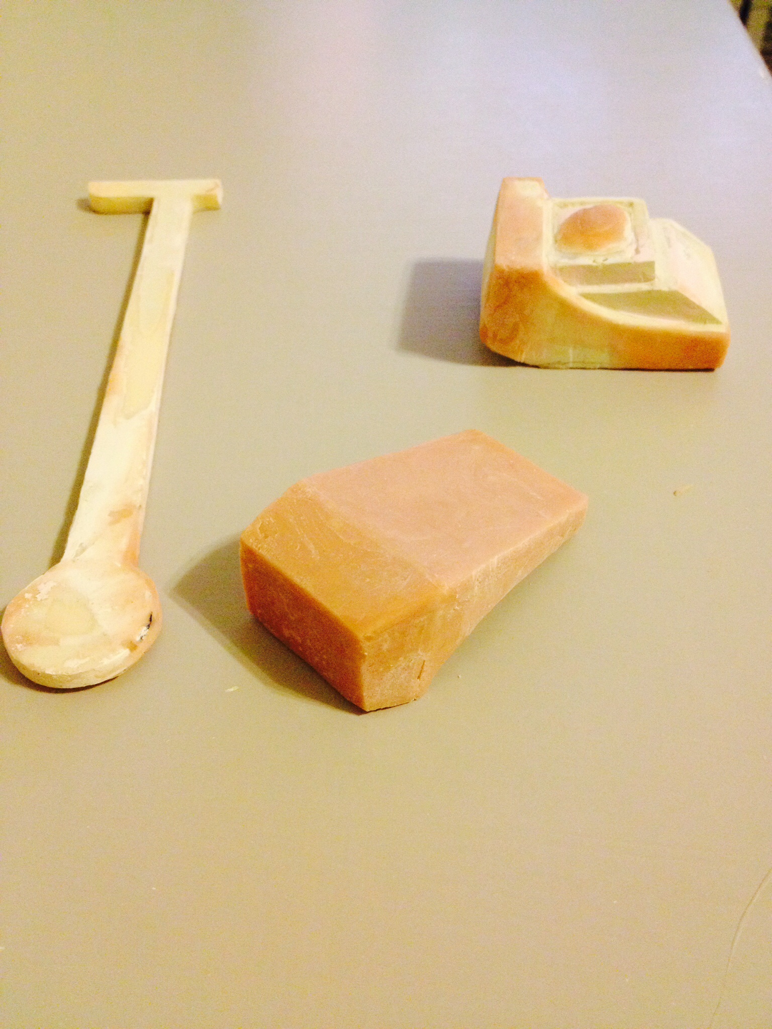

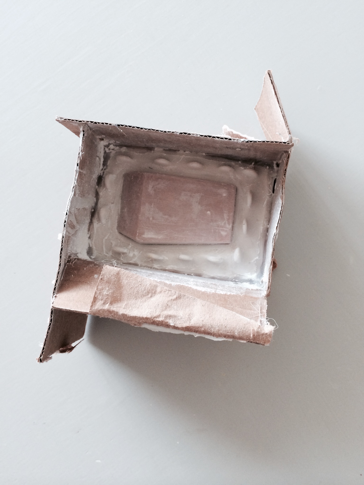

bild (5).JPG made some silicone molds that looks like shiiiit but they work fine and after a few tries they come out really clean!

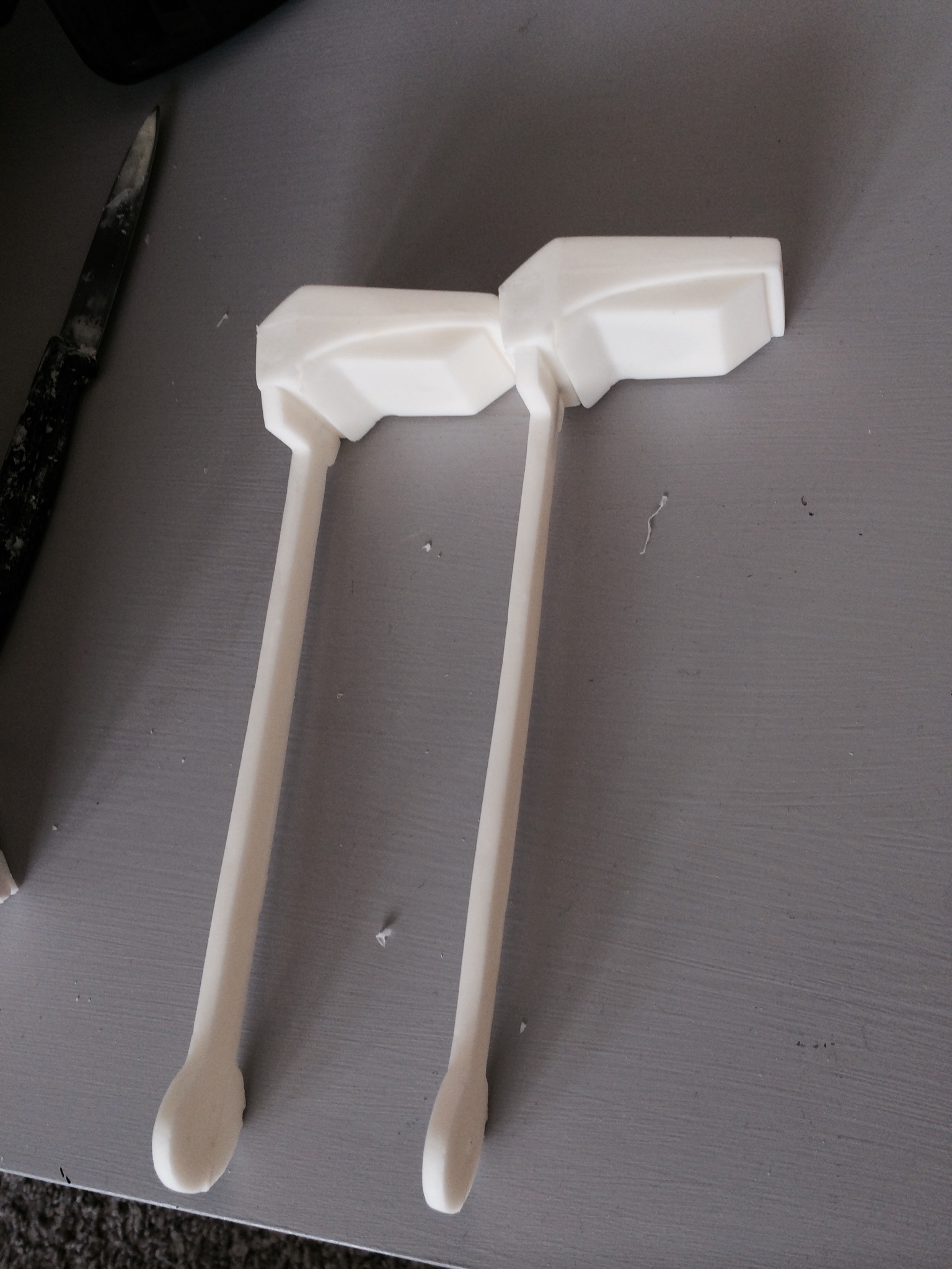

bild (2).JPGnow i know that the real deal is supposed to have clear resin but i dont have that at home so ive cast them in polyutherane harts :) rotj style so far. im thinking of making the litle greeble seperate so i can make both rotj or esb. :)
bild (3).JPGtried out some lights in it looks kinda good huh? im realy pleased with them anyway.
thanks for looking feedback and comments more than welcome!
