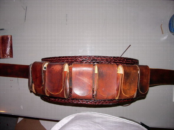

From this to this...Jango girth belt results
Cruzer
Here's a couple pics.. the others were blurry.. :lol:
and actually there's too much flash as well.
That looks really good Kivas.

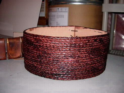

To give the nooks and crannies some color, spray it in small sections with some brown spray paint and then immediately wipe the spray paint off of the top surfaces. This should leave spray paint remaining in the cracks and darken them up. I used primer, then Walmart Colorplace brown, then a light mist of primer to give the nooks and edges a "dusty" look. You could also use black spray paint but then this would darken up the nooks and crannies big time. Be sure to work in small sections (5-6 inches) and wipe right away or else the paint will begin to dry on the surface areas of leather where you want your brown stain color.
