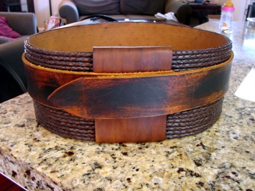

Well guys here's the girth belt I was able to make with a roll of that bolo material we ordered a while back from India. I also included a couple pics of it with my Seeker ammo belt. If anyone who also ordered some of this stuff wants more explaination and build up pics, just let me know how I can help.

Man Cruzer:eek: you still amaze me everyday! Truly an artist. I would deffinitly be up for more details as im planning on starting my girth as well with the same sweet sweet bolo that you supplied us bucket heads.
:thumbsup: :thumbsup: :cheers
Is that cardboard or leather on the inside? Looks killer you need to open yourself up a leather hsop now! LOL
looks awesome, nice to see what the end product will look like
I finally went to the local Tandy store yesterday and picked up what I needed for mine :) weeee... I got the sanding part done, but figured the neighbors and my wife would think I was crazy if at 1am I was in the garage using Acetone..lol..
good job

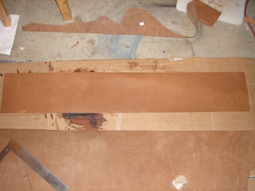

All right here are the few build up pics I took because the process is exactly like my other belt build up pics, with a few tweeks because I went full leather backing on this one, and of course the staining process was different.

  4. Cut out a piece of my leather backing to the dimensions shown. **Note there is correction made to one of the dimensions-the width of the belt should be 7", not 5 1/2" .

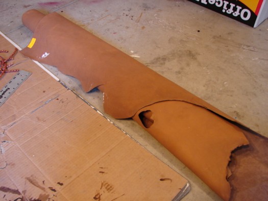

Also, I used some very flexible backing that is about 1/16" thick (maybe even a tad less) and I glued the strands to the "fuzzy" side so that when I wrapped my ends around the finished side showed and because I figured the glue would stick better to the rougher surface.

Kivas you bring up a good point about having to buy a nice "chunk of hide" just for the backing of this belt.
I need enough leather for 4 more belts and then I'll have extra I probably won't have any use for. I don't mind cutting and making pieces available for others who also bought some of this bolo material so they don't have to buy a whole hide like Kivas and I did. $10 should cover a padded envelope, shipping, and the cost of the material if anyone is interested. If not, I paid about $45 for my piece of hide in the "sale" stack at our local Tandy store.
