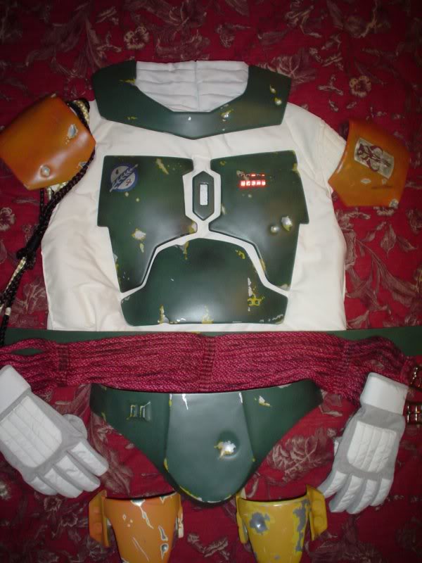

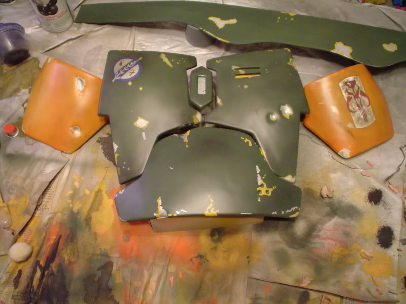

Okay. Here is a picture of my chest armor and shoulder bells. I hope this is all the work I need to do on them.

Here is a test fit on my vest. Looks pretty good over the new TDH shirts don't you think?

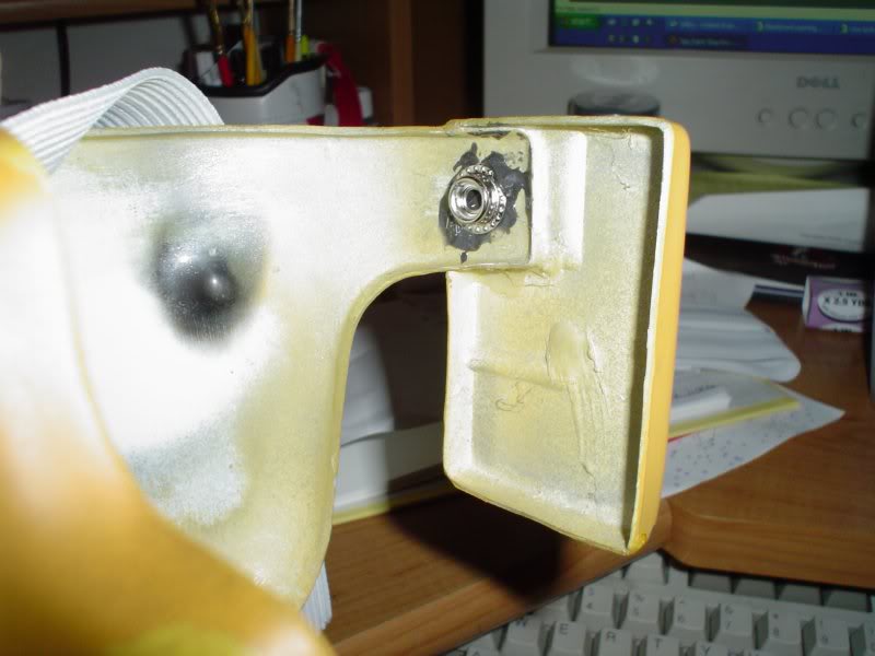

Here I have JB Welded on some snaps to fit the strap on the knees. Overkill kinda but I had some just lying around...

ARE YOU SURE you haven't done this before..????
SWEET GARY...SWEET..:cheers
LOVE THE WEATHERED "Work station/ newspaper"..:lol: nice color washes..

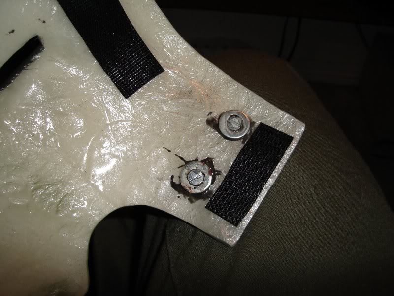

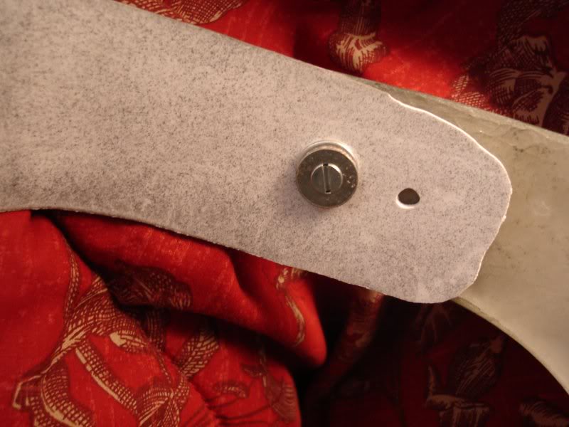

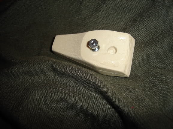

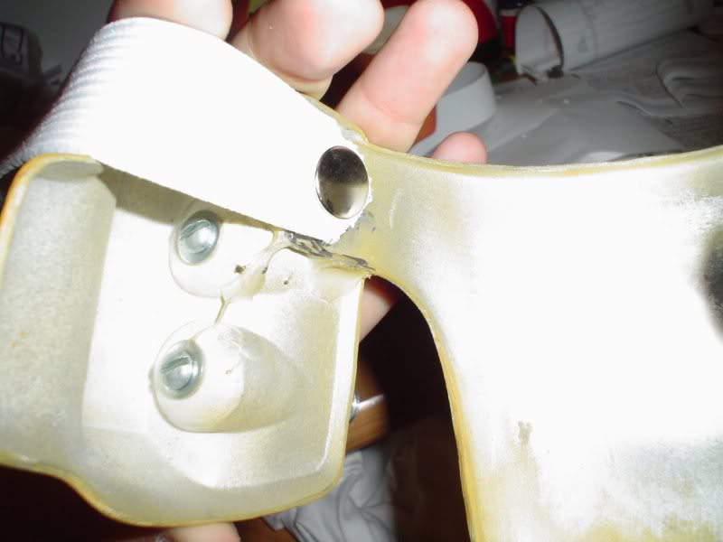

Here you can see how I attached the bolts to my back plate. I JB Welded the bolts in which helps me attach the shoulder "keys."
Next a picture of inside of the kidney plate attachment point. I didn't JB Weld in these since I can get my fingers on those easier.

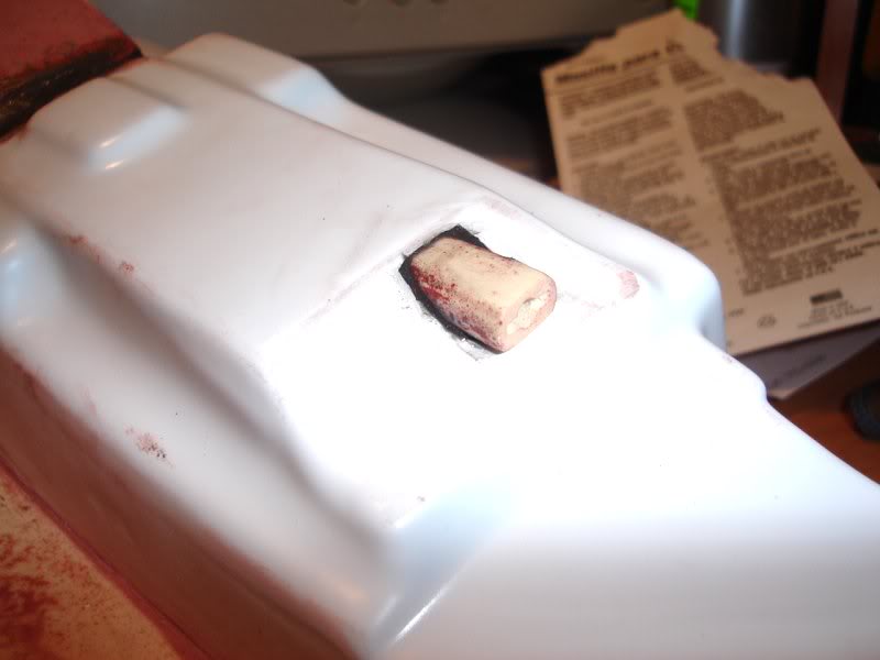

This is of my homemade key for my cod/kidney attachment. It is made of sculpey.

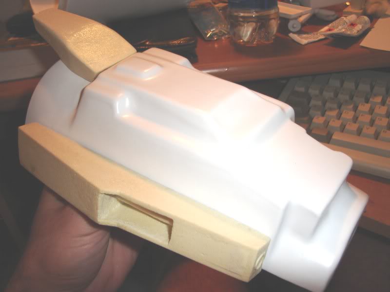

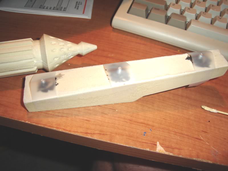

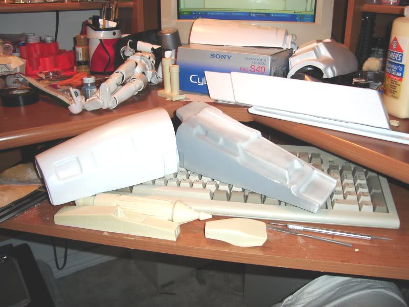

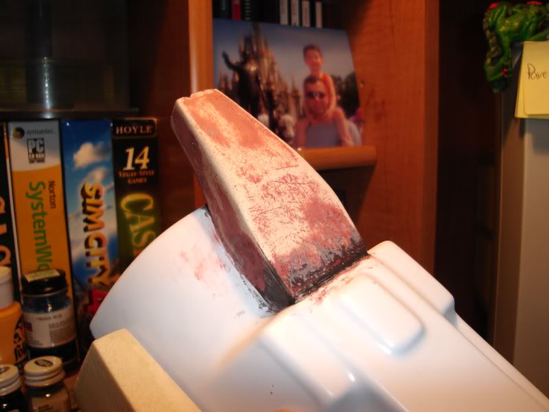

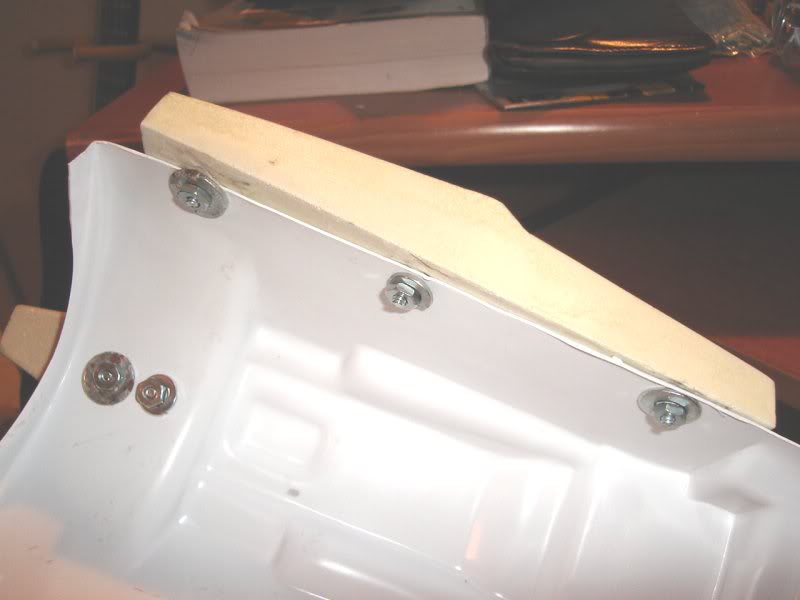

I got my gauntlets in the other day and I finally got time to start working on them. Here is a picture of the big parts:
I really had no idea where to start so I decided to attach the resin pieces to the vac parts and go from there. To make it as sturdy as possible, I dremeled out the resin pieces and JB Welded in machine screws (reverse of what I did for the shoulder keys.
After fitting them I have temp installed the resin pieces.

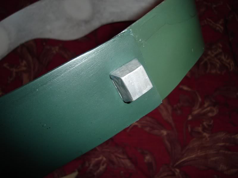

For the keypad, I sanded it down and then glued it in place. Instead of bondo, I used sandable wood filler to fill the gaps. If anyone knows if that was a bad idea or not, please let me know. I haven't sanded it down all the way yet!

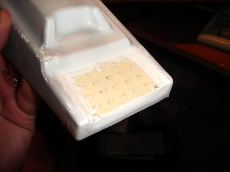

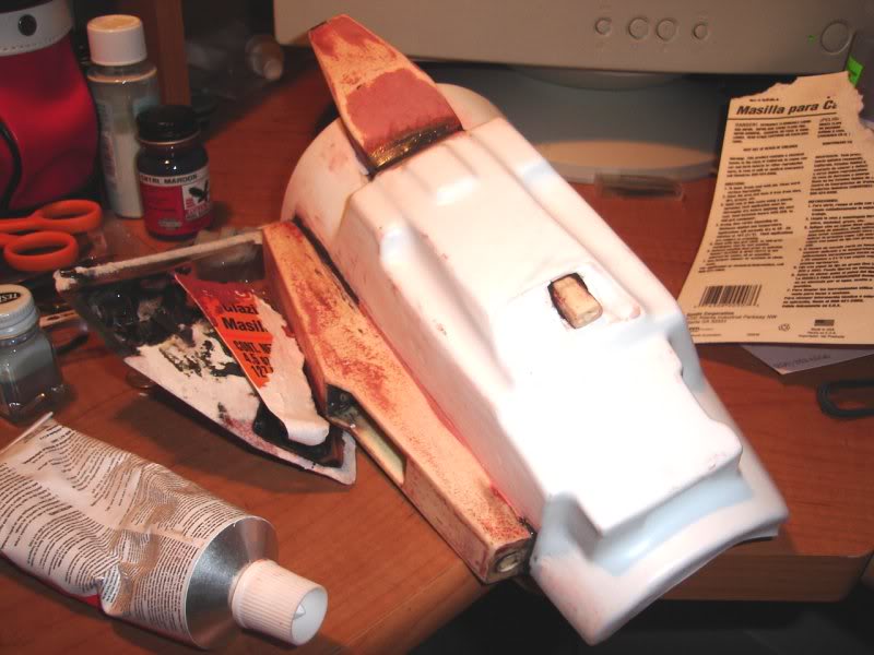

Alrighty. Here are a few update shots. I got some Bondo in a tube the other day and it works pretty well for small stuff. I also am digging JB Weld for big gap filling. Here you can see some pics of my right gaunt after being filled and sanded. I missed a couple places but as luck would have it, they came out looking like nicks.
