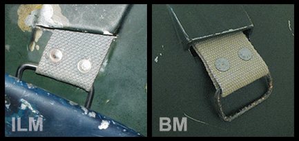

Finally made accurate JP Straps
bobamaker
I finally found some canvas strap that was the right width, I just needed to dye it to the correct colour. I couldn't find the metal loops with the correct dimensions so I sourced some D Rings that were very close and re-shaped them using two pairs of pliers. For the metal studs I used a couple of galvanised nails, pushed them through the strap, cut off the excess shaft, dropped on a small washer and mushroomed the nail (like a rivet) over the washer using a hammer.
I made two of these straps and have sewn them to my harness, I'm very pleased with the results.

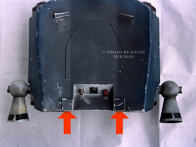

Hey Ben
They way I interprate this picture is that It appears the lower clips do not stop the JP from lifting up, they just hold it tight to the body, I've made the lower clips on my JP this way.
DAZ
