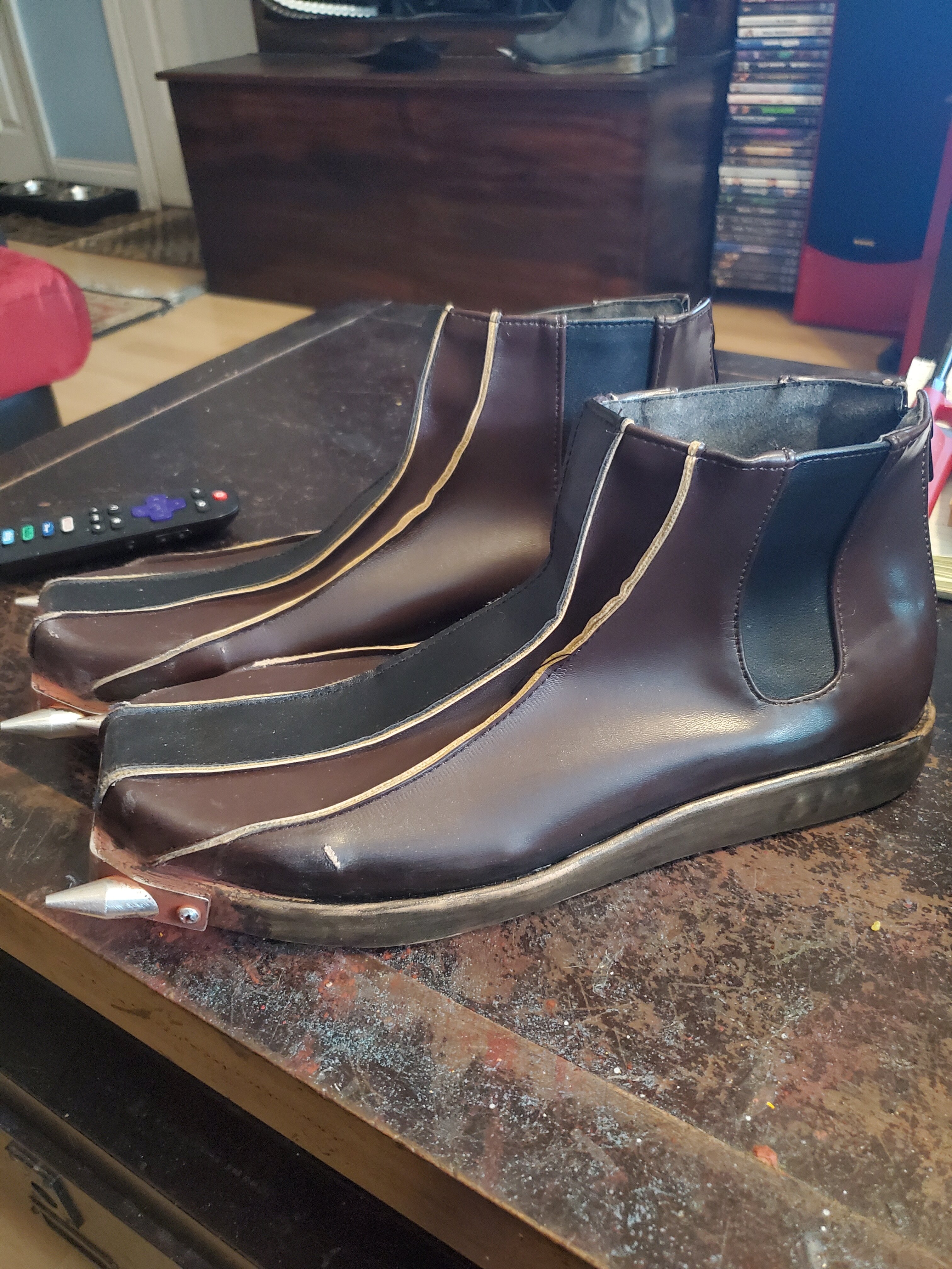

These boots are marketed as "space cowboy Beebop" boots lol. But they have this brownish tan scheme that I would have sworn the pre pro 2 boots had, until looking at references now.
I decided I want to build this suit for me and I will make it stylized. So I'll use my cheap ebay brown boots and run with things from there. It's funny how one item can start a whole costume.
So without further ado, I will walk through my build. As of now I just have the boots, gloves, and working on the shoulders. So this will be a slowly evolving thread and I will update it as much as possible but there may be large gaps as I am building this in real time.
So here are those boots, pre weathering and having just attached Quest boot spikes. I will say, these boots are very comfortable and I ordered a size up thinking that like all things from China, the sizing would run small, however it does not with these. I just added some insoles to take up space and they work just fine. I will update you on the weathering and finishing of these as it happens

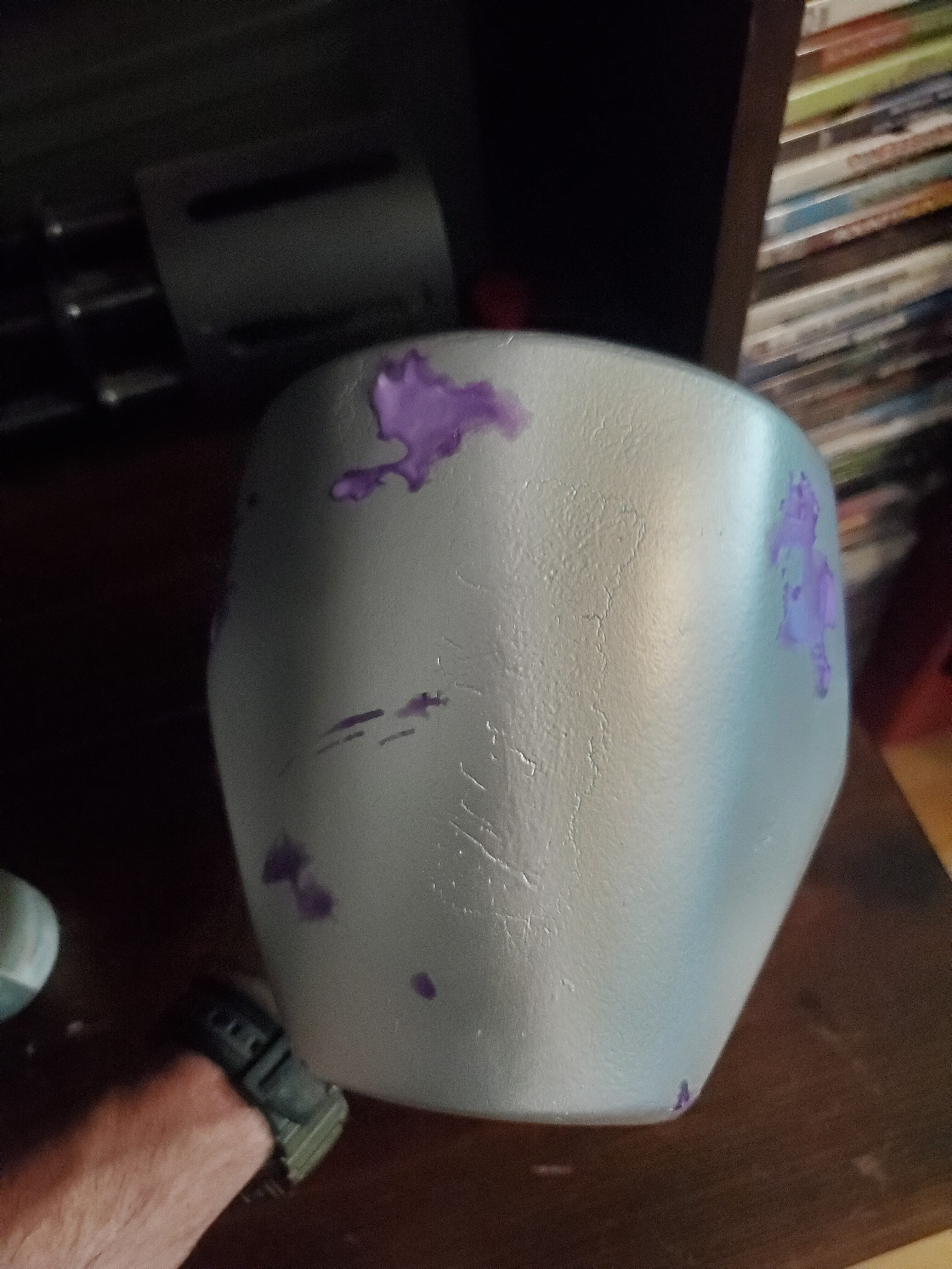

Next up is the shoulder armor. I am once again using Quest brand esb shoulders and had to use a heat gun to "undent" and then re-dent the right shoulder. I also used some filler putty to fill the dents on the sides and used my palm sander to smooth everything out.
My base is Rustoleum filler primer and then Duplicolor universal silver( very smooth and tough base silver).
I am using Humbrol liquid mask applied with these little tiny pointy sponge brushes I got on amazon.

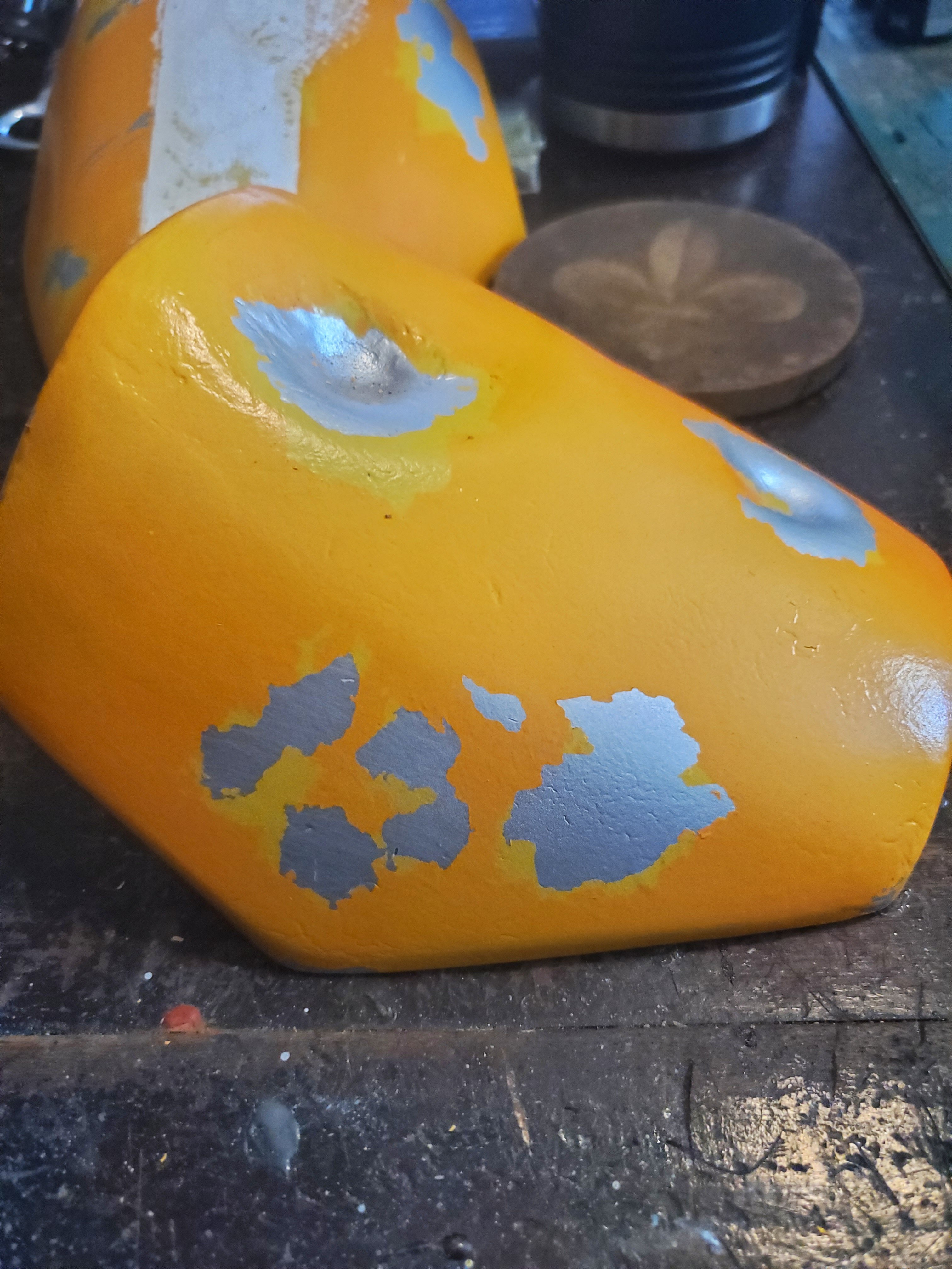

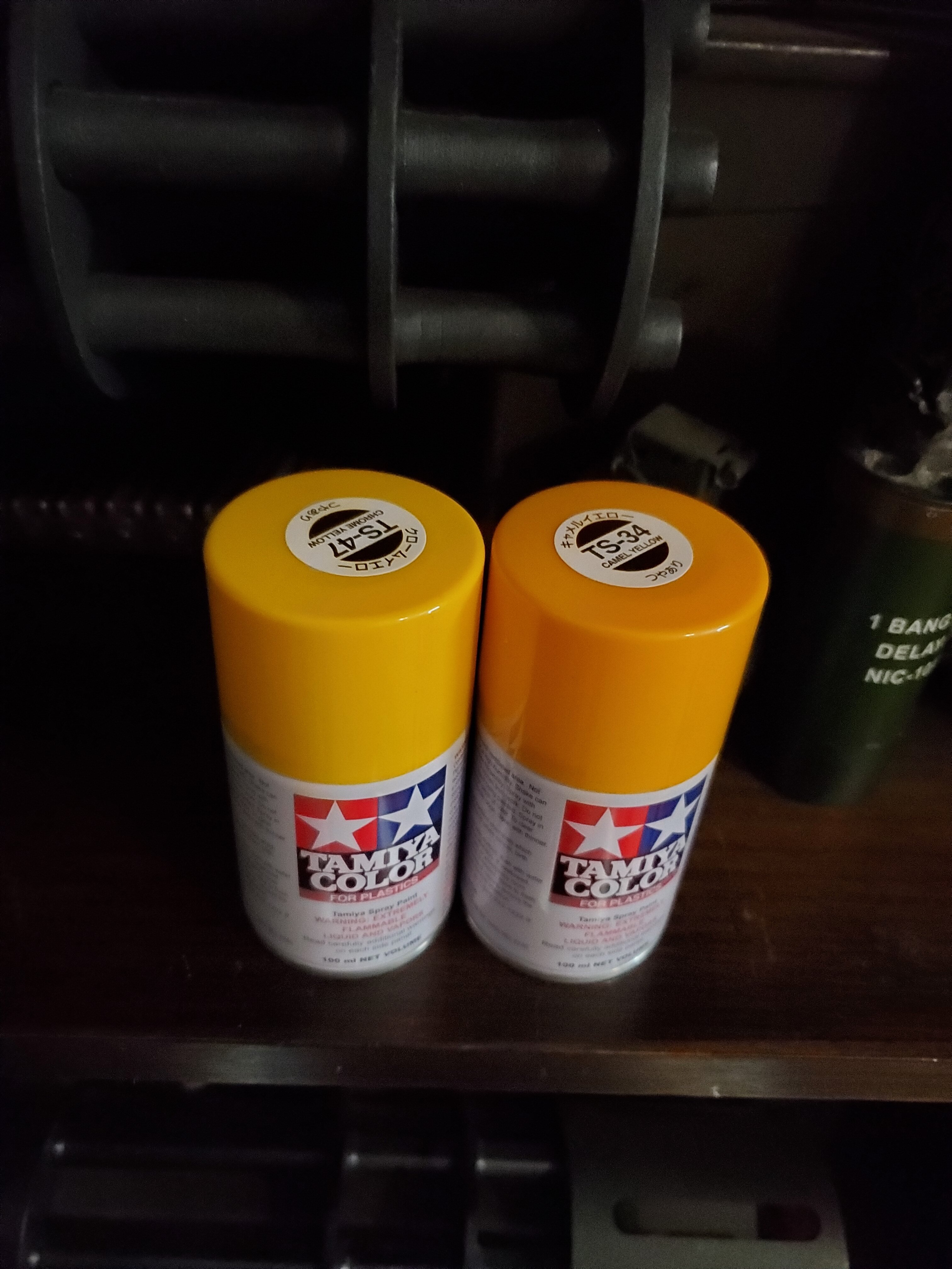

So I am using these two Tamiya sprays to achieve my colors. The lighter yellow being sprayed first then masked then I spray the darker yellow.
I also used line striping orange misted over that final darker yellow to punch up the contrast a bit. This was done at a distance, basically creating a cloud of orange mist and dragging the plates through it.

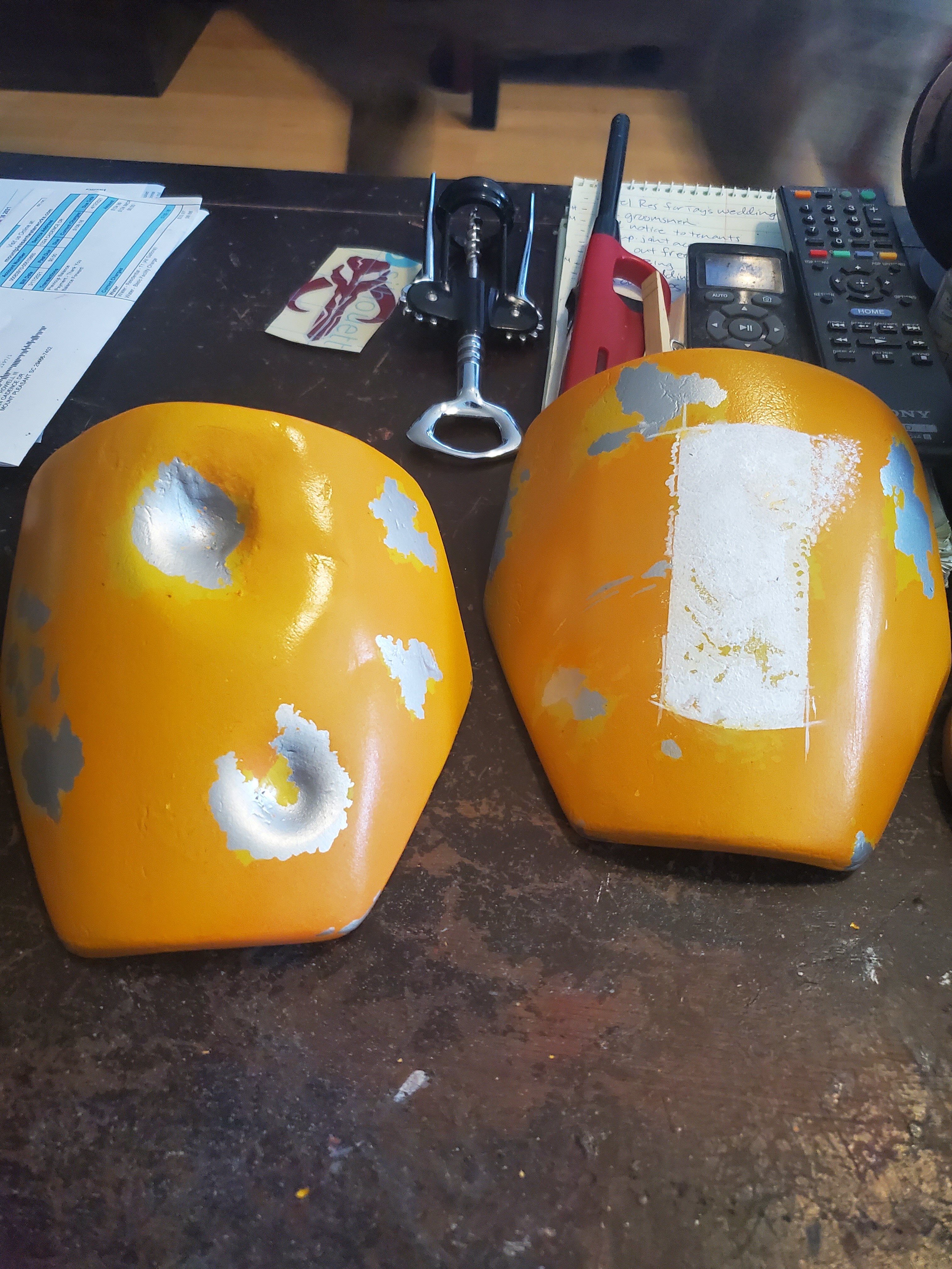

Here they are unmasked, and I have started the skull. I just taped it off and fused a sponge to dab the white paint on, then un taped it and used a fine brush and sponge to start working the overstay splatter and lining, still working on it now so this is where I am at with these.
Hugw shout out to Rafelfett for his amazing work on the templates!

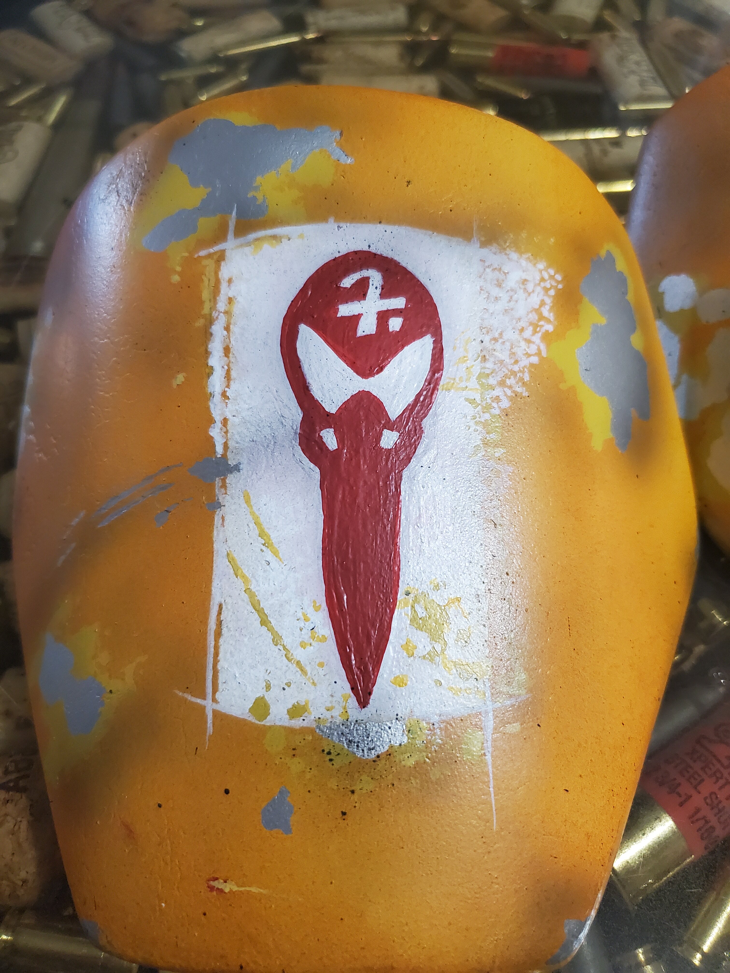

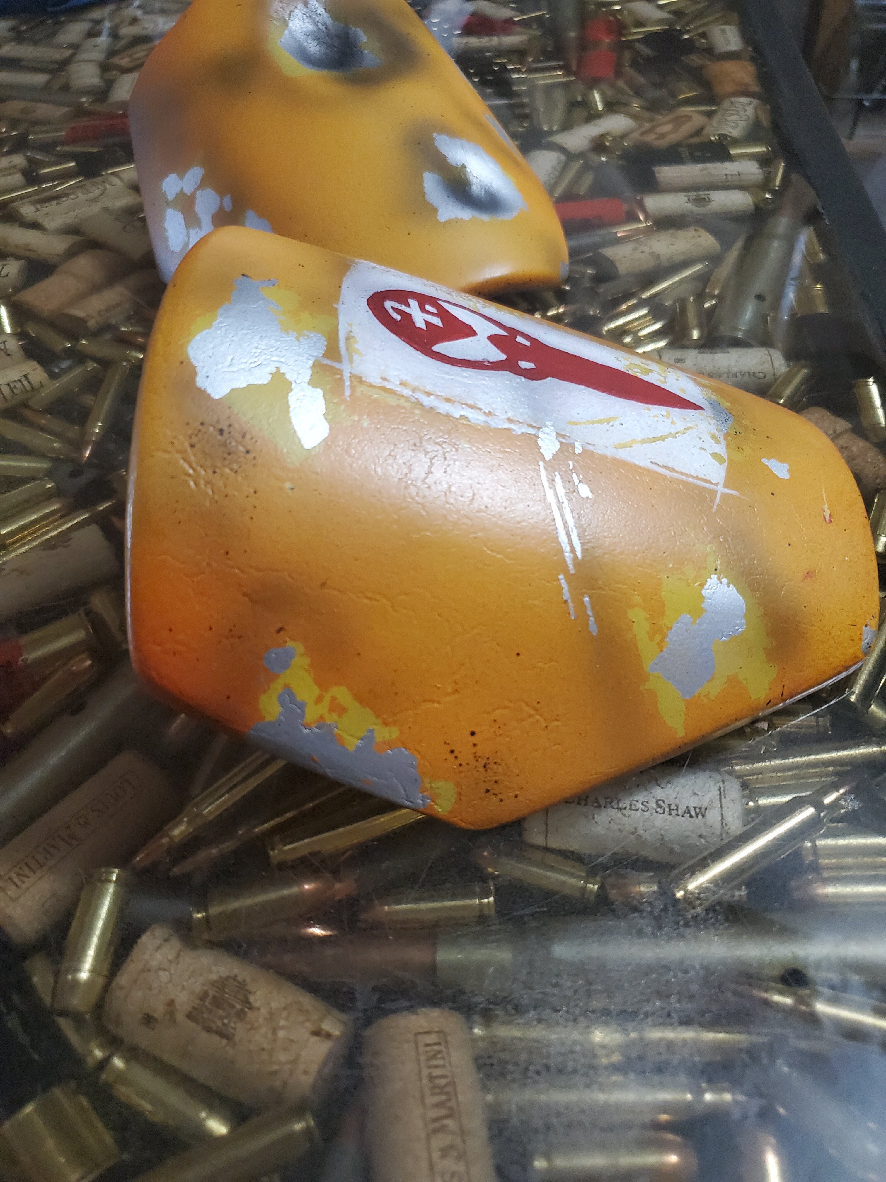

I started to hand paint the skull on the shoulder armor. This is a deceptively simple yet complex shape. It has taken many times to get it right, it's asymmetrical and looks to be hand painted on the real thing so trying to replicate the asymmetry was difficult ad I kept wanting to make it symmetrical.
I still need to tweak it but it's mostly there. I will lightly shade these shoulders with some airbrush work and call them done. The PP2 shoulders appear pretty clean and lack any scorching or blast marks and lack all of the cool "accidental" paint apps and damage that other shoulder have.
Ad stated, since it's "stylized" I may add some weathering to make it more interesting but I'm trying to not go overboard.

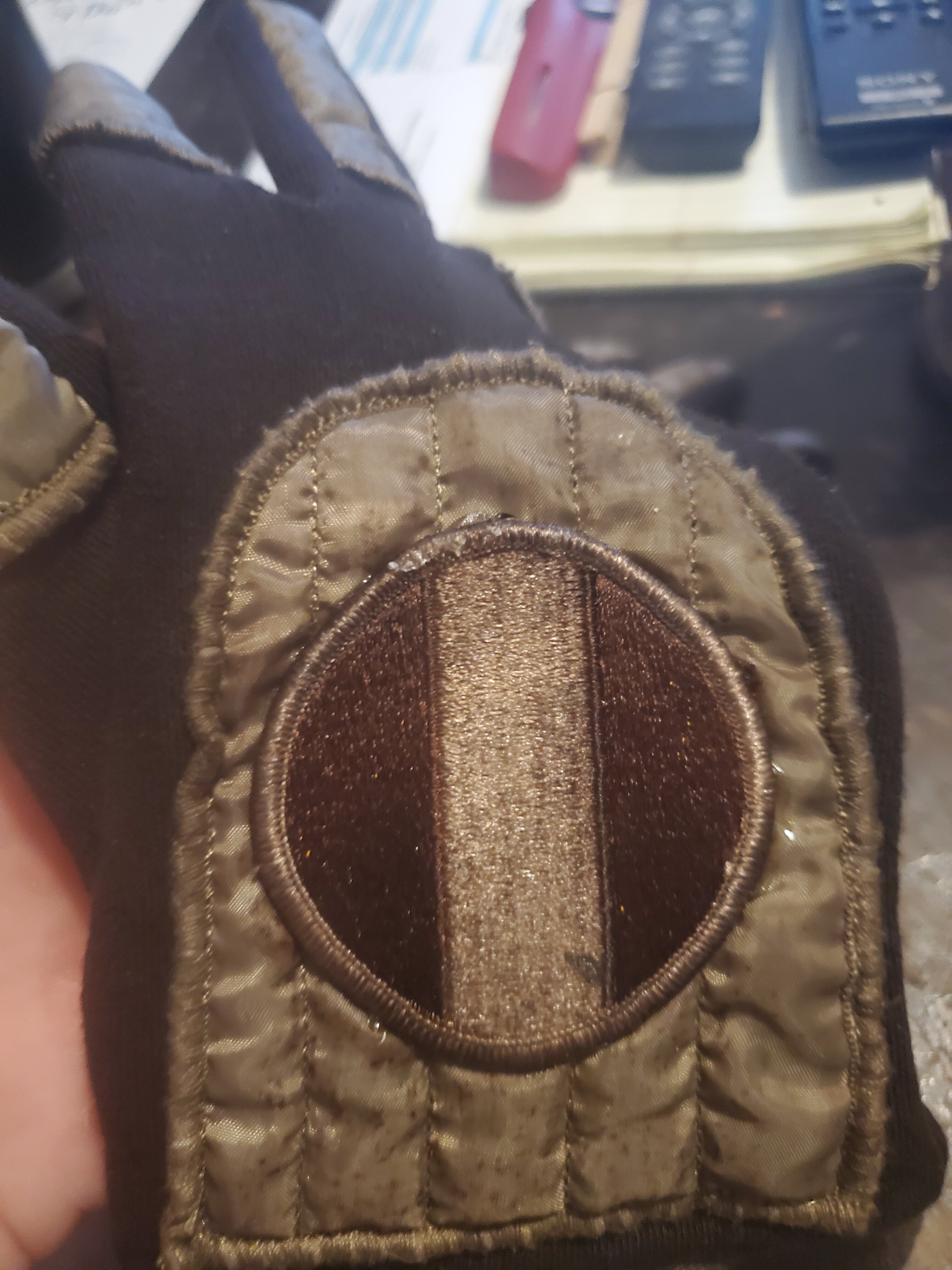

While I work on the shoulders, let's show off the gloves! So I scored a set of ESB gloves and ROTJ gloves on Ebay ( maker unknown, although they appear to be Man of War gloves but they are second hand).
Well the RoTJ gloves are going with my SE suit and since the Pre Pro gloves appear to be ESB gloves dyed brown. I thought I would give it a go.
So I picked up the desert version of the 7th infantry patch and had to do a ton of searching bc no one talks about what the other patch is, its the Training Doctrine and Command Patch. They also have a desert version which I got for about 2 bucks on ebay.
Armed with some rit dye ( coco brown) for synthetic fibers I plunged both the gloves and the patches in for a looooooooong time. Man it took some time for them to soak up some color.
Anyways, here is the result!

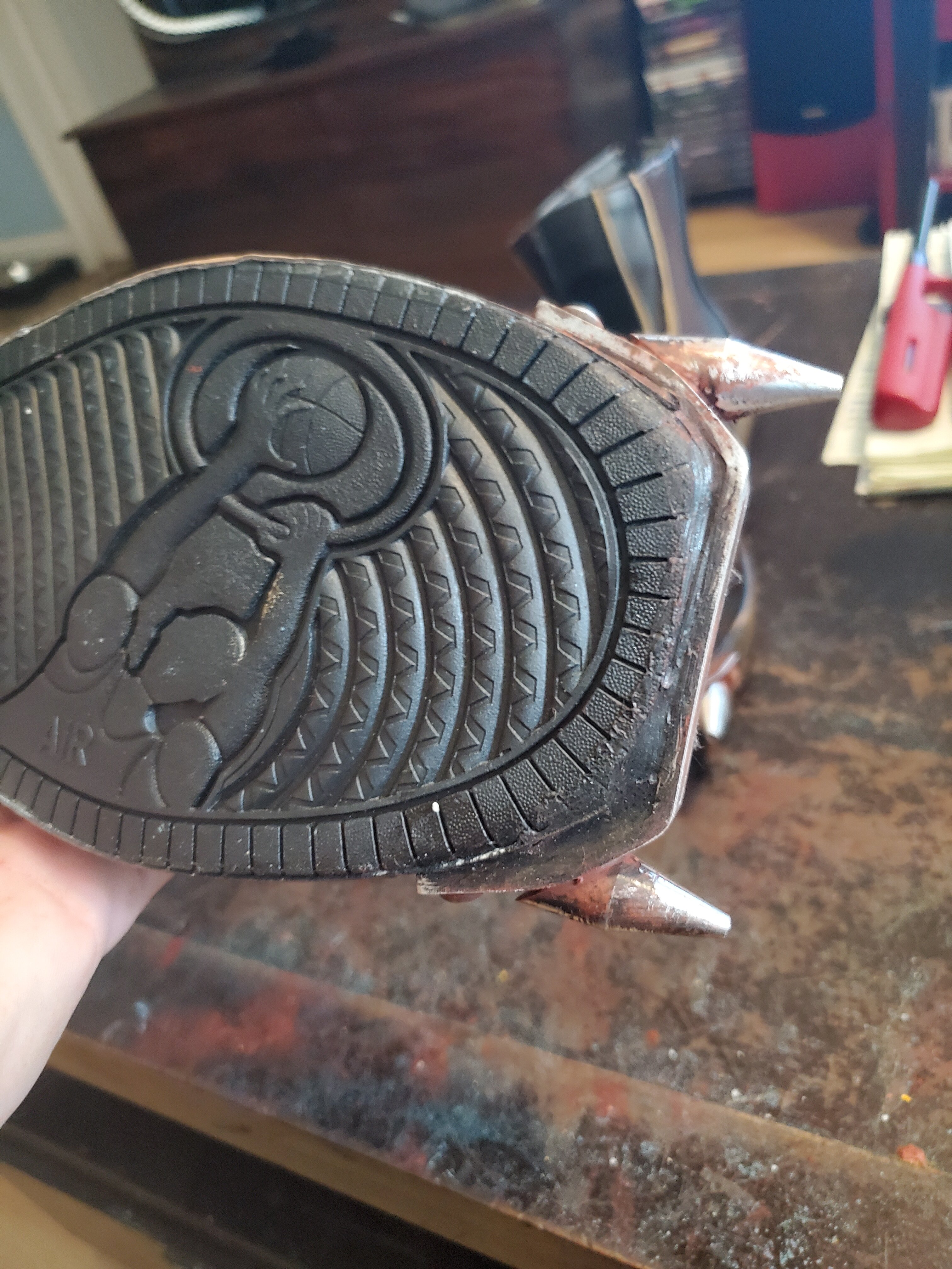

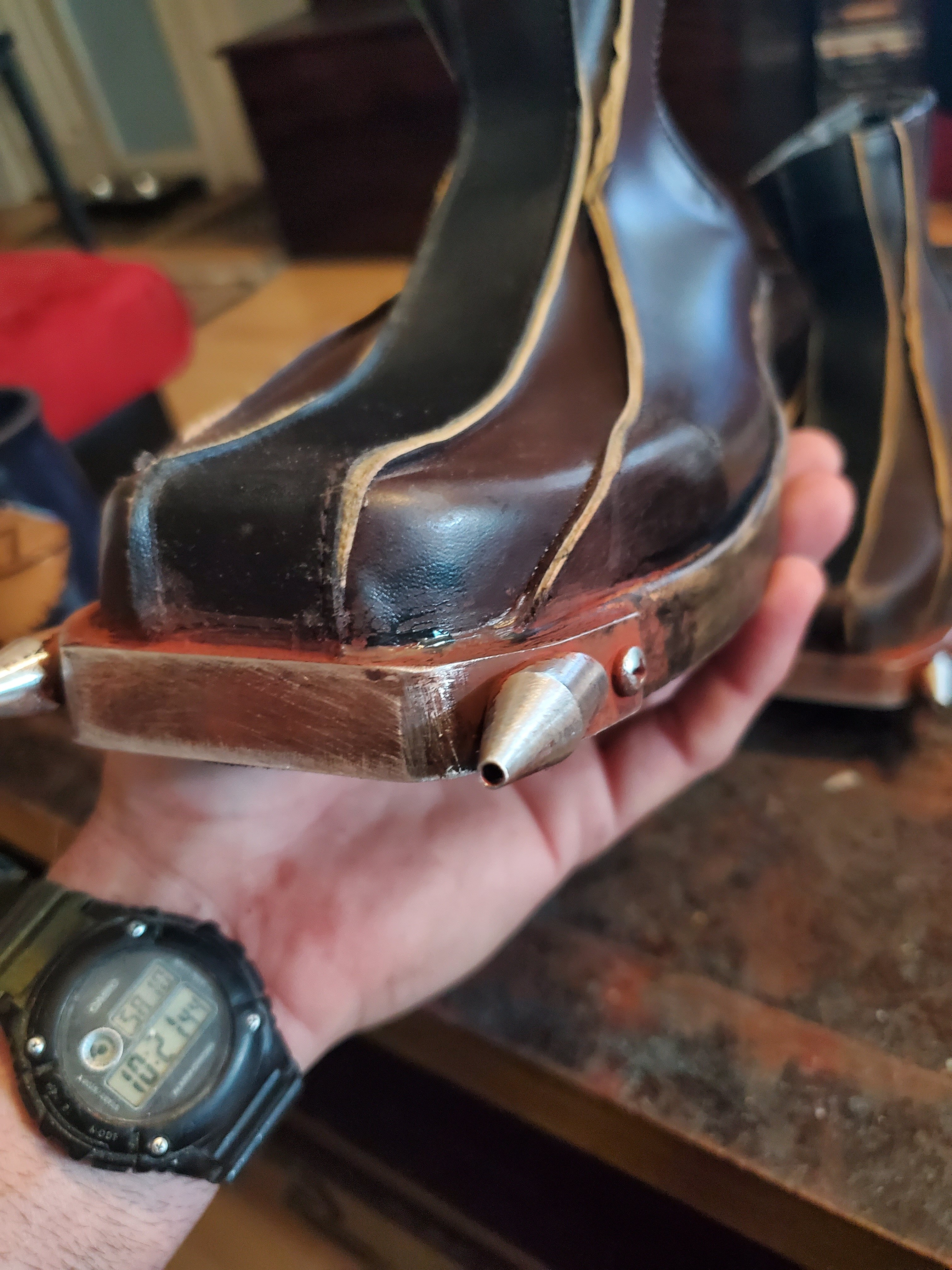

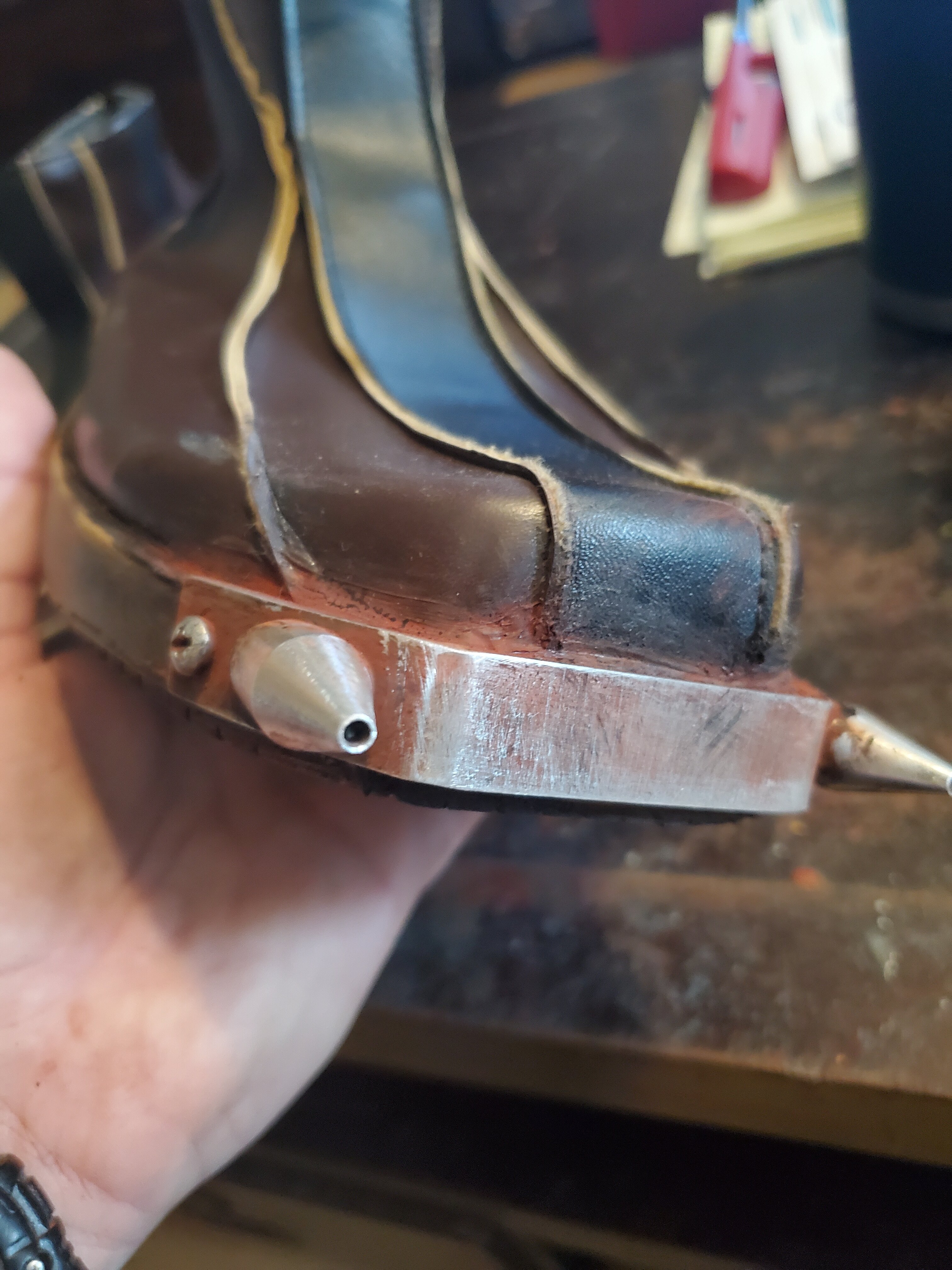

So now I can show you a little more of the shoes. I know ,I know, they aren't accurate, but they scream Pre Pro 2 to me and I like them! Lol.
So I used Quest( I can't say enough great things about Quest of Canada, they have quality machined aluminum Boba products at reasonable prices and shipping is fast to the states here, I also love thier armor parts as well, very nice products and nice folks!) spikes for them, I had to cut the front of the sole off a bit, basically shave it down to be flat so I could sit the spike strip back further and then gently bent the strip in a few places to better fit.
I used long (1" 1/2 " ) self tapping sheet metal screws to secure them and then filled the void in between the sole on both sides ( top and bottom) with black flexible automotive sealant. This stuff was great, it dried quick, to the consistency of hard rubber and really locked the spike strip in place and blended it with the boots.
I should also mention that before all this I unscrewed the spikes and used a bit of red loc tight on the screw for the spikes so they would wiggle loose.
After all this I used black acrylic paint to cover the soles and wiped it off. I did this a few times and achieved a darker color with some shading on the soles.
I then scuffed up the boot toes with sandpaper and used some dark red and brom Vallejo color acrylics on the spikes to age and "rust" them. I basically just brushed it on rather haphazardly and wiped it off. I then used Vallejo weathering powder "rust" to again add some color and finished that off with a buffing of sandpaper.
I plan on going in with an airbrush to shade the whole boot a bit more but I like my brown inaccurate "cowboy beebop" Boba boots!

Further notes about the boots, I will probably hammer the screw heads flat to get rid of the Philips head slots in them, and I'm still working on a way to get rid of the "air" logo on the outside of the soles, being Chinese loosely manufacturered boots I have a feeling these came out of a general knockoff shoe factory where they have some generic "Nike air" soles ( not the basketball logo on the bottom of the sole lol). I may just shave it off and repaint and weather the soles.

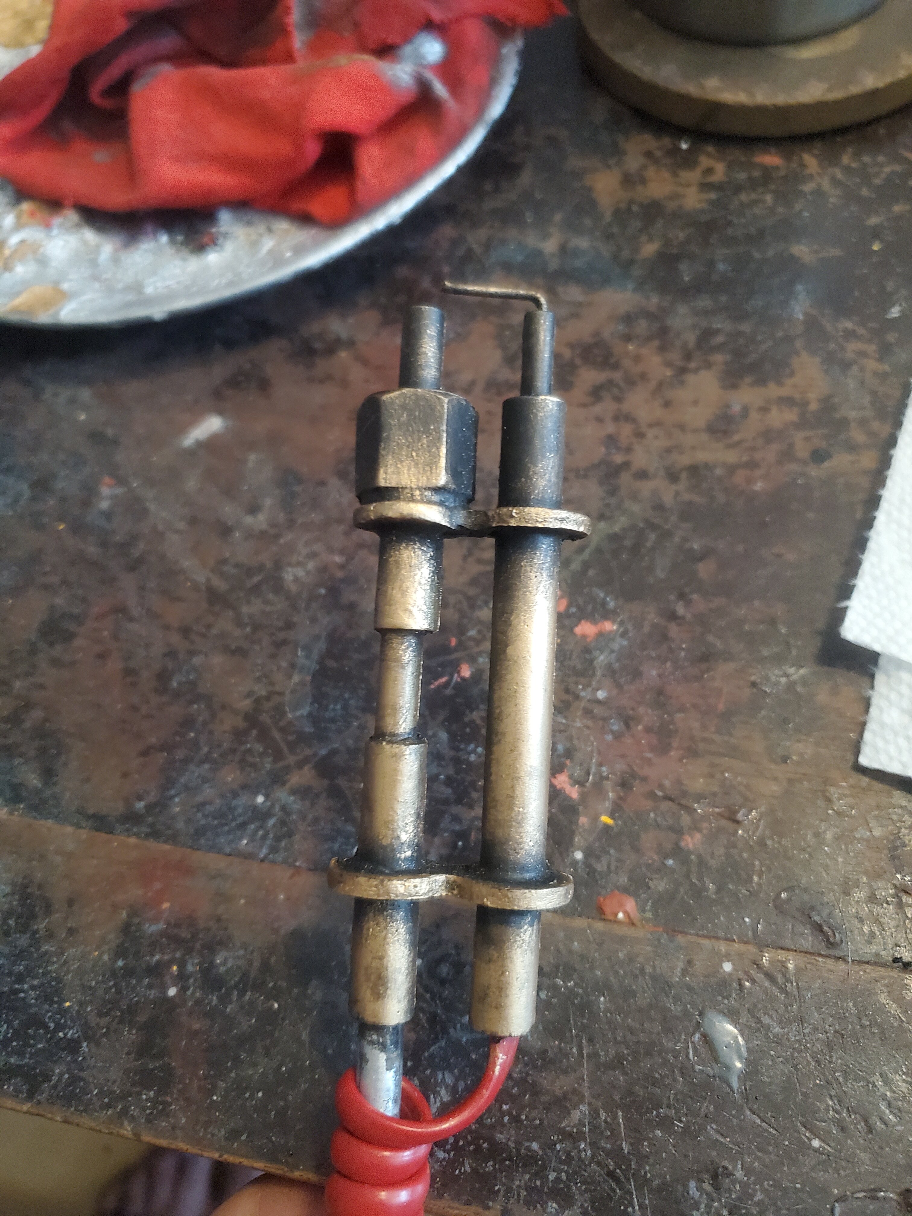

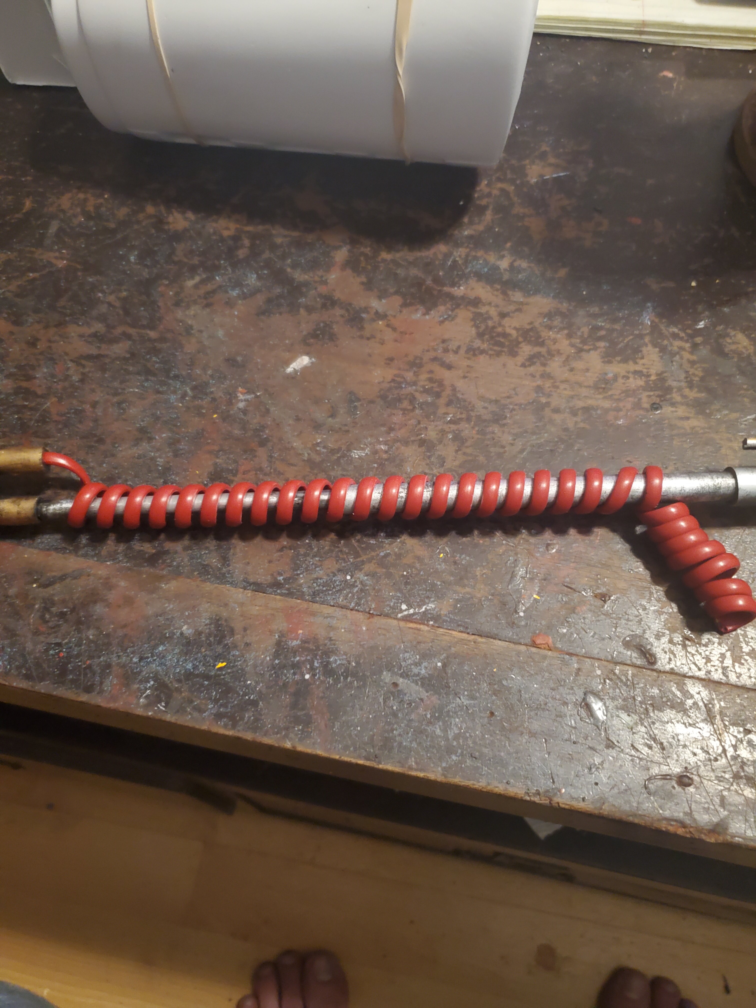

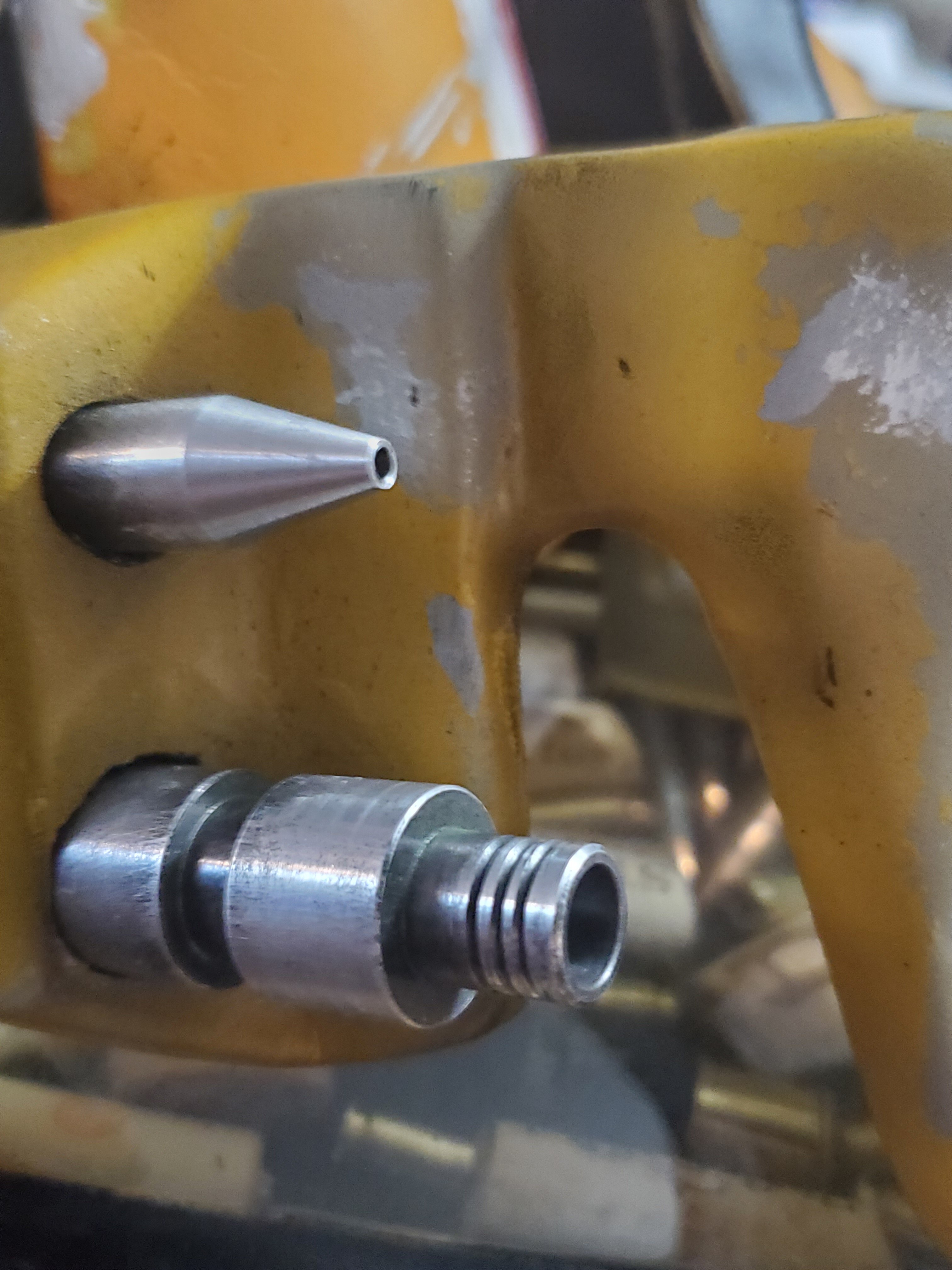

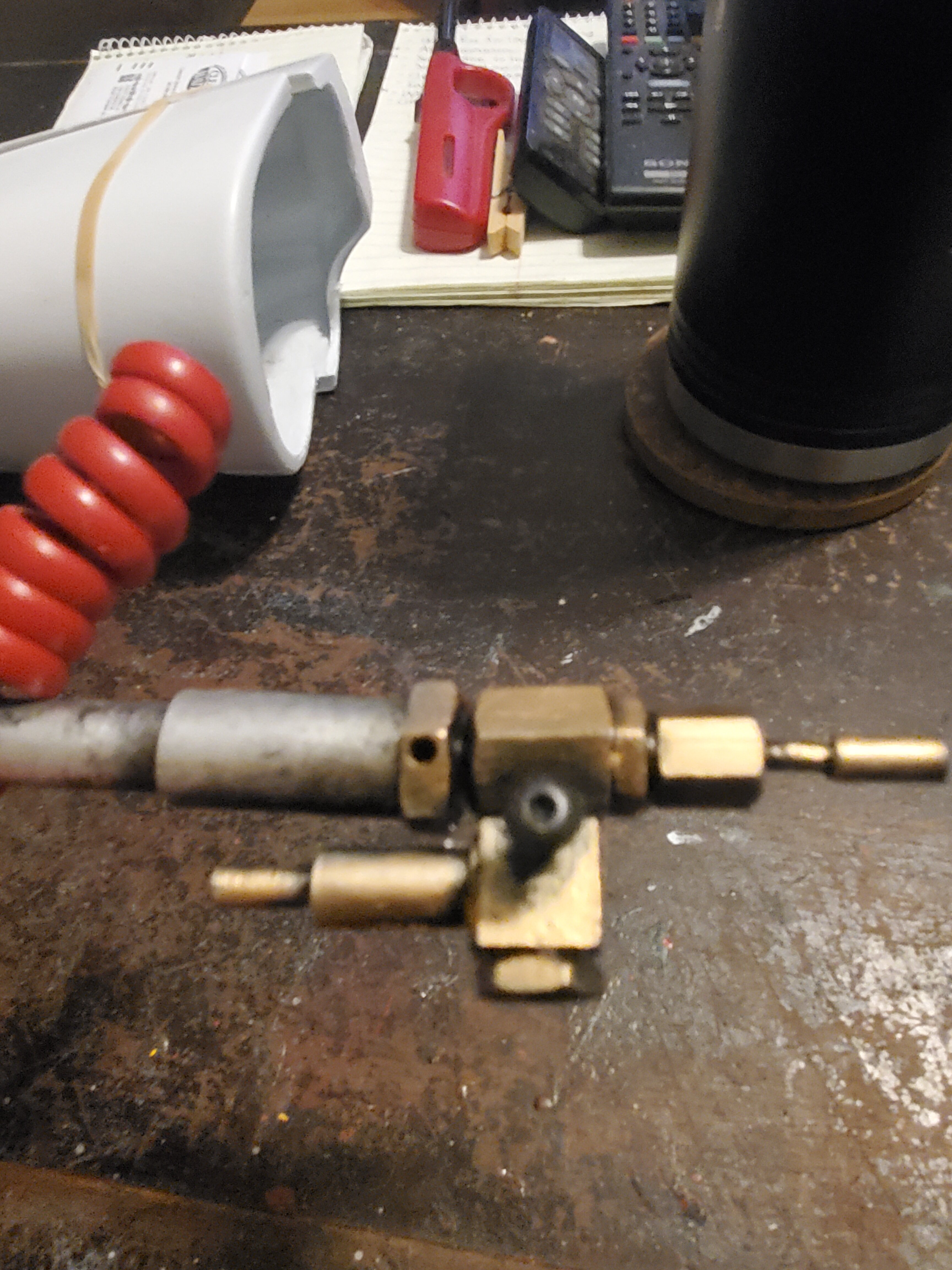

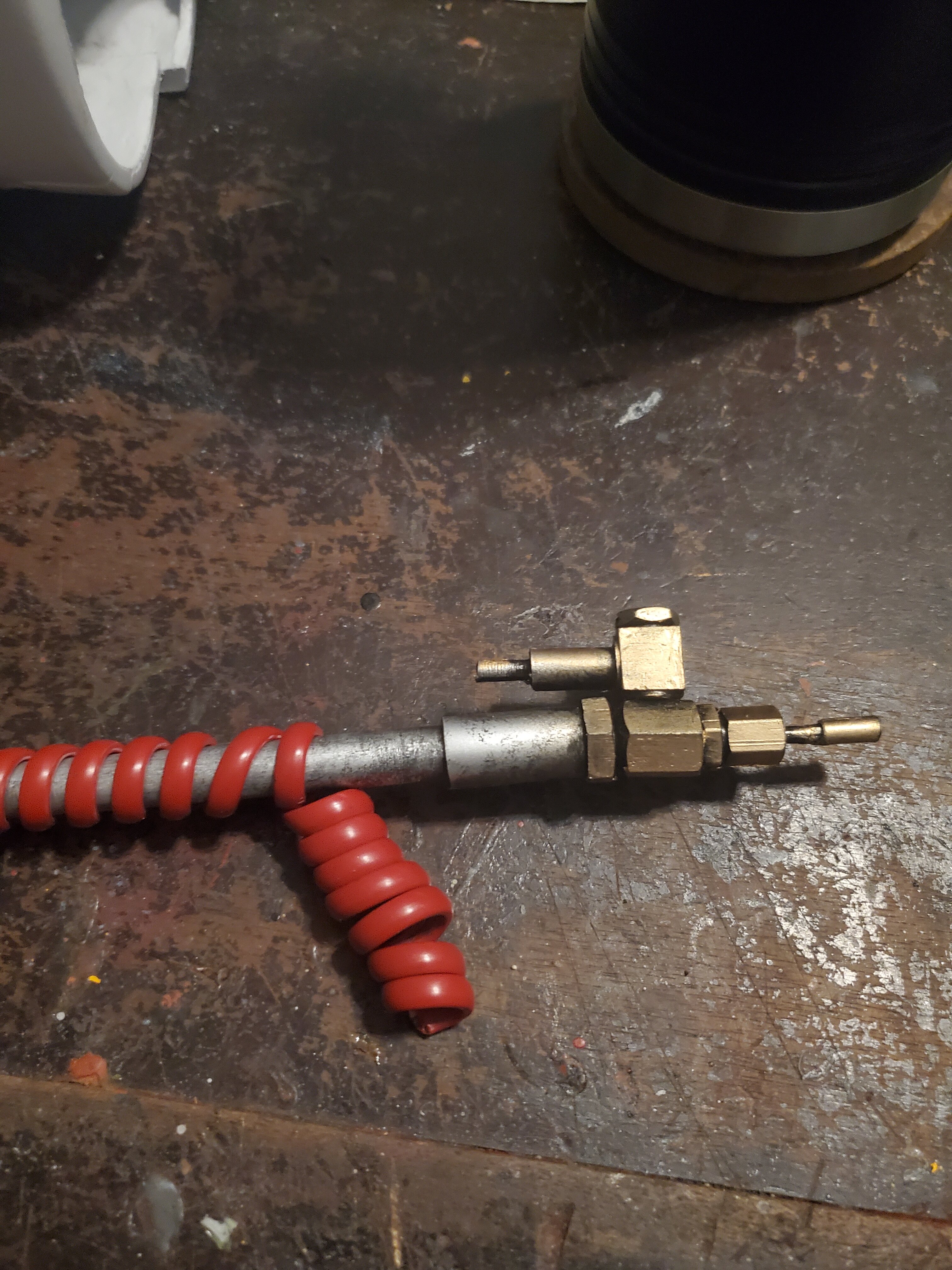

Little bit of work on the flamethrower, this is the Marco Enterprises part that comes with his suit. Its mostly plastic and aluminum tubing.
I used a red coiled telephone cord from. Ebay. I have only just begun weathering it and honestly I may change it to all metal but I'm also kind of okay with how it looks.
I hit it with black acrylic paint and used a scotchbright pad to rub some of that off and gold rub and buff on the brass parts.
I have a metal sheethed cord coming for the second hookup cord and have several additional weathering and small.parta to do. Juat wanted to give you an overall look at it.

Did some more work on the flamer, added the fuel tube to the front and coiled the red telephone cable around the right way this time (doh!). Added some soot and rust staining using Vallejo pigment powder.
Honestly, I think I'm going to leave it as is. Changing everything to metalnis cool and all but this it light and after some rub and buff gold it looks pretty cool. I have added another section of aluminum tubing on the inside to tighten it up but it still extends and retracts. There are two screws already on the side to attache my mount brackets too. Juat waiting on my metal sheethed USB cord to come in from China ( ugh, should have just gone to Walmart), to replicate the second cable.
I'm honestly shocked at how well this was made from the Marco Enterprises costume. Literally all he had was the old promo photos and he got it shockingly close!

So I went a little.heavy on my weathering on the shoulders so I repainted them fro. The ground up, here are the shoulders now with a little stylized weathering
