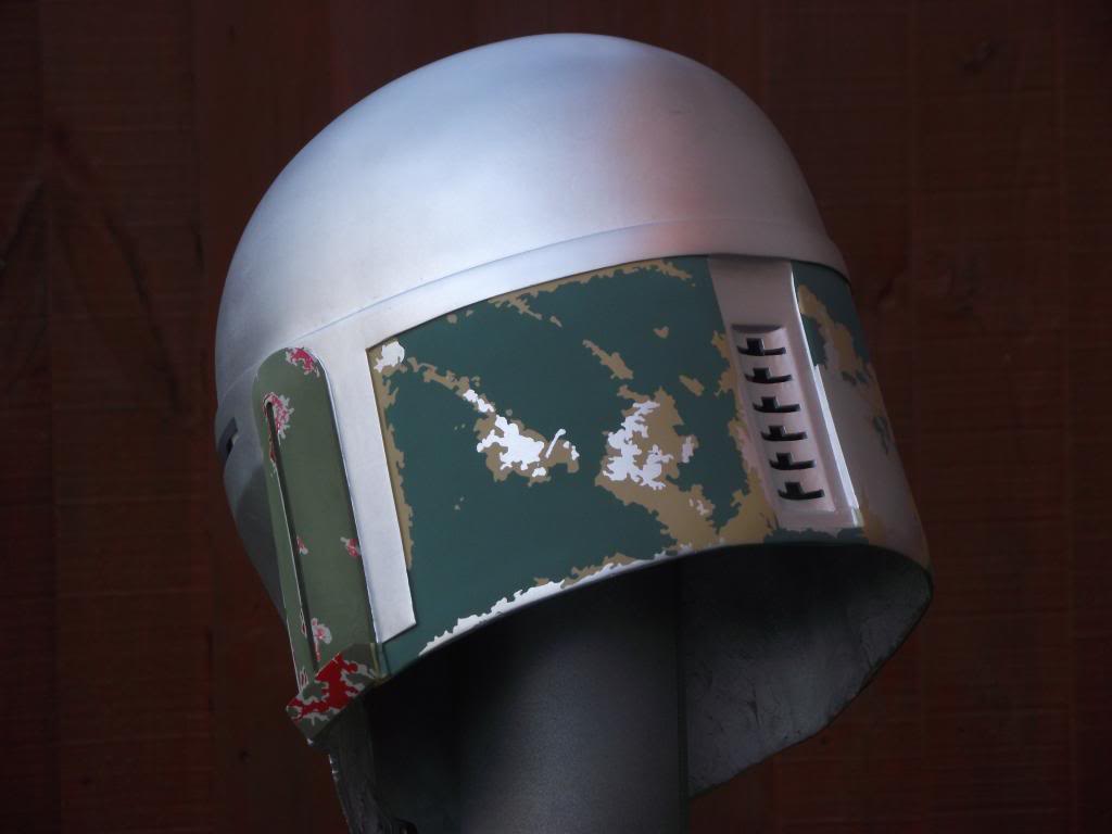

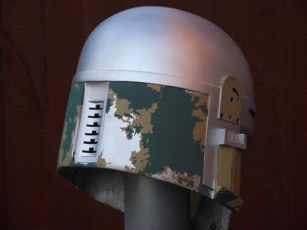

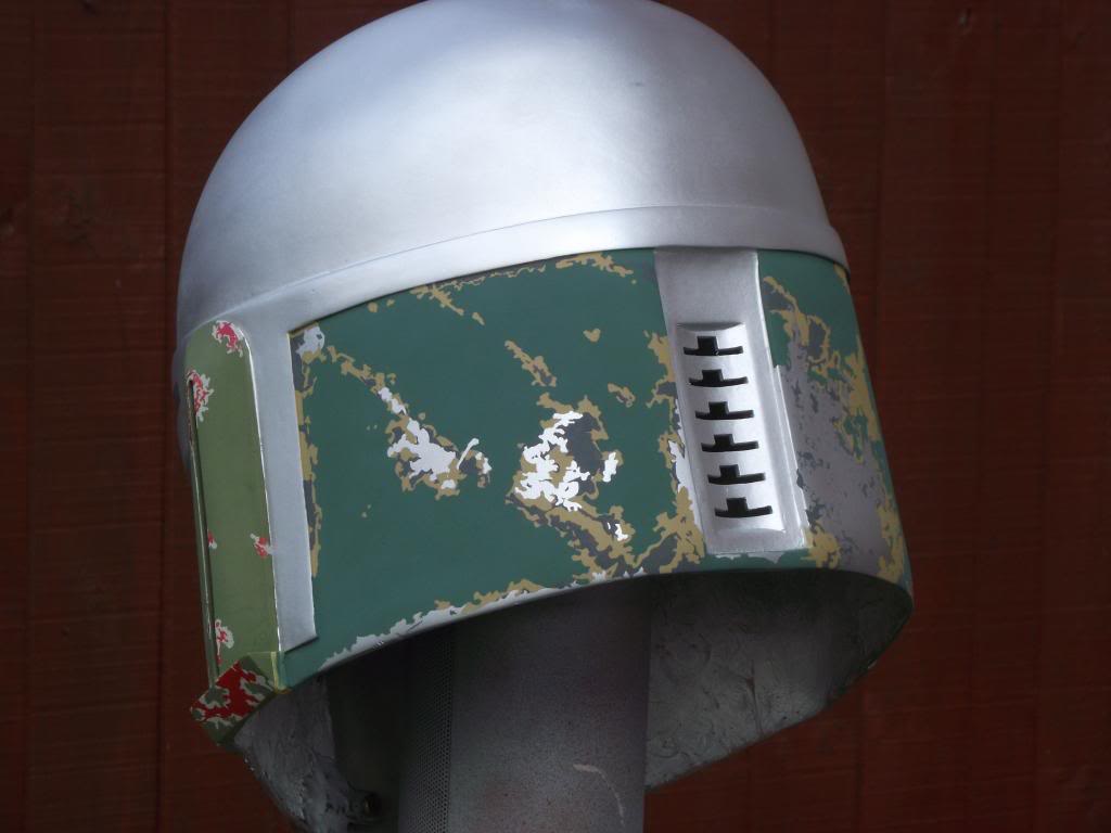

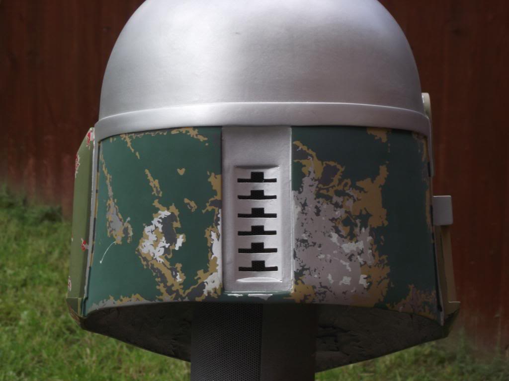

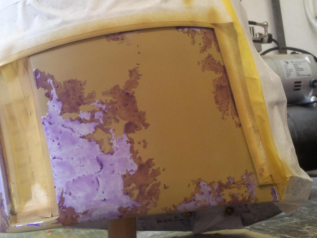

So I started to paint both the ears first, and naturally didnt take any photos of the process. So I jump straight in with the back panels. Usually I do a full layered paint job, going from silver, to the grey, beige then the final green. But on the last helmet I did I left out the grey layer, doing this I found really helps me keep the beige an accurate size. So after the silver was masked off, the beige was applied and itself to, masked off. For the beige I used 94 and 103 mixed 1:2. I like this section to be quite dark.
The green was then applied, this is straight up from TF's paint list, which is 76+96, although I put a little more blue in than usual. Once the green is tacky I then removed the masking fluid with a needle to give me the near complete panels.
Its then a case of going in with a fine brush and hand painting all the grey 79 sections in. I find that its best to mix the paint quite heavily with some thinner, this gives you a good working time and reduces brush strokes.
Finishing it up then by appling the white areas inside the silver, you can only see these under certain light/angles but it really completes that busy right panel look I find.
All the panels need now are the physical scratches and the misting of black plus a wire wool. Next up will be the dome and front cheeks.

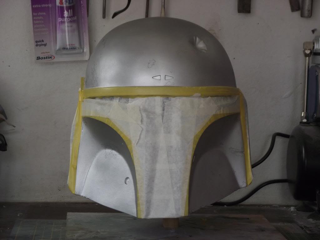

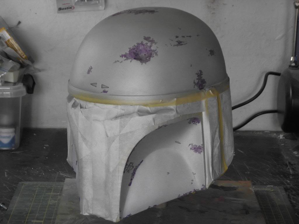

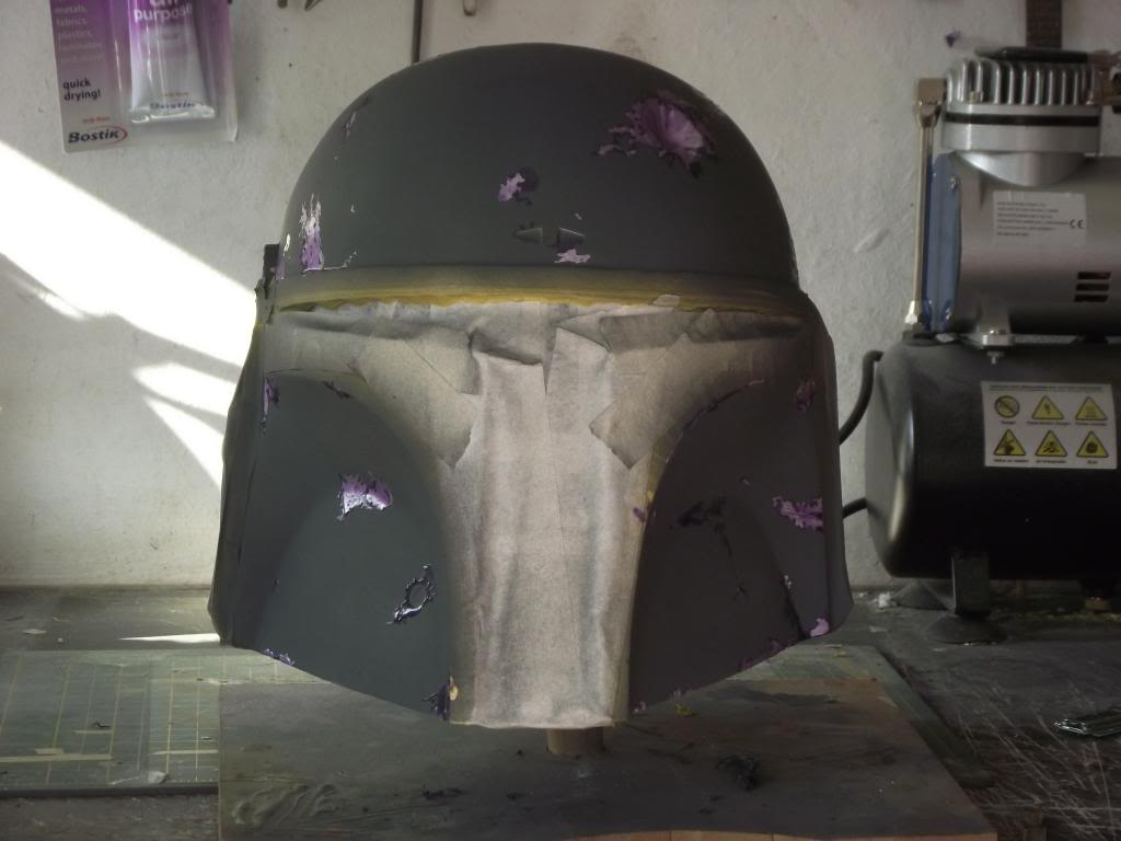

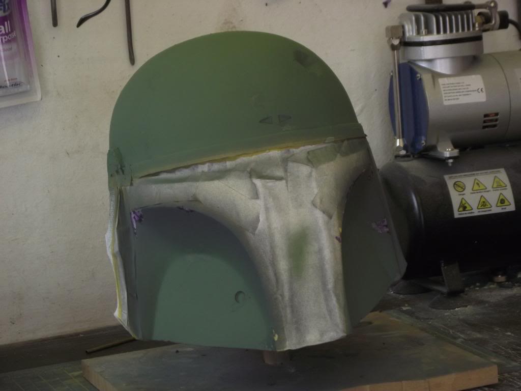

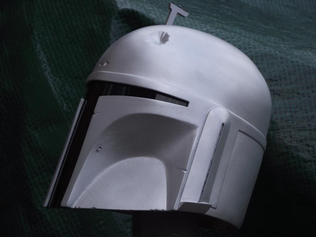

So with the helmet, I managed to get a good weekend in on it. So firstly I had to paint it silver, well if it wasnt all ready silver, so I went ahead and drew out all the silver damage;
Followed by masking it out with Humbrol maskol, I love this stuff.

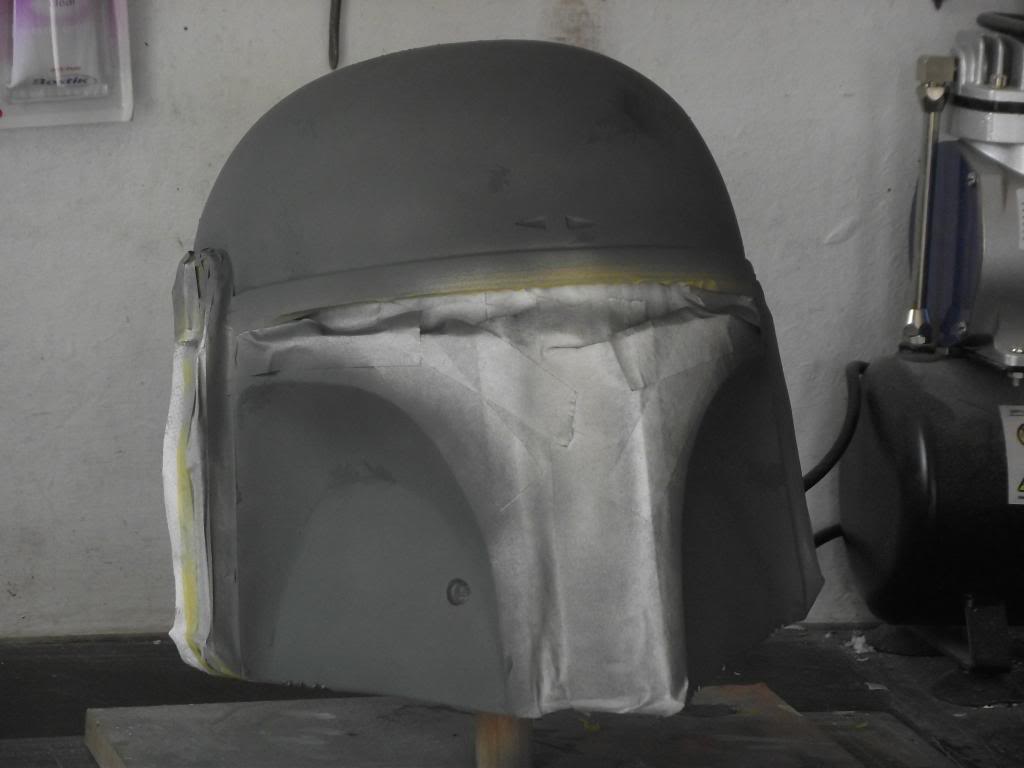

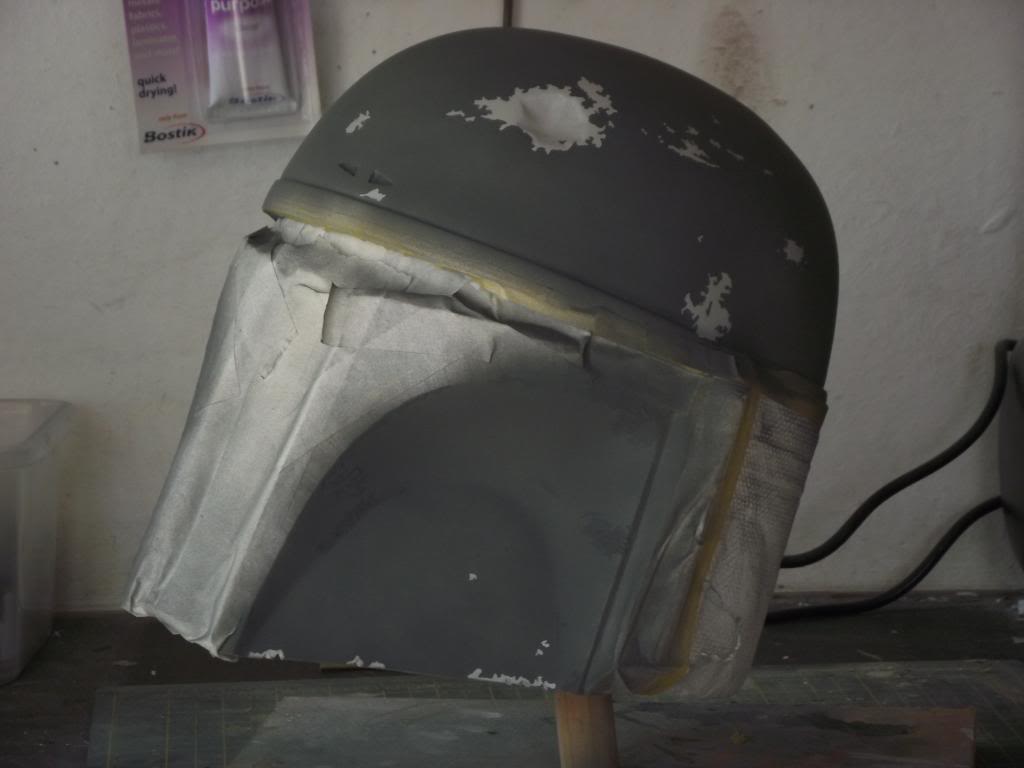

Quick blast of grey 79 and once tacky, remove all the masking fluid with a needle:
Then its just a case of repeating the process with the green, and then the black:
And here is where the helmet stands of right now. Still need to go in with a brush and paint the grey sections inside the silver, plus the weathering and what not;

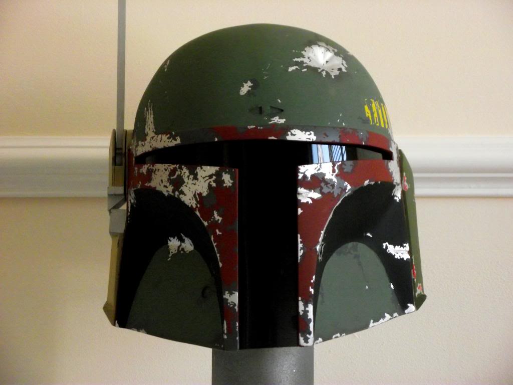

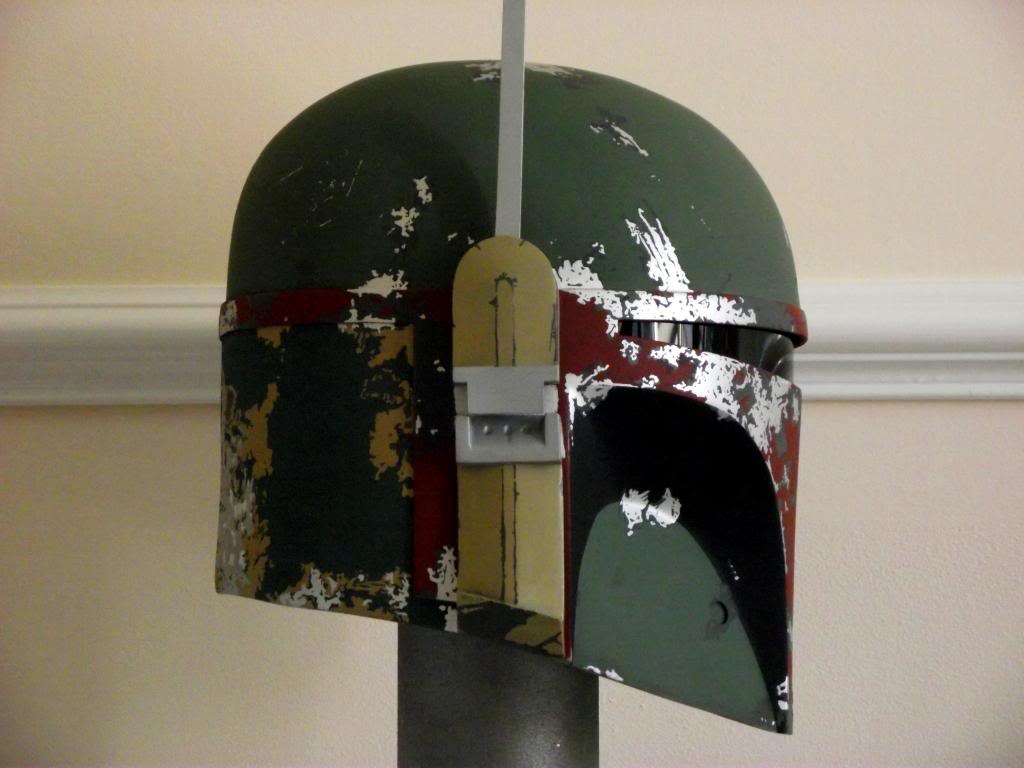

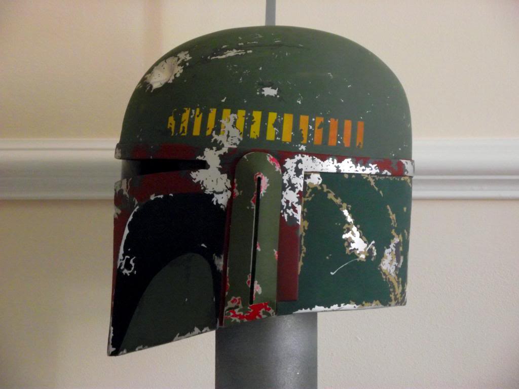

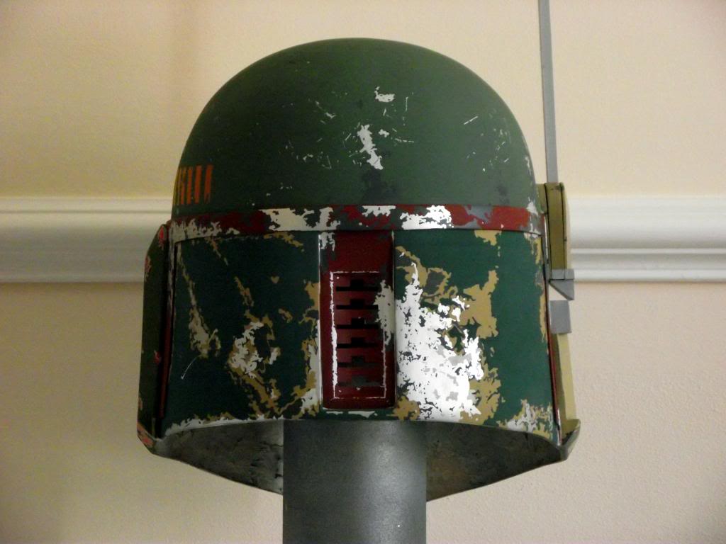

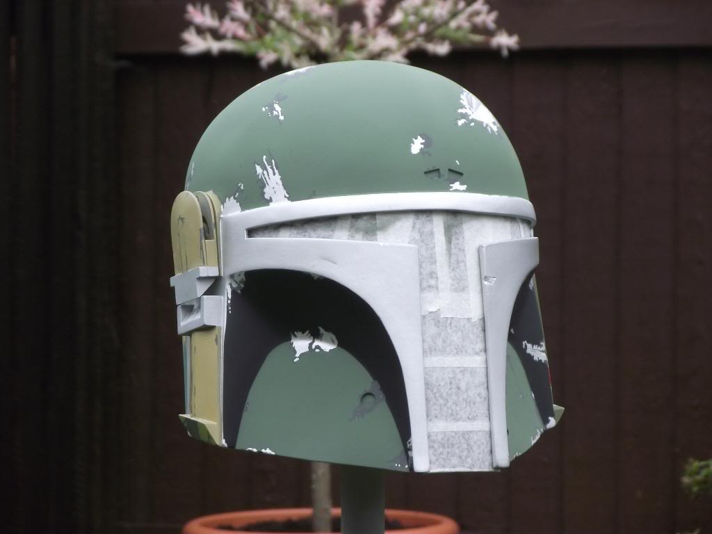

Anyways, got the helmet almost finished, need to add a little more weathering and the ear decals followed by a satin clear coat. Not the best of pictures but here you go,
Pretty pleased with this, I got another helmet now awaiting the red and thats it then for Boba helmets with me. Will probably do one for my self in the next few weeks but I wont be taking any more on for a long while. Hoping to get some professional studio shots of this done to finish it off.
