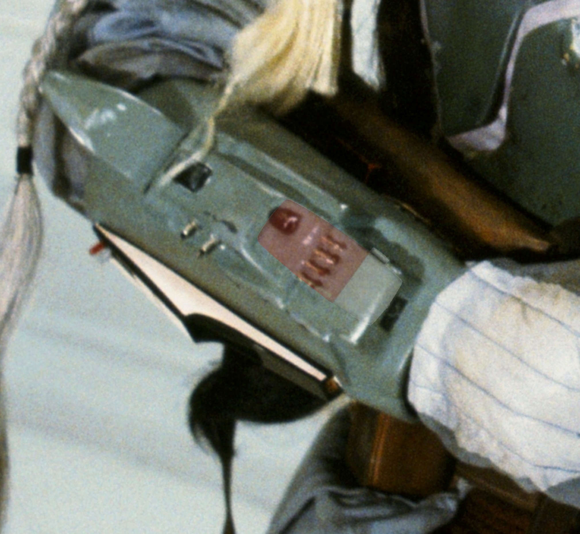

Now the next question... was this used as part of the gauntlet shape at the front, or did they just use the guts & light inside and the button on the outside?
It is possible that they used the whole mini torch and build that part of the gauntlet around it:
That is what I think. If it's supposed to be functional like the one in the supertrooper gauntlet it needs the batteries, and keeping the rest of the torch built in sounds like an easy solution to keep the batteries built in.
Ive always thought of it as the whole torch in the gauntlet ...the recess at the front looks to me to be a rectangular opening cut into the vac of the gauntlet with the torch face behind it ... the bulb would be masked off and the recessed torch front painted ...thats what I think we see at the front...(my theory ;) )...
the torch could be mounted on velcro with the switch sticking through the side panel ?...this leaves easy access to batteries and a self contained unit in the gauntlet ... after all 'why fix what isnt broke?'

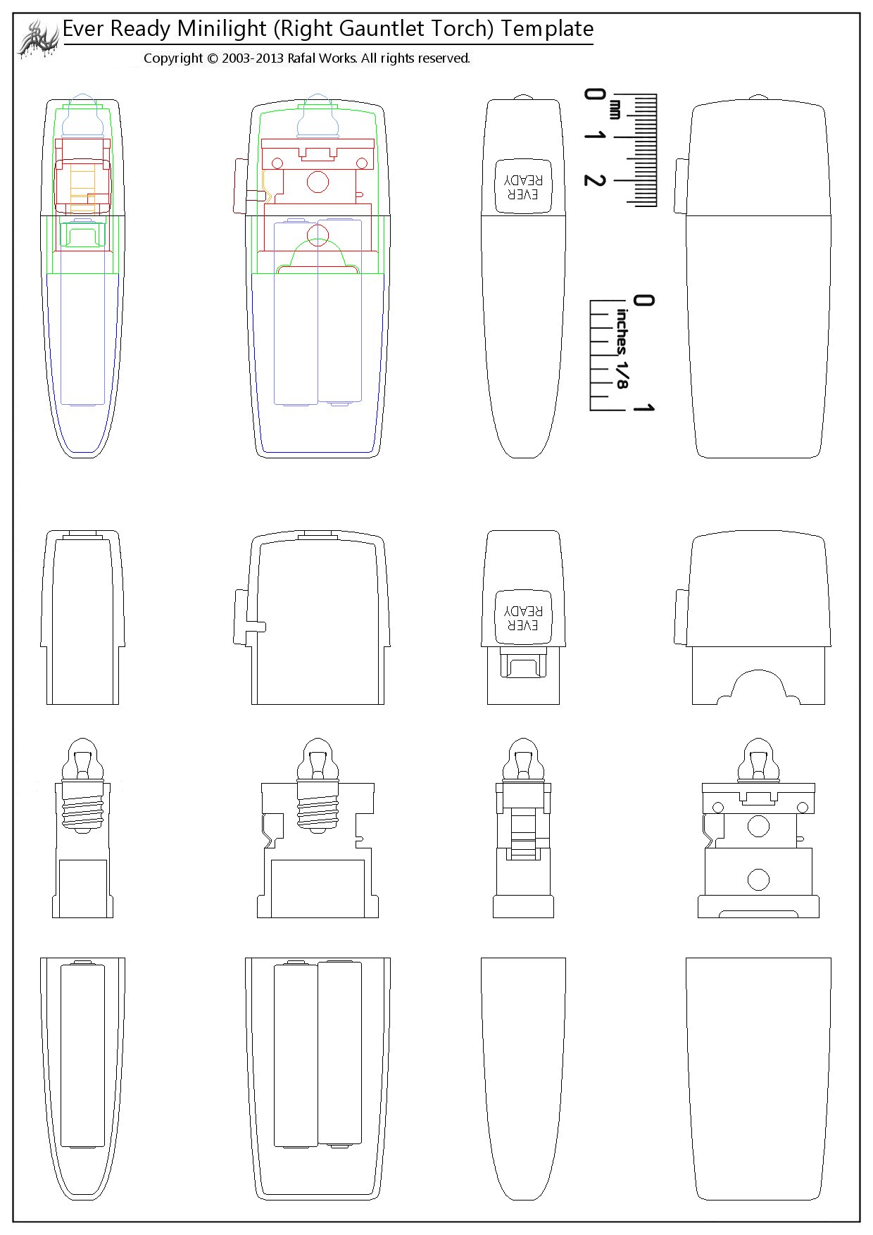

I have worked on these files for a while now... and almost drive me crazy. Most of the parts are based on estimations and guess work using the images posted by boba trooper (a huge thanks for him!) and although I didn't posted measurements, I provided a mm and an inch ruler to help you in printing the image at the right percentage. I did a test print using the Windows Picture And Fax Viewer program (for Windows users) with the 'Full Page Fax Print' option, resulting a perfect 1:1 page (sadly I'm not sure about the LTR format). But I guess it depends on the printer settings too...
Here are the files in A4 and Letter formats:
If there are areas that needs tweaking or resizing, just let me know and I will do the necessary adjustments.
Have fun!
