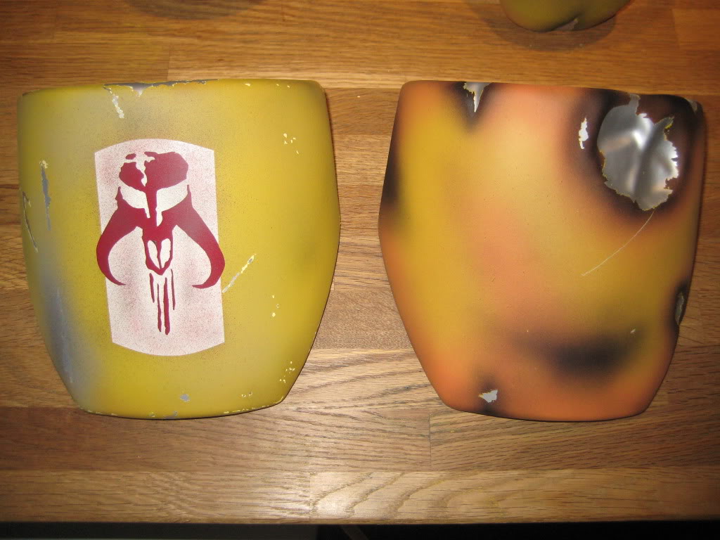

Ok, I´m having trouble getting my grubby hands on the UP Armor Yellow for the knees and shoulders. And since pics on the web have a tendency to "lie" I´m wondering if anyone can tell me what this color looks like? :) I know this is a bit hard, but I can´t find a conversion chart for the Floquil paints.
Is it a light yellow beige color? It looks like that in the pics, almost like light sand or something. If anyone on the other hand has a conversion chart for Floquil to Vallejo or Humbrol I´d be a happy camper!

And the UP armor yellow is more of a sunshine yellow, not sandy. The costume ref. pics you're likely viewing are weathered down a tad don't forget.

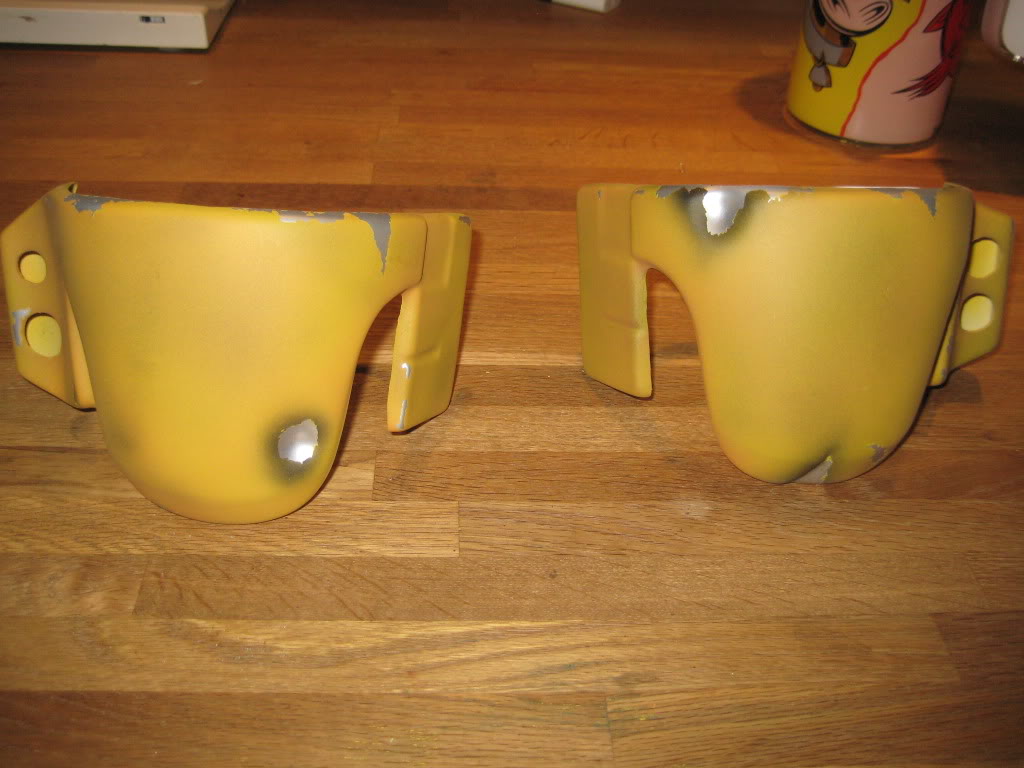

Got some lightish yellowish color for the shoulders and knees today, I´ll hopefully get that on them tomorrow.

Got a lot of work done today! All these four parts where silver this morning:)
The flash wipes away a lot of the light misting on some parts. I´m considering darkening the knees a bit more tomorrow.
Enjoy!
