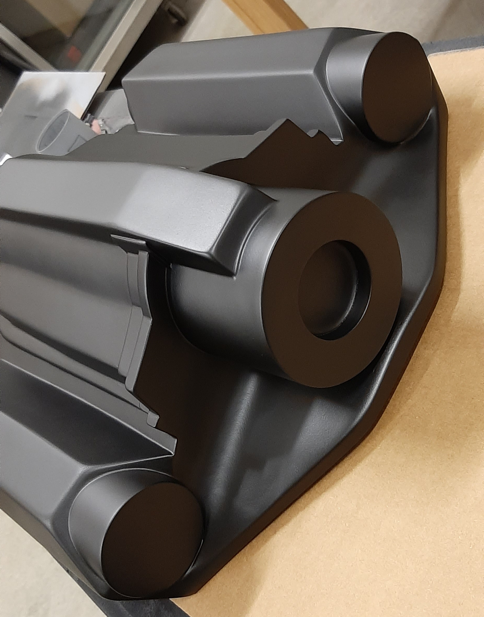

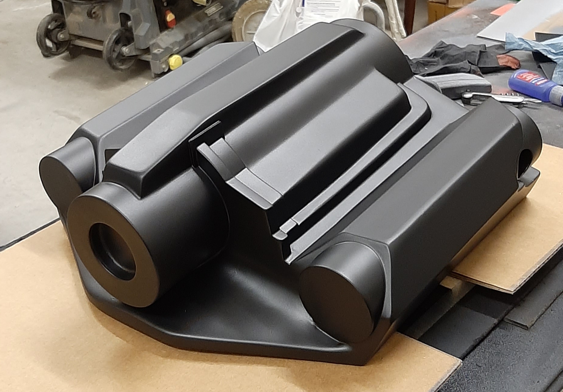

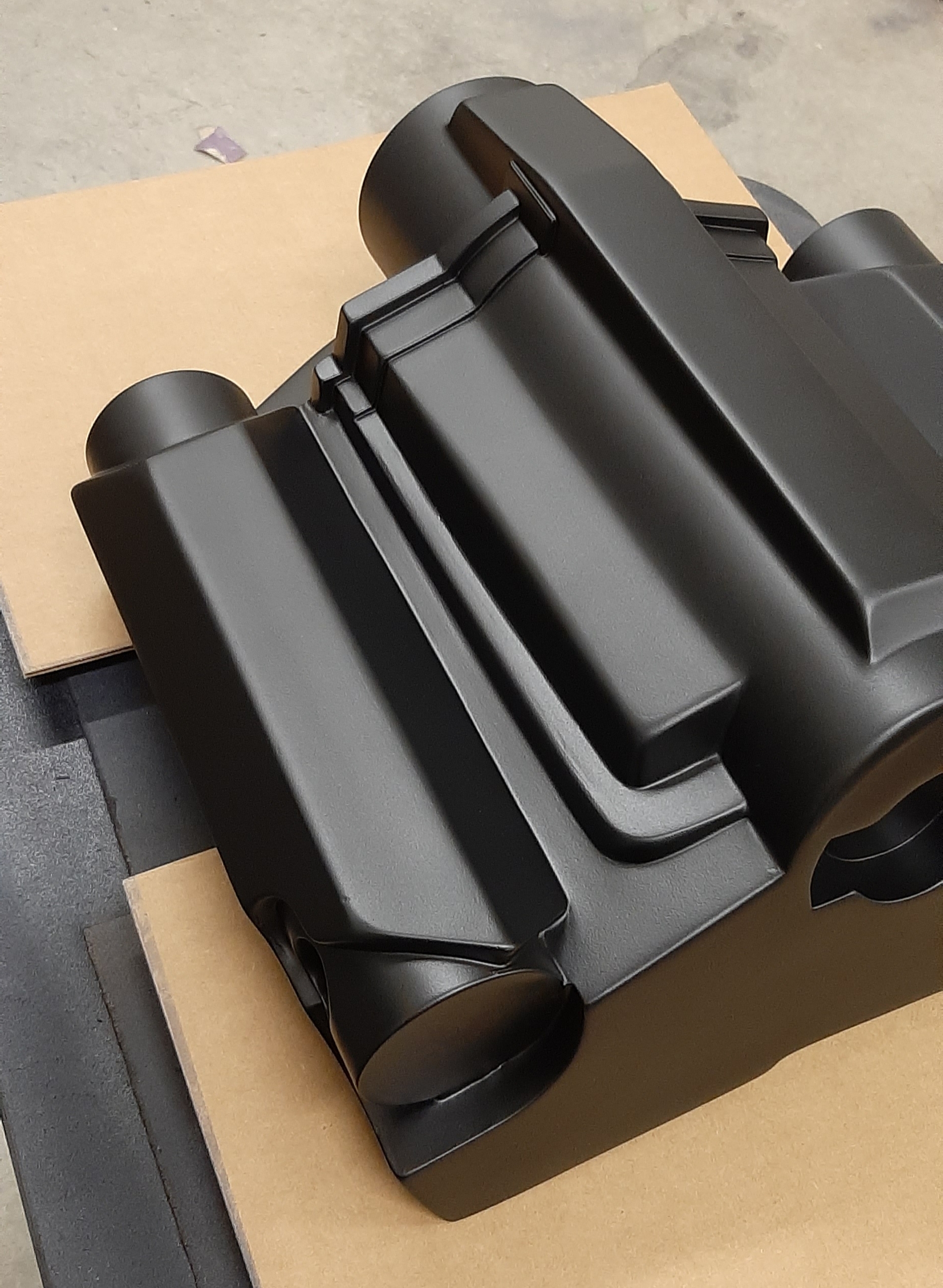

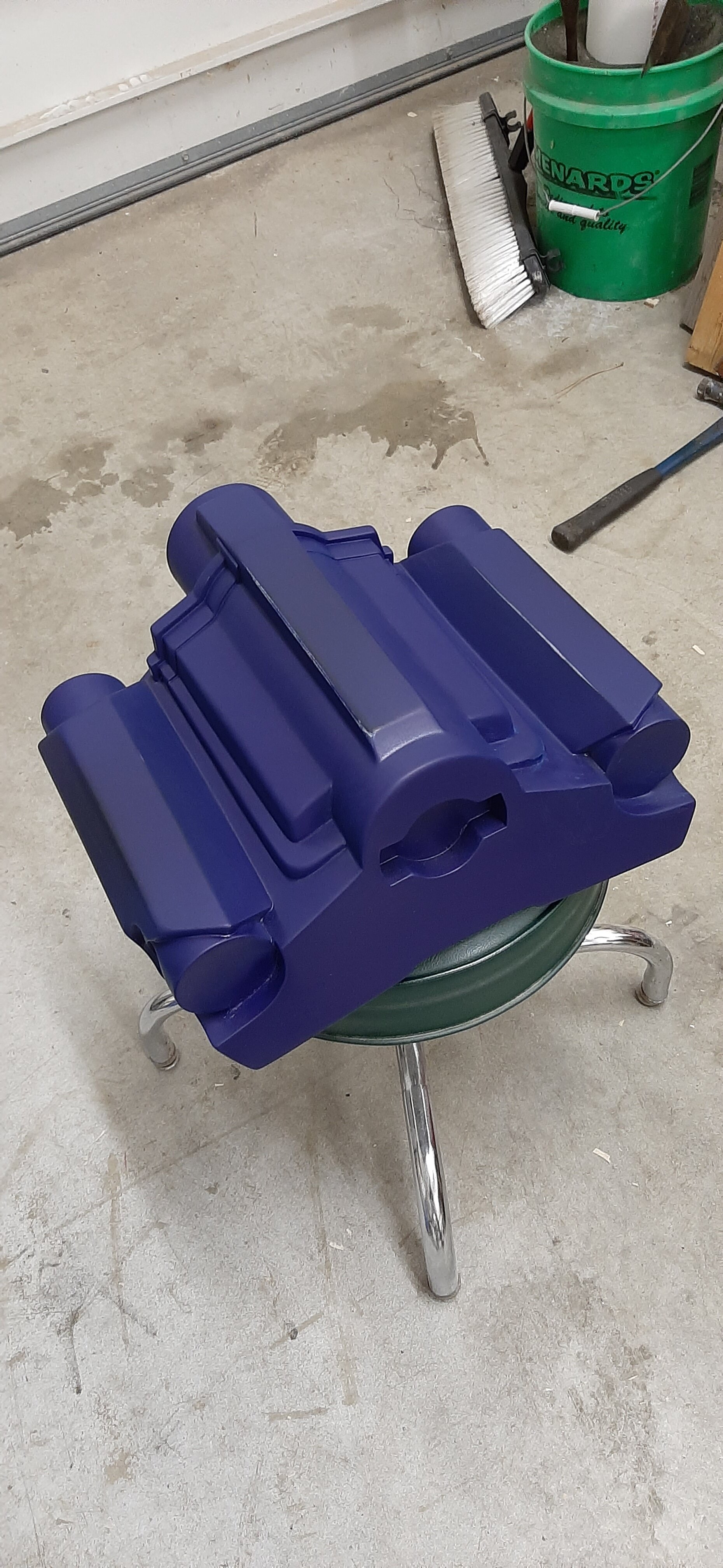

I'm still learning how to use paints and stuff like that. So I am bound to have lots of errors. I added to much gloss black and got really bad orange peel. So I had to wet sand it again. I need to watch some videos on how to apply gloss black. Also re-read my Volpin Props and Punished Props painting books. Here is how my pack looks now. I used the remaining satin black paint that I had left. Looks good so far, some tiny imperfections all over the pack but not noticeable unless you really look close at it.

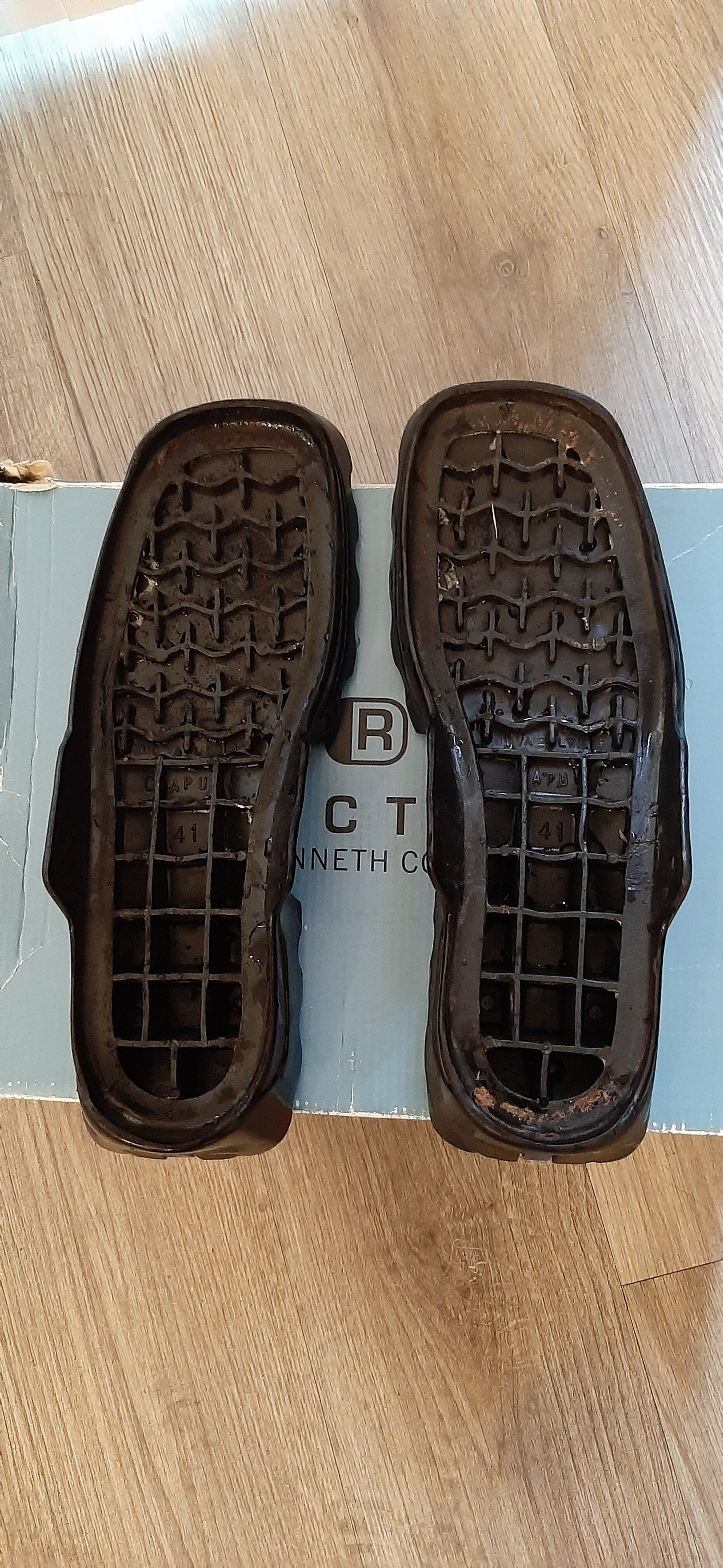

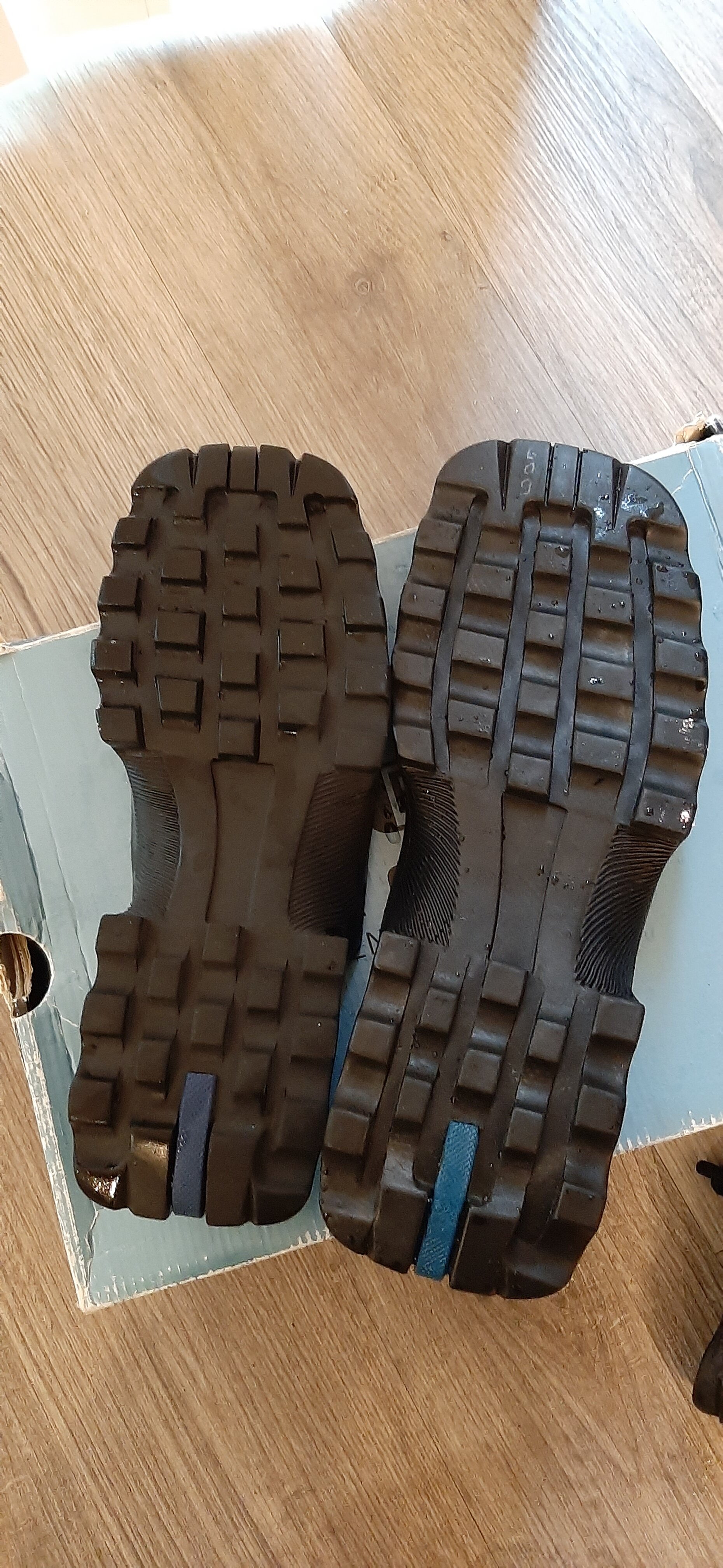

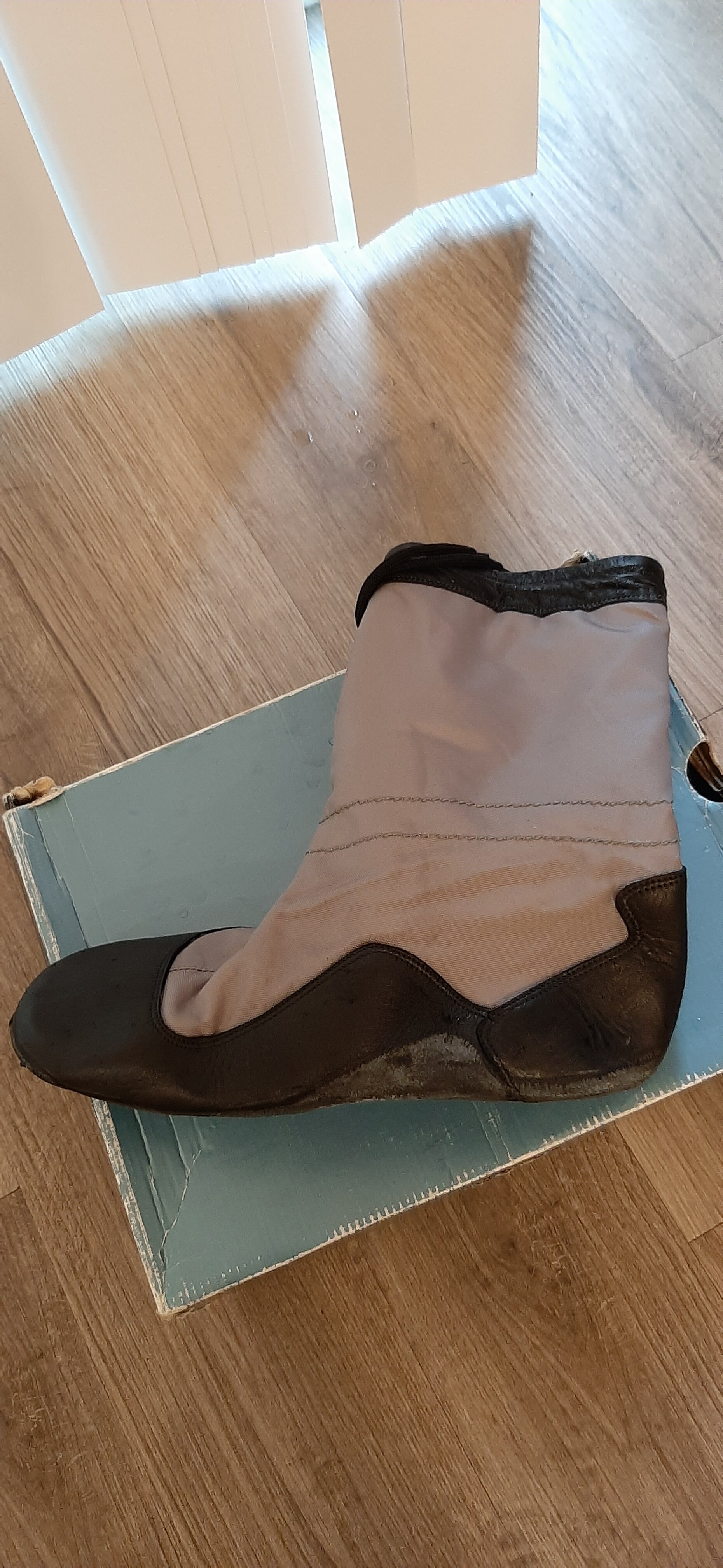

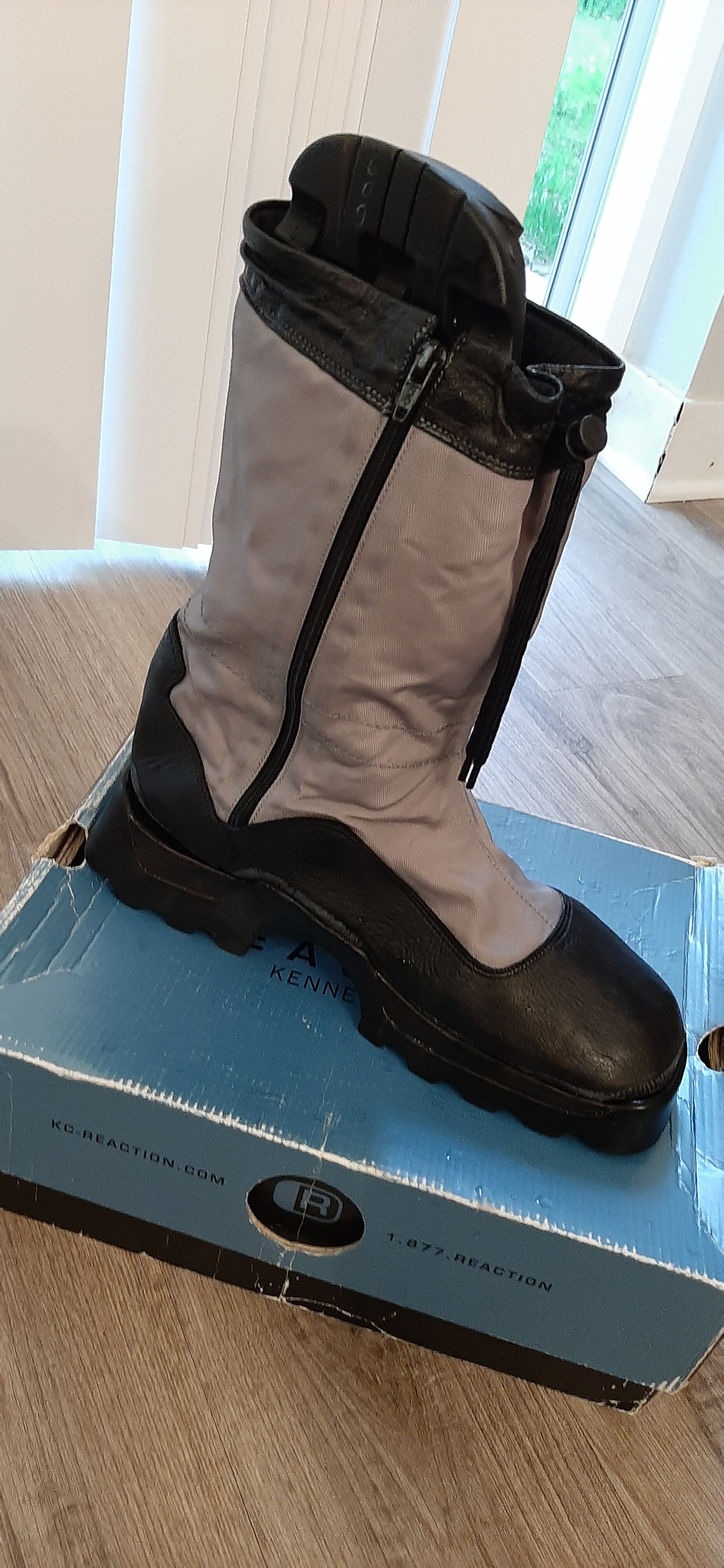

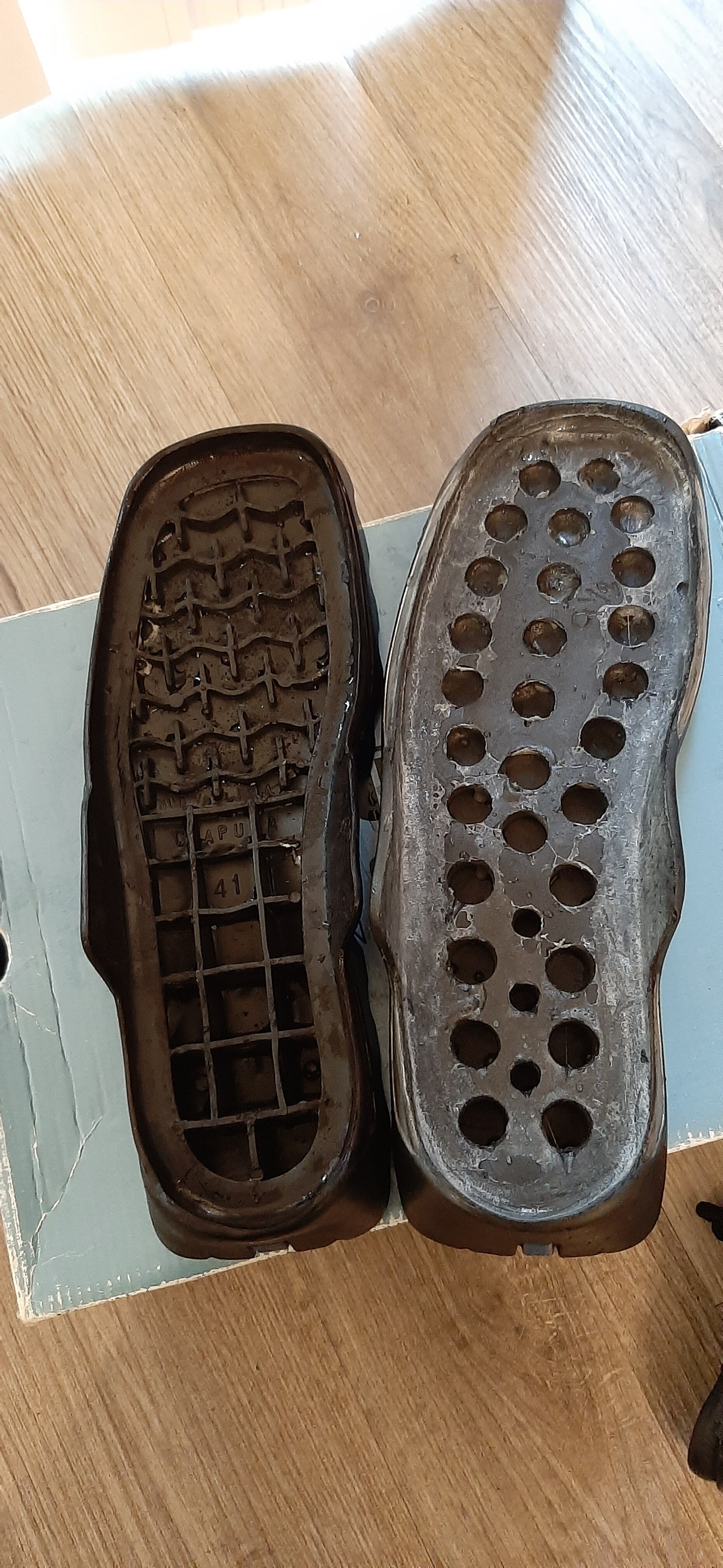

Three blisters later I removed the boot soles off my Kenneth Cole Kilamanjaro boots. Also removed the Crow Props boot sole. It was so hard to remove and I ended up ripping the sole in half. Oops! Now to wait and see if the upper will fit when its dry. I hope I didnt ruin that boot. If that doesn't fit that is. Haha. Worst case scenario I messed up boot. If this doesn't work out I might send the soles to Gio and see if he can add an upper for me. Maybe next year if this Pandemic subsides and we go back to somewhat normality.

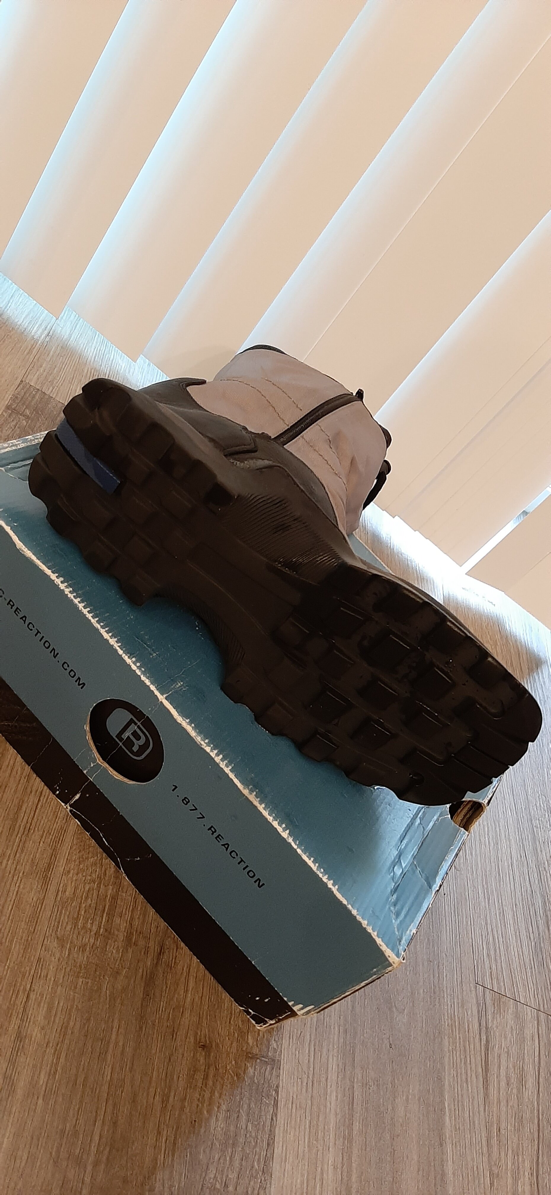

I might have made a oopsie poopsie. I didnt see that these boots where size 9.5s and my Kenneth Coles are size 9. I ordered size 9s from Gio. So lame. XD
At least only one messed up..
I'm going to make a mold of my soles for future use. Before I send them to Gio, whenever I do that is.

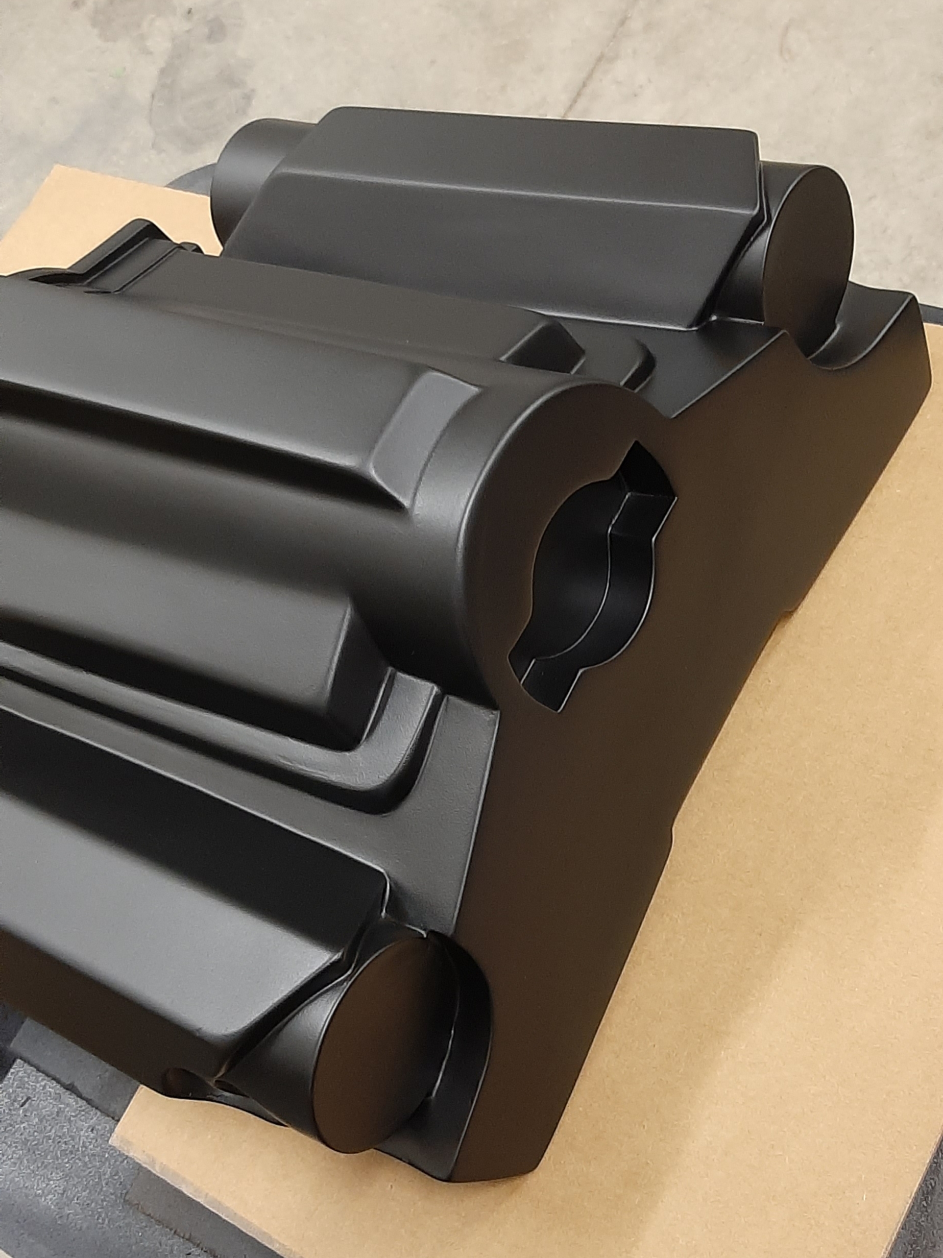

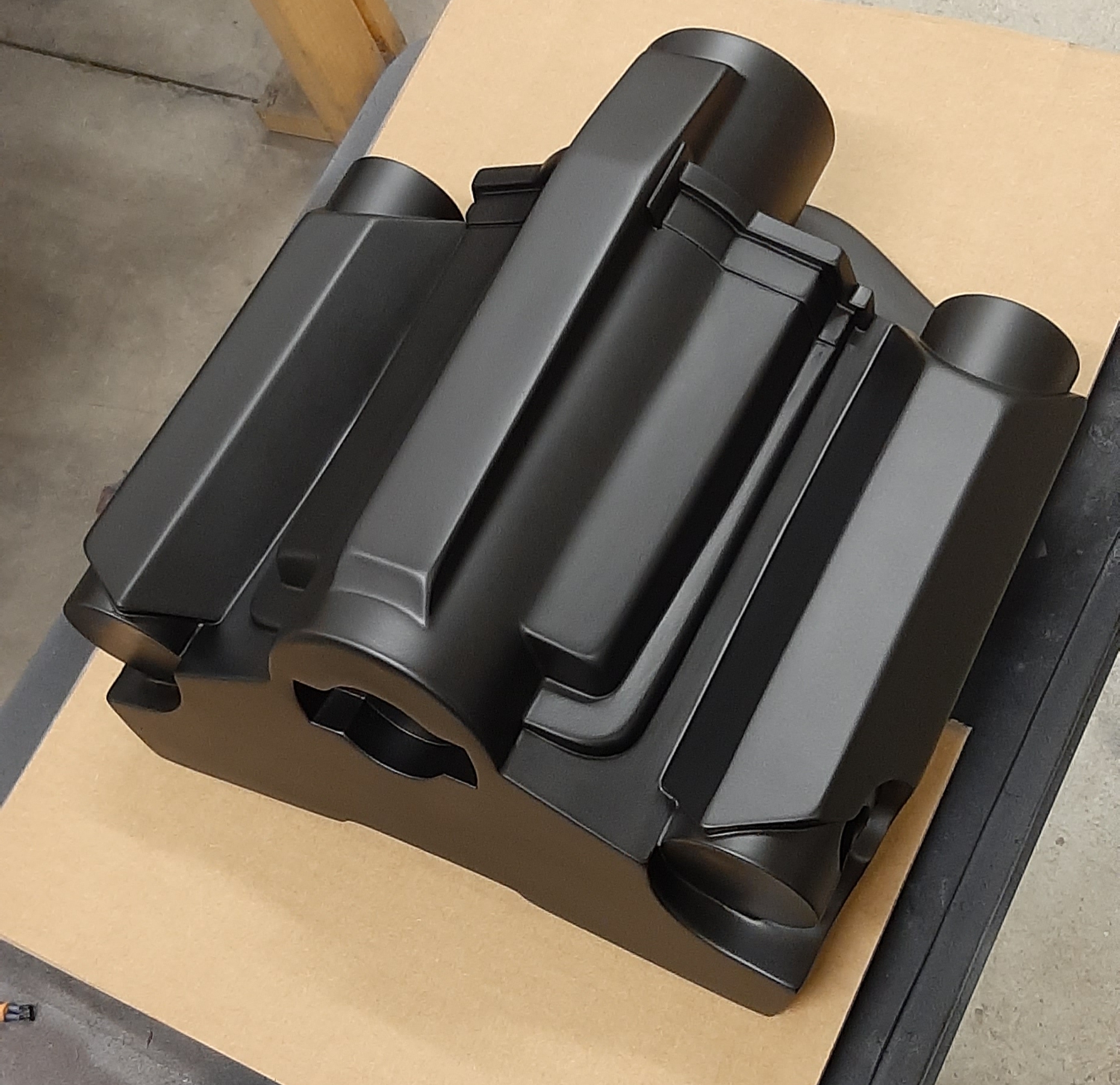

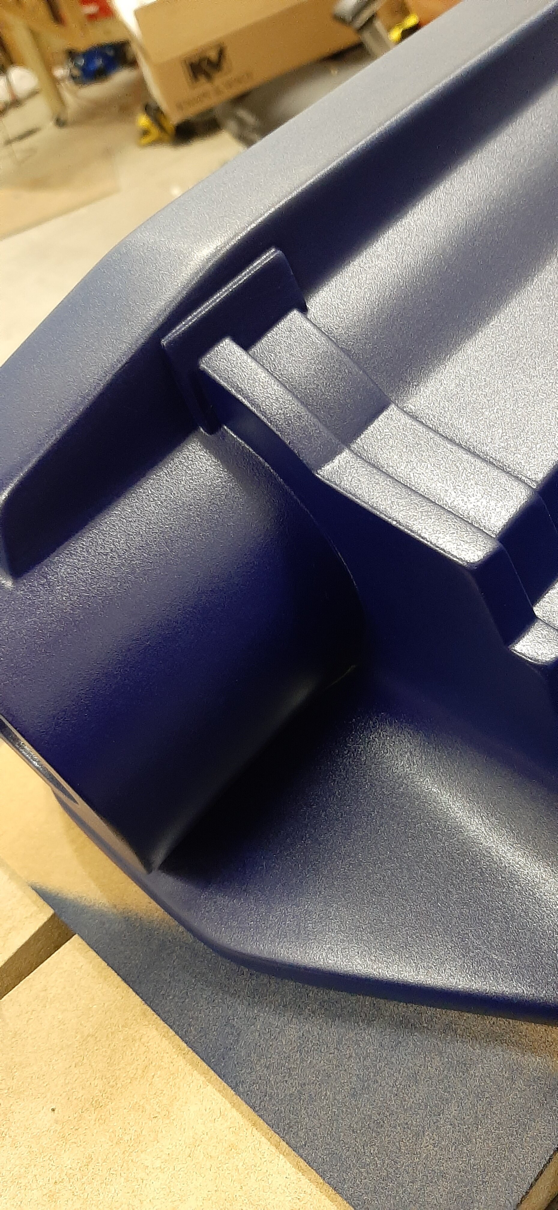

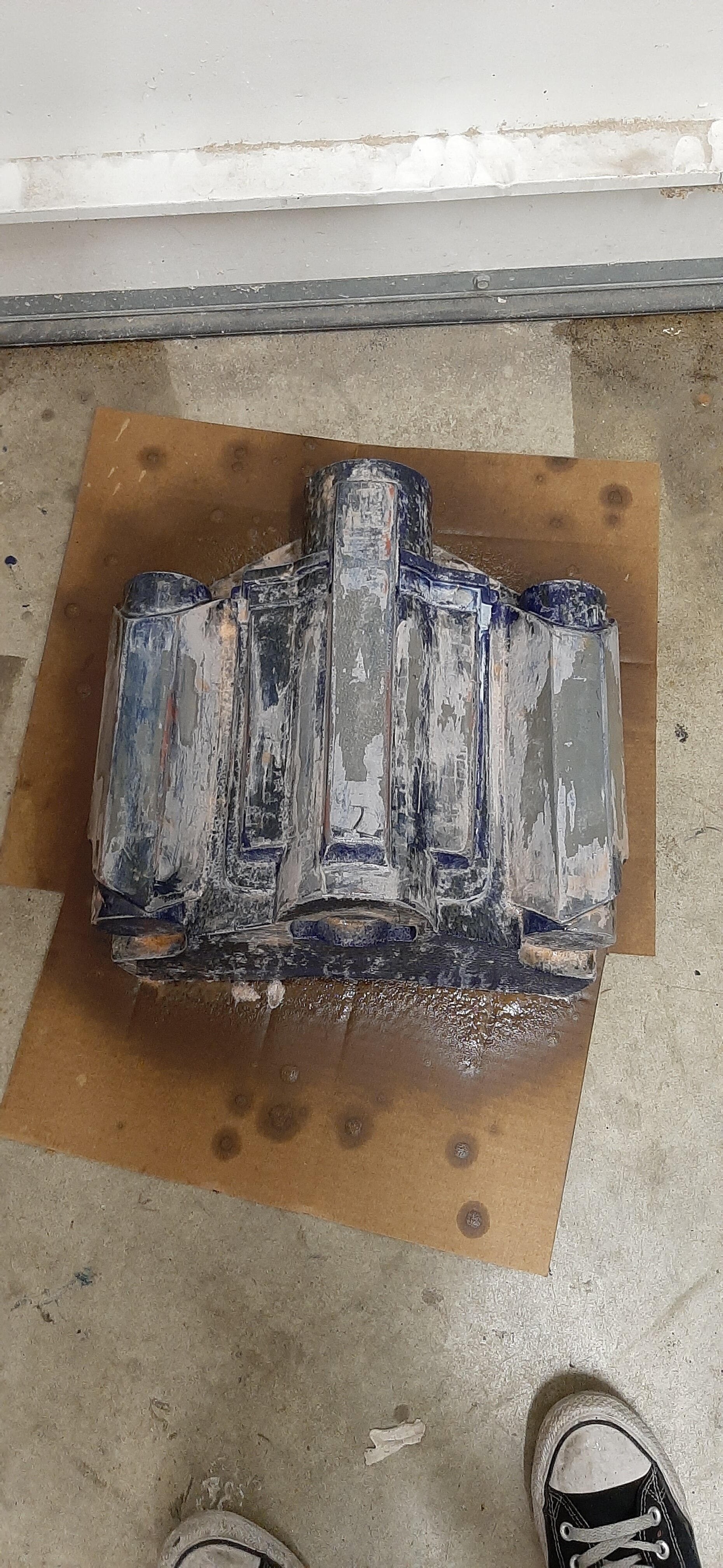

I can't believe the jetpack burnt me out from my Jango build. Krylon has defeated me. I tried two different cans of the same color and still get this terrible orange peel on my pack. I have stripped the color 3 times already. Wet sanded with various grits. (Frustration over 9000.) Anyways this what I have so far on it. It looks good in pictures. (IRL not so much.)
This is the problem I had three times already.
Tricks I use
1 prime then wait 4 days
2 paint can heat up for ten min in very hot water in a bucket
3 don't shake can stir can in circles with ball rolling at bottom of can
4 paint with slow even strokes
5 don't hold can at a angle
I use a lazy Susan from Home Depot with a 24 inch round platter also at Home Depot
Hope this helps

This well help. Thanks!!
