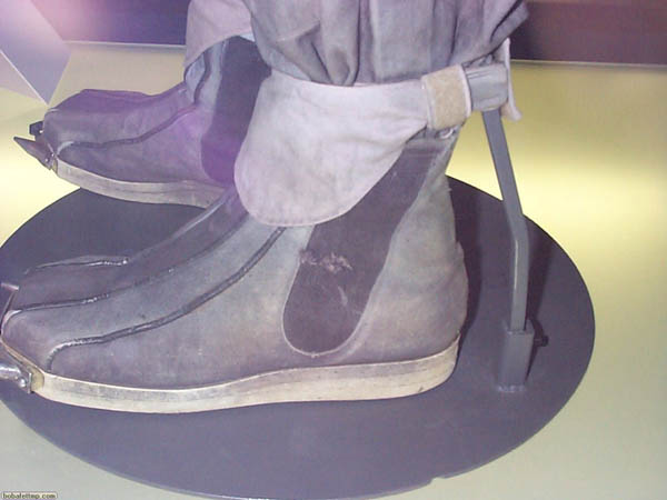

And remembering that this is what you're trying to emulate:

so from reading the replies on here, i see a bunch of unanswered questions about the difference between ESB and RotJ weathering.
the simplest way to tell is to just look at them both and see how they are different. if you are going to be painting this stuff, you need to stare at it until you can see what you are painting. otherwise all the tutorials in the world aren't going to help. look in the gallery, watch the dvds, etc...
i've been saying this a lot on a lot of different forums lately, but the single greatest tutorial you can ever read is this: "Make it look like the picture". that's it :)
