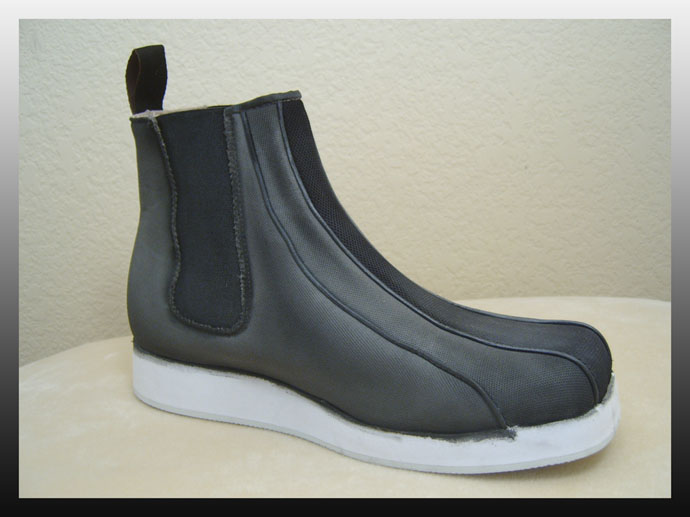

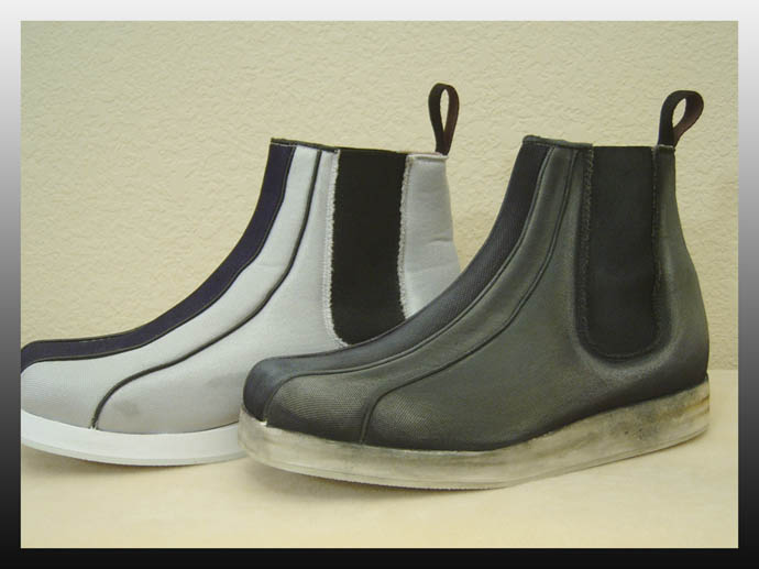

This first pic is obviously the way the CA BOOTS come ….wrong color and in need of some tender "Love"/ Weathering.:love

This next Pic shows the BASE Color that is used to tone down the light color of the boot.
For this I used a Gray mix/or "WASH" of Charcoal and White....
When applying don't be scared to go at it. Again this is the base color and will be lightened again with highlights later.
You can see the difference in color in the PIC below.

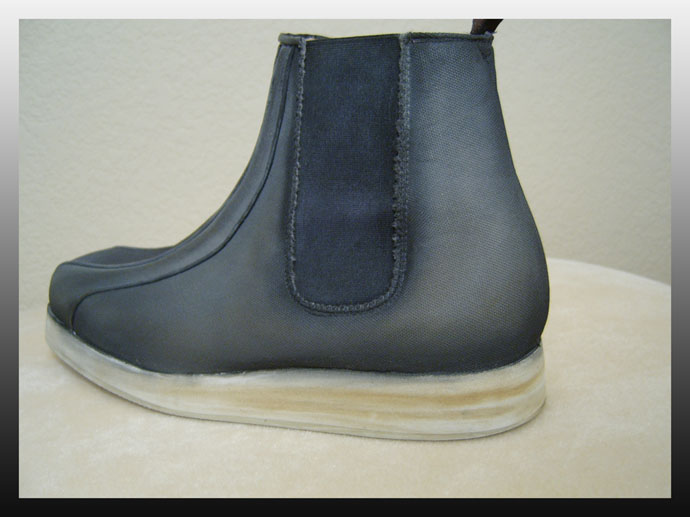

Next, Using the Straw and Burnt Umber Color Mix/WASH
I apply a SEAM on the bottom of the boot, and tone down the white sole of the boot using the dirty water from the straw color mix.
ca-boots-weathering-s5300116.jpg-10480d1148178241
** NOTE*** Again the “Wet on Wet” technique should work just fine here too…in fact if you mess up….just wipe it off with a damp paper towel and start again…works every time.;)
You can see in the Pic below I have used the Straw color mix Wash to apply “hints” of brown tones on the boots as well….

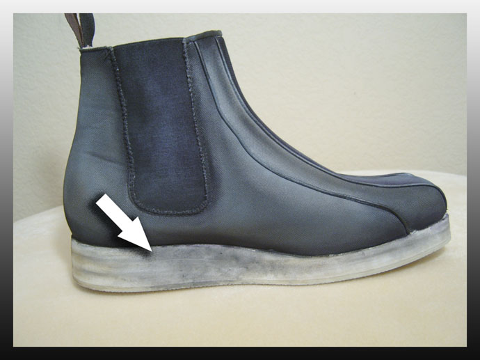

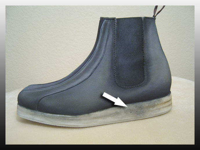

For the additional gray “Dirt” Weathering on the Sole just use the Charcoal color straight from bottle.
**AND the “Dirty water” you’ve been cleaning your brushes with….USE THAT!!;)
For applying the color or wash use the Dry on Dry technique, and like the Previous step very sparingly. You may want to test the color on a paper towel first.
Once you apply the pigment to your brush, tap the brush head on a napkin to open up the hairs of the brush to get the detailed dirt specs when applying to the sole….(did that make sense??):p
Or you can use a Toothbrush and do the splatter technique......that works great too.

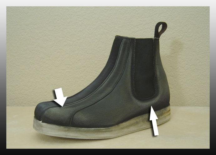

Anyway, to get some of the additional highlights use SAND-Paper….yes sand-paper.:)
The first pic below highlights the areas in which I hit the boot with sand-paper………150 grit should be fine.
All you are doing is making natural scuffs on the boots….creating a “natural highlight”.

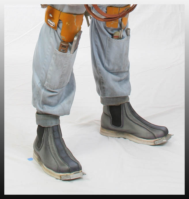

The last few pics are just with spats and a comparison of the before and after…..ahhh much better.:)
