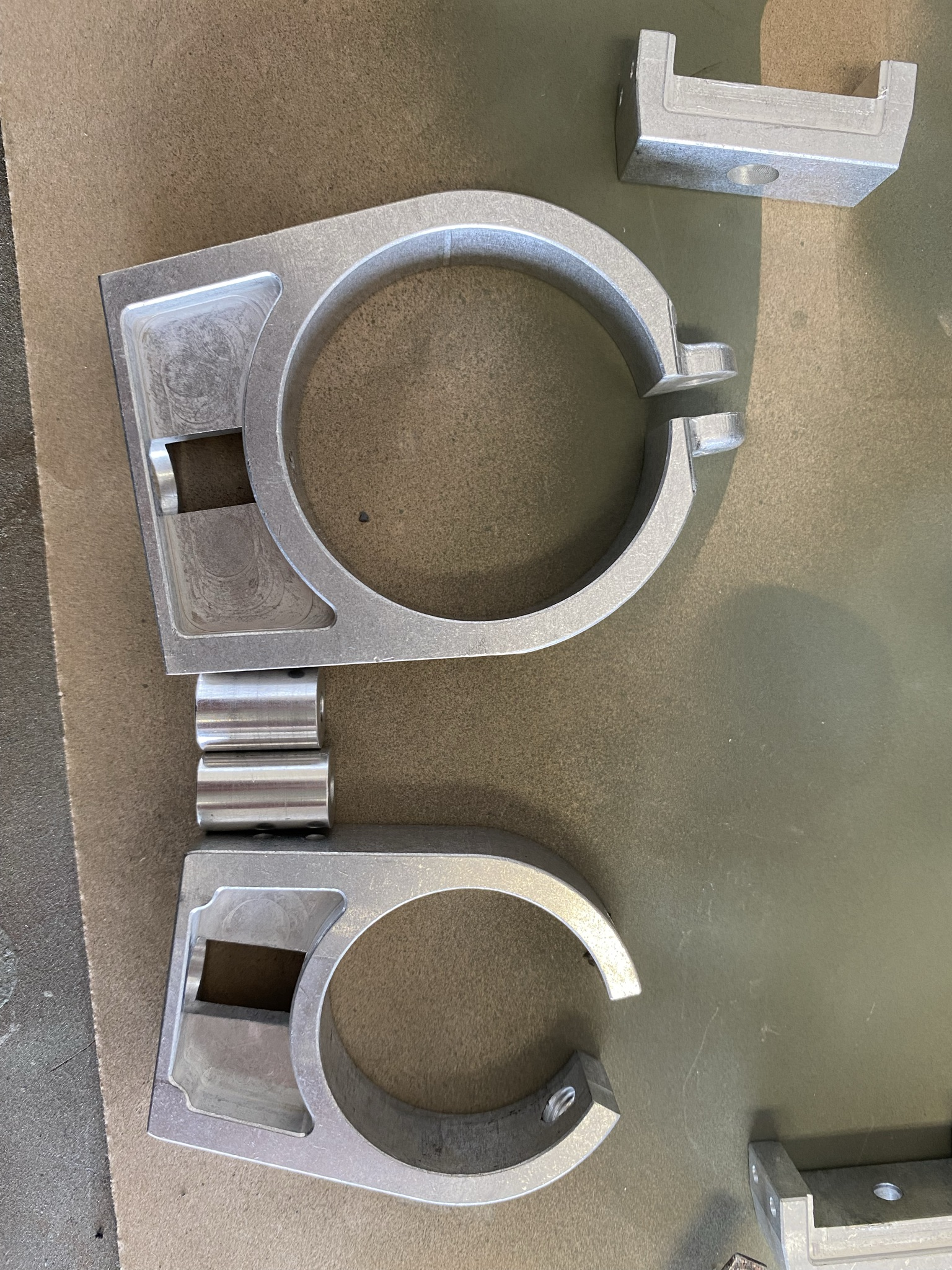

I also used steel stick epoxy to fill the holes on the clamp. I needed one clamp surface exposed.
Hey again. I have everything inhouse now to do the blaster. I just reread the thread and you mentioned you filled holes on the clamp with epoxy.
Just wondering which holes as I can't tell by your pic.
Also, why? Was it so the acid bath didn't damage the holes?

The holes I filled were only to get rid of the connecting rods for the molex connectors for placement. The configuration I used has one molex missing and I didn’t want to have a small hole in that spot. If you plan on using all four molex connectors you won’t have to worry about filling those holes.
I didn’t put the clamps, hammer or trigger in the acid either.

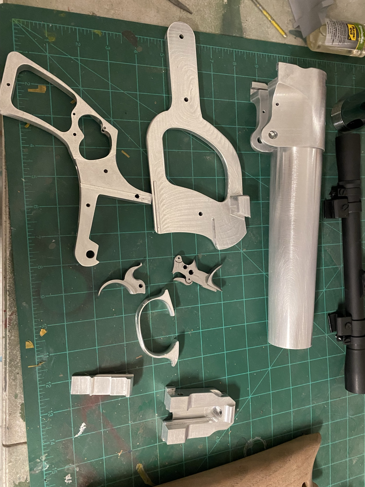

Only these pieces (minus the brass piece):

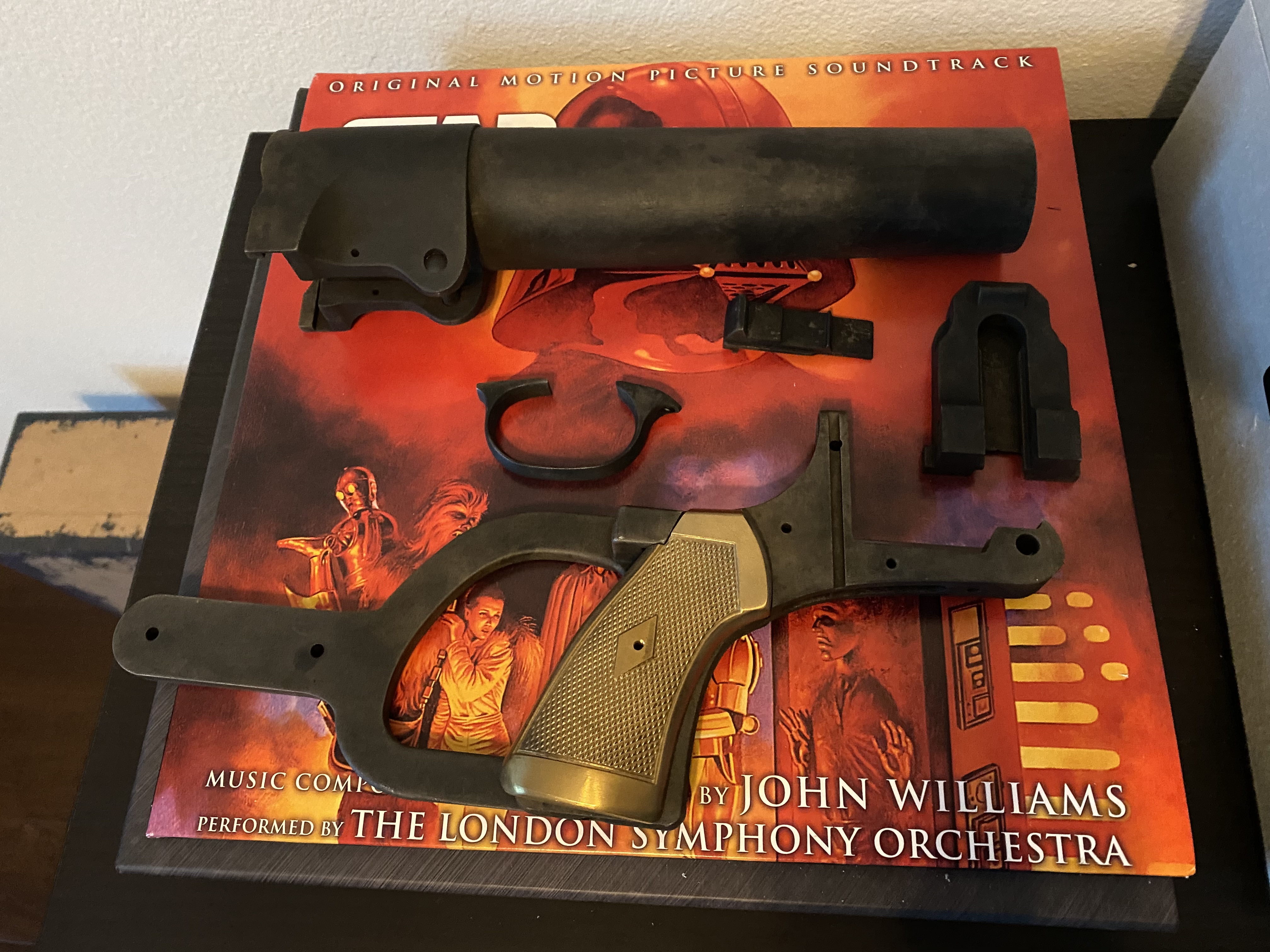

Pretty much finished with this after a few passing of birchwood and Casey Tru-oil after I damaged and weathered the stock.
Like mentioned previously it’s all found parts besides the actual webley (obviously) and the MPP. I painted the trigger and hammer myself. The hardware to attach the sling are actual webley replicas as well.
