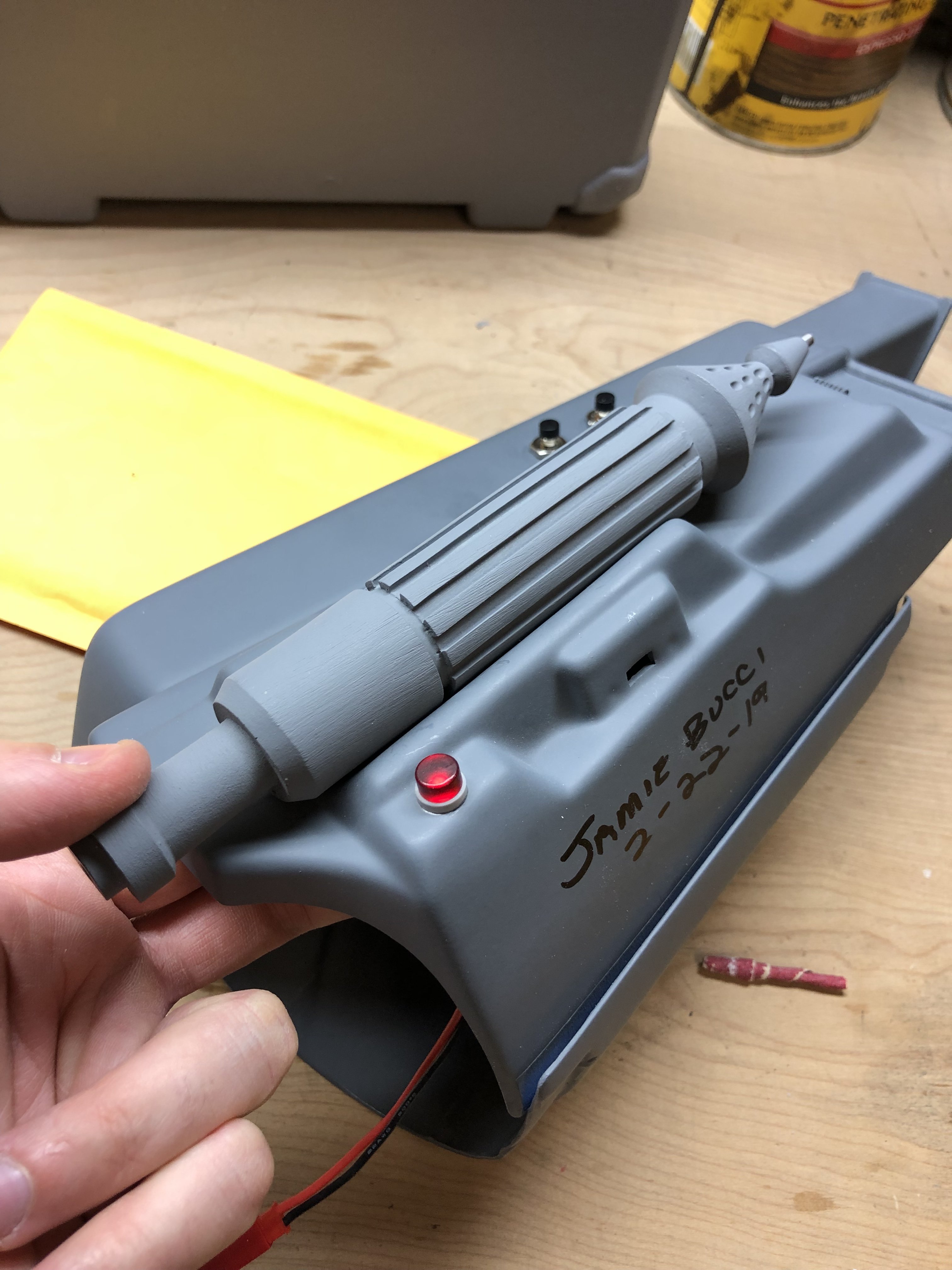

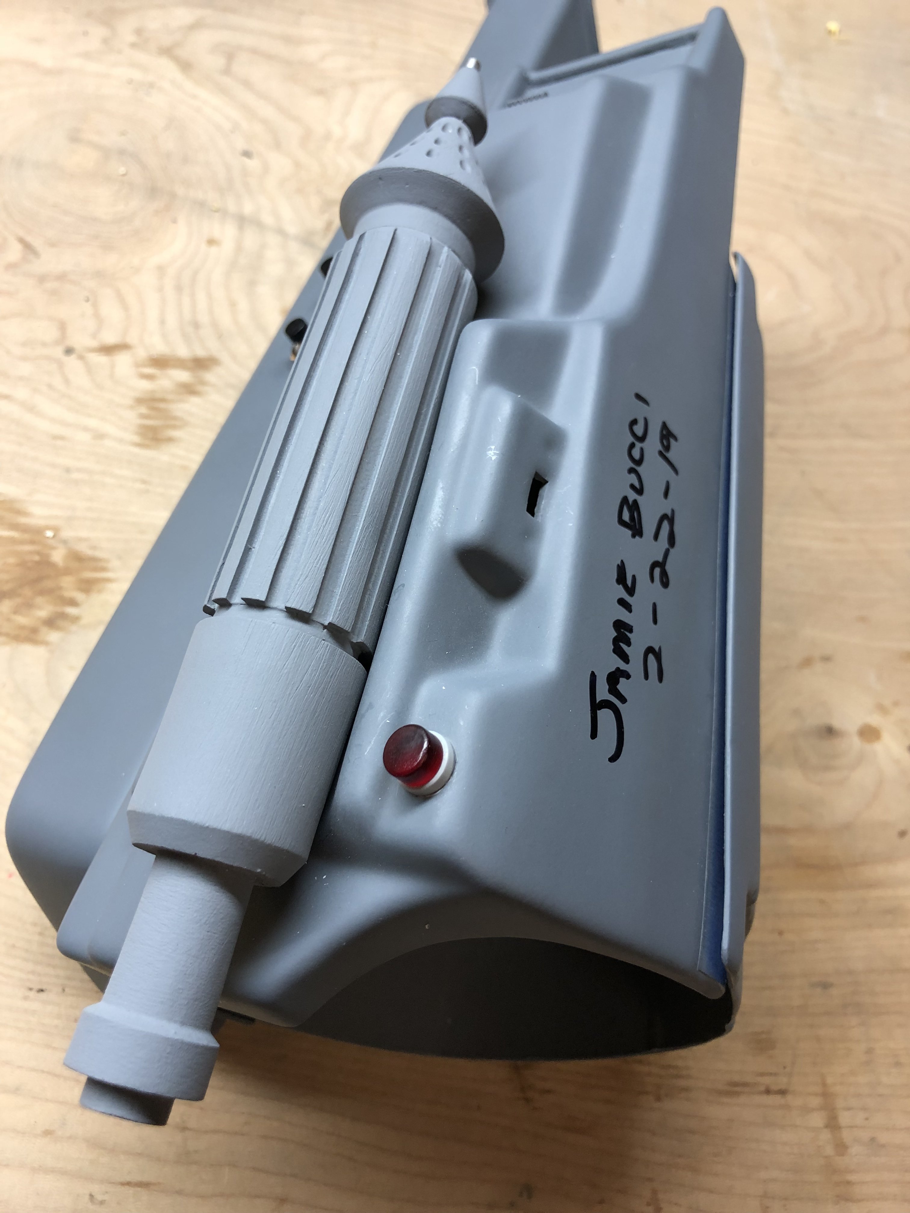

So THIS is what I was referring to. The gauntlets came assembled and the light HOUSING is molded in. So I disassembled the light kit I received from crumdum (pulled the LED from the housing) and put it into the gauntlet housing.
Slide switch is a little wide for the pre-cut slot in the gauntlet, but I’m pretty sure this will work just fine when I enlarge it!

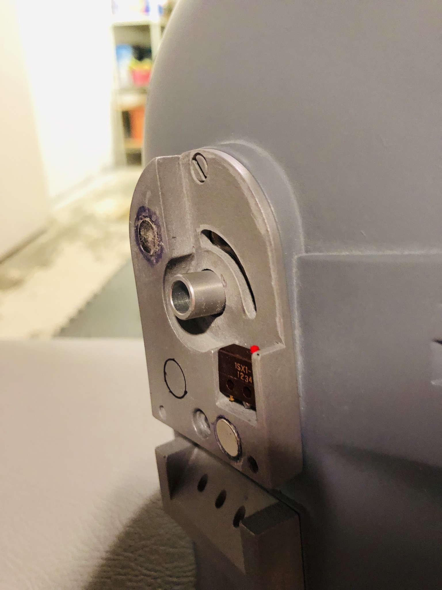

Anyways I was beat, but wanted to do some things I’ve been wanting to do to my lid. I had bought some rare earth magnets recently, so I countersunk them in the right ear. I felt like the ear cap is too shallow to countersink magnets in there, so I cut a sheet of 26GA sheet metal and recessed them in the cap in corresponding locations.

Drilled a hole in the lid, and a corresponding hole in the right ear for my servo from Jc27 . Pretty sure things are going to line up very nicely once the helmet is painted. Trying to as much as I can now so I don’t have to drill holes or cut the helmet after its painted, you know?

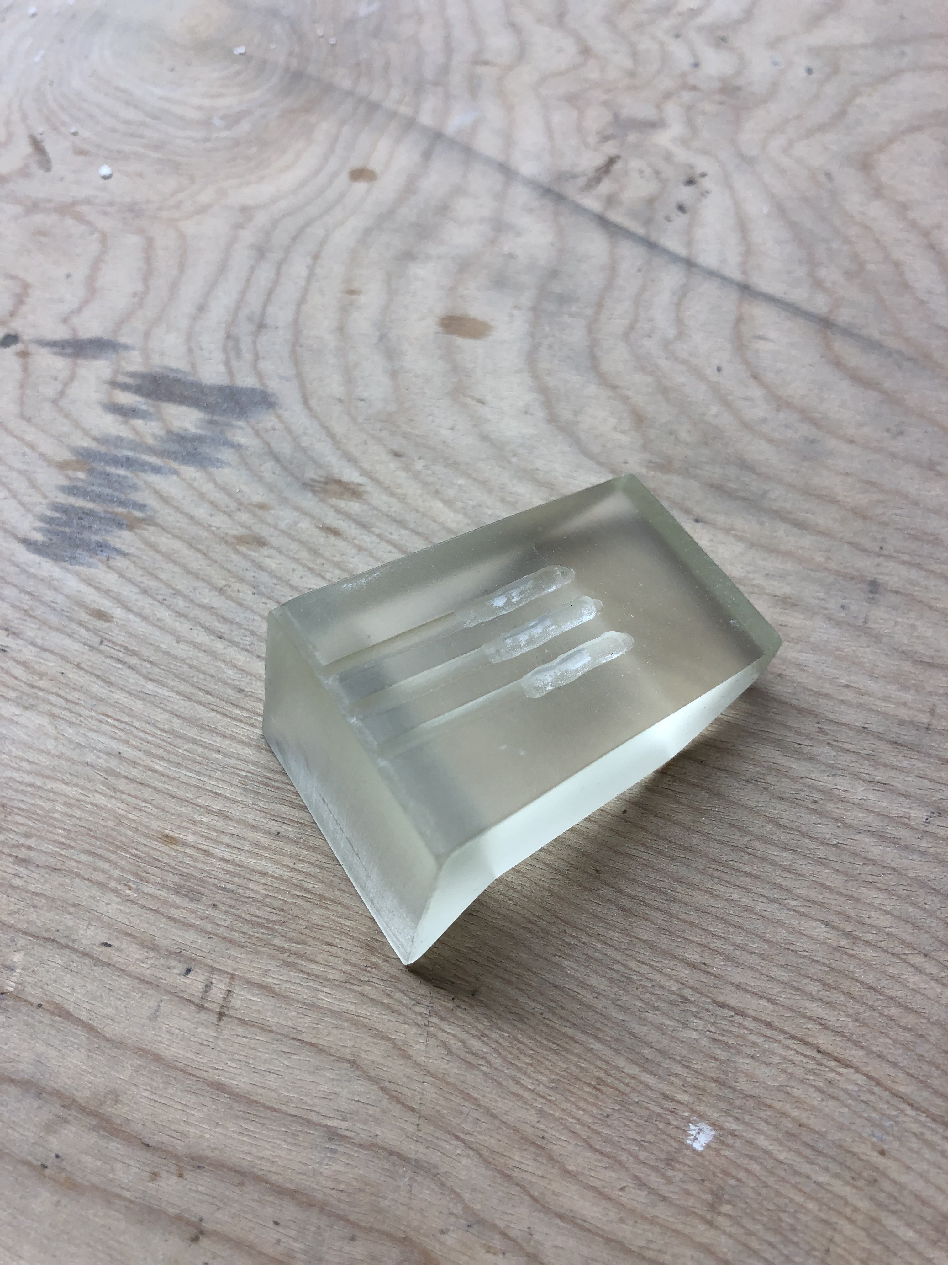

I also sanded the grooves in the perplex block so the GOW bulbs sit flush in there, as recommended by Justin.
Lastly I sanded the holy hell out of the inside of the RF topper for the light kit. Not sure what exactly is going on cause I sanded ALOT out of the inside of the topper, but the bulbs don’t seem to stick out as far as I’ve seen on some others...what are you all doing!?!

The RF holes may need to be opened up to accommodate the bulbs. Use a round jeweler's file and file at an angle to widen up the underside. Go slow with this to avoid removing too much material. Btw, the CRL for Infamous states "RF Topper lights are fully tucked into the topper housing."
Got ya! I tried to do that with a fine dremel bit, but didn’t want to accidentally shave away anything on the outside. Point file may be the way to go! In my opinion, the lights are fully tucked into the housing (they’re snug and friction fit in there) - how do you know so much about the new CRL anyways...?
