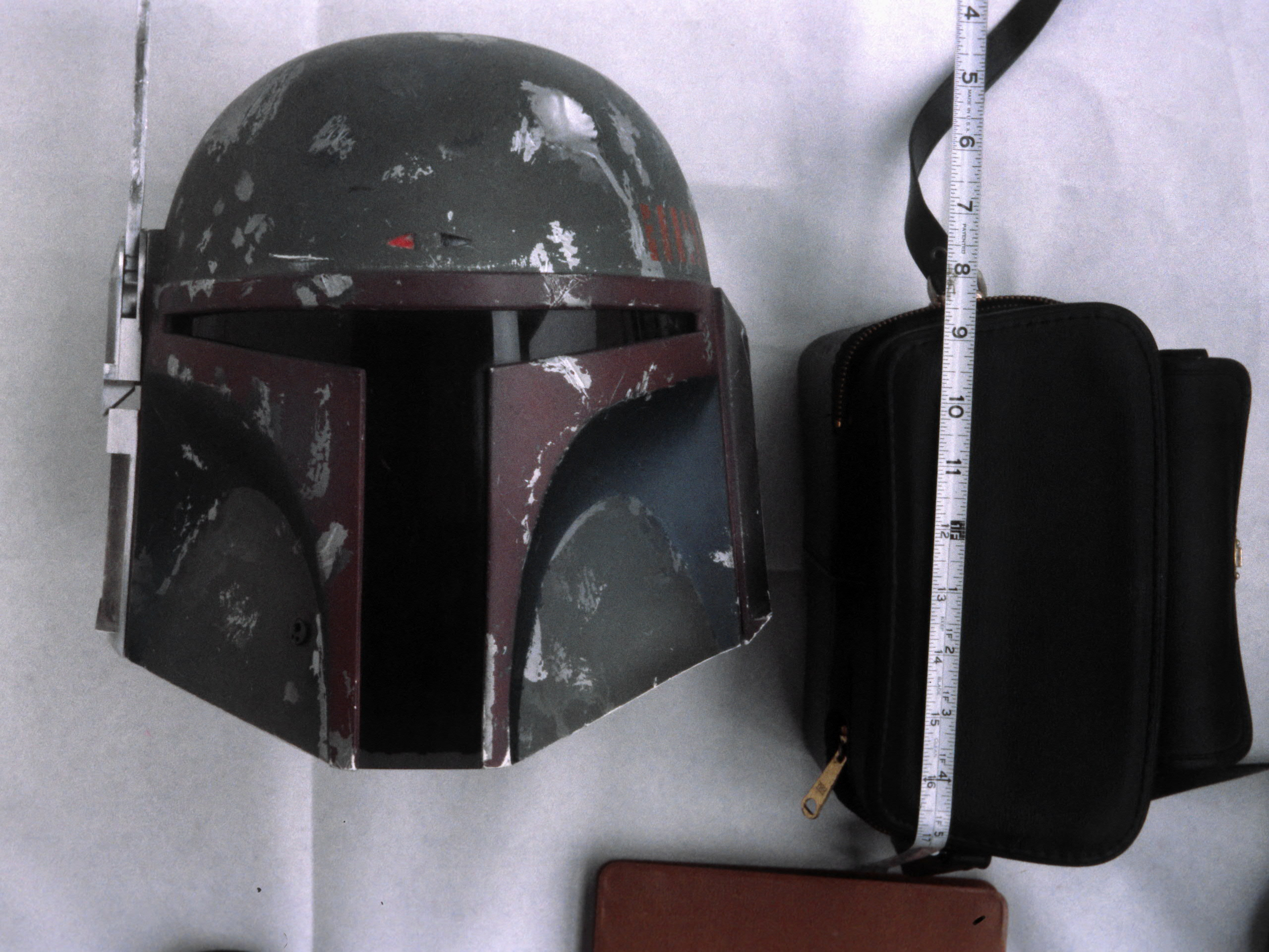

There are some images of the hero helmet here but also be careful because some of the first images in the gallery are the stunt helmet.

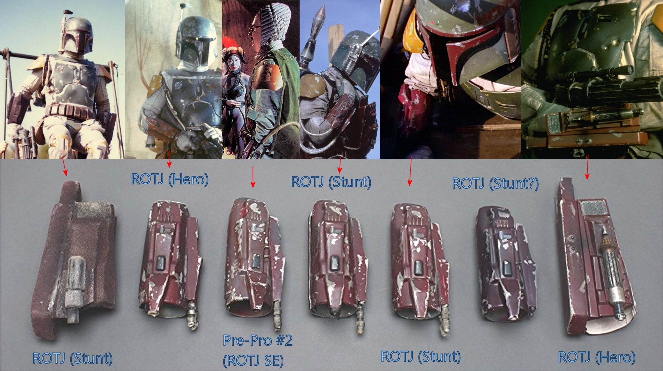

Yea its very confusing with ROTJ, There were multiple right gauntlets all with different damage patterns. Of course the one that's the hero costume version, is not featured in any modern reference exhibits to my knowledge (while the stunt one is) so its a common mistake to mis-paint that one with the wrong damage patterns.
My advice would be to follow the CRL images and the few promo ROTJ hero promo photos in the galleries above.

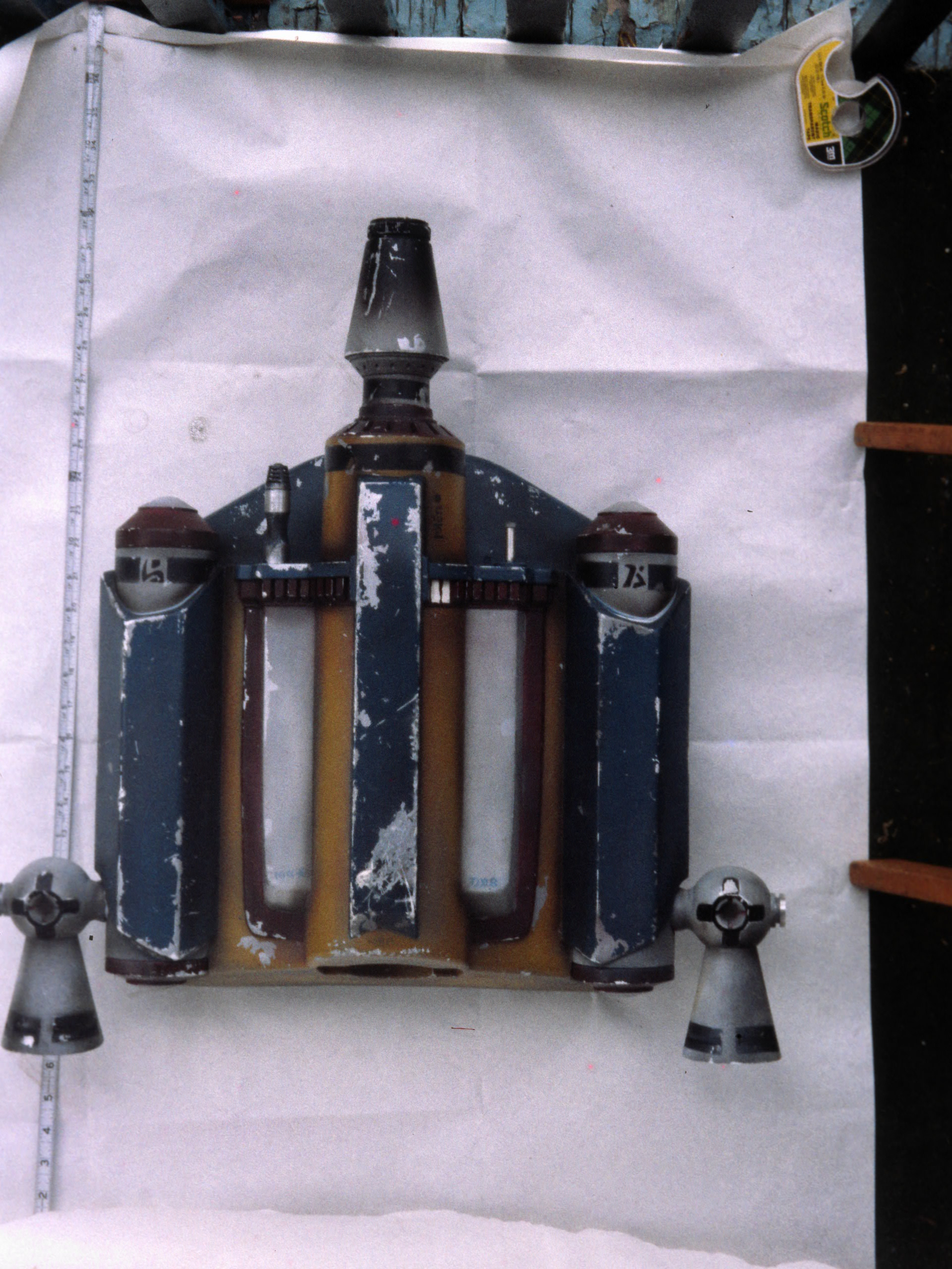

As far as the jetpack goes, there's some reference here on TDH gallery of it freshly painted for ROTJ production but it's missing some details that were damaged and or repaired before filming started:
Neo Fett does a good job explaining that in a post here.
The actual ROTJ hero jetpack is featured in some of the exhibits, but by that point in time 10+ years after filming it has a ton of additional damage and marks that were sustained over time that you should not include if you are going for the original ROTJ hero look (That would be the special edition promotional version)
Those pictures of the jetpack are not freshly painted for production. Mario painted it at the same time as PP2 and his other parts.
Those pictures with the white background are from around 1980 (is the best community guess anyway) and the jetpack would go through a lot more abuse and damage over the years before filming ROTJ.

The CRL is pretty far from perfect - especially in dent size and placement.

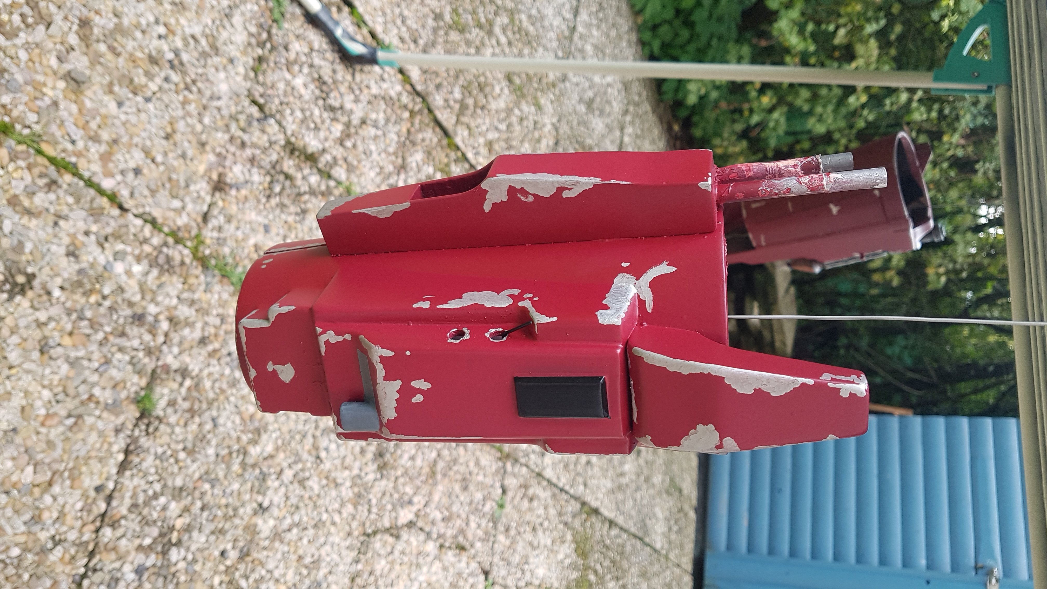

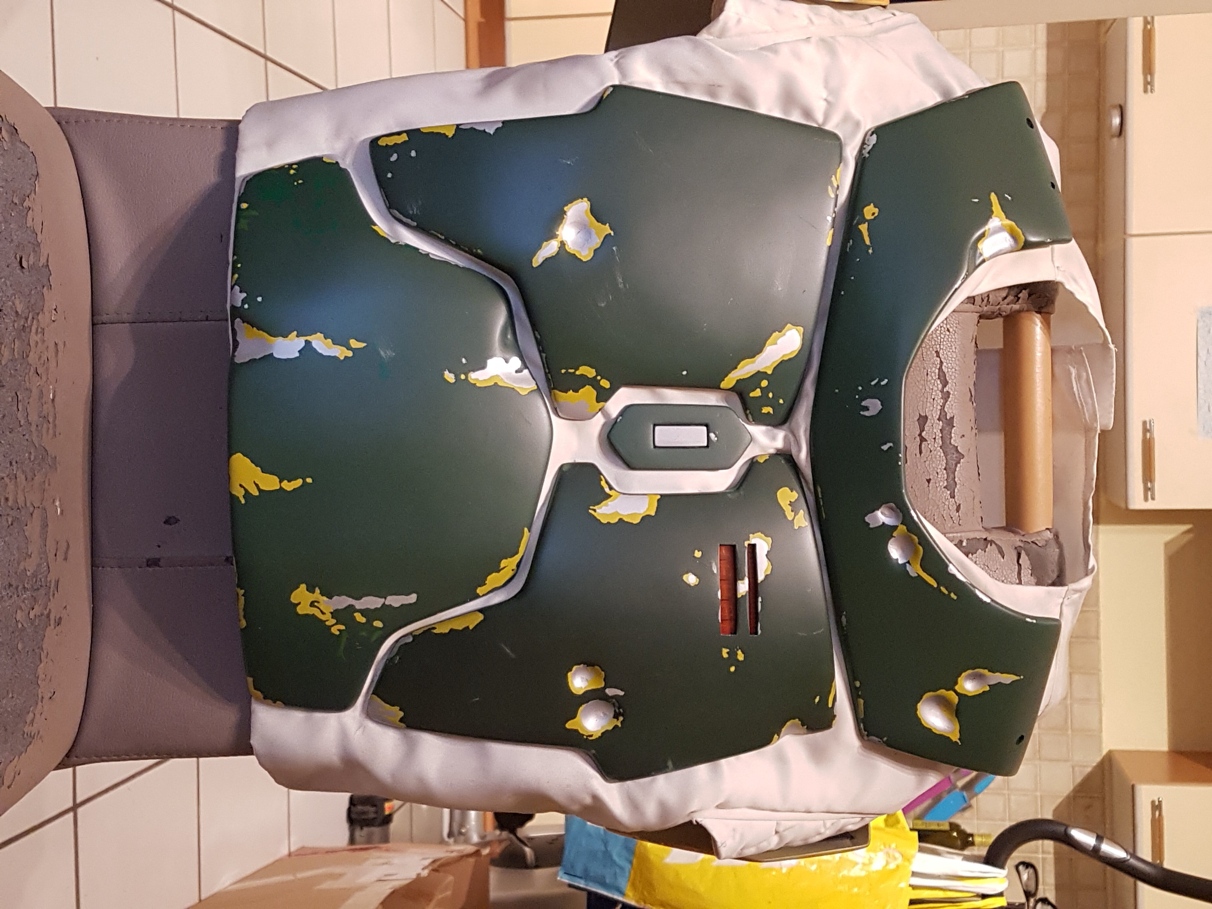

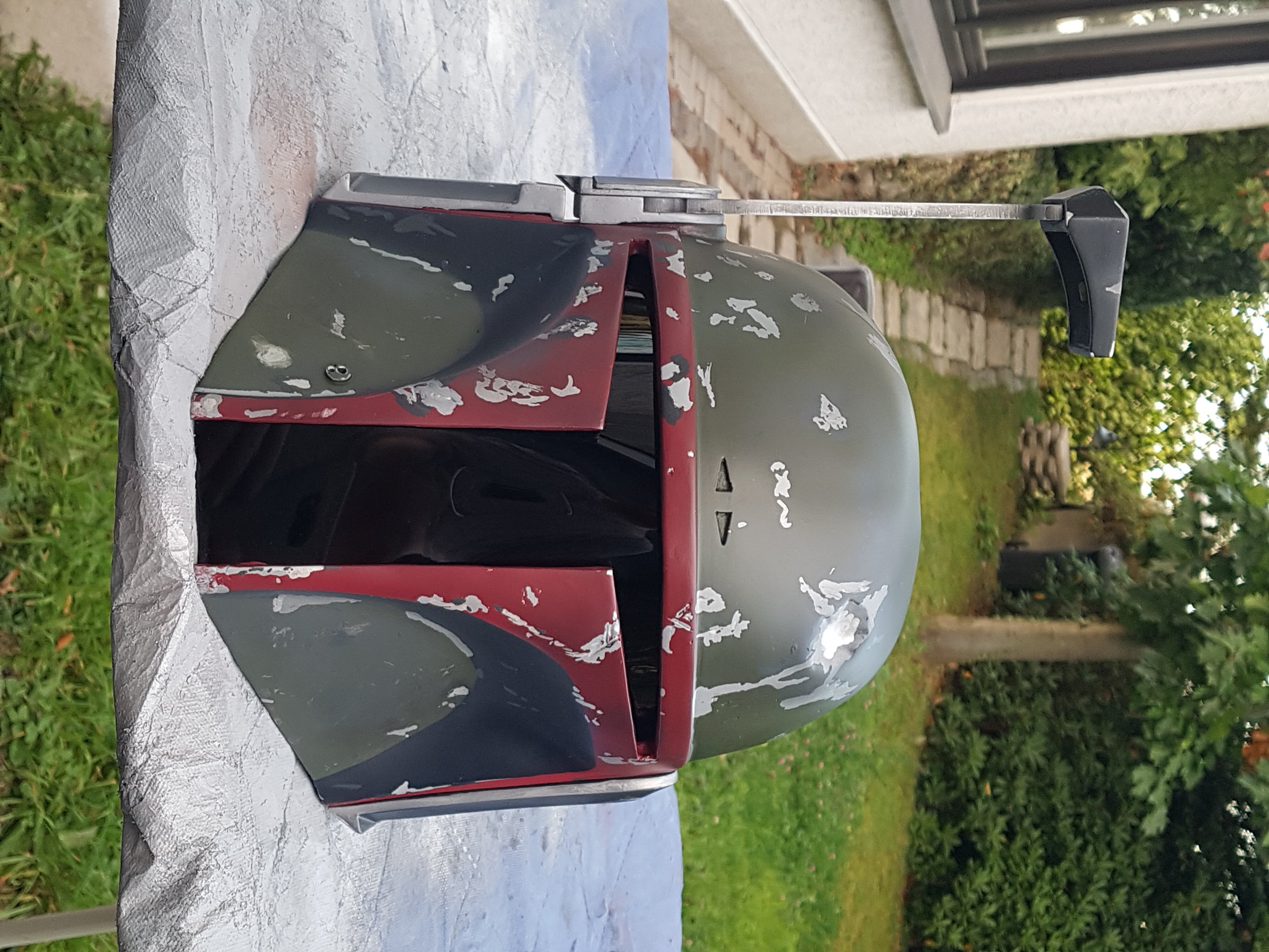

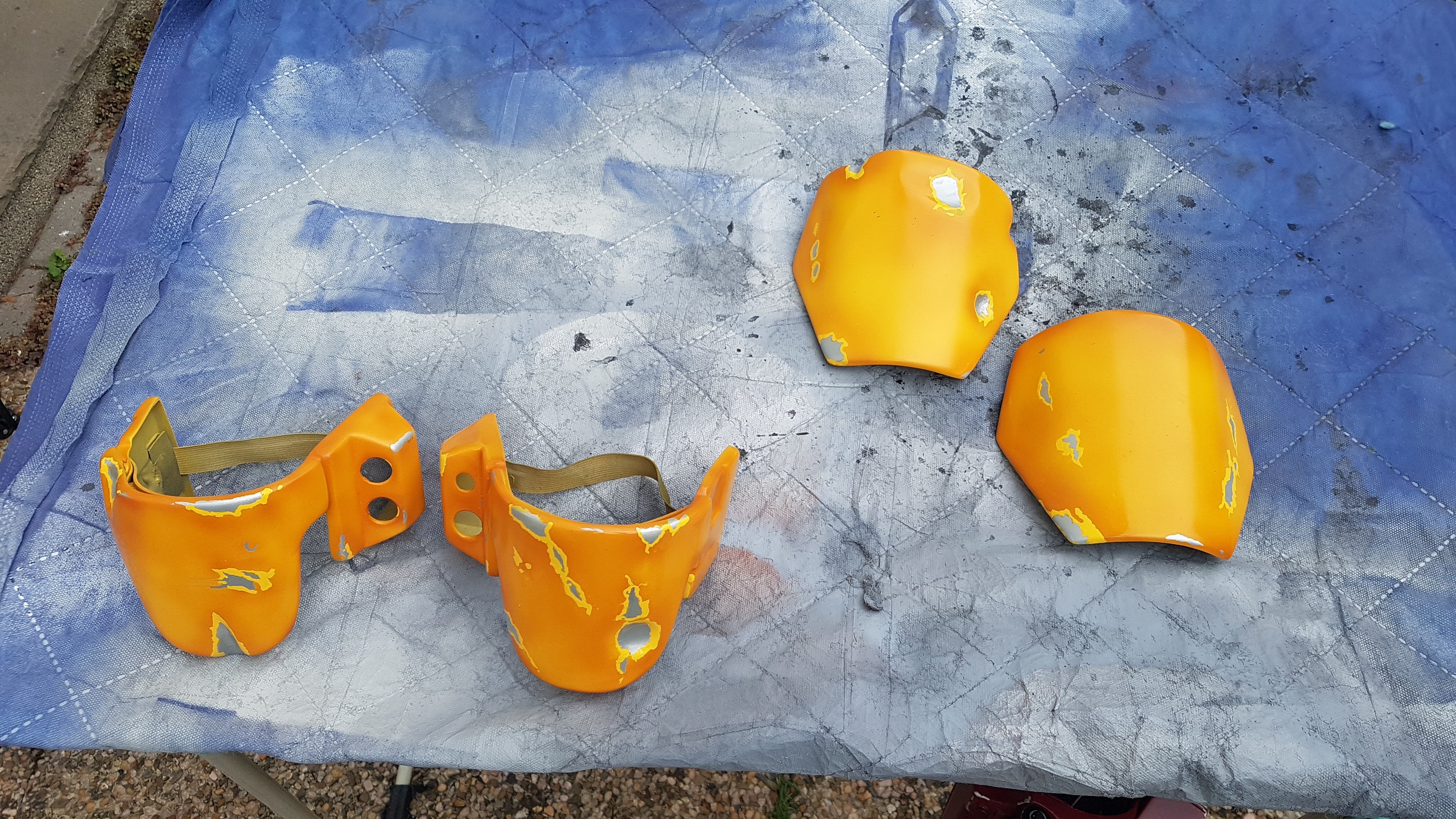

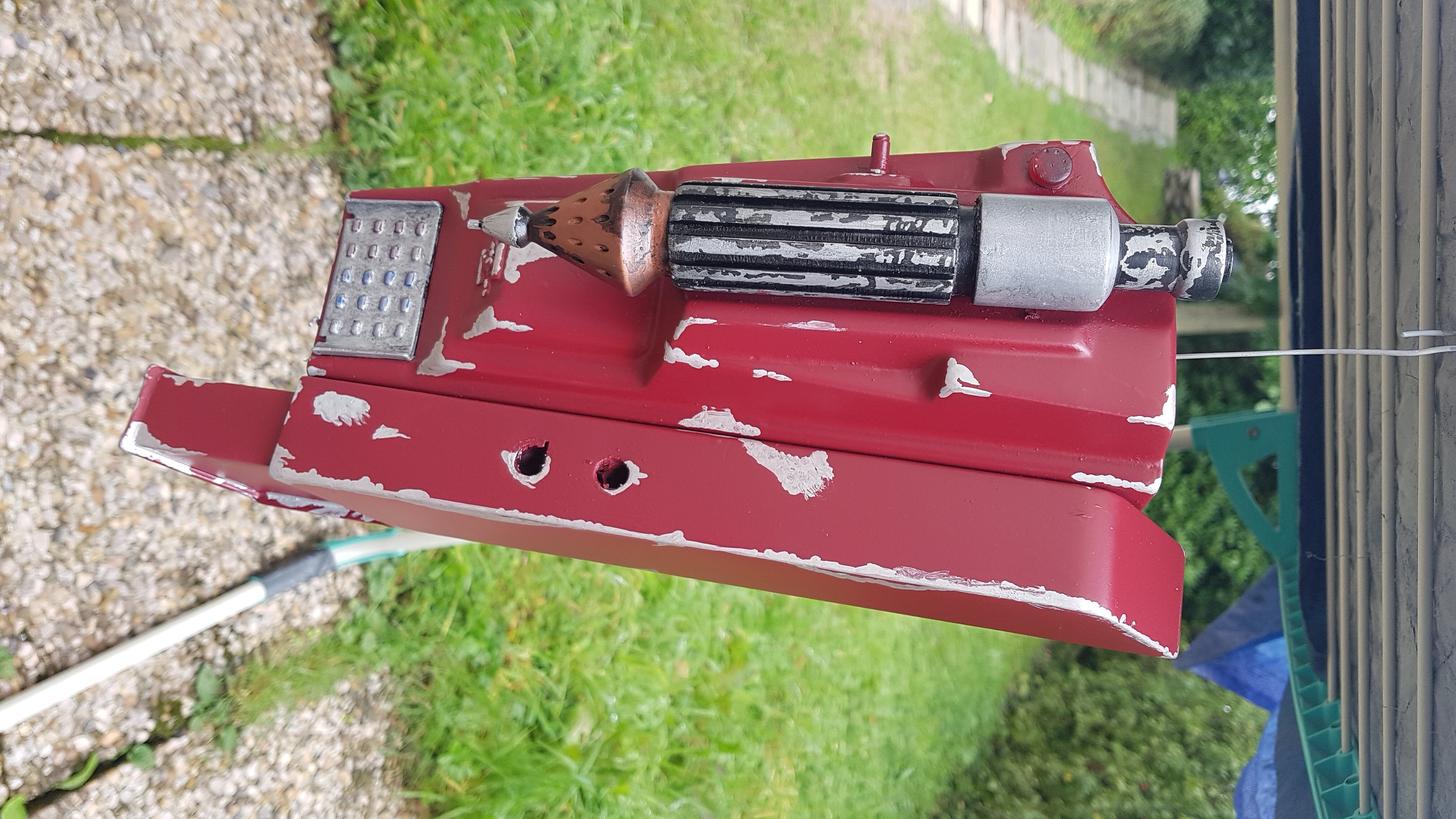

That's how I did my helmet and armor following the suggested references.
I hope this will be ok this time.
Thank you all for your feedback.
