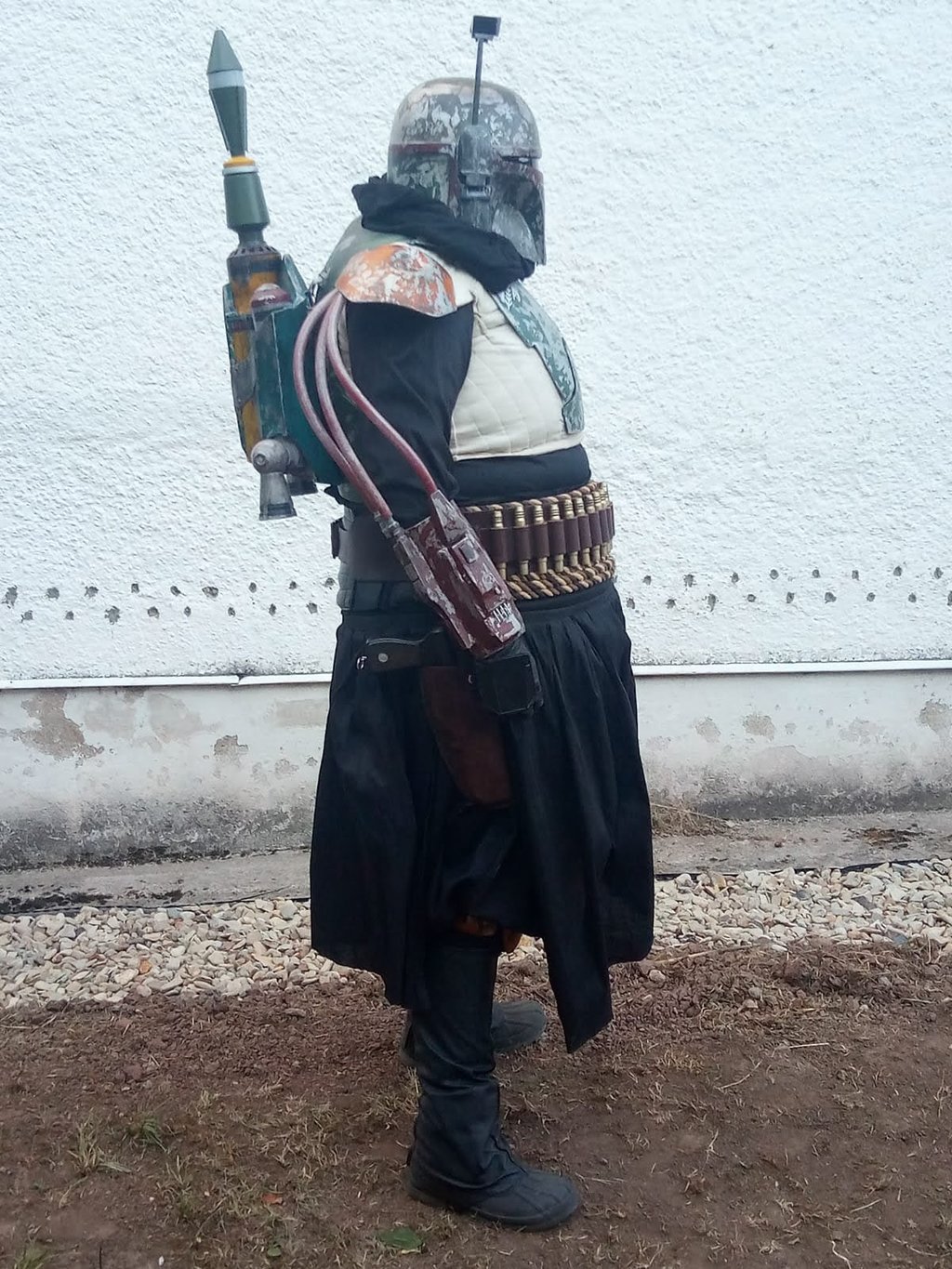

Boba Fett Re-Appearance Armor (heavily weathered version)

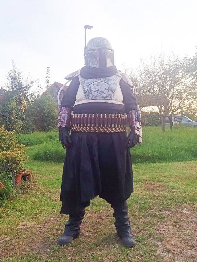

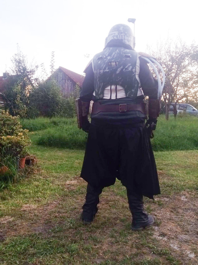

Some pics of me wearing what I have (some are lightened up, because otherwise you hardly see anything of the lower half):
Sadly, two of the hose attachments at the gauntlet, which is 3D-printed, broke off. I have to reinforce this with some metal rods, it really is a weak point. The chest light-up is not happening right now, as the technical parts lift up the plate too visibly. Does not look good.
Now I am working on the jetpack. I guess I have to add a third point of support (I am sure there is a whole in the backplate for a reason), as the thing got a bit heavy, being fully laminated and I stuck the rocket on. Also, I have to be really careful with doors. We shall see how much I get done before winter and I cannot use spraypaint anymore. The paint is really very intricate and it is more important to get it as accurate as possible than to rush and ruin it on the finish line.
Fantastic build! Looking forward to seeing the jetpack.
Thanks! They really liked it on the Mandalorian Mercs (got the permission to troop as an UM on my first event this weekend, as the kit not complete yet). But they also told me that I really have to increase the quality of my pictures. Somehow, that is my real weak point. This set was taken by my daughter on her mobile phone. But they told me these have no chance to pass even the pre-app, and I can see clearly why. So I will mostly work on that...oh well, you always learn new things (I am not a great photographer myself).

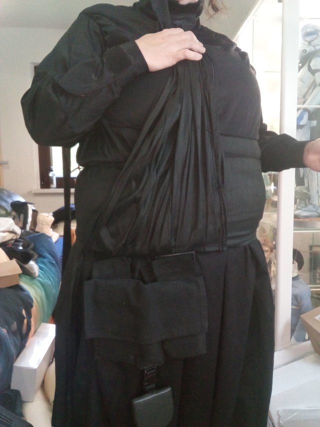

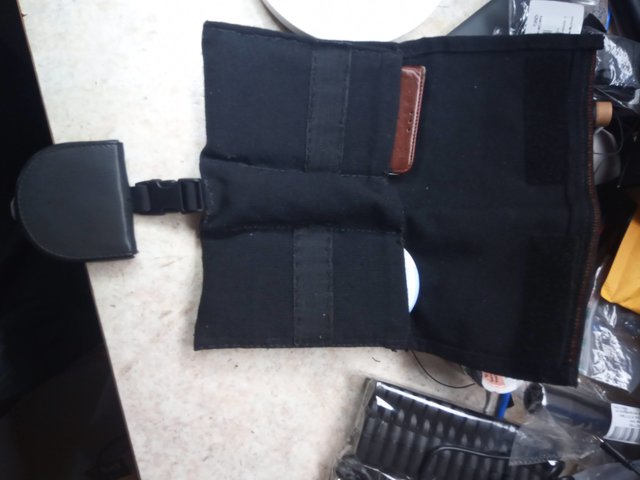

To increase my creature comfort, I made this little pouch to go under the...half skirt thingy:
It hides really well under the raw-silk sash/half-skirt thingy. And it allows me to take my phone with my important cards in it, my glasses in a flat, metal case, and - most importantly - my asthma spray with me. I know it looks a bit crude, but it does its job. As both the pouch fabric and the raw silk are rather coarse, nothing shifts, and due to the pleats/folds you cannot see it. As it is attached via velcros, it can easily be removed for pictures or actiony things (which I do not know to what extent I can perform these - but still - the option would be there).

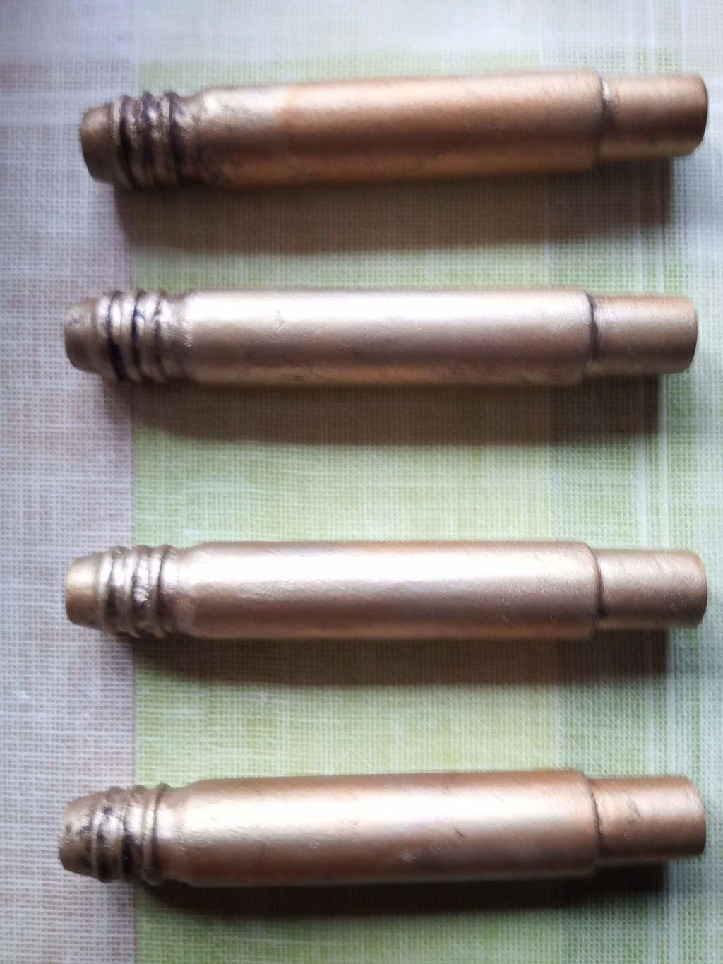

I got my gauntlet fittings fixed (I put some tighter-fitting sleeves under the shirt and installed neodym magnets. Holds really well). I also got some Oyumaru and will try to recast the tiny gauntlet rockets in rubber. I already broke off two of mine, which is really annoying. Somebody said I could get some in machined aluminium, which I think is really dangerous if you get stuck on stuff things (imagine tearing another cosplayer's costume with these things. No bueno.) Also, ordered a aluminium-machined rangefinder stalk, which needs to be installed. Hopefully, I can use the electronic device I have for this thing.

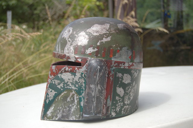

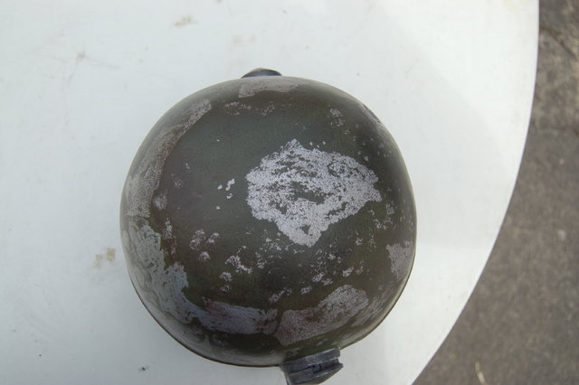

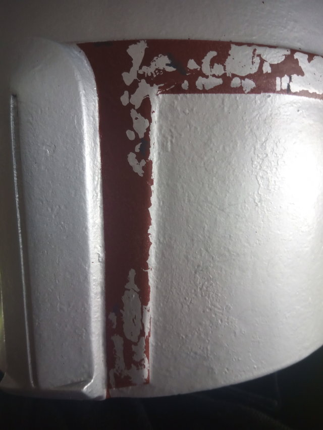

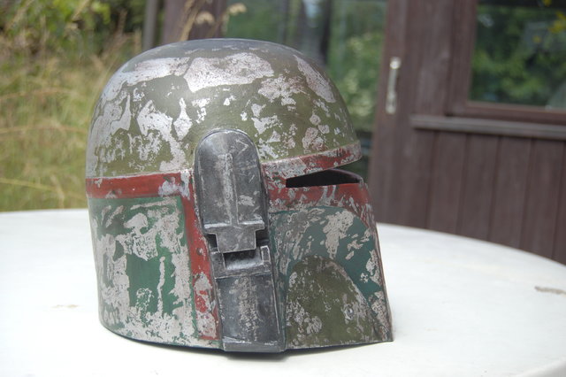

Really nice work on the damage! How did you go about making the chips?

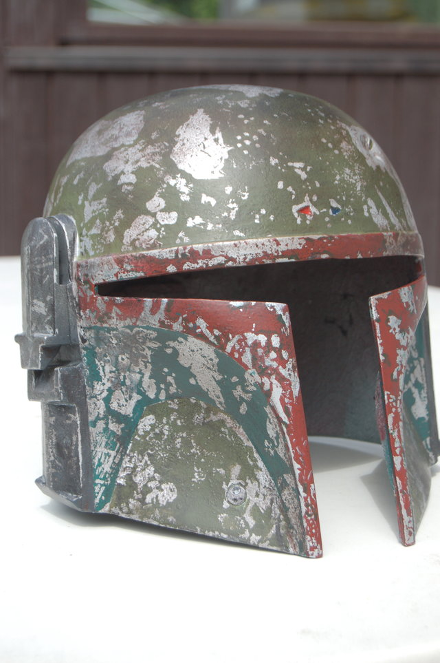

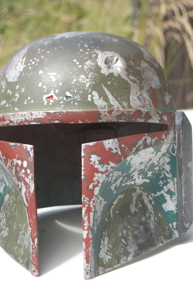

The first step is to sand the plates with some rather coarse sandpaper. I just removed the printlines from the plates, but did not want a perfectly smooth surface. Then I made the chips with toothpaste. The first colour layer is rattlecan aluminium (or Beskar, if you like). Then I looked at the reference images and applied the toothpaste with a brush with hard bristles. This way, I did not get any bristle strokes. After that, I used some granite effect rattlecan spray. This is textured, but it was used sparingly. This creates the raise paint effect (or rather where the sarlacc spit damaged the paintjob). Then I applied the correct Boba green, also out of a rattlecan. Of course you have to wait between every layer until it is dry.
Then I took a bucket of water and a sponge and rubbed merrily away. Everywhere where there was toothbrush, the paint plus the granite effect paint went away, revealing the silver under the green, but with the green sprinkled in the coarse surface (what we want here). I applied black and brown wash, which makes it even more believable.
As the final layer, I applied Mod Podge Hard Coat. This gives a very nice, deep effect. In order to avoid brushstrokes, I applied it with my fingers. Now I do not know if this a very safe and healthy method, but it looks grandios IMO.
Well, and then you have to wait in theory 30 days for the Mod Podge to fully harden...which I did.

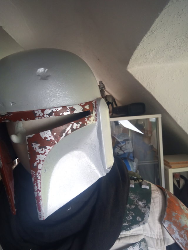

Also, what I could prime is primed by now. Hopefully, temperatures will continue to rise, so that the shells and the blaster can receive their new paintjob. Oh, and the helmet, of course.
Some updates:

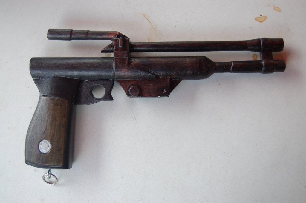

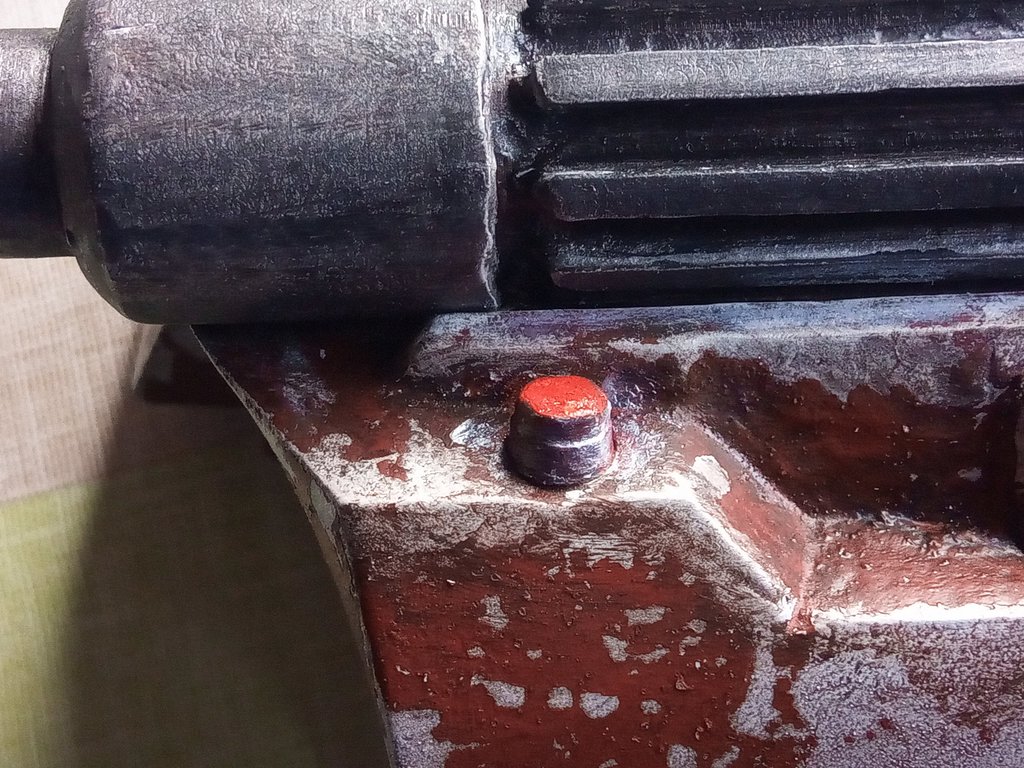

Changed the LED on the left gauntlet according to the now official CRL on the Mando Mercs forum. I repainted the blaster, as well as the belt shells. Also, I started on the repaint of the helmet, but for now I am waiting for the correct colors of rattlecans. The jetpack is also well under way, everything is printed and the jetpack body is fiberglassed. Also made the brackets. Next is installing them, then glueing the two halves together. After that, installing the greeblies (everything is sanded). If the weather stays the way it is here, I can do the primer, then the colourful parts.

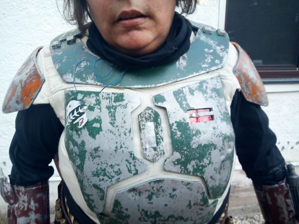

Some updates (zip in correct colour, cleaner shoulder part on the flak vest). Also the first battle damage which was okay with the Mando Mercs:
Now I am figuring which of the settings of my chest LED display is correct for this Boba Fett version. I have 4 options. Does anybody know how the sequence is?
