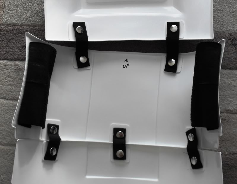

Use E6000 glue, this is what many TK costume builders use to glue the snaps to ABS. First create you snap using say a 1inch sqaure piece of ABS. Drill a hole through it so the snap fits and hammer it home. Then use the E6000 glue on the snap and glue it to the armour.. Cures in 24hrs... solid and will not ever come off.
Here's an example of some snaps made for TK armour... Made by a good mate of mine FBJ... You can see the square pieces of ABS to which the snap fits and these are then glued to the armour..
I do something similar for my stormtrooper armour, the only difference is I use squares of webbing glued with E6000 to the armour instead of squares of ABS. The difference is that webbing can work better on uneven surfaces ... but squares of ABS looks sexier and more professional ;)
E6000 will come if you want it too, I pulled apart my stormtrooper thigh armour a week or so after it set. It comes apart with a little brute force, and can be fully removed with white spirit, leaving no trace of it. But it's deceptively strong stuff and won't come apart by accident, or normal use.
The only downside with it, is that it takes 24 hours to cure, but if you make a mistake that can be seen as a bonus.
