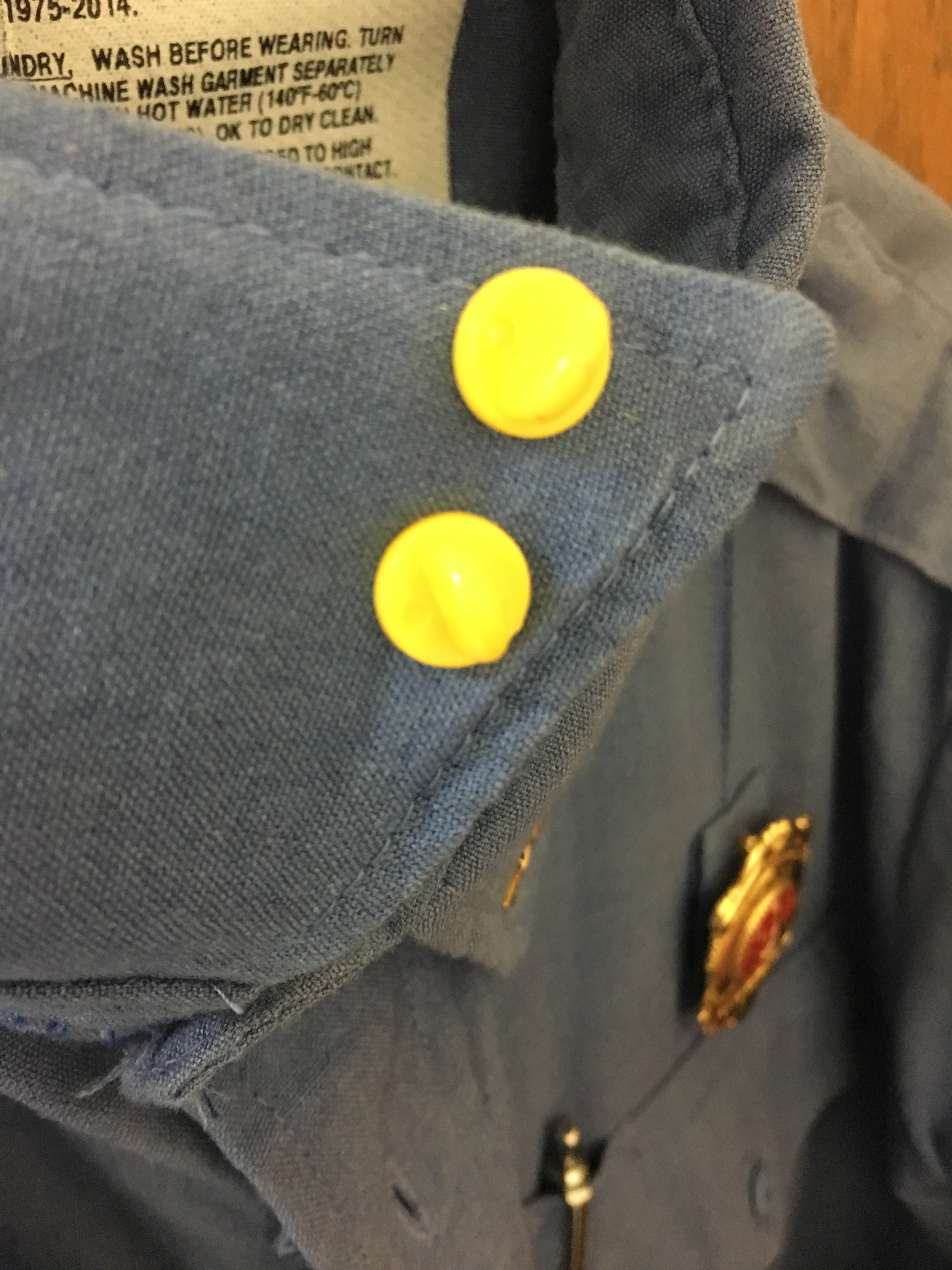

Bought some pins and rubber clutch backs the other day.. I gotta say! I think I like the rubber ones, just a much as the metal ones! These work great!
Unfortunately, the rubber ones will wear out and probably fall off over time. I have those type for my work uniform and they suck.
As much as they will be rubbing against the flightsuit on the inside, the holes will soon become stretched out and they will fall off.

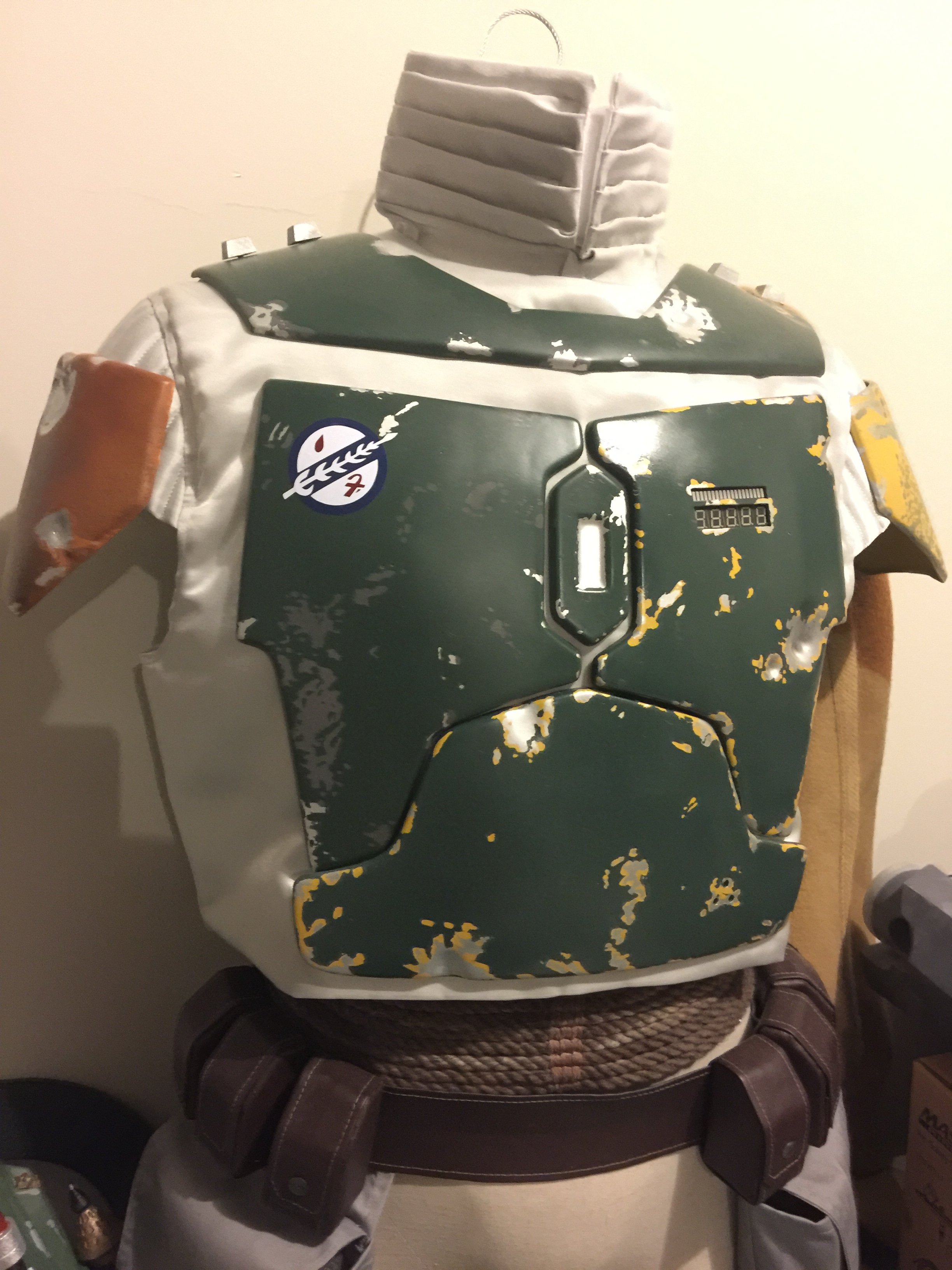

Nice spacing, JReevy! One of my pet peeves is people spacing the armor out too much. It is really tight with a decent sized gap between the collar and chest pieces. The advantage of the jewelry pin method is that if you get the spacing wrong, it is really easy to change and then keep it like that. Even if I were going to do the screen accurate bolt and eyelet style, I would still probably make the eyelets, then use the jewelry pin method to assure that everything is properly aligned before gluing in the bolts.
