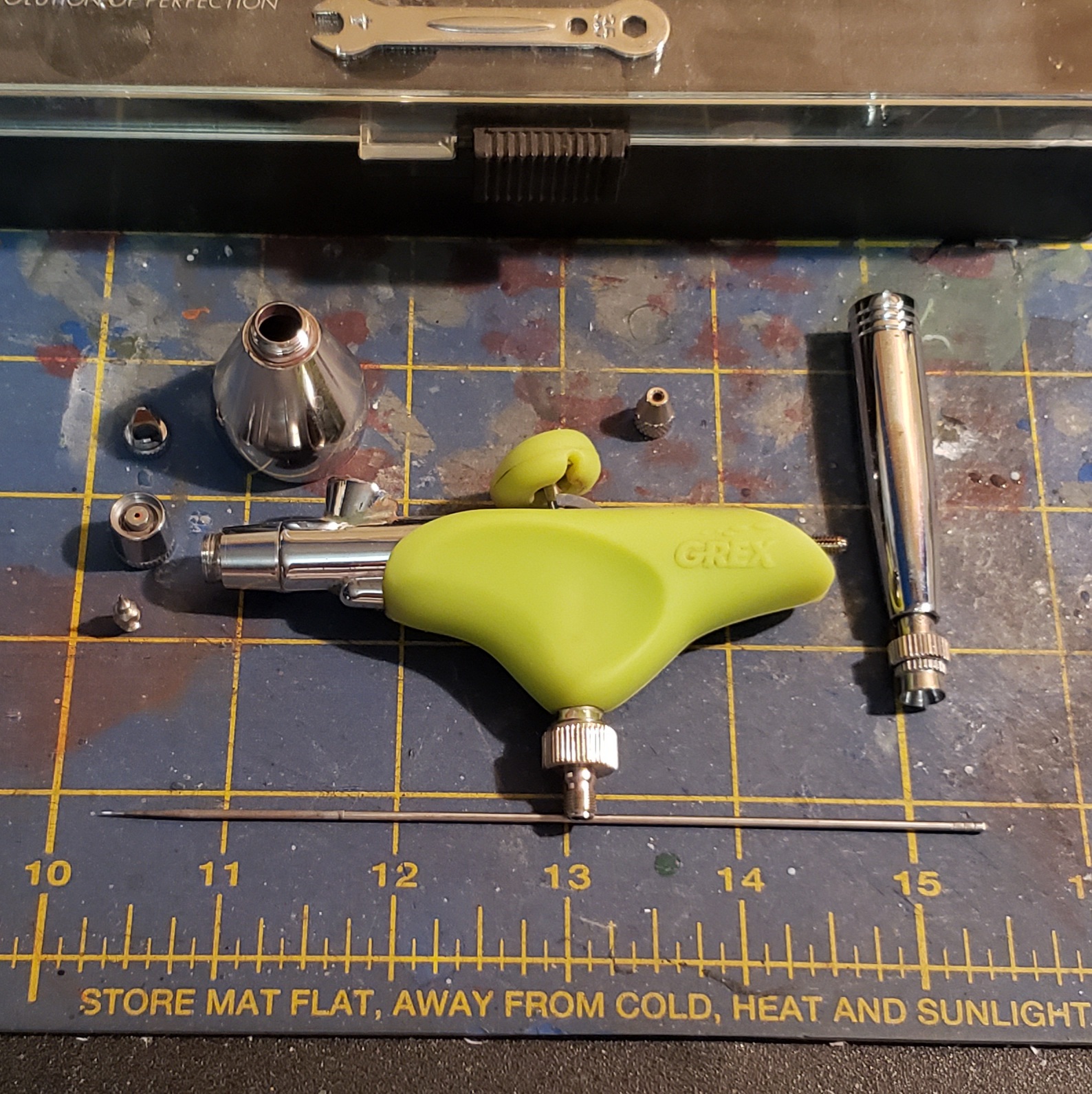

Stripping the airbrush down takes about 90 seconds. Follow the instructions for your airbrush. Here is my "field stripped" Grex.

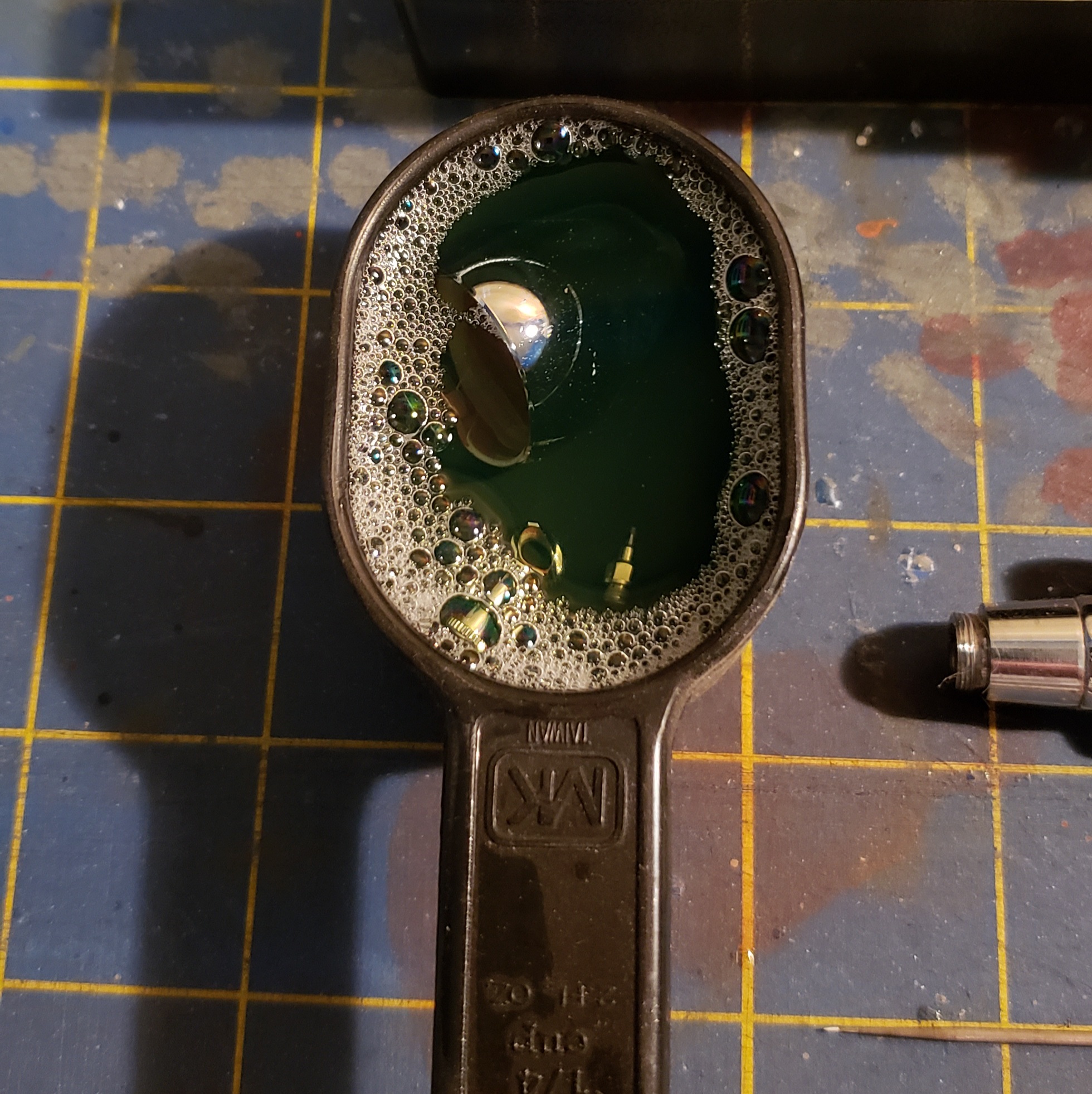

I put the nozzle, the nozzle cover, the needle shield, and the color cup into the small measuring cup, then fill it with airbrush cleaner until all the parts are submerged.

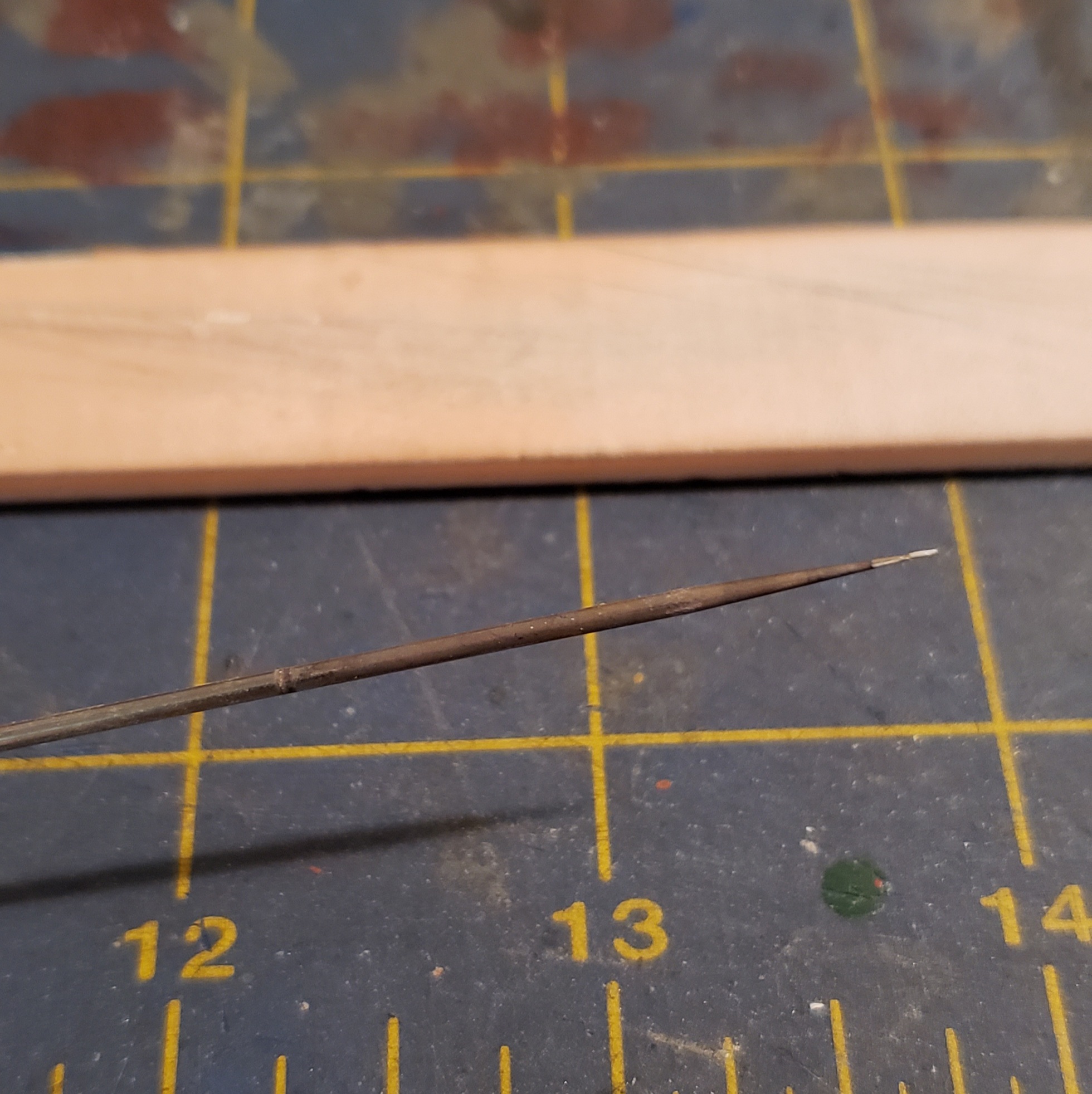

For the needle, I use a very fine grade polishing stick to remove any paint residue.
Here's the needle before polishing.
![20200927_074719.jpg 20200927_074719.jpg](https://thedentedhelmet-f28a.kxcdn.com/forums/data/attachments/198/198924-87e2db49ca9e074941097bf4c3a33b55.jpg?hash=h-LbScqeB0)

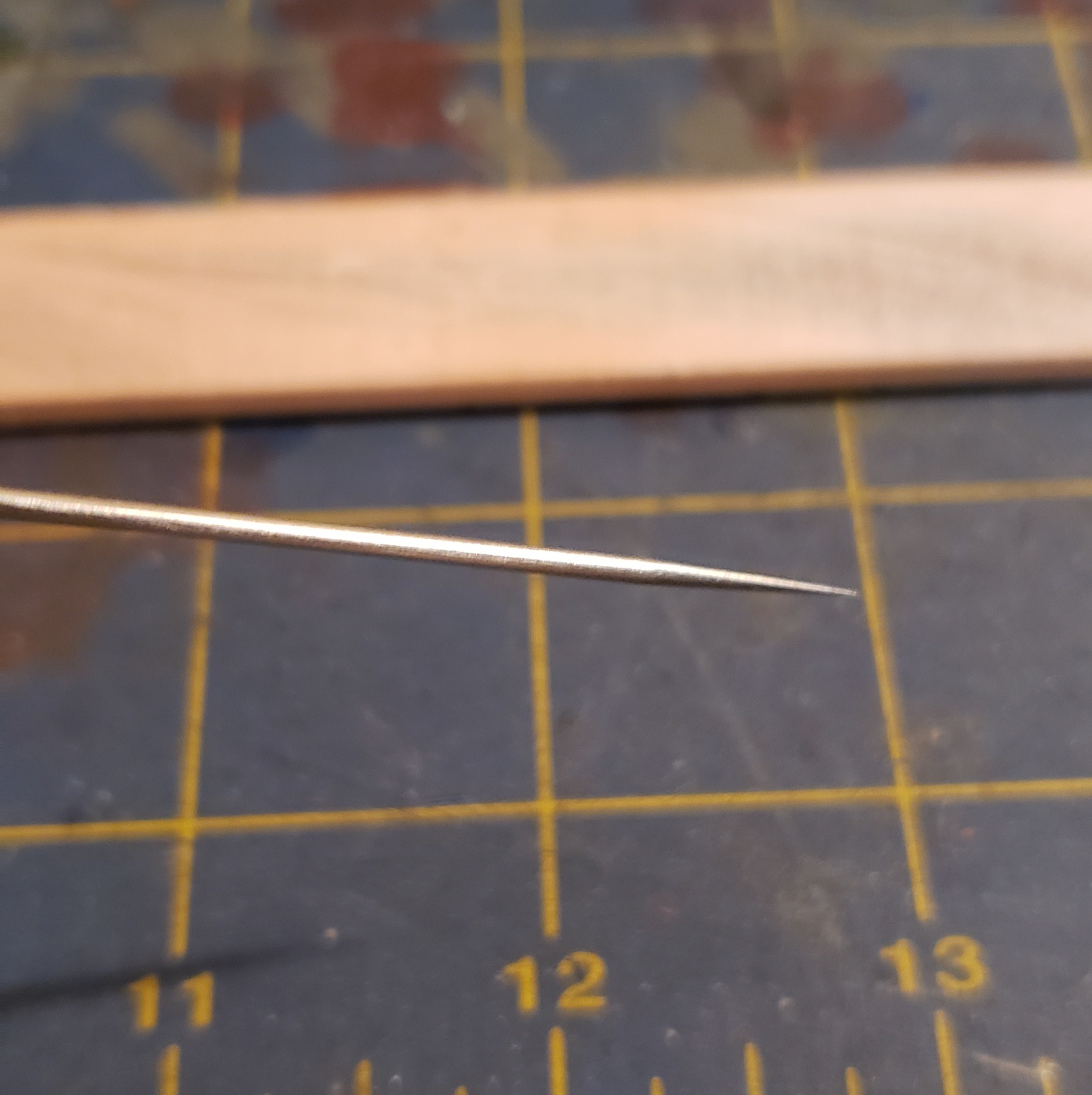

And after about 30 seconds of polishing.
![20200927_074705.jpg 20200927_074705.jpg](https://thedentedhelmet-f28a.kxcdn.com/forums/data/attachments/198/198925-be6ef2334ab2a8af2b9ede293caf1c03.jpg?hash=vm7yM0qyqK)
I do this very carefully so I don't bend or deform the tip of the needle.
I let the parts soak in the airbrush cleaner for about 4 hours, then use the small cleaning brushes to clean out any residue inside the nozzle and other small parts. Then I reassemble the airbrush and I'm back in business!
