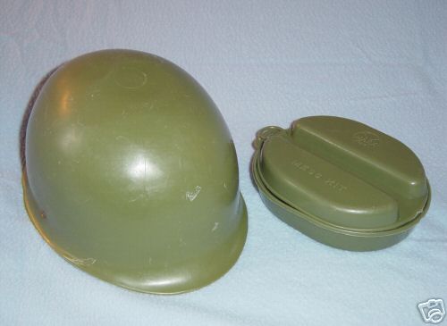

No, didn't make any progress pics on the helmet. I basically followed the tutorials that have been posted on the site, substituting the toy helmet (like the one in the below pic) dome for the batters helmet that was shown in the tutorial. If you can get your hands on one of these helmets from eBay or local toy store, it works great for a kid-size Boba helmet. I printed out the Wizard of Flight templates at 75% scale on a laser printer and the scale worked perfectly to match the helmet size. You have to cut away an inch to an inch and a half from the bottom of the toy helmet as they often have a turned-out flange on them to match the look of a military helmet.
