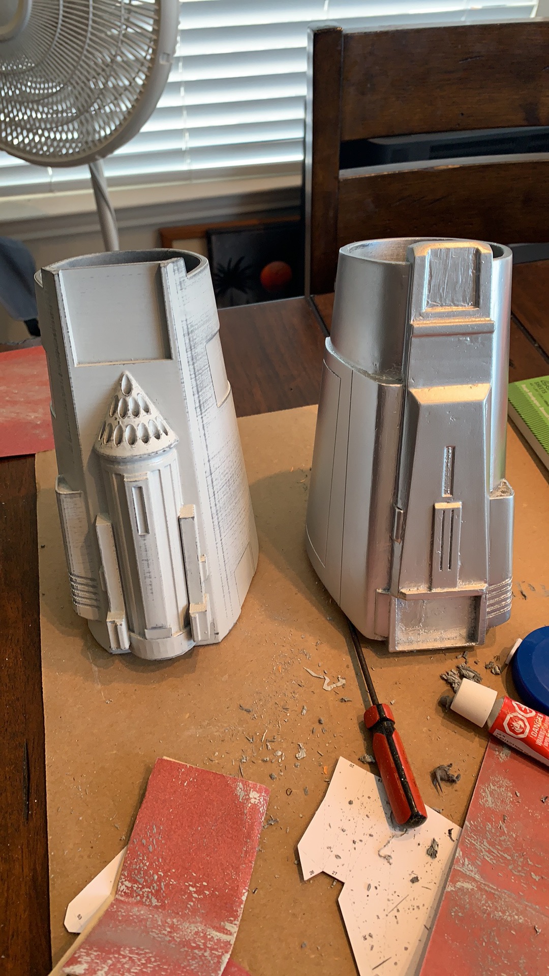

I recently bought a set of 3d printed Beskar Mando gauntlets. They are single piece slide and look great. I have however encountered a problem with the wrist end being too small for my right hand, left goes on and off perfectly. I have seen some people use piano hinges for the ROTJ Fett gauntlets but I am unsure how to split and then resecure 3D print. I’m also looking to split the left gauntlet to hollow out the whistling bird launcher to use fiber optic lighting to create the effect of them turning blue. Does anyone have any experience cutting 3-D print and resecuring it like that? I really hate to destroy something that I paid that much money for.

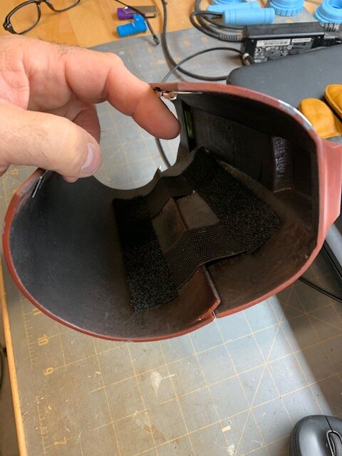

Putting it all back together is a different matter. If you don't mind seeing the hinge then you can follow Cruzer's tutorial in the Jango section. If you are going for a screen accurate look and don't want to see the hinge, there are still a couple of options.

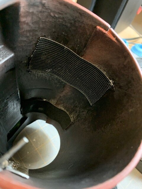

You could glue in elastic with E600 on both sides of the inside gauntlet and it will have enough give for you to wiggle your hand through (probably the best method since you can already put on one gauntlet)
Or
You could glue in hidden piano hinges. One side would have the loose pin for opening and the other side would need to be a flexible hinge. Because of the way my gauntlets were modelled I needed to be creative with the construction of the flexible hinge and I had to glue in elastic. My setup works great for me and there is no chance of these ever slipping off. My gauntlets are also extremely close fitting so I knew I wouldn't be able to make a full elastic closure work, I really have to stuff in my gloves.

bigkidbiggertoys, They are PLA. My first thoughts were a dremel with a fine cutting wheel. I didn't give any thought to the heat it would generate. The hinge is what I was considering, I was just not confident in my mind of the exaction. The Elastic on the inside as a hinge is definitely more inspired than I was considering. Do your gauntlets stay in place well on there own or do you have an additional contact on your sleeves that keep them in place? I was thinking Velcro on the upper and lower sides of my arm to hold it.
My gauntlets are very form fitting so I don't need any velcro to keep them in place but I did add a strip inside in case I needed it.
My Jango gauntlets are a little looser so I just added some padding inside and they don't spin around at all.
