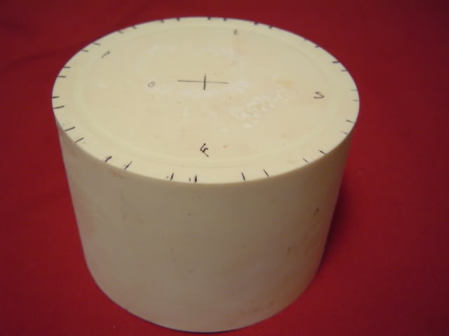

1) Yes... It is curved on both the x and y axis. So it conforms nicely to the shape of a back (or backplate:) )
2) The only thing filling the center is the pvc pipe for the center tank. Other than that it is pretty hollow. I used some steel bar GOOP'd to the long flat pieces of plastic so that they would keep their straightness.
3) According to the bathroom scale the total weight as of now is 6 pounds. This includes the upper tank piece which as of right now is still a solid piece of resin. As you can see I have done some initial marks for the placement of the "teeth" or "keys"...
I used a planters peanut can as a mold for this.
Step by step...
  • Buy Peanuts
  • Enjoy peanuts
  • Wash out empty can
  • Set can on top of the "top deck" of the jet pack
  • Place a pen on the top part of the jet pack backplate
  • Rotate can fully making a line around the can
  • Mix Resin
  • Pour resin to line
  • Let cure
  • Wish that you had more peanuts while resin kicks
  • Tear apart can and remove resin block
If you do it this way you may want to use some type of mold release before pouring in the resin or the wax lining of the can will stick to the resin. I had to sand quite a bit to get it all off. I puttied up the seam of the can and sanded it smooth.
I have now decided that I need to go to the grocery store and buy some peanuts :)

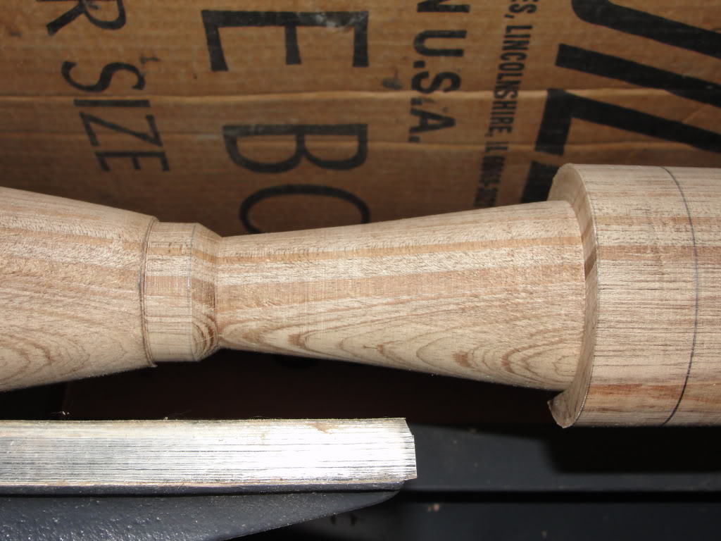

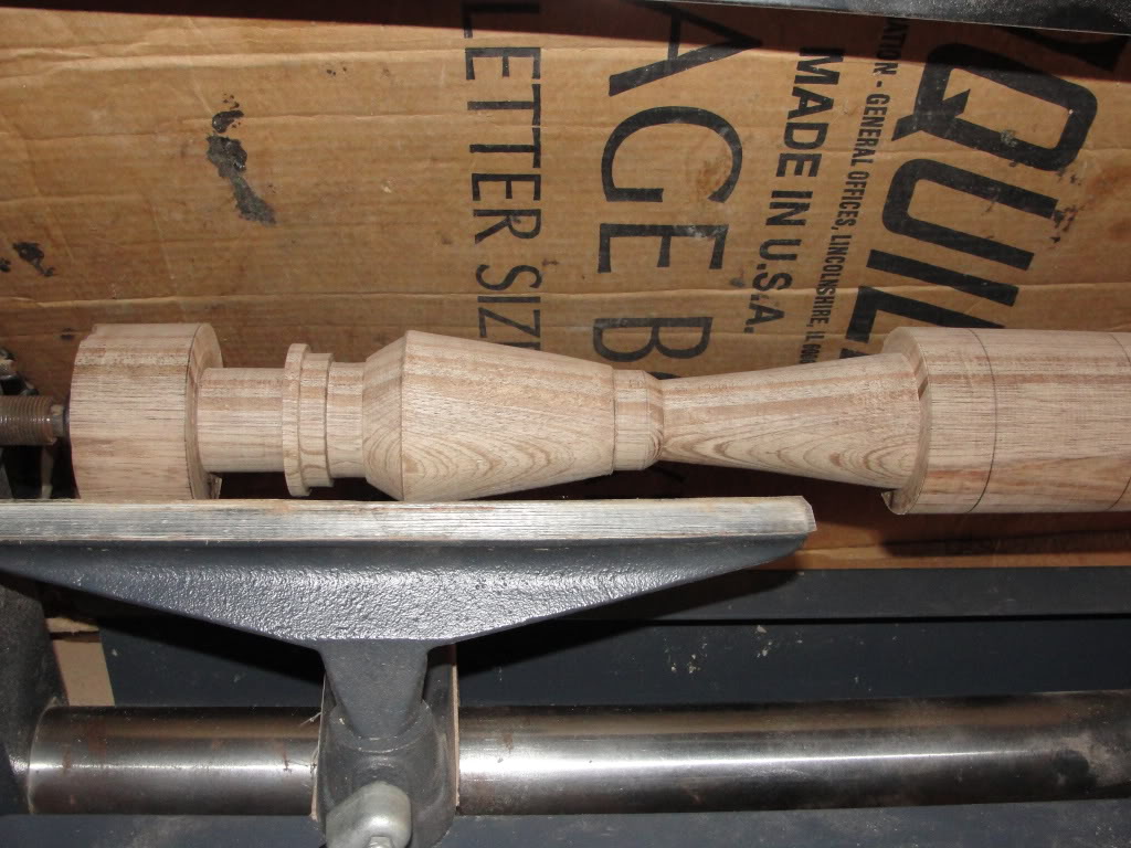

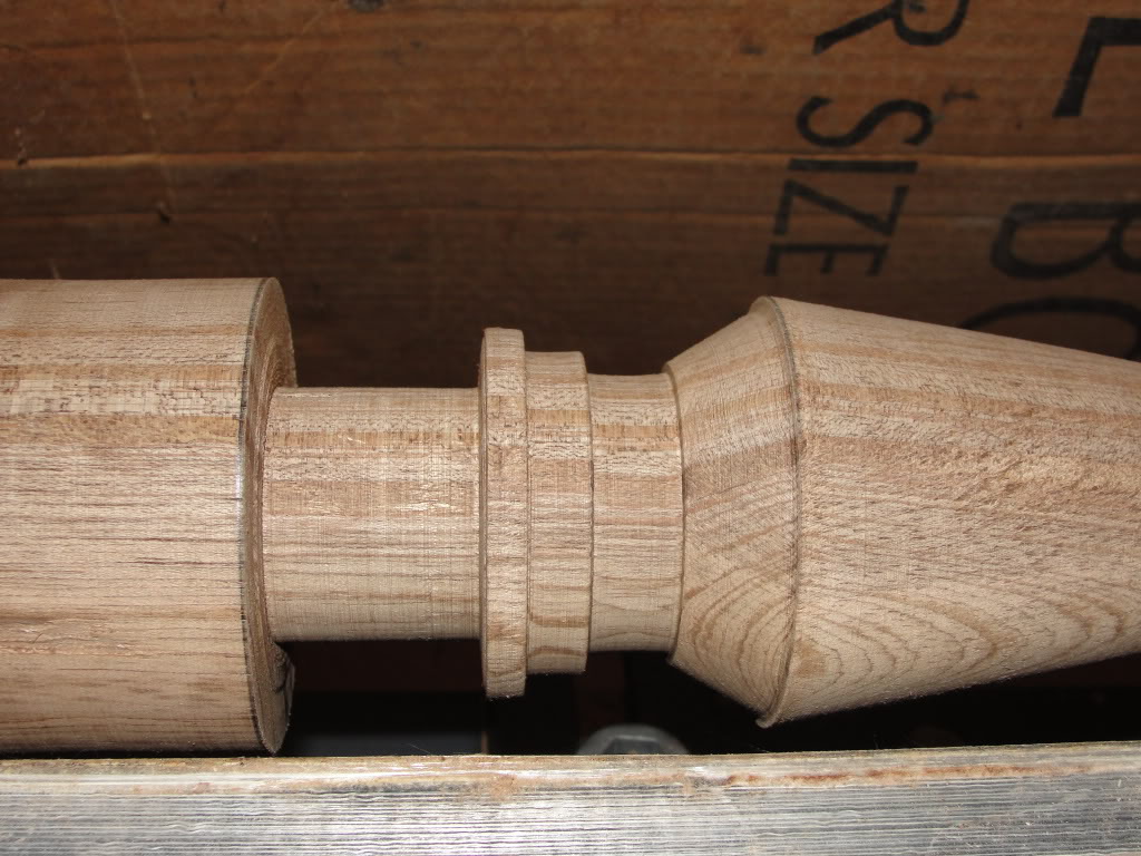

Well after several years away from Boba I decided to do some more, lol.

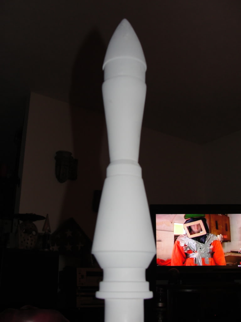

I finally got the gumption to try my hand at the rocket with a lathe. Not done yet and it will probably be a few weeks before I'm at the lathe again, but I thought I would post progress so far and see what everybody thinks.
Nice to see you again drokkul! The rocket looks really good to me, so well done bud :thumbsup:
Great! This is one of the builds that inspired me to build my pack! Glad to see you're at it again!

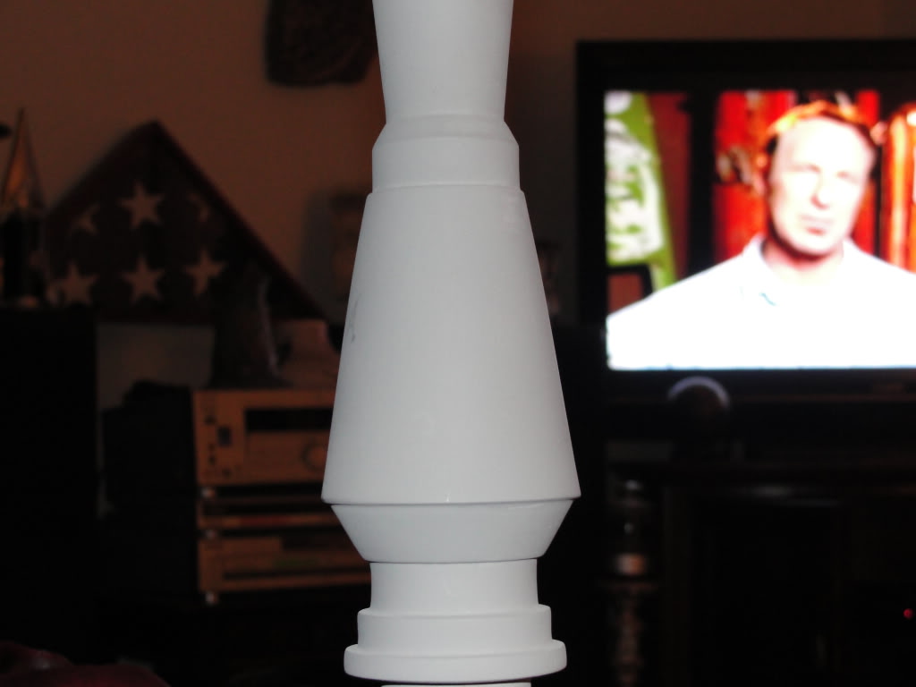

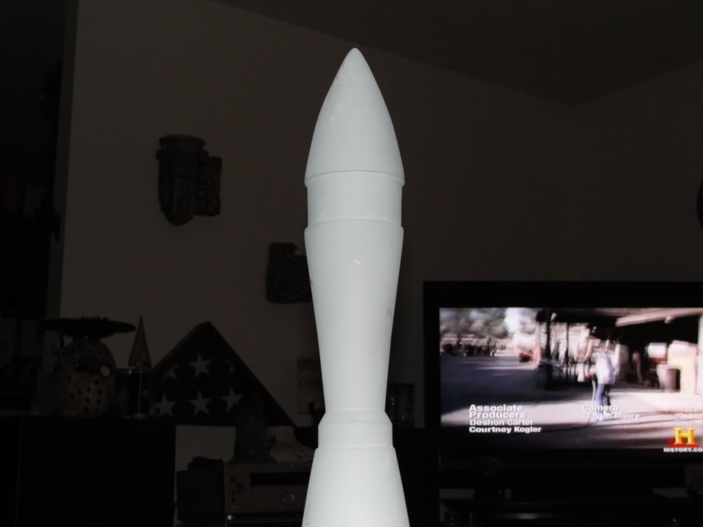

Thanks for the kind input on the missle everybody! I've gotten the main lathe work done and am smoothing and priming out the wood grain. I should have some new pics up soon!
As promised...some new pics with the top cut and smoothed and primed.
Next will be carving out the three indentations near the top, drilling the holes around the bottom, and working up the fins, and figuring out the mid ridges.
Thanks for looking!
