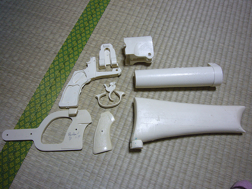

This past weekend, I got some Fett parts from a friend. I got a flak vest and neck seal, I will have alter them to fit properly. I also, got some resin parts.
I've found some previous builds on here of resin kits so using those are helpful. There is some writing on some parts that I think say "Budget Fett"
I'm trying to figure out what parts I still need.
I think I need greeblies for the stock, scope, scope mounts, molex connectors, and some lever looking thing that goes about the trigger. I'll also have to get some kind of tube for the end of the barrel. I found scope mounts and molex connectors on ebay, but I'm skeptical of ebay sellers sometimes.
Is there anyone on here that sells those parts separately? or any advice for this kit?
yes, that would be a budgetfett kit...made by Seven about a year ago...great kit for the money originally, but lots of work involved with these...you need:
stock greeblies-2 square and 3 or 4 aerial plugs
barrel mounts
scope/rings
shrouds (u shaped pieces that go over the barrel mounts, have 2 holes in the front)
molex connectors
heiland flash tube
v8 arm and disc
sling/sling mounts
you just have the webley cast there...all these pieces are needed to finish her up!
contact BH-2647 for original molex connectors, not casts...he is a member here
sidewinder (UK based) may help with barrel mounts (i think his barrel mounts have the shrouds molded in now) and stock greeblies
shrouds you can make out of aluminum strips
for the sling, sling mounts, scope (real scope, not resin), flash tube, v8 arm and disc, i may be able to help...shoot me a pm...
you can also get alot of this stuff from stormrider, i believe he does just the parts minus the scope/sling/sling mounts/flashtube as a greeblie kit...i know he did them awhile back, not sure if he is still doing just the miscelaneous stuff, i know he does the webleys for sure...
hope that helps!
