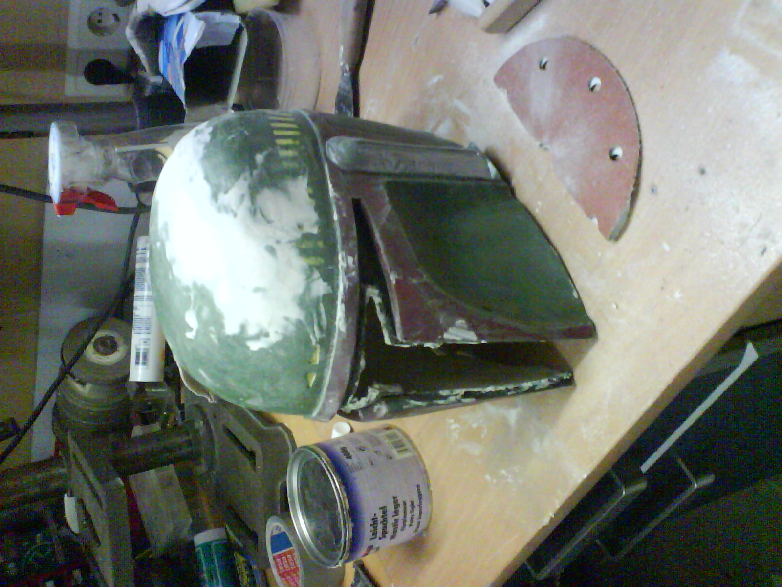

Well now my problem: i have an old Rubies Boba helmet which is in a pretty bad condition. It has got some cracks and is deformed in some areas. For the deformed parts i tried to bend it right again after i worked on it with a heatgun. I also bought some plastic putty to repair the cracks from the inside of the helmet, but that didn´t work out quite well. Has anyone an idea how i to repair the helmet. It doesn´t have to be too accurate for i want to build a custom mando anyway...

Superglue or epoxy should work.... as far as putty goes, look for a German equivilent of Bondo. Basicially, automotive body filler
Thank you guys so far. I think Bondo should do it, the German equivilent would be "2K Spachtel" which is a 2-component putty if i'm not wrong. I'll try to Load up some pics tomorrow so you can follow the progress and give me some advice ;) But for today i'm first working on my armor...

If not, good luck with the repair, one possible way is hot glue, it will bond to the surface and you can use a scalpel to smooth out the repair.

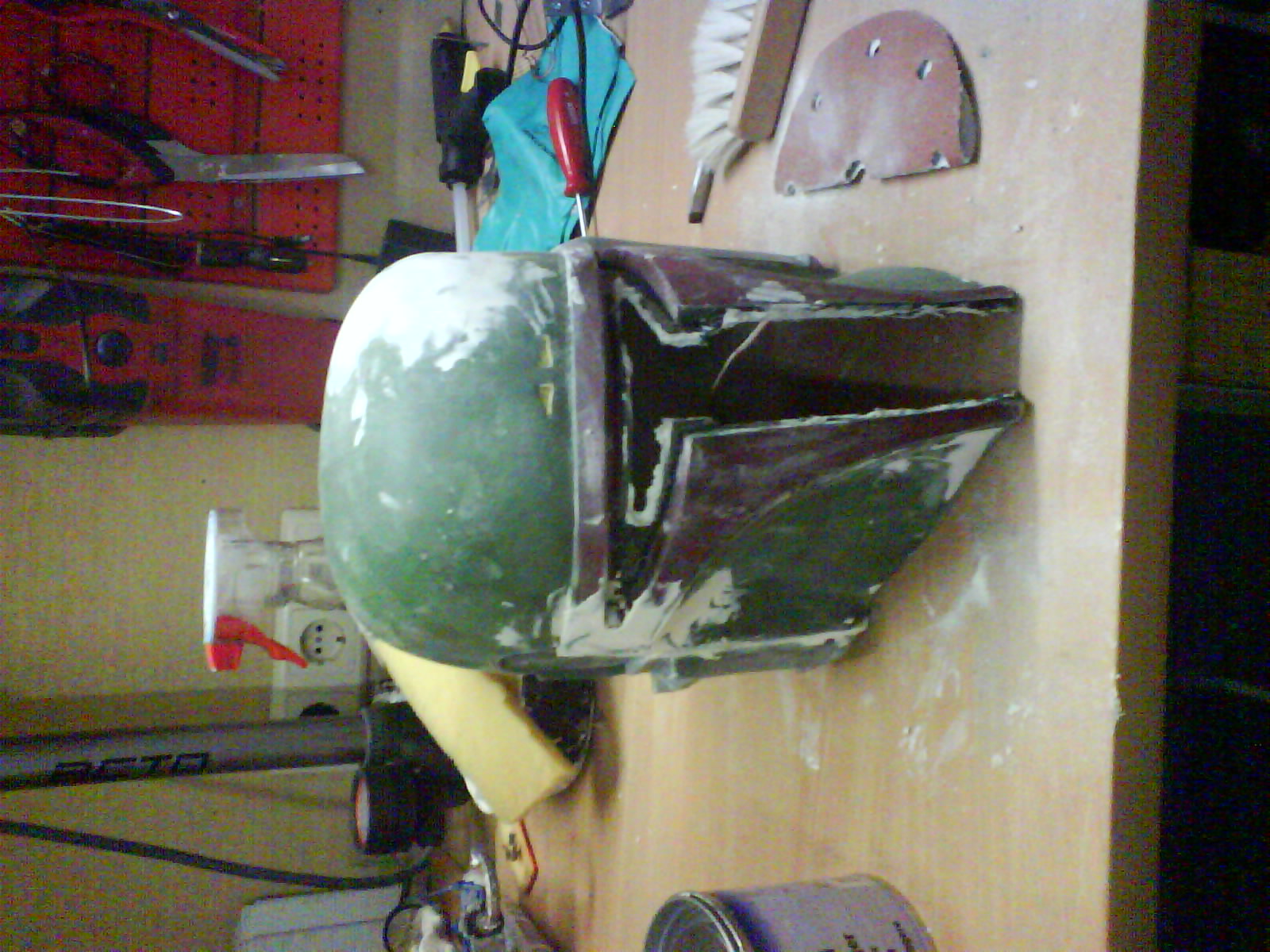

No i don´t want to apply for the Mandalorian Mercs (yet) ;) I know the Rubies helmet is kind of ******, but its all i got atm. Well, i fixed it with an specific type of silicon putty on the inside and bondo on the outside. The inside i strenghtend with plastic mesh which worked really good. I already sanded the outside and cut out the pvc plates (its the german equivalent for sintra)for my armor based on WOFs templates. Saturday i´m going to bend them in shape and prime all parts :D Thanks for the advice all of you!

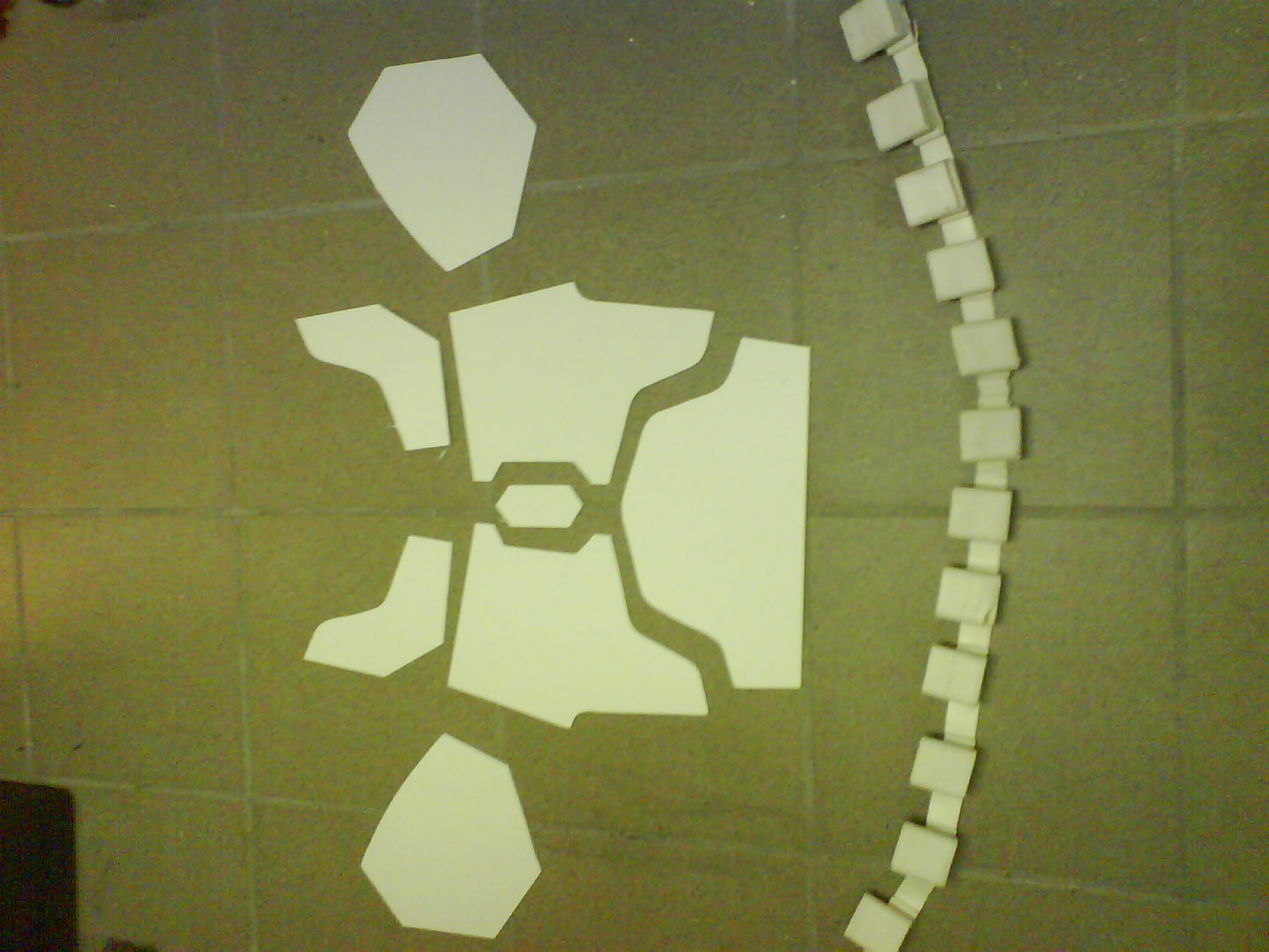

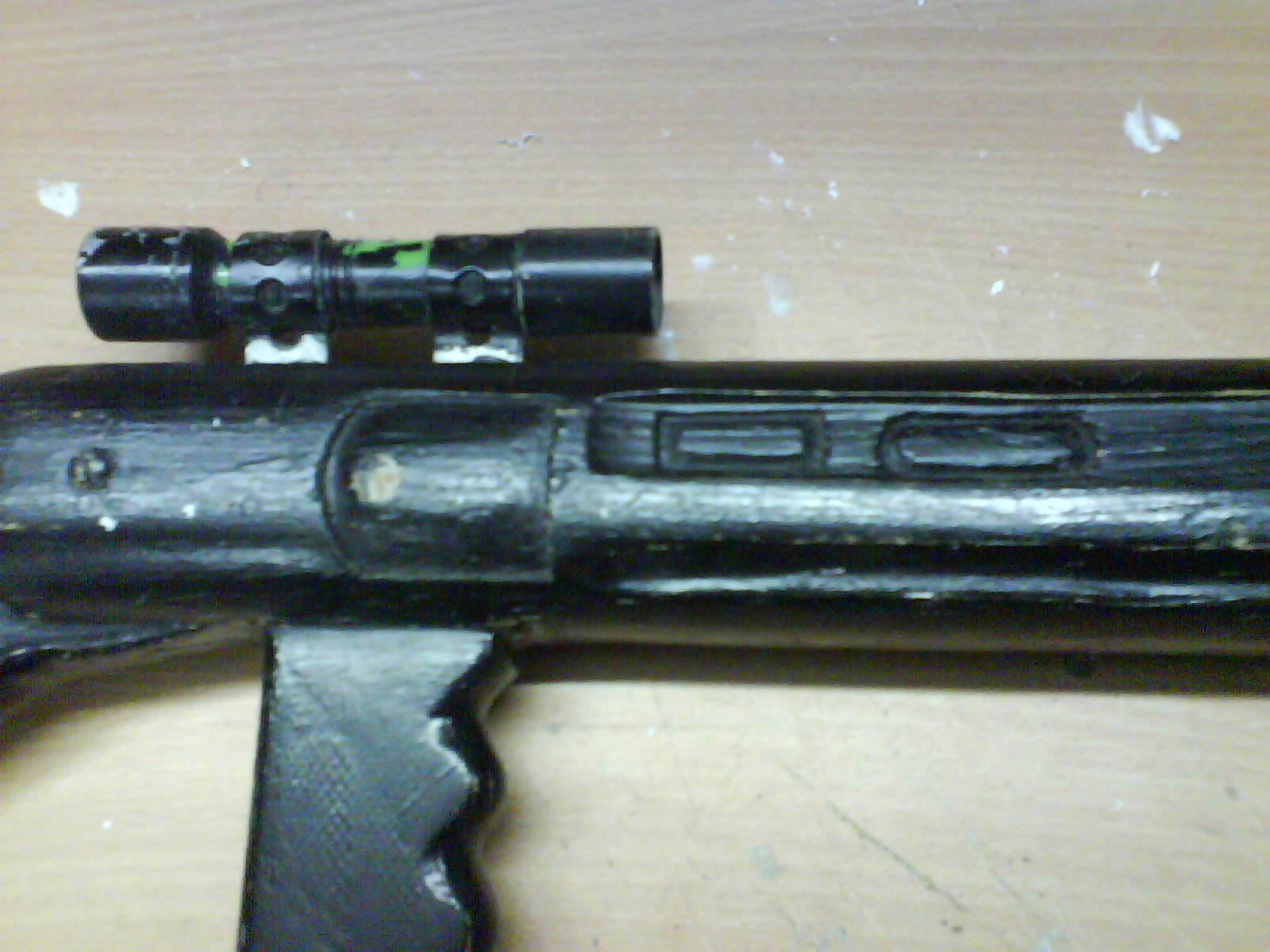

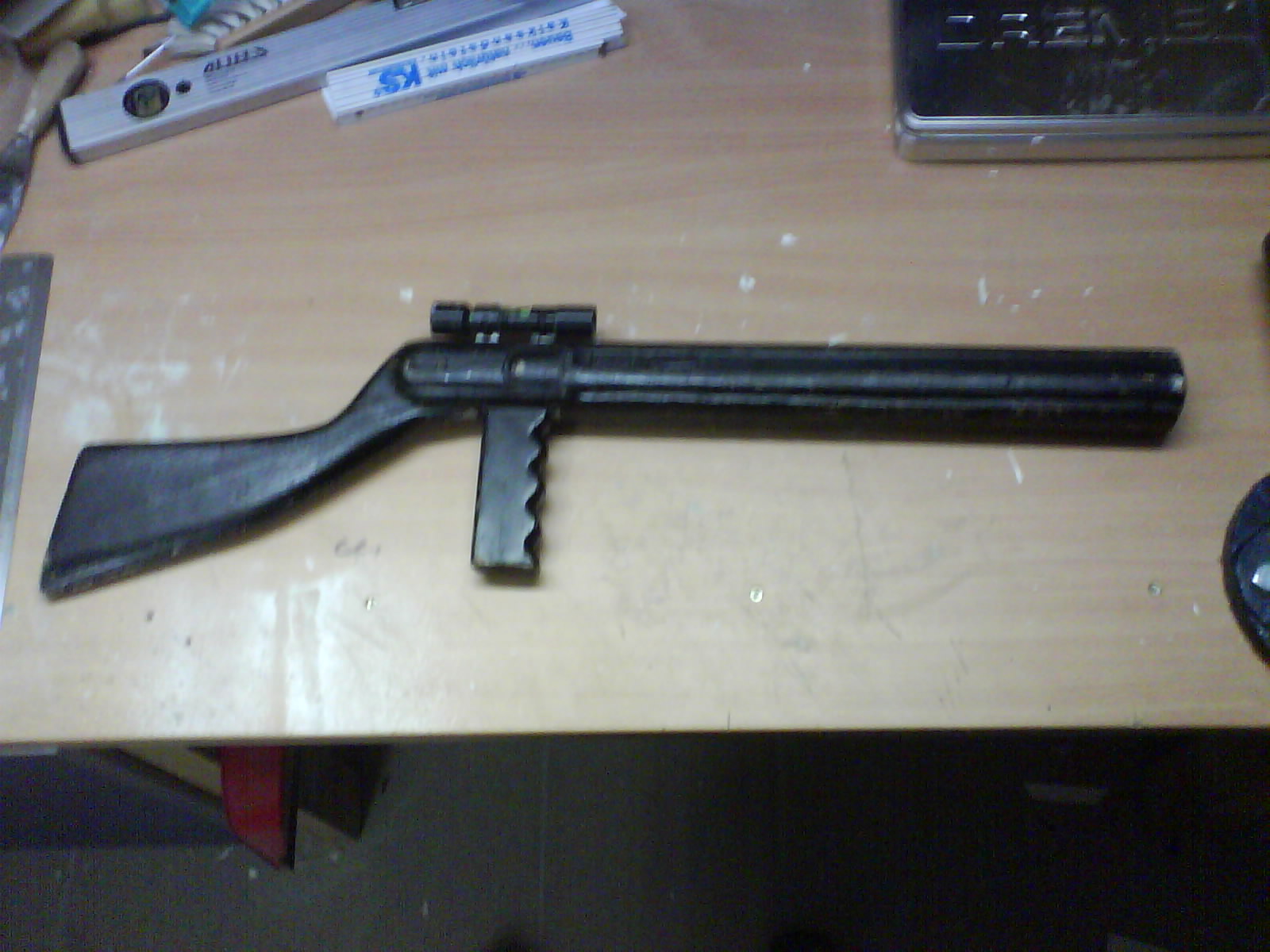

OK, the basic repair is done, so that in the next days i can sand and prime the bucket and cut out the visor the right way. Armor for the upper body is ready to get shaped. The armor is, like i said, based on WOFs templates, except for an custom designed 2-piece collar armor. Belt is ready to get primed. Do you think its too stormtrooper-ish? Maybe i´m going to modify it somehow, but i´m not sure which way (any suggestions?). Enclosed also some pics of my weapon, which has to be sanded again and repainted...

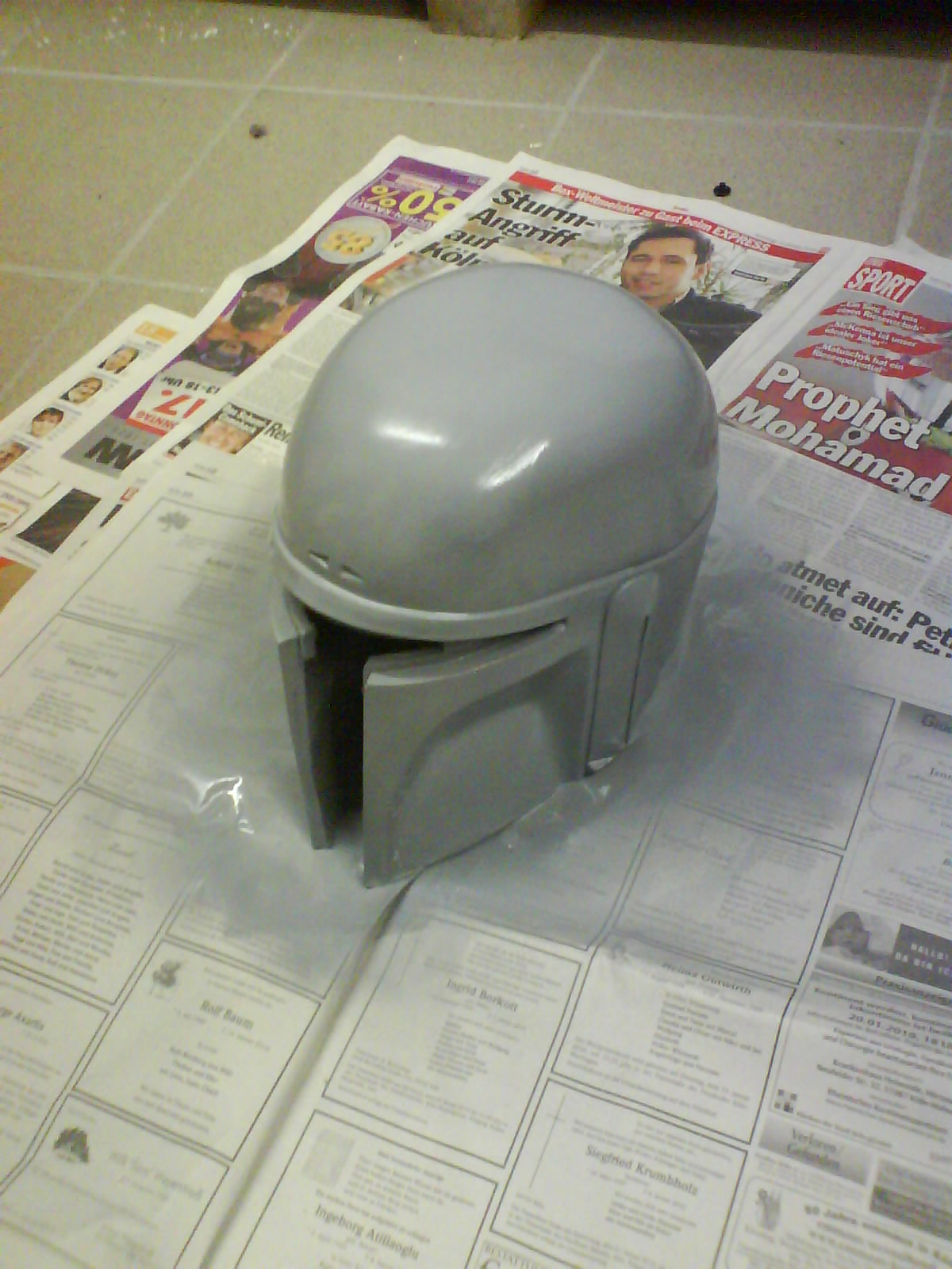

Here´s my bucket fresh after priming. Looks like brand new compared to what it looked like at first. Also bought an beige/olive flight suit of the german Bundeswehr.

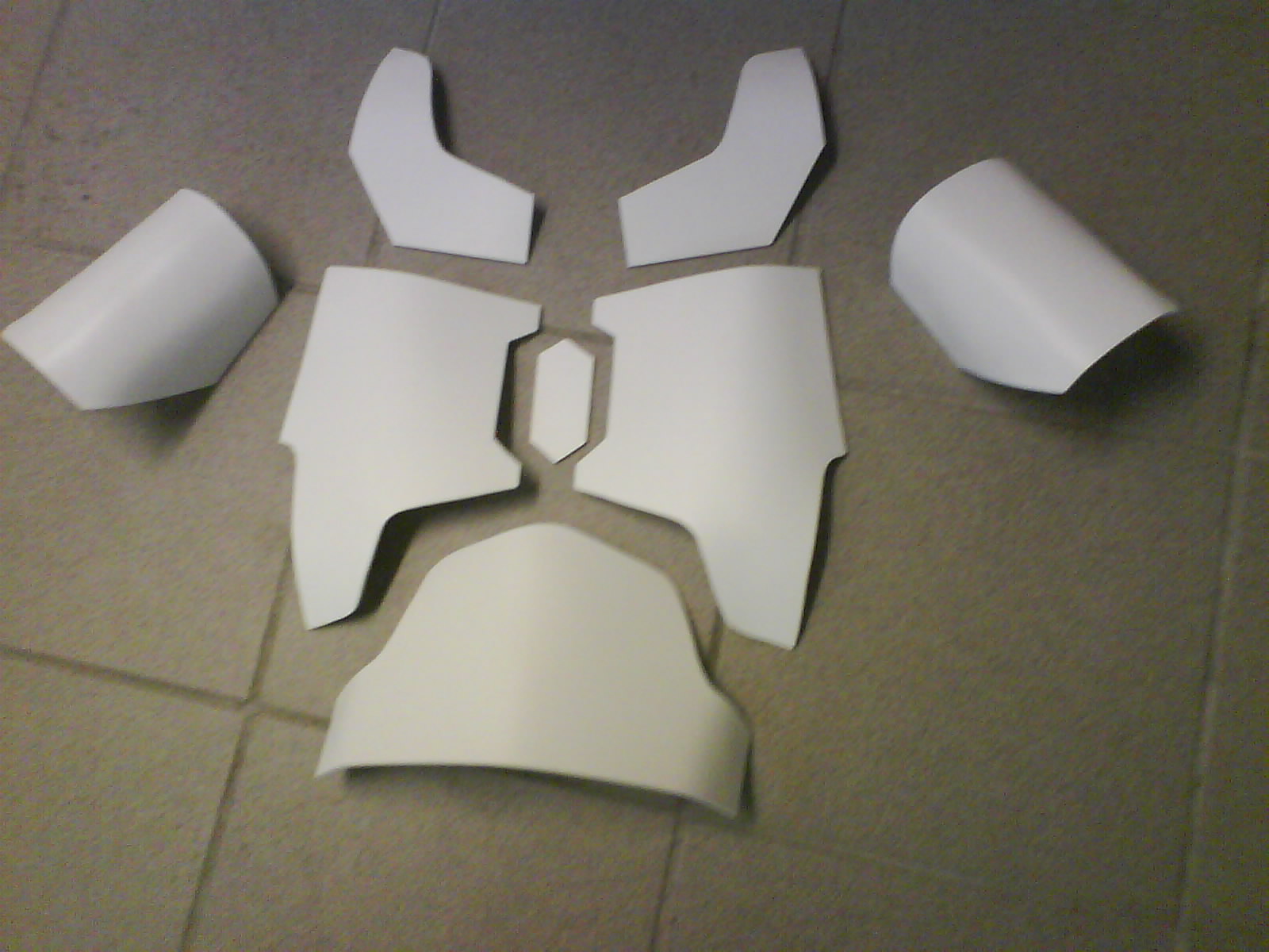

In the meantime i could finally shape my upper body armor (had to wait till i got a heatgun)...
Yeah i wanted to be one part to be a little bit different from the usual BF type armor. Now i´m considering to place something between the gap of the two collar armor parts, but i haven´t got a clue yet...
Maybe a strip between them so you still have mobility but not such a big gap? Something around an inch wide would look good.
