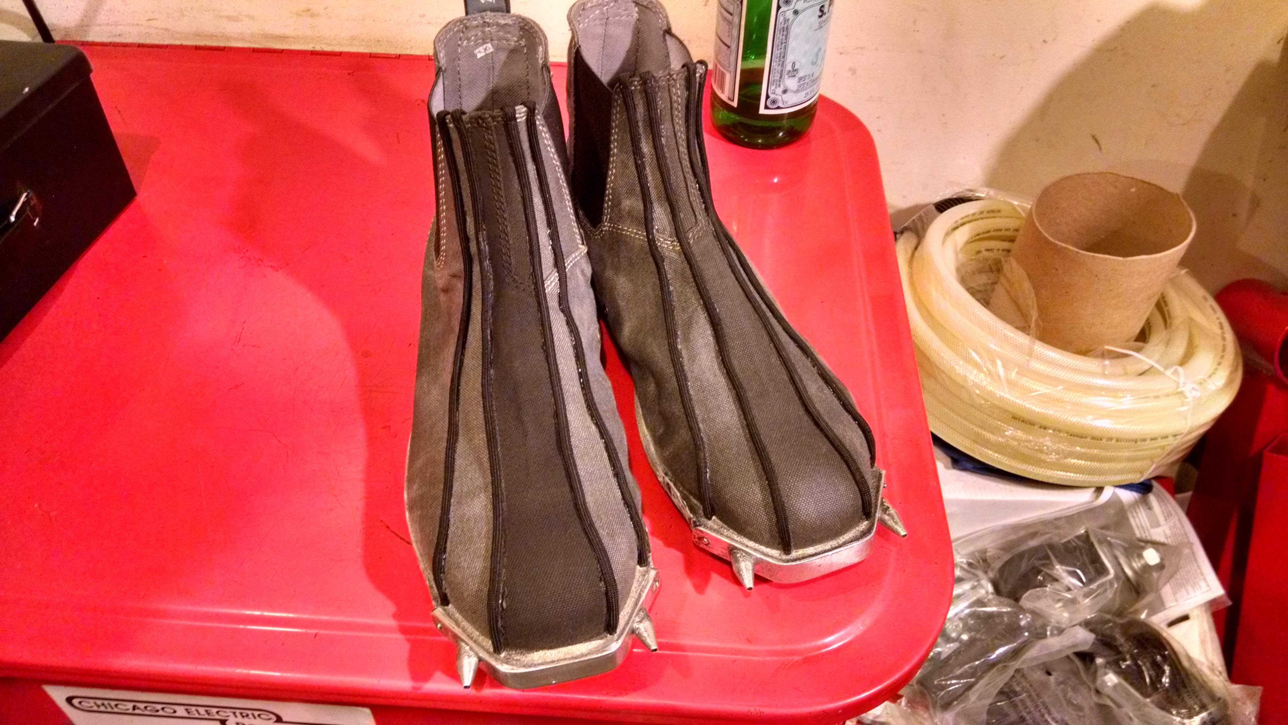

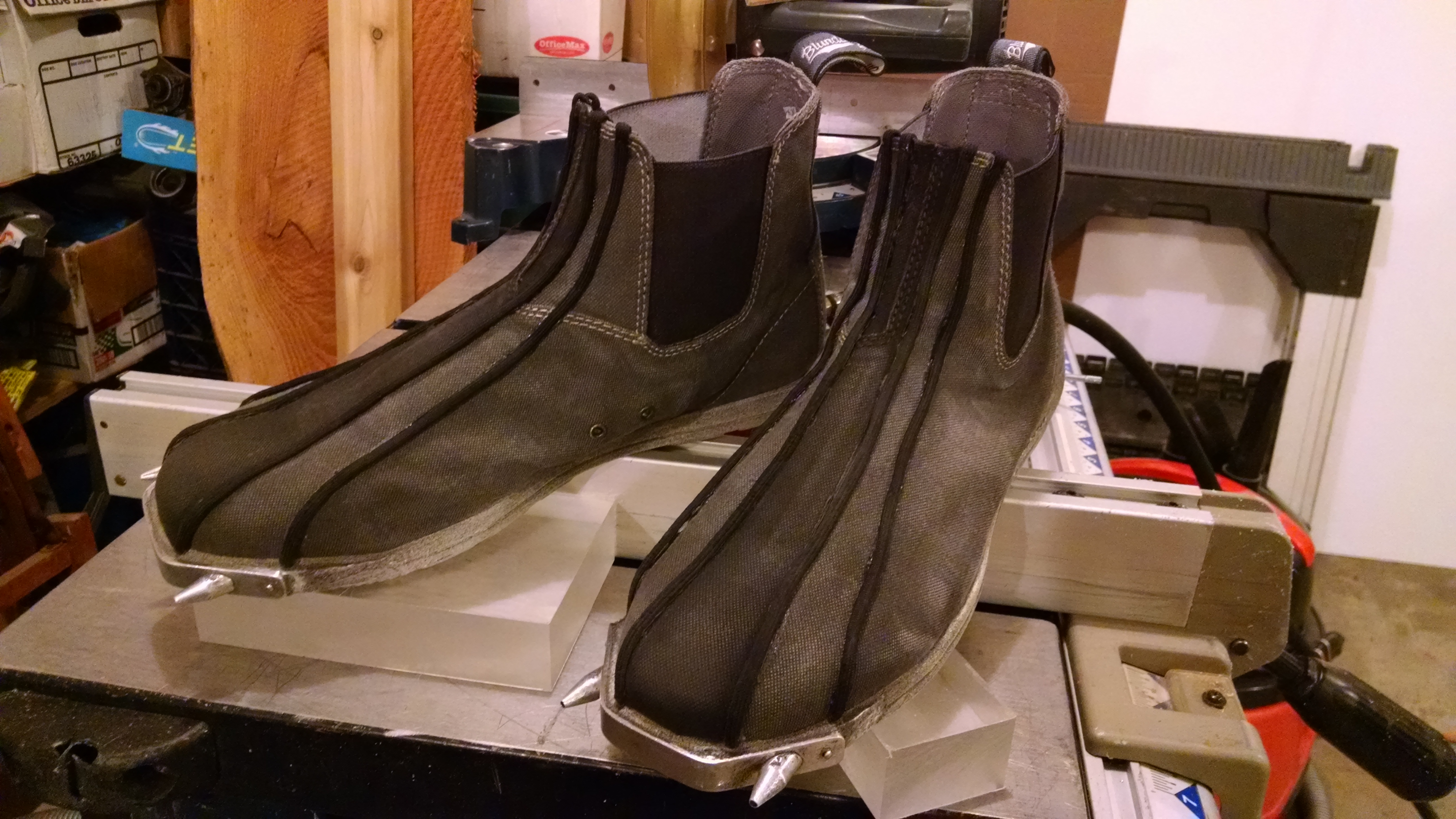

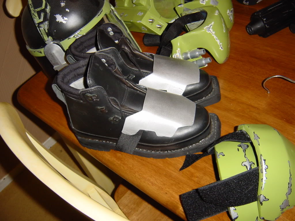

Here's my boots after darkening the center stripe:

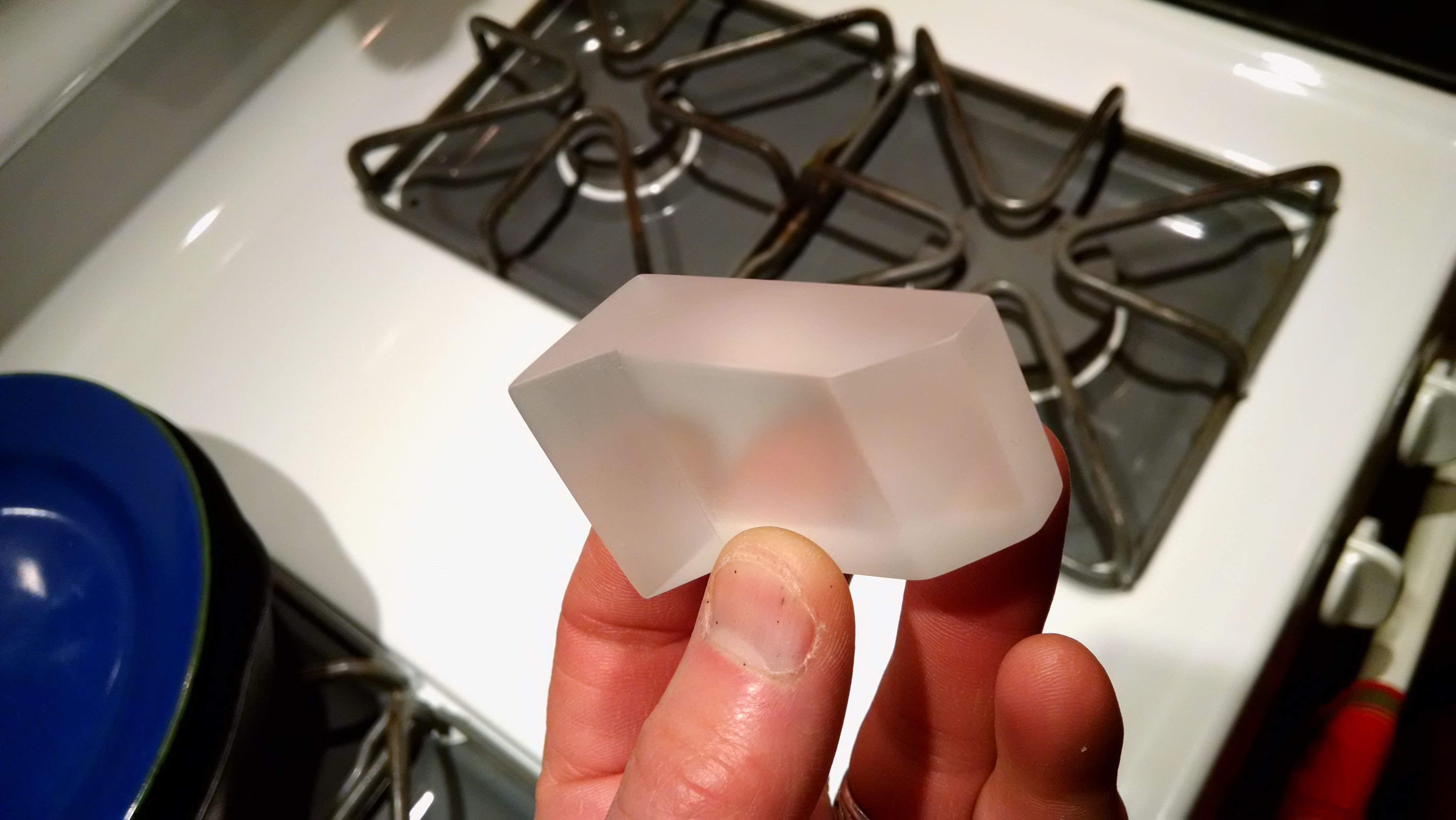

And my viewfinder prism after more sanding. Still not sure if it needs grooves in the back (top).

Last night I started the viewfinder prism. I bought a 6" x 6" slab of 1.25" thick clear acrylic from Tap Plastics in Seattle for $36 incl. shipping. On my table saw I cut it to size, and am sanding it using a sanding sponge to remove sawblade marks and to give it a uniform haze. Anyone know if it's supposed to have recessed lines on the top (hidden) side? Looks that way from Alan Sinclair's helpful templates which I'm using. There are green lines that suggest that in the PDF illustrations.
Acrylic block:
Cut to rough size:
After some sanding (but not done):

Sadly it would cost too much, you could get one cheaper elsewhere. It takes a long time to sand all the saw marks away. You can get one from toolguy301 for less than $20. https://www.shapeways.com/shops/csbprops?section=Rangefinder&s=0

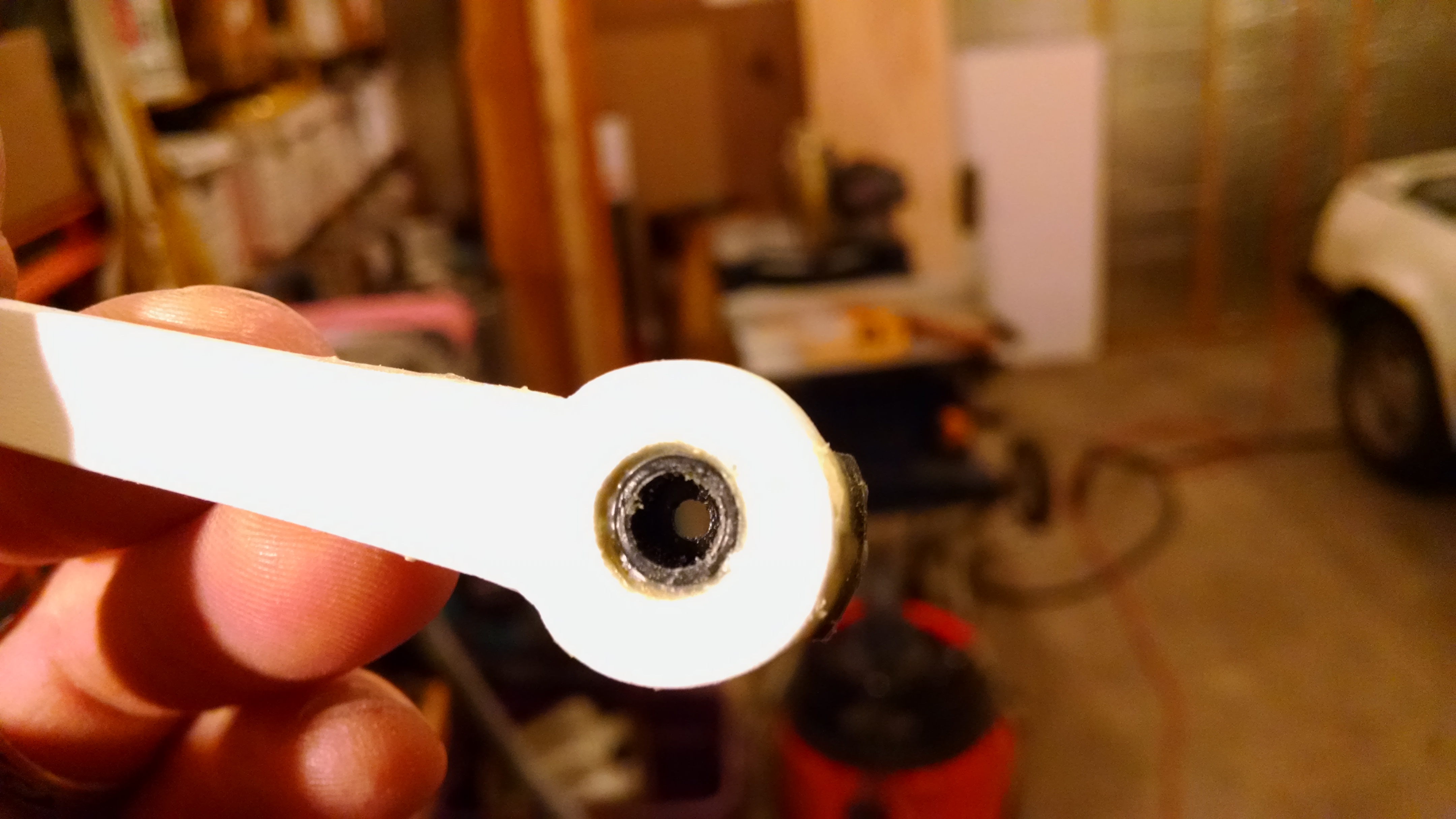

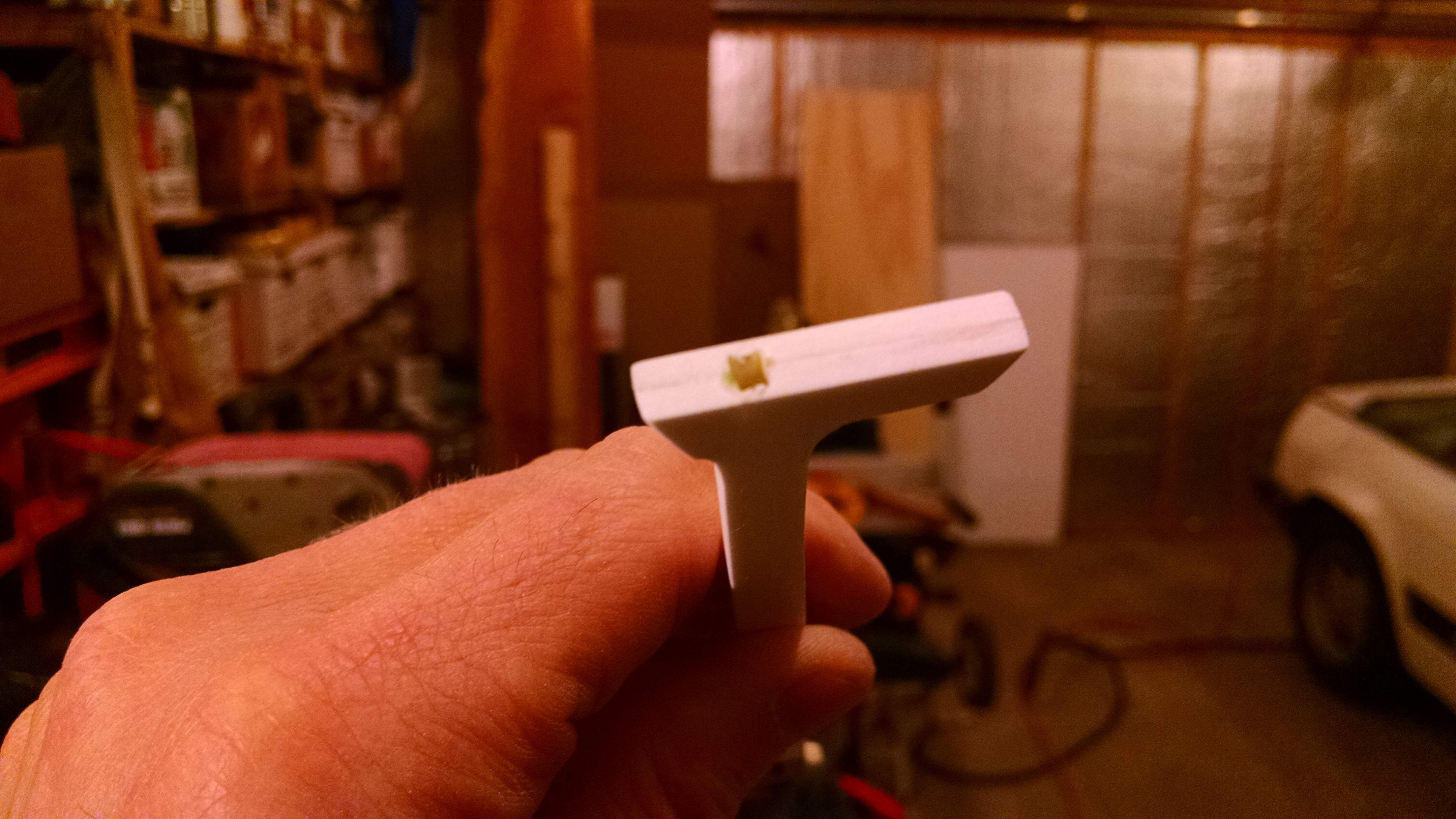

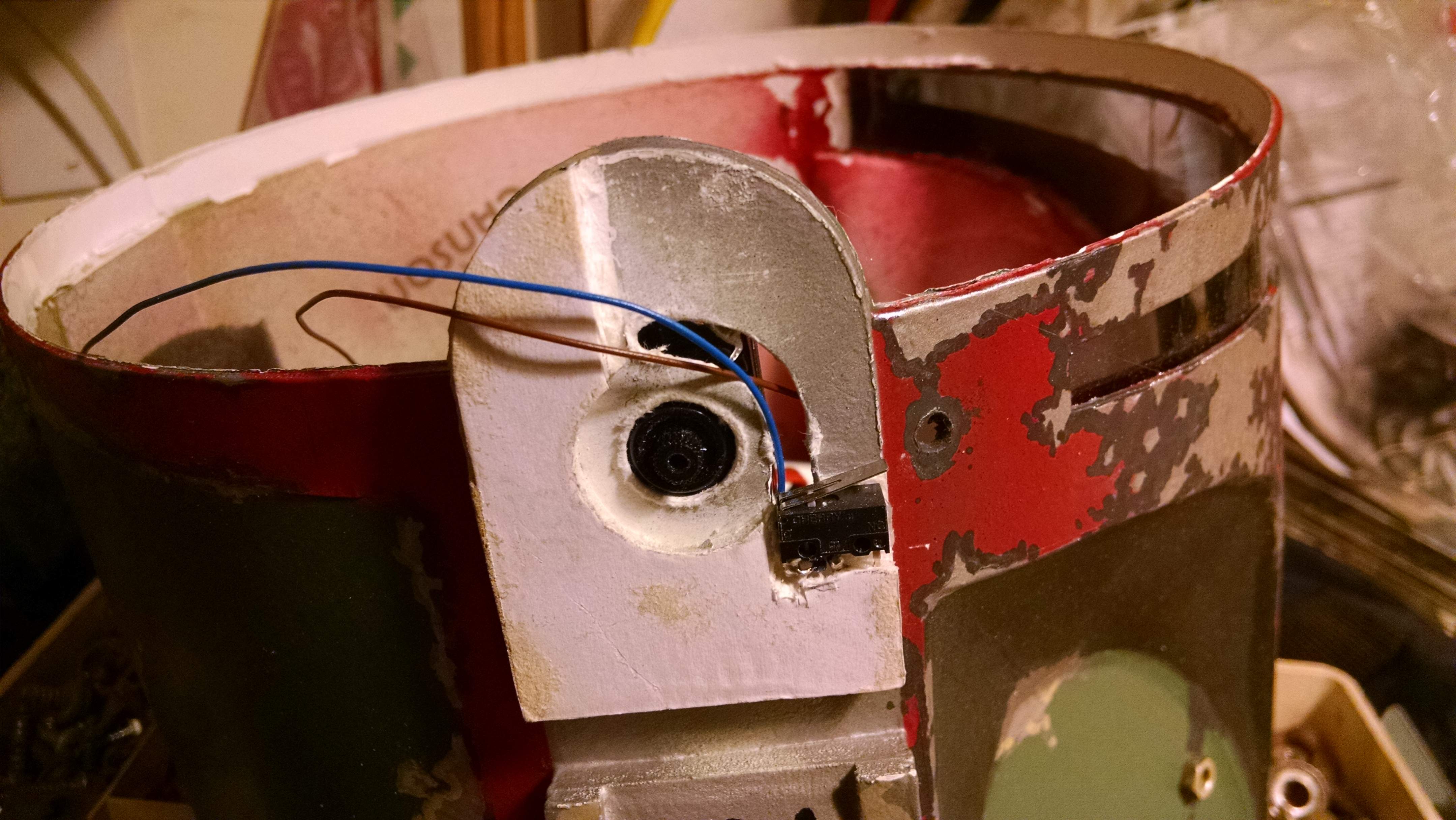

Started fitting my salamanderking rangefinder LED's and servo. Ended up breaking my existing plywood rangefinder stalk, so I made a new one from two layers of 3mm sintra. This allowed me to locate the servo armature on the outside, and therefore the servo similarly further outside on the helmet end. I rough-cut my stalk shapes and ran them through a table saw to create the grooves that when mated, made a channel for wires. I shaped the stalk on my belt sander after gluing the halves together. The glue I'm using is multi-purpose plumber's cement that works on PVC and ABS.

Got my salamander king rangefinder up and running, exciting to see it work. I made the rangefinder housing from 3mm sintra as well, and my prism fit well. Finding room for the electronics is a challenge, I wonder if my helmet is smaller than it should be.
http://vid58.photobucket.com/albums...a Fett/VID_20160308_211633110_zpstzm2eo2u.mp4
I have some details to work out, including maybe needing to get a rigid/metal rangefinder stalk (my sintra one has a lot of flex which creates some bounce in the servo action) and/or making a lighter rangefinder lens prism. The prism I made from acrylic is pretty heavy, which also contributes to the bounce I'm worried about.

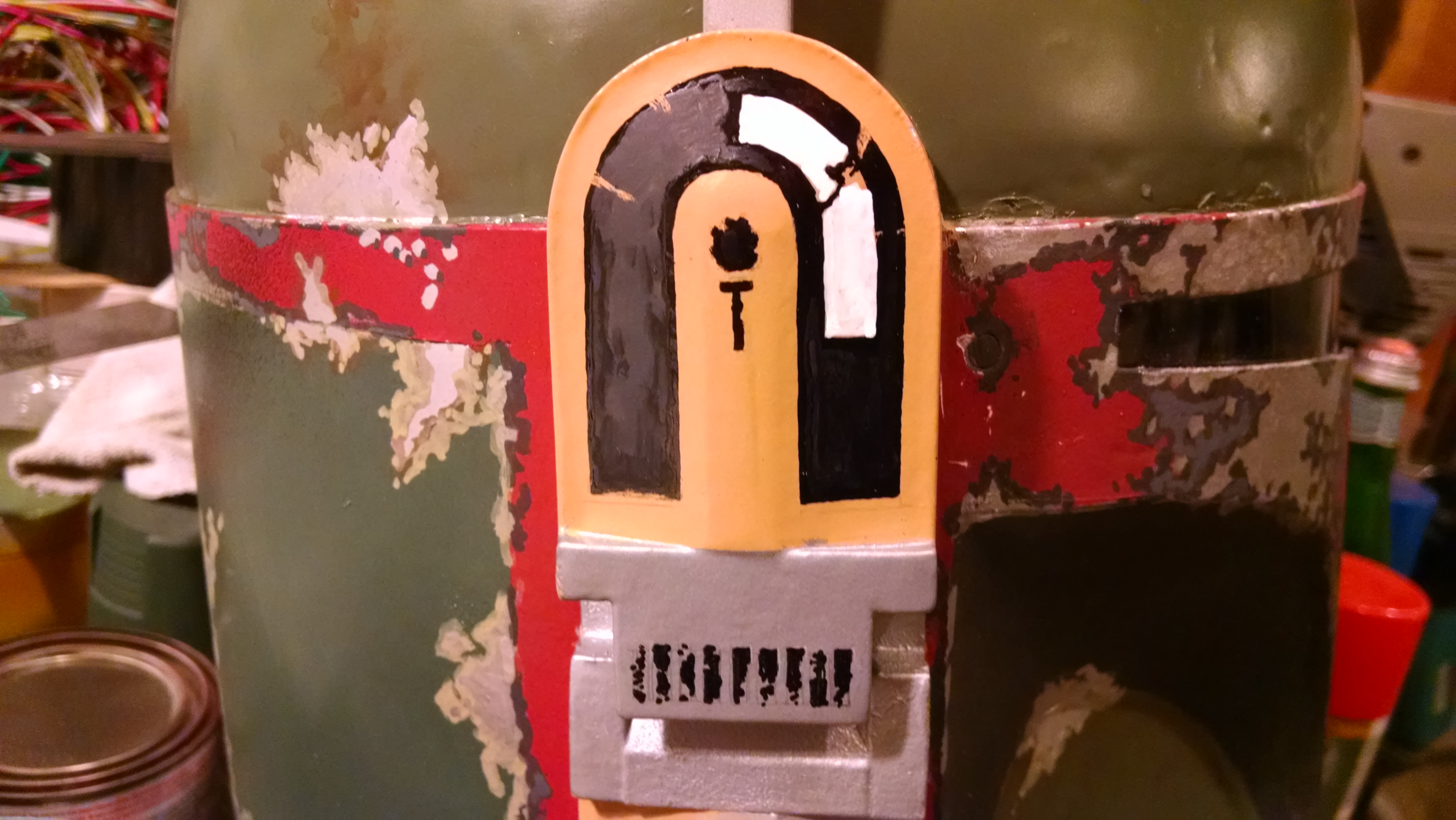

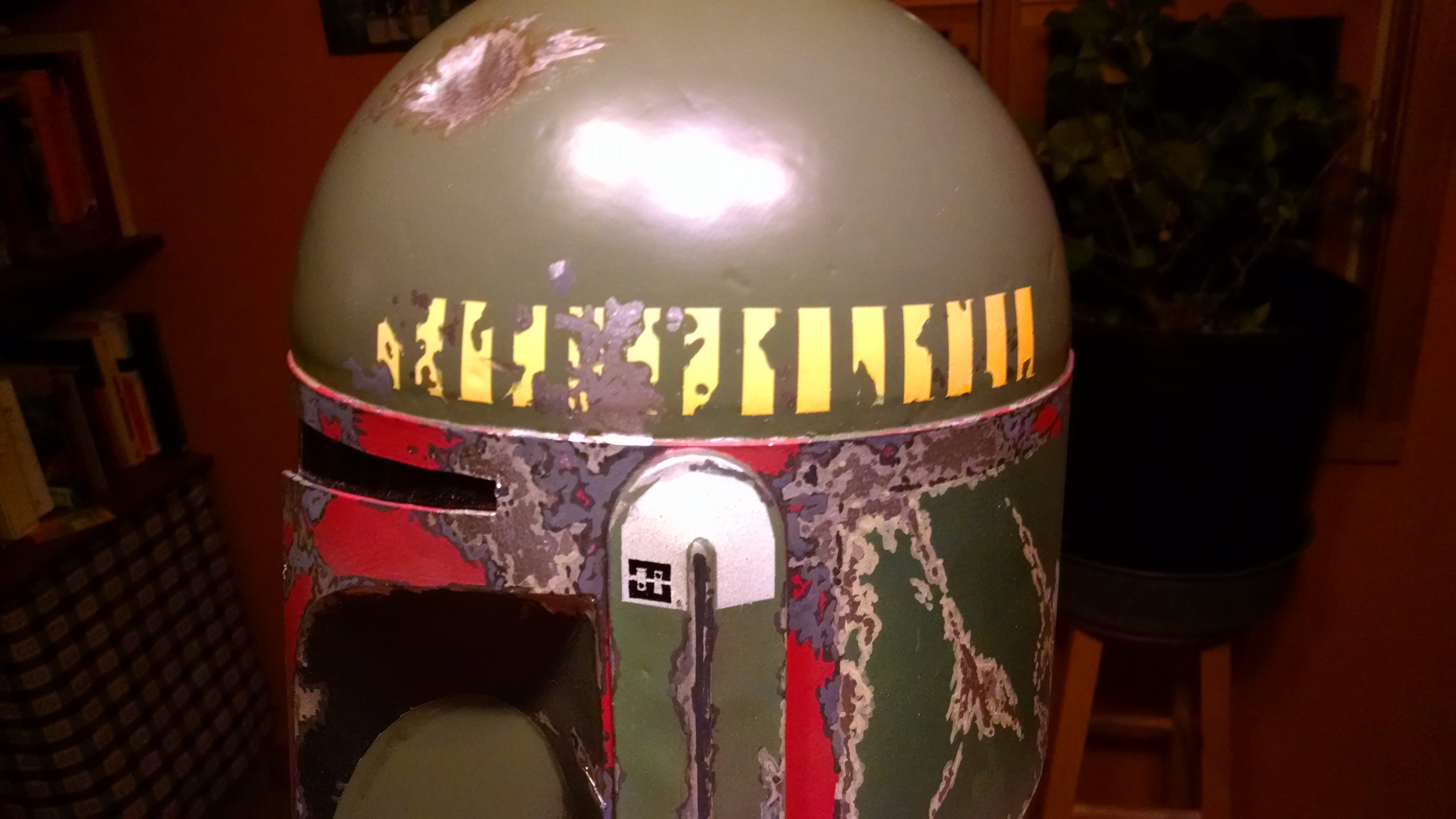

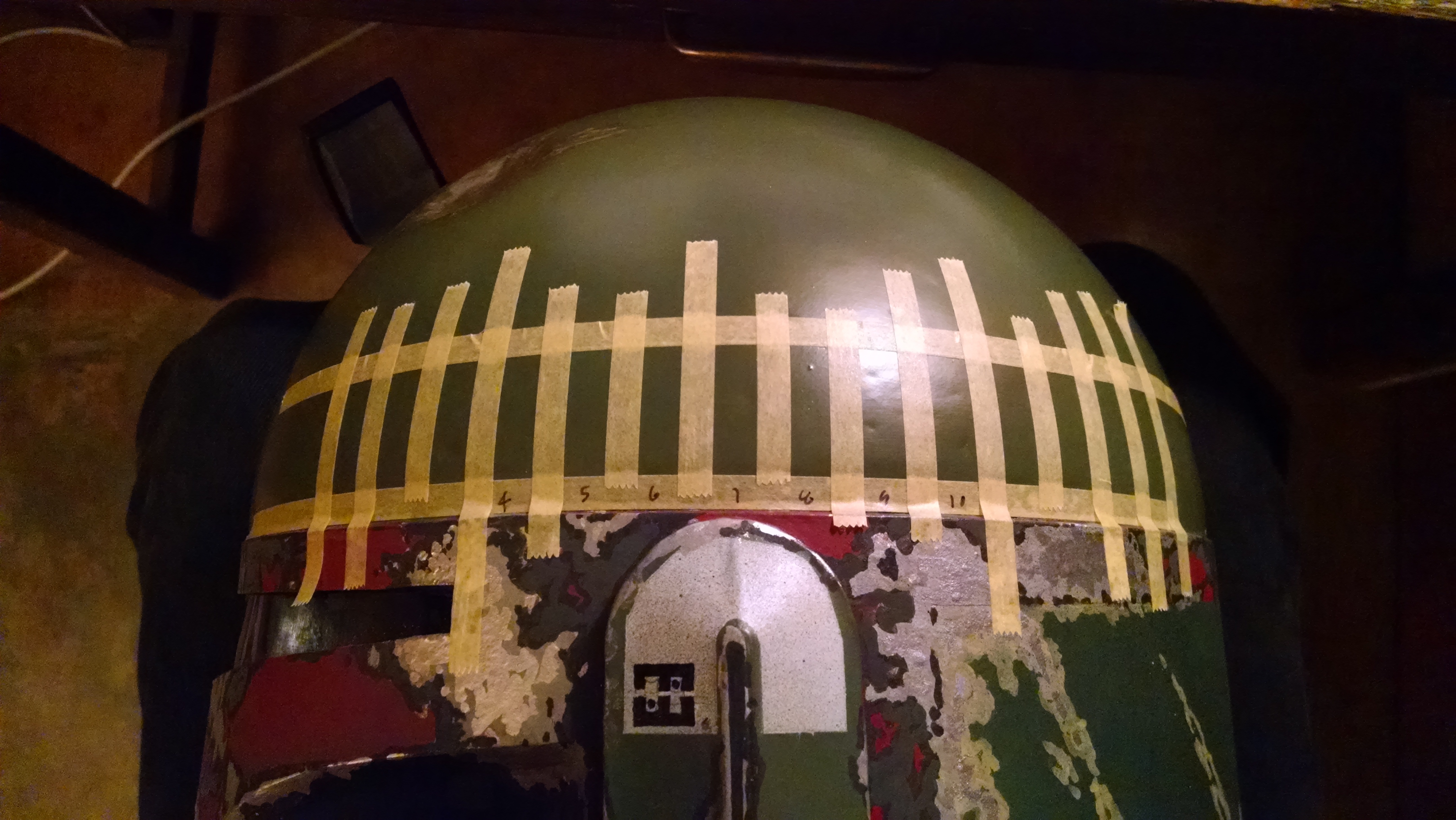

Reassembled my dome to my helmet. I took it off to reshape it and get rid of the pointy-ness it had. Also multiple coats of sanding primer to smooth it out. Then repainted a more olive color, along with other parts that needed the lighter color.

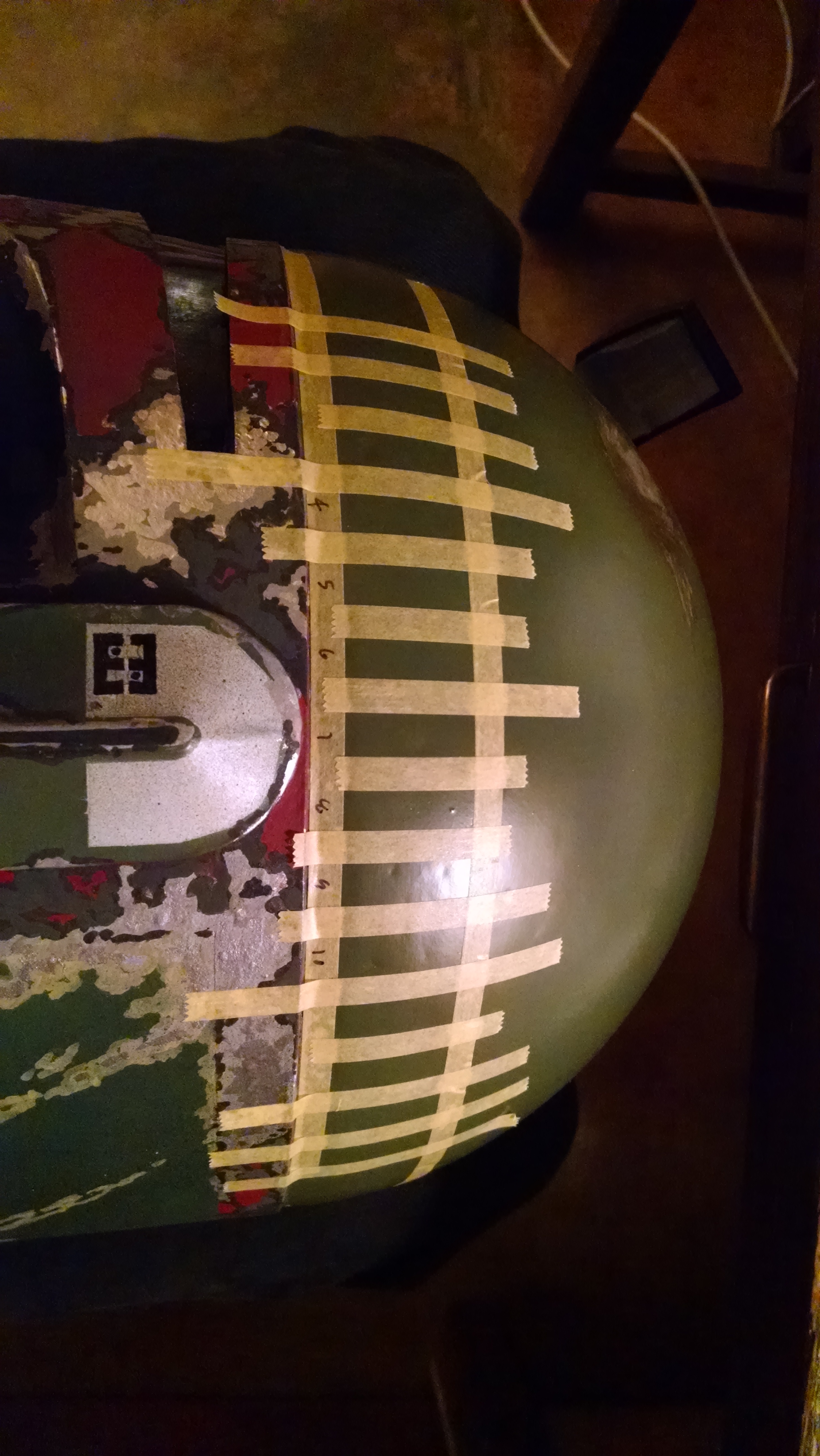

Finally got to detailing the ears and other parts with paint pens. Did my first try at liquid masking, when I repainted my kill stripes. I forgot to buy some liquid masking at the hobby store so made a mixture of spackle paste and water. Worked great. Needs weathering and more damage, but I'm getting there.

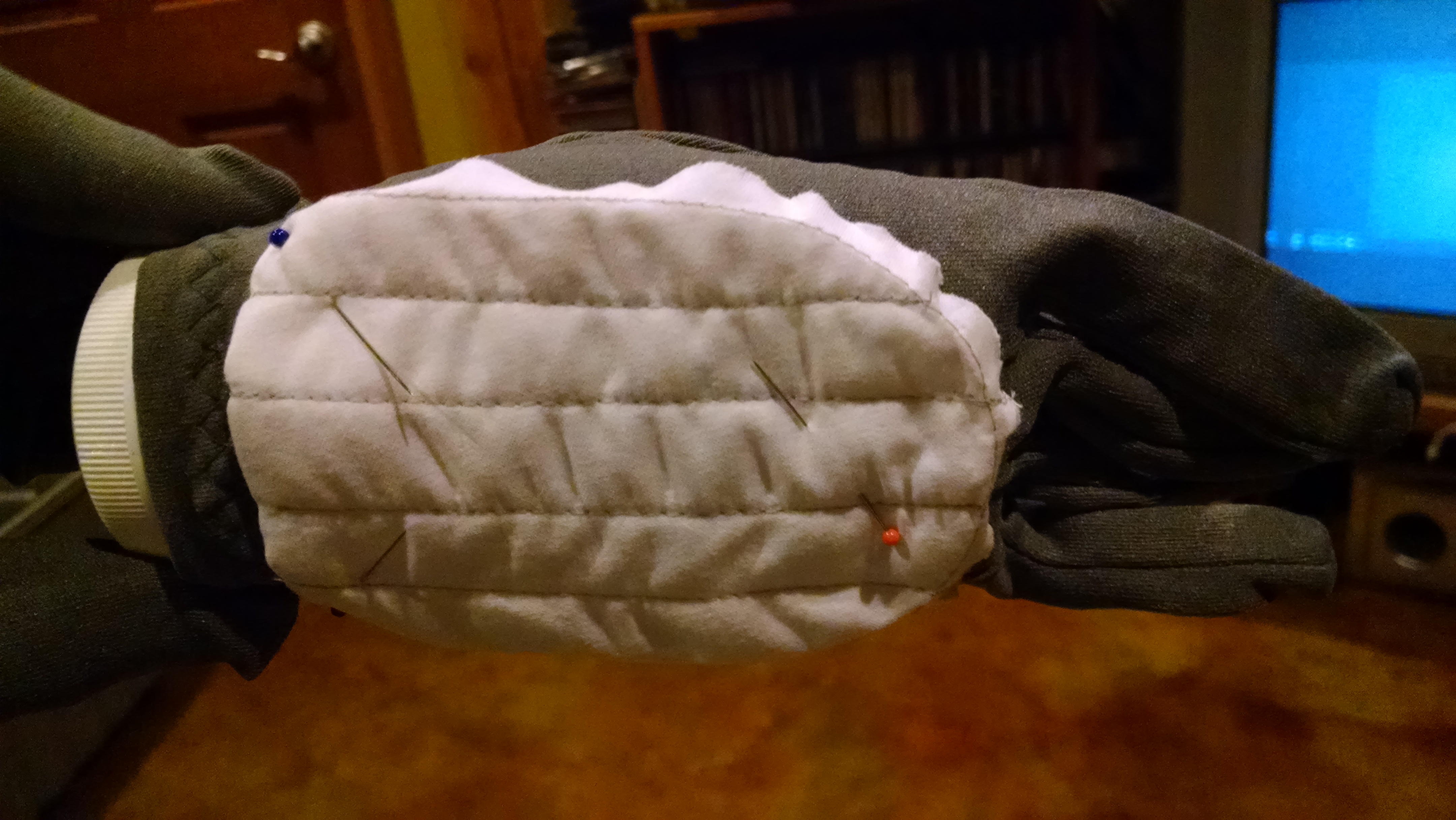

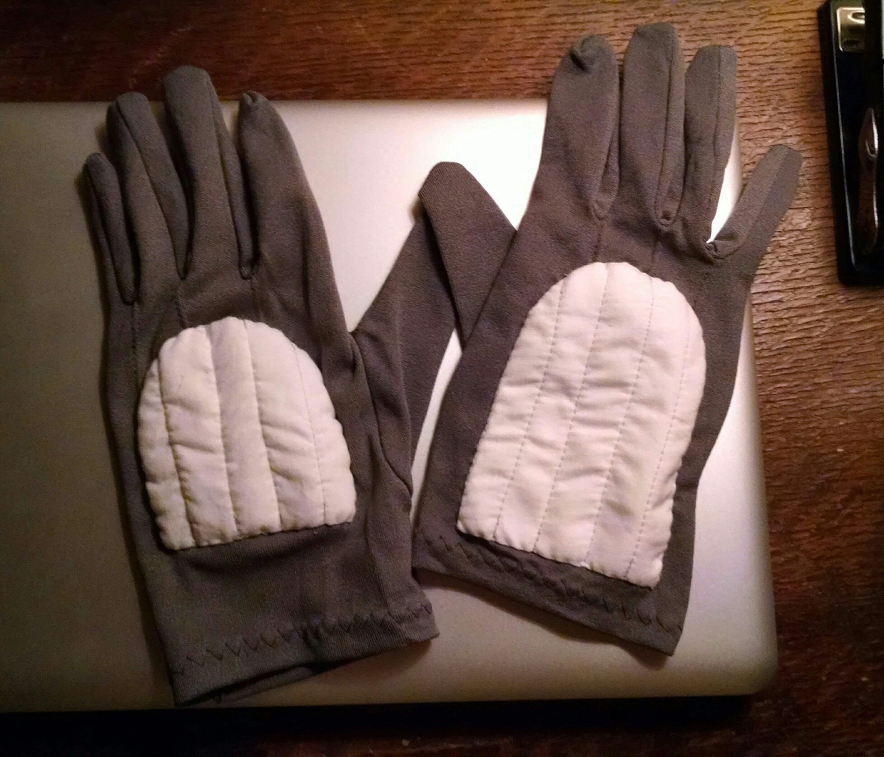

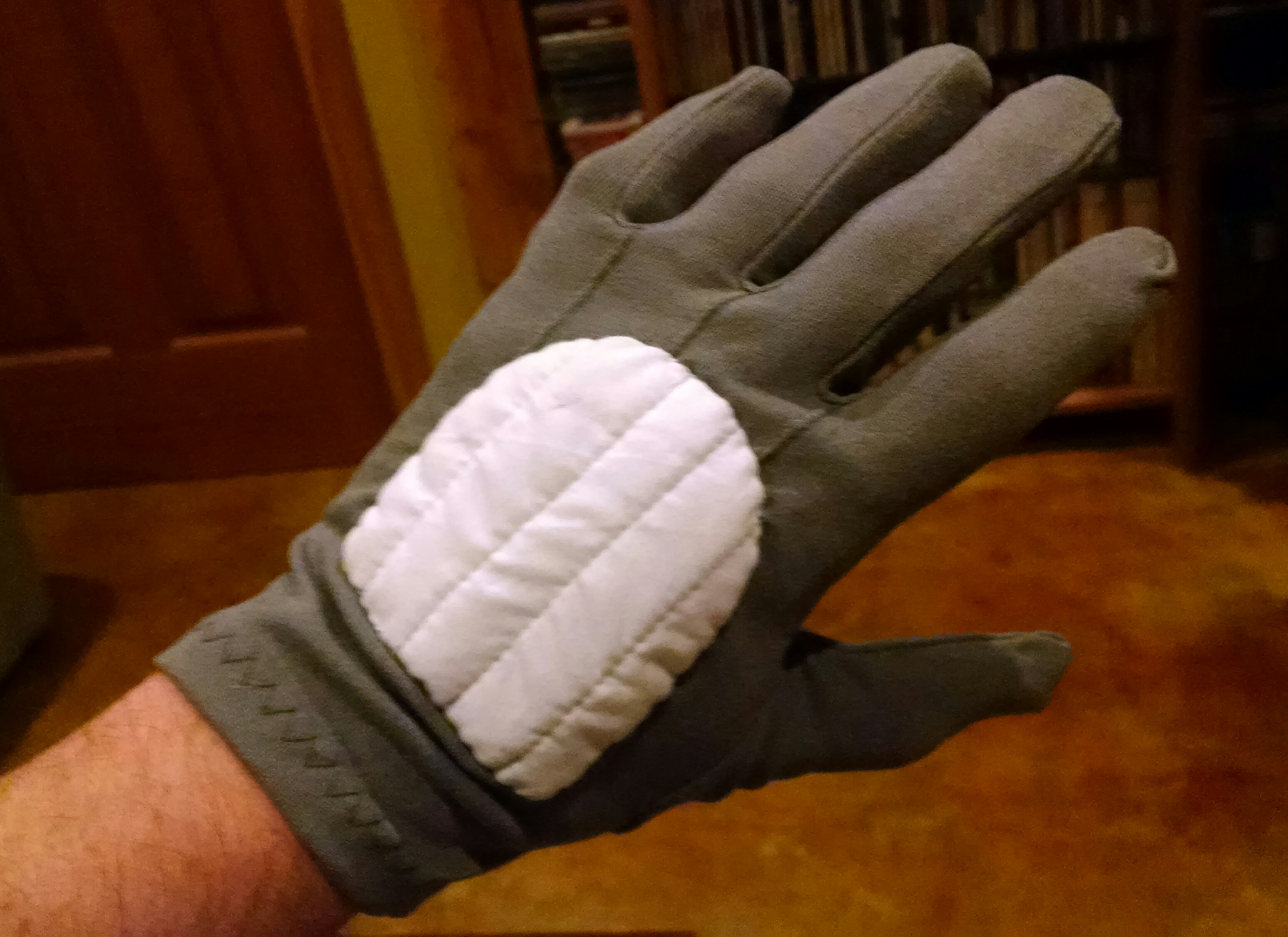

Started on my gloves last night, made a little progress tonight. I made the quilted patches on my sewing machine and am hand-stitching them on. I'm beginning to think buying them is a better idea. But, I also like being able to say I made them. Gloves are from Gloves-Online, Inc, 2 pairs for $13 shipped, the mold is a honey jar. Still need to do the fingers.

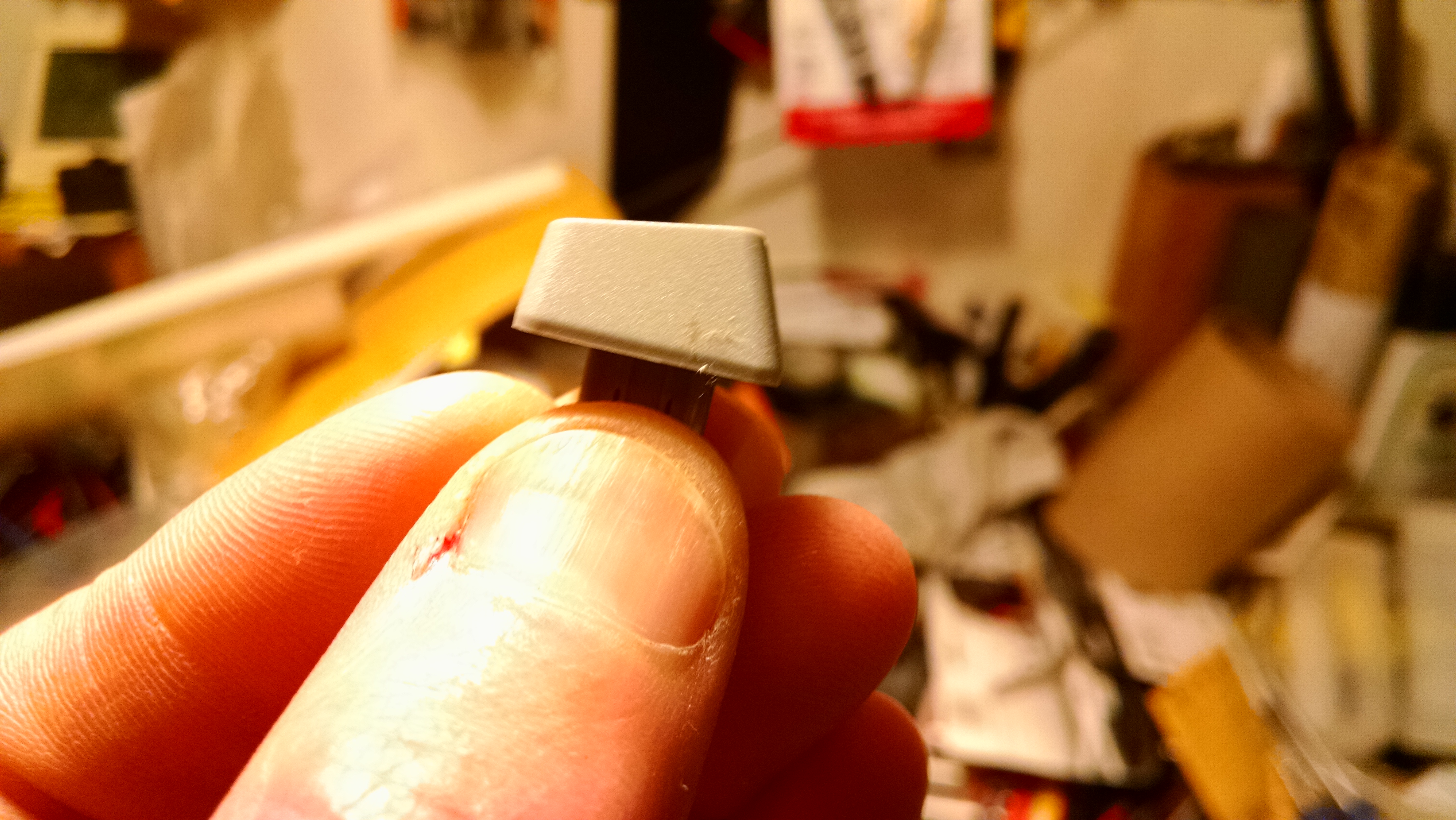

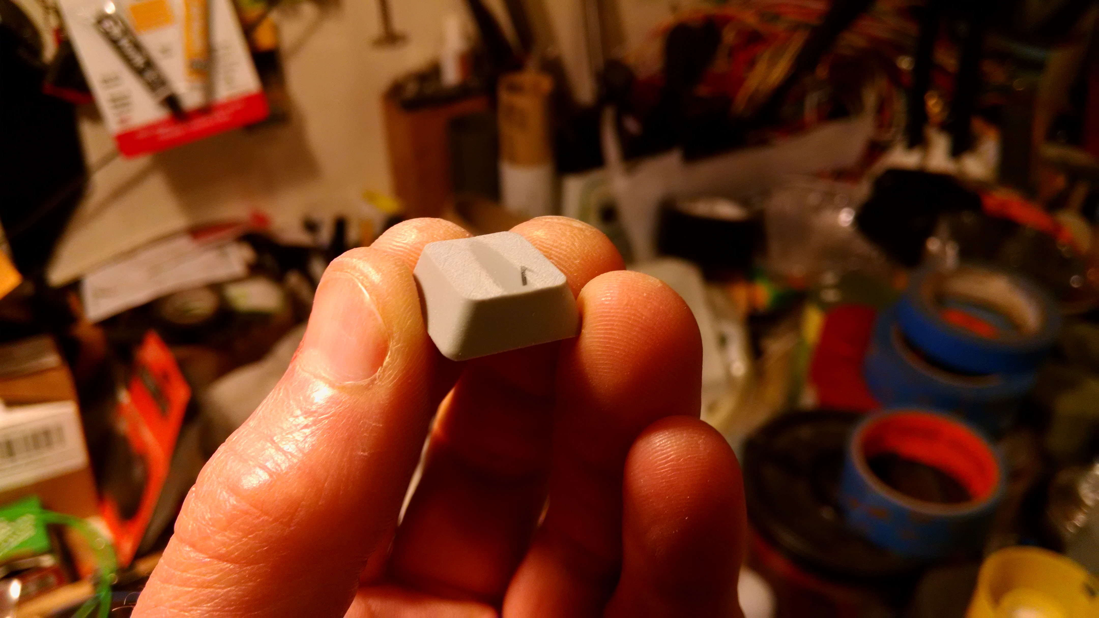

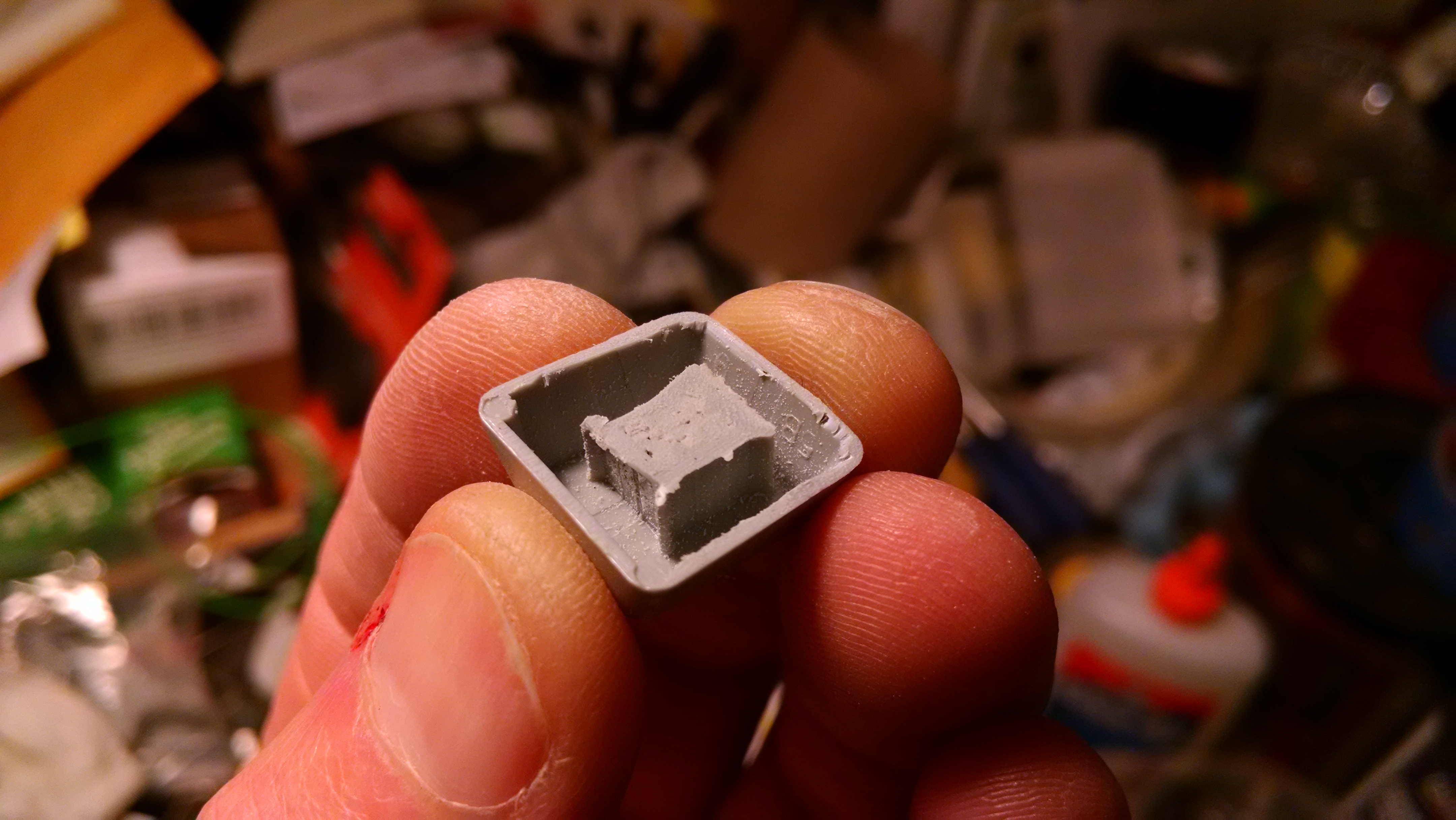

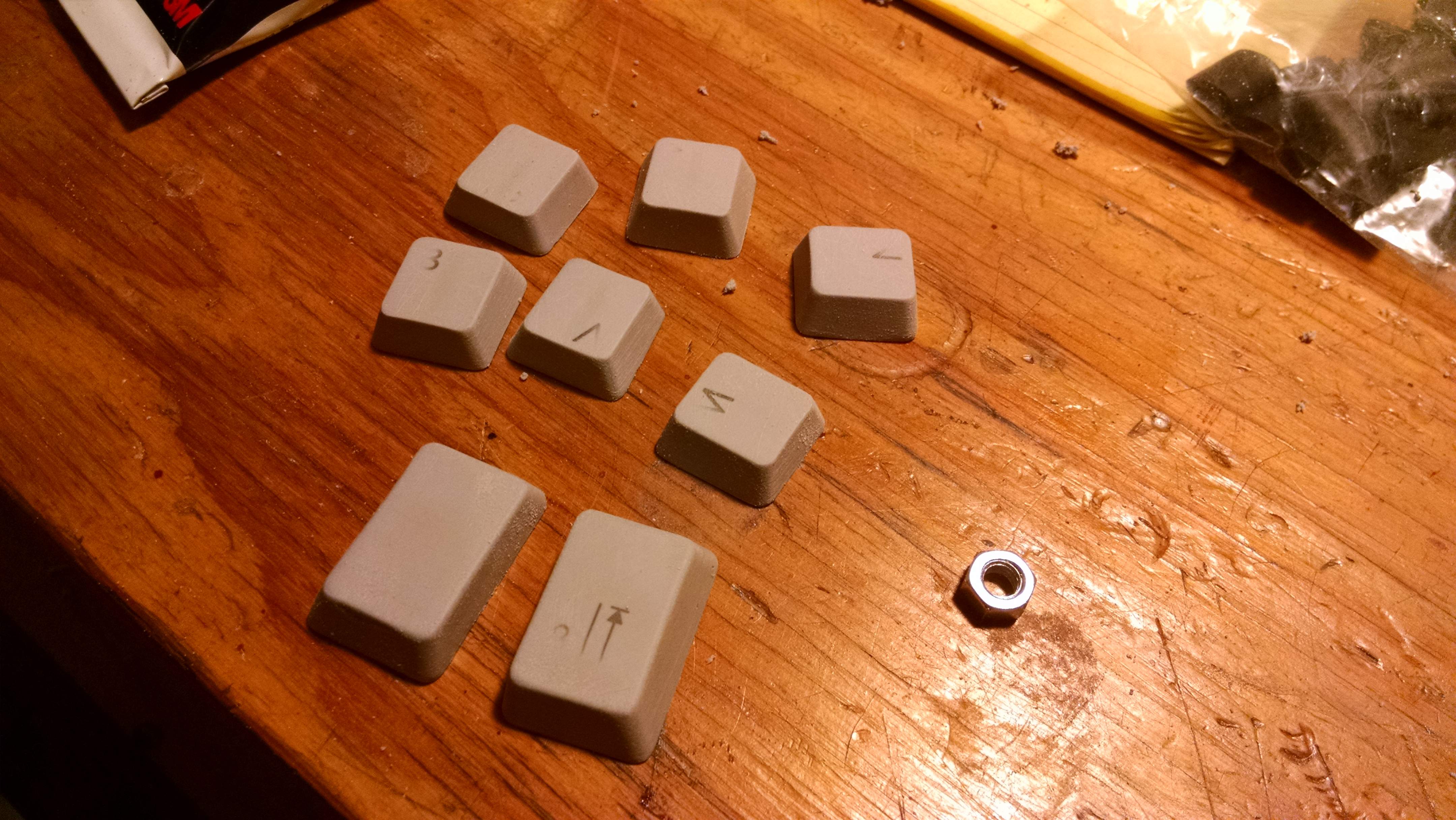

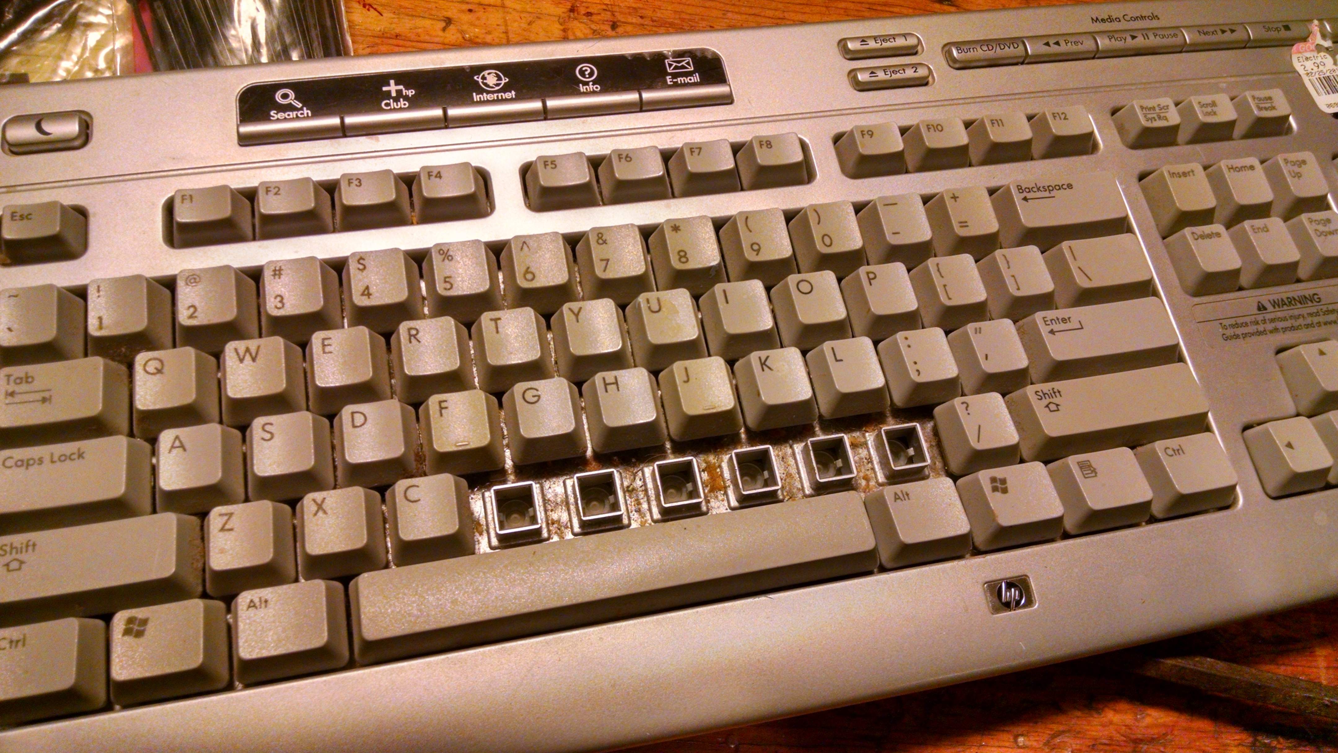

Started my armor key connectors today. Bought a $2 keyboard at Goodwill and popped 8 keys off. Ground them square at the bottom (they are tapered), and sanded the tops flat. Glad to find the inside was flat where the outside was curved, so I didn't sand through. Then I carved out the key's attachment structure. After sanding, I brought them indoors and fitted M5x1.0 nuts/bolts and embedded the nuts into the keys using JB weld. When they've set up and dried, I'll remove the bolts, sand them flush and add a nylon washer to prevent future armor scratching. Additional longer keys are for the codpiece, I'll mount them and do a little filling around them.
Donor keyboard:
typical donor key before sanding:
After sanding on my belt sander to square it up and flatten the top:
After sculpting out the backside (bottom of back recess is flat!):
Here's the attachment that needs to be removed from the backside:
Keys after all machining; 6 for collar, cod joints and 2 for cod right front side.
After JB Weld and nut embedment. After curing overnight, I'll unscrew the bolts and sand flush.

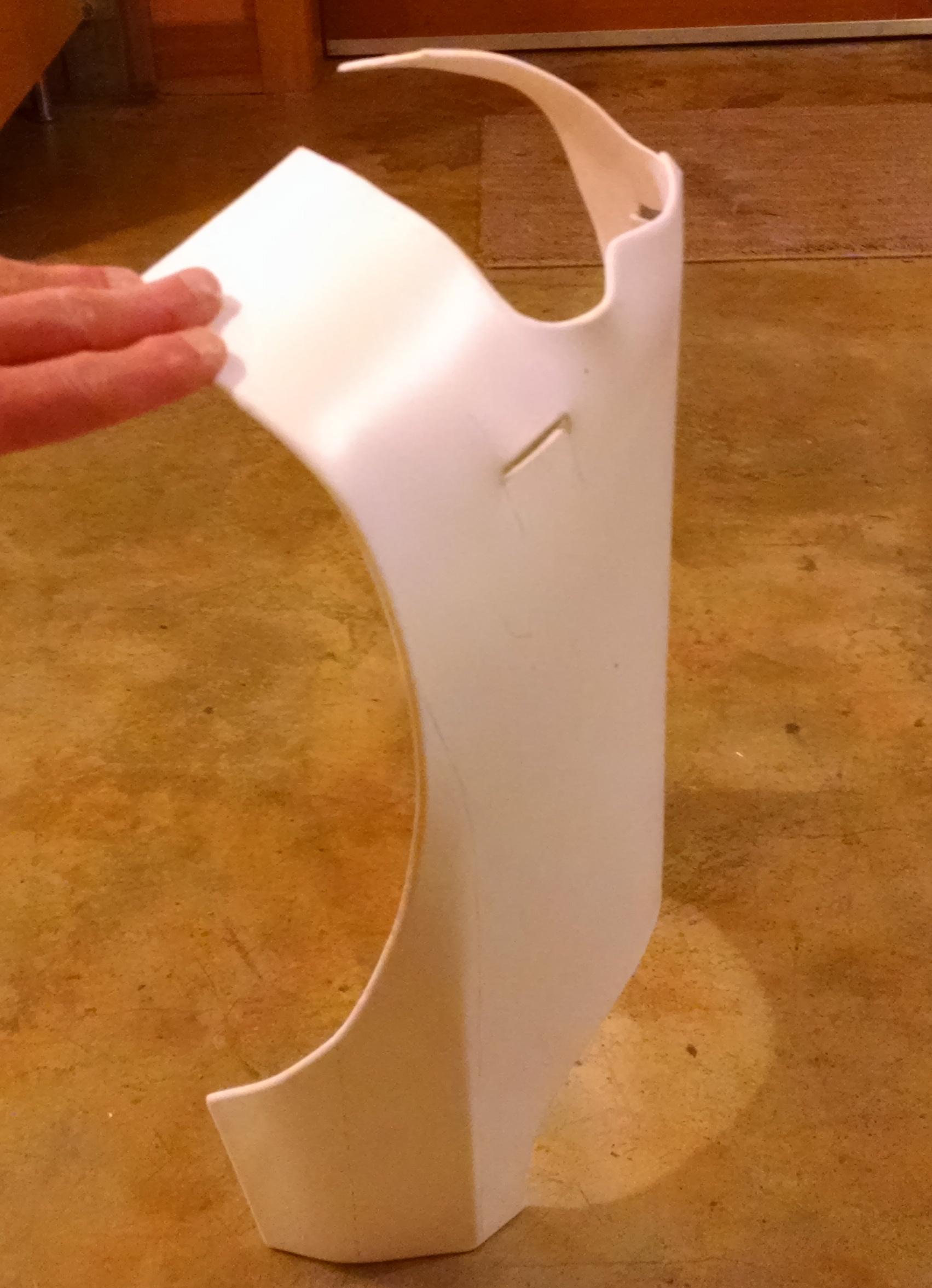

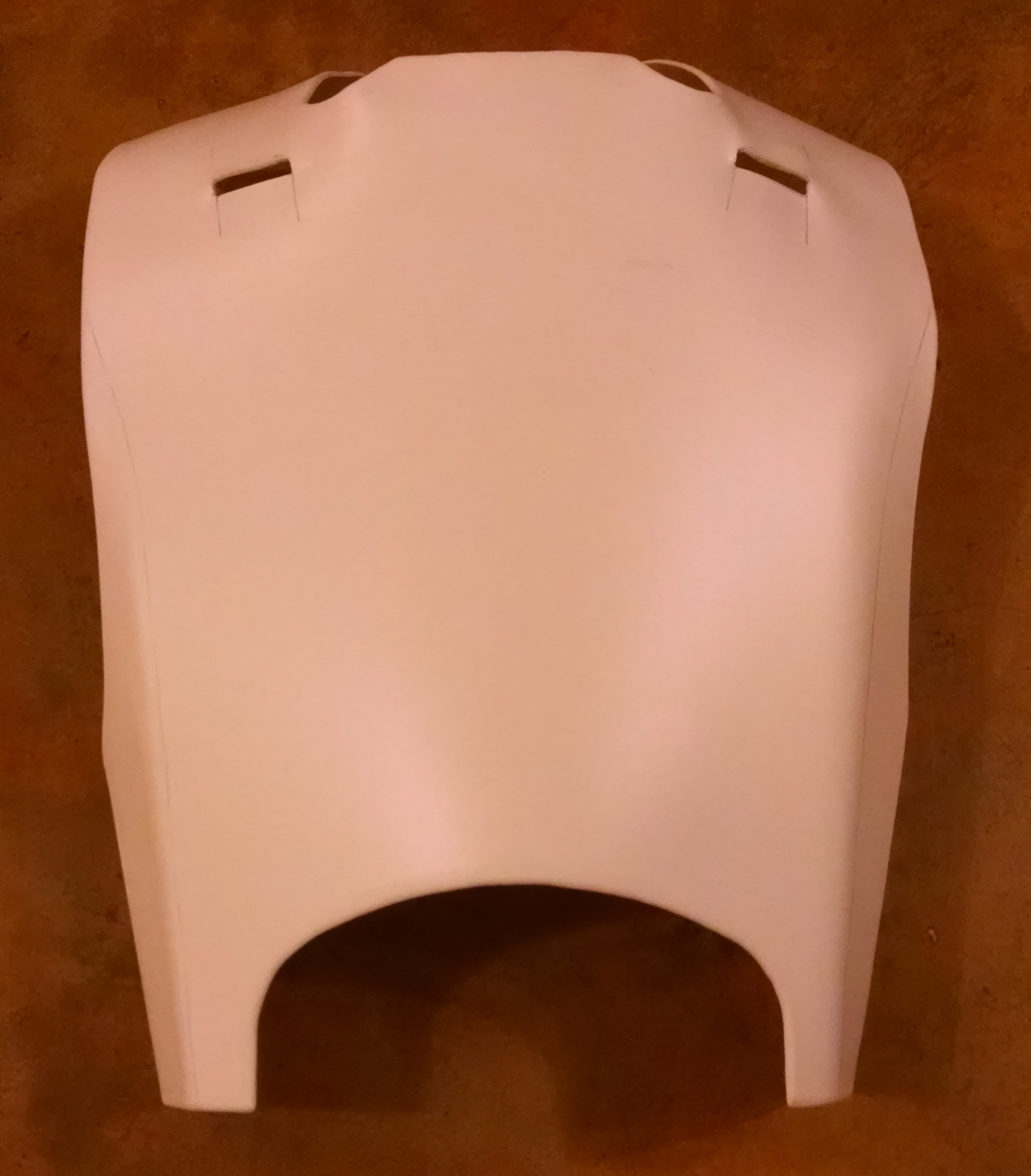

First attempt at back armor, using 3mm sintra:

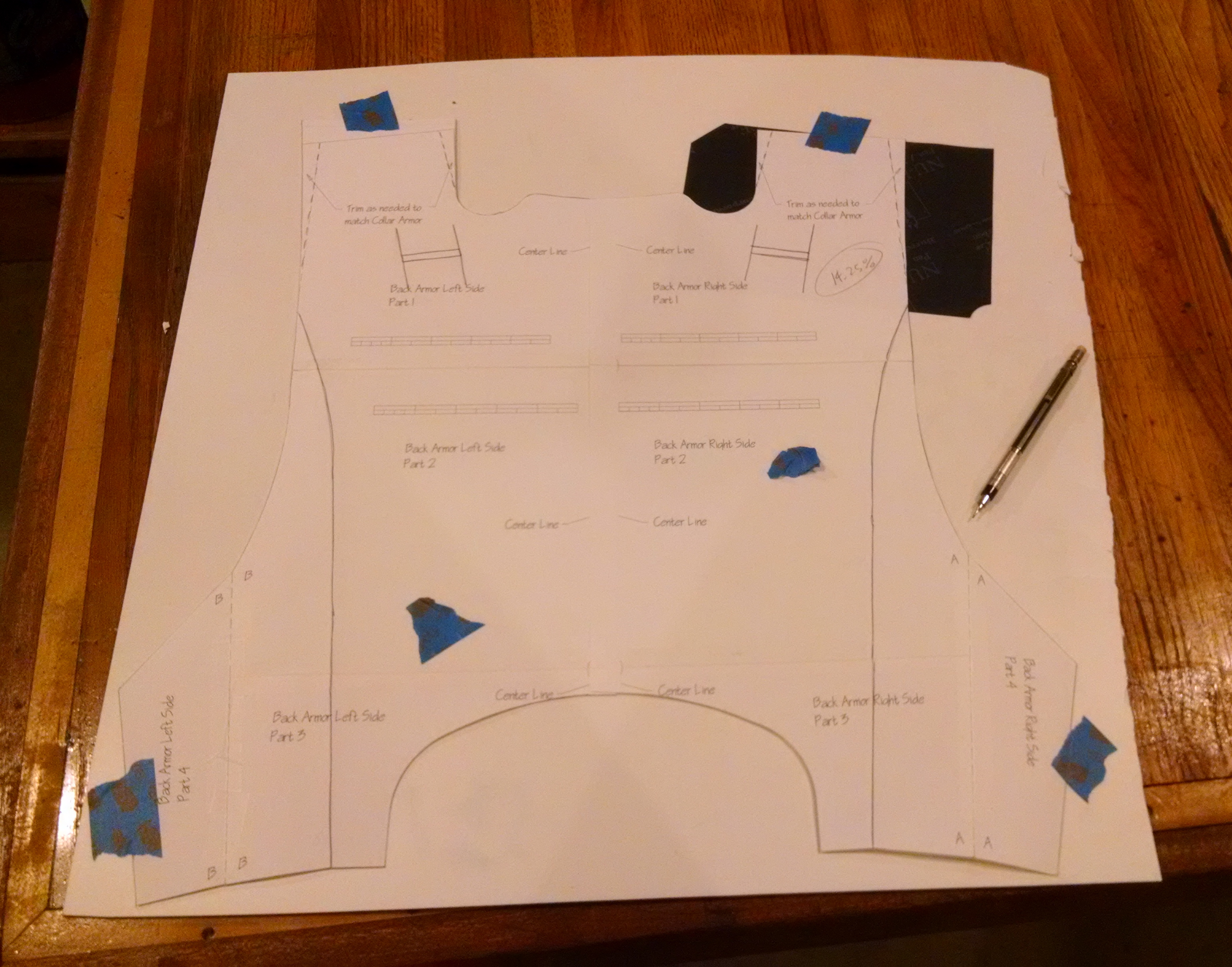

First I used Alan Sinclair's templates to trace the outline onto my 3mm PVC sheet.
Then I cut it out with a scrollsaw. Next I shaped the edges with my router and a 1/8"R roundover bit. Then the fun began with my heatgun and various iterations of shaping it to fit. Still fine tuning that.

Since my jetpack only weighs 2 lbs and change, I'm going to try supporting it from the back armor only using some white webbing I bought today. Wish me luck, planning to troop at my local comic store on saturday, Free Comic Book Day.
